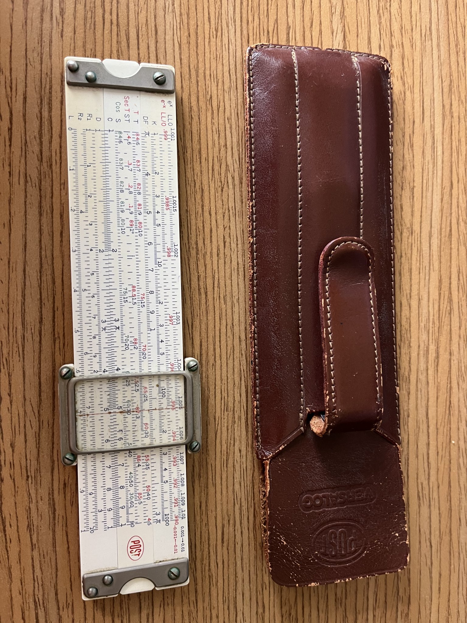

I have not seen any of my old calculators in a long time, I suspect they are gone. But I do have one of my Dad's slide rules. He was an electrical engineer at Bell Labs in the 60's. The slide rule I have is a pretty small one. He had a much larger one that I suspect my older brother grabbed before I thought to, haha.Re the calculator.

+ @VelericMy dad had a very nice slide rule too, not sure where it went.

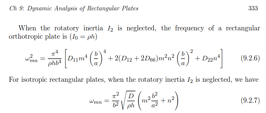

A book that might be interesting : "Theory and analysis of Elastic plates and shells" JN Reddy
In page 333 (extract below) is the natural frequencies for a simply supported orthotropic plate. With the criteria you proposed Eric : less a ratio 1.3 between f(1,1) and f(1,3), the ratio b/a can be determined.
