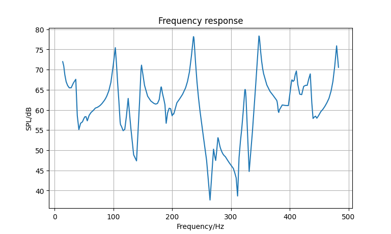

Here's a first frequency response from harmonic analysis.
(1,3) mode at 35 Hz
(1, 5) mode at 80Hz not showing a peak - why?
(3, 1) mode at 102 Hz
(3, 3) mode 125 Hz
I have calculated the panel average using triangles rather than points - with points it's incorrect because there are obviously more points than triangles! And this will allow the Rayleigh calc including distance/phase to observation point if it proves worthwhile.
Still puzzling over the physical meaning of the complex displacement data, and whether it represents phase differences over the surface of the panel. I assumed the reference would be the applied force (the exciter) so that its movement would be at phase zero, but that does not appear to be the case. I assumed that I need to find the magnitude rather than just take the real part, but am not even sure about that.

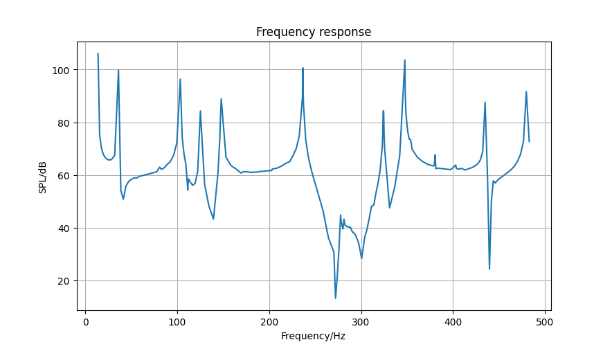

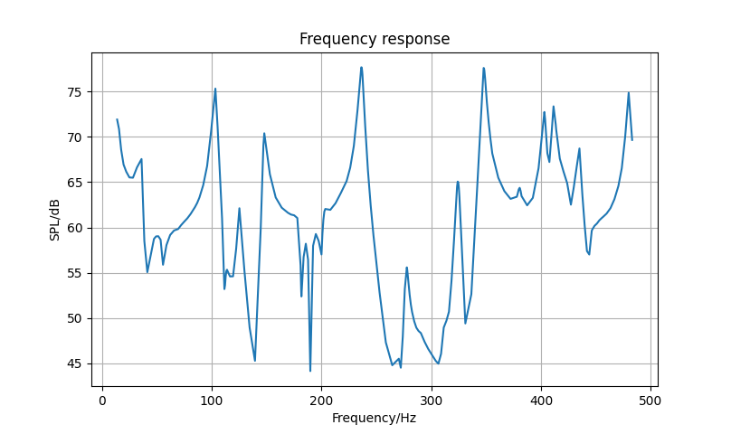

A couple more initial responses from a direct implementation of Rayleigh integral taking account of the additive phases of each element to the observer (microphone) position.
Density = 26
Thickness = 0.015
Tension = 0.0
Poisson ratio = 0.3
Youngs modulus = 4000000.0
Panel size 1m x 0.5 m.
Exciter pos 2/5, 2/5
The main differences I would point out today are the extra nulls just under 200 Hz, and the extra peaks over 400Hz.
The nulls are due to the particular mic location being at a spot to create a null somewhere in the spectrum. The depth of these nulls will be unaffected by damping, because they are a function of observer location. The graph above is for an observer location at (0, 0, 3) which is in front of one of the panel corners. Below is a response at a different location in 3m in front of the centre of the panel (0.25, 0.5, 3). Note how the nulls below 200Hz have shifted.
The peaks above 400Hz are edge modes I believe. Have to check this.
Ignore the fact that the overall levels are less - I was playing with damping and didnt put it back to the same value.
Code is still in a state of flux, and I will move now to shell solver, which has a better damping setup and ability to add extra masses.
I will post code when its a bit more stable. Some aspects are still puzzling, like no apparent increase in average response level with frequency. I thought I would see an increase due to omega squared, but the main one may be due to increase in radiation efficiency towards coincidence, which is not accounted for in this model.

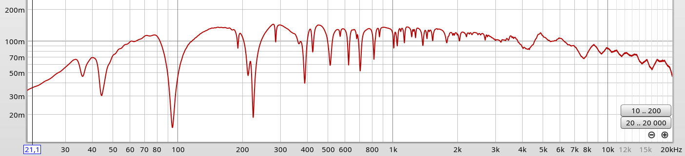

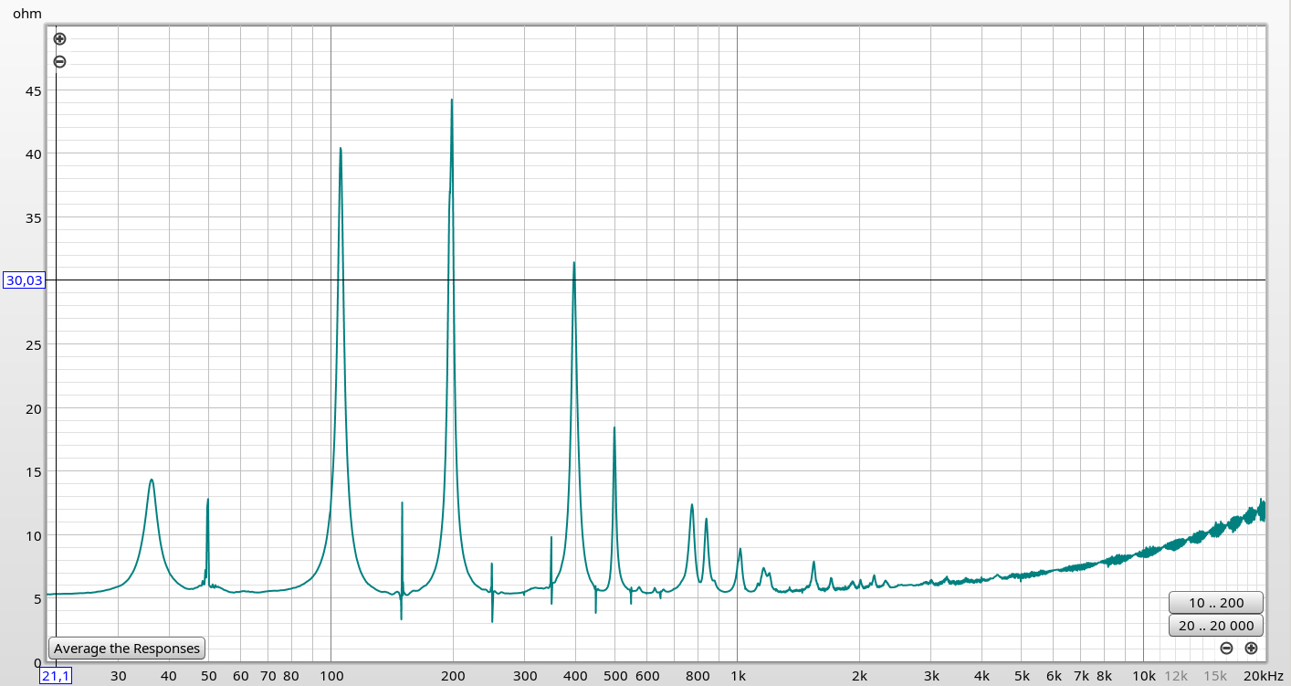

I did some impedance measurements today. See #9456 in the main thread for the exciter impedance (free air and mass added).
Below is the impedance with a 20x30 XPS 9mm plate.
The very sharp spikes are from some set up problem I haven't identified it (REW compatibility with linux or Linux with my soundcard or some interference because of power supplies?).
Except that, you can see the effect of the mechanical impedance at resonances. This time the vertical axis is correct in Ohm (I went through the calibration).
The peaks are from 45Ohms to about 10Ohms up to 1kHz. So in this example (ok this not an operational DML), it divides the current so the force by 2 to 5 at the resonances.
I would like to find the cause of the sharp spikes... but the set up seems correct. I have at hand a second unused exciter to evaluate their dispersion and a pair of canvas panels. For this week I am away from my plywood panels.
Christian

Christian,What we see as expected in a voltage driven exciter is a reduction of the current at each modes (not only the productive ones).
Nice measurement. Do you have some correlation with tapping or modeling that confirms the modes at the same frequencies as the dips in the current flow test? It seems certain that they must be, but it would be great to confirm.
Also, clearly some dips in the current are deep and others shallow. Any correlation of deep vs. shallow with the mode type? Or exciter position relative to the mode (close or far from antinode, for example)?
Eric
I seems to be viscous (velocity-proportional) damping with the plate model. Does not seem to have much effect on anything but the peak height. But I dont get velocity from the model itself but calculate as proportional to displacement as we discussed. So viscous damping probably does not work properly. For shell model, mass-proportional damping is available.Which damping into the material have you modeled? Over this range of frequency, one might think the damping is constant, so the quality factor of each mode (the width of the modes), so as the density of modes increases with frequency, the level might increased?
Density of modes is about constant with frequency, but increases of course with log f. So yes we can expect an increase due to that if I were to go much higher in freq.
Yes, constant force is the model.The model is probably for now with a constant force
The increase resistance you are measuring would be due to back-emf I suppose.
