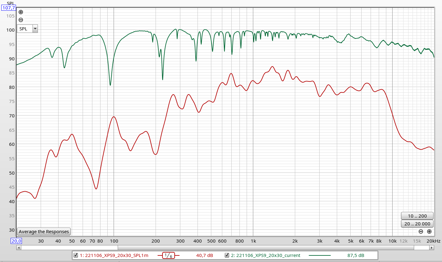

Nice measurement. Do you have some correlation with tapping or modeling that confirms the modes at the same frequencies as the dips in the current flow test? It seems certain that they must be, but it would be great to confirm.
Also, clearly some dips in the current are deep and others shallow. Any correlation of deep vs. shallow with the mode type? Or exciter position relative to the mode (close or far from antinode, for example)?
Eric
Here are the current and SPL at 1m of this test. As it was a 1st attempt, I haven't pushed it really... I remember now that I was a bit surprised looking at both!
Yes exactlyThe increase resistance you are measuring would be due to back-emf I suppose.
Good observation. No such sources close but you reinforce the assumption of an effect of power supply. My old USB soundcard has an external switching power supply (a model of replacement because the original one died). The laptop was operating on battery. There is also the power supply of the power amp (it is a very old one I built in the early 80's... yes! inspired from Hiraga amp but in AB class...).Odd multiples of 50Hz. Looks like a square wave at mains frequency. Are you working near a motor? Air con, refrigerator etc? Or an SCR LED light dimmer?

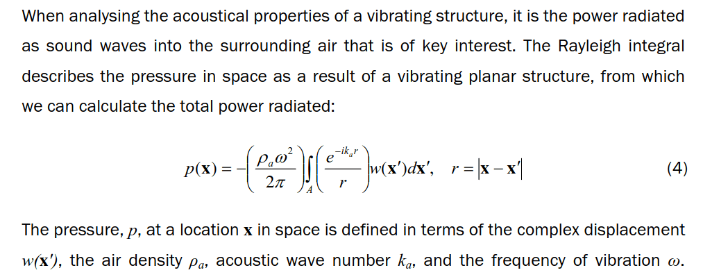

Im still considering why the calculated SPL is not increasing with frequency when using either simple averagng, or my attempt at coding the Rayleigh integral directly. Any ideas?
Ive been doubting our assumption that the plate velocity is just w (omega) times the displacement. We actually want the normal component of displacement, but idk if that would make any difference.

Hi Paul,Im still considering why the calculated SPL is not increasing with frequency when using either simple averagng, or my attempt at coding the Rayleigh integral directly. Any ideas?
You are in advance on my own thinking... Currently I go slowly on the FDM for orthotropic free edge plate and I have also open a side topic with the impedance measurements. The impedance being I think something interesting for all, I hope to close the assembly of a not too bad set up this week. It leads me also to the idea to read agoin some papers about the electrical impedance of DML; papers that were aside for now but I should understand now and I hope to find information that will help in modeling.
The step in front of the Rayleigh integral is for me to get the speed in any point, any frequency based on the location of the driven force. Not fully clear in my mind...
Yes the normal speed is needed. But as I suppose displacement in the other directions very limited, it shouldn't make the difference.Ive been doubting our assumption that the plate velocity is just w (omega) times the displacement. We actually want the normal component of displacement, but idk if that would make any difference.
I tried to find elements going down in the paper I collected. About the Rayleigh integral there are few doubts. Here is an extract of
Analysis of Flat Panel Speakers Luke Humphry. This one is based on the displacement.
In the same document, there is the calculation of the displacement as a sum of the modes depending on the driving point location similar to the Putra's thesis. This is probably something I should implement in the FDM script to see where it leads.
Where I am not able to follow those papers is when the topic comes to the radiation efficiency. The coincidence frequency is introduced while it is not in the Rayleigh integral... something missing.

Yes I can't really see much wrong with our assumptions. I also have been looking for example to prove our assumptions about it. This equation you found confirms it well. And omega squared is there as expected.
I think that the Rayleigh integral should in principle show coincidence. Because another related technique using the 2D Fourier transform called 'supersonic intensity' does show it. It involves taking the transform into k-space, filtering to keep only those wavenumbers (confined to a circle about the origin) which radiate, and then taking the inverse transform. It shows clearly the edge modes and corner modes below coincidence, and would of course show coincidence itself, when all modes are inside that circle. So the required info is there in the panel velocity.
I would like to try this also with scipy, but the 2D Fourier transform requires a regular rectangular grid, not triangular. I would need to make the exciter area a square, berhaps with just one or four elements.
The simple application of the Rayleigh integral (called the 'simple source' technique becomes 'unstable' for locations near the plate, but we only need the far field, so I suppose it should be OK out there.

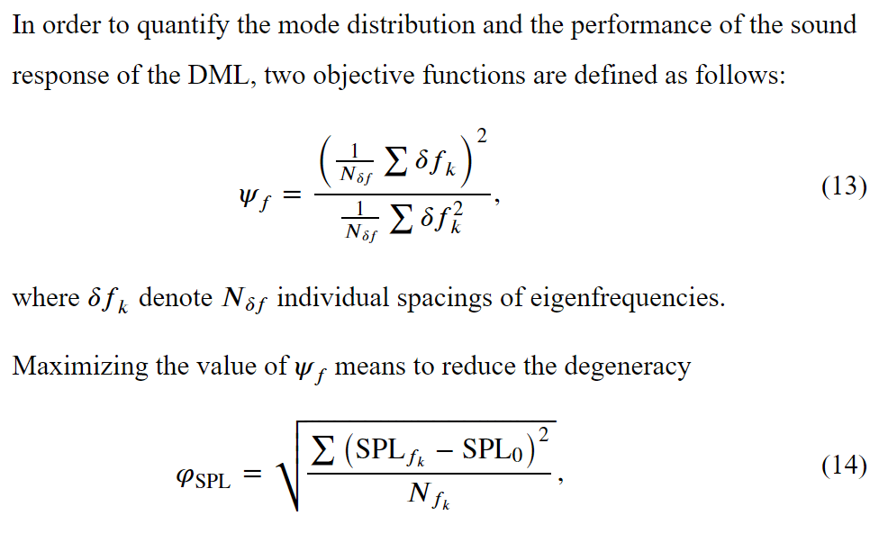

Going into the papers I collected, there is Optimization of orthotropic distributed-mode loudspeaker using attached masses and multi-exciters. Have a look to fig 3; there is no LF roll out shown... The method used is similar what you do.

Hello Paul,

Ive not seen that paper.
It interests me because they are considering the mode spacing with a view to reduce the degeneracy and variation in mode spacing! I thought that was my idea!
Their measure of variation in mode spacing is interesting, I used standard deviation of mode spacing but they use mean^2/variance, which they say reduces the SD of the SPL, which would be a better objective function.
There does not seem to be any increase in response with frequency as you say, and they go to a higher frequency. I suspect its a deficiency of the simple source technique.
I find it a little strange that they are focussing on mode distribution when adding weights. On the one hand, adding weights at asymmetric locations should tend to remove degeneracy and even out mode spacing. But in my mind, weights are mainly about removing specific problematic resonances - the weight has to go to the location which is optimal for that, and you just need to accept whatever effect on the modal distribution that produces. The main technique for getting a smoother modal spacing in my view, is to use an asymmetric panel shape to begin with.
