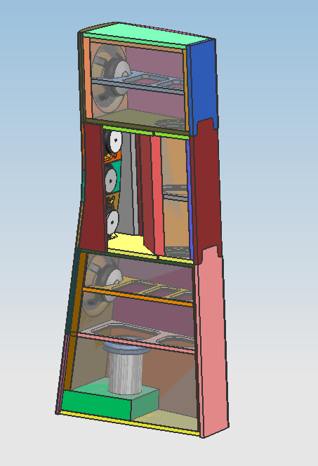

your design is elegant to say the least you must have put a great deal of time into just getting the volumes right for your driver selection let alone the drafting part of your thoughts
it would be fair to say that you would have minimal problems adapting your drafting skills to the proposed CNC machine that is in the pipeline
some questions for you
if your internal bracing is so tight how will you tie in the rebates to the side panels and also incorparate the attenuating material for the damping
from the drafts it appears that both top and bottom woofers share the same volume so are they wired in serial push pull or parallal or some other configuration
do you plan to tri amp bi amp or other will the crossover be active or passive or a combo
if passive it will be fun getting that stuff in side your cabinets
best of luck on your project and a successful new year to you

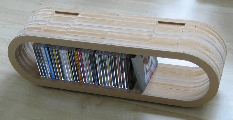

  • 2.5D machining - yea, it takes a long time! Cutting just one example and making a mold for casting is not a bad idea. I found a local pro CNC shop that uses 100mm CNC modelling board - I get lots of pretty large pieces for free, as they consider offcuts as waste. You can glue them together, they're easy to cut/sand, and they're great for making molds. A powder additive mixed into casting resin can make it cheaper to cast as it bulks it out a bit. Silicone molding rubber is pricey though.

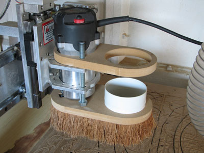

  • Milling MDF is dust central. If I had the space I'd create a separate room just for the CNC machine, let it cut, then enter the room with a respirator and clean up. As it is I'm running a dust extractor all the time the machine cuts (as the machine's in the garage). Works well, but it's not very neighbour (or electricity bill) friendly.
I know what you mean. Even a hand held router cutting a couple of holes creates a lot of dust so a CNC machine would be even worse. I anticipated this and ordered the machine with a dust/noise enclosure that cover the working area. You can hookup a dust shoe onto the milling head attachment and extract from there and also catch the airborne particles within the enclosure via a second hose. This will keep the dust down to healthy levels.

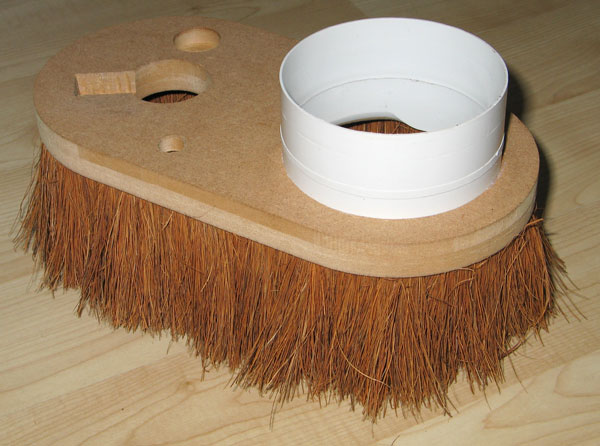

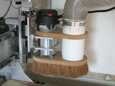

Be really careful with hold downs, bolts etc. Good clamping of sheets is a must - you can easily drag a 4x2ft 3/4" thick sheet of MDF across a table if it's not well held down.
Also be really careful when it comes to tool paths vs. clamps. Let's just say that a 1/4" up-cut spiral solid carbide bit doing 18k rpm and travelling at 2" per second is 'interesting' when it clips a 6mm steel bolt that's being used to hold down parts :eek:.
Mach3 is great. The set up takes time, but it's a cracking piece of software and well worth the cash. Good motor tuning is crucial though for the best results. Is the machine a K2, ShopSabre, something else?

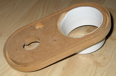

The enclosure is a great idea. Just don't have the space for it in my garage. BTW I built a shoe for mine, as the original was a bit too puny:
Good dust extraction is a must. I'd recommend at least a 3hp blower. If you can fit it in (I can't) then a cyclone separator (Bill's Cyclone Dust Collection Research - Home Page) would be a great idea.
Nice work there.

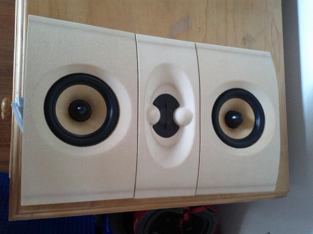

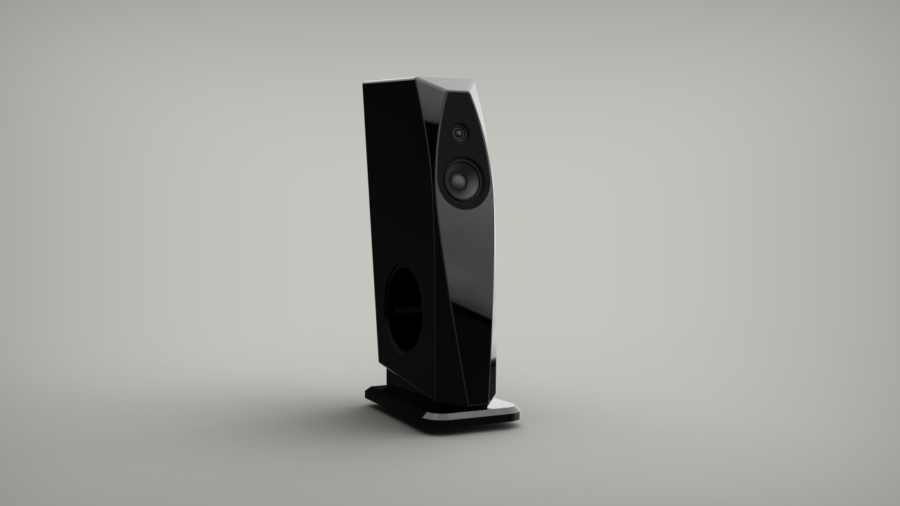

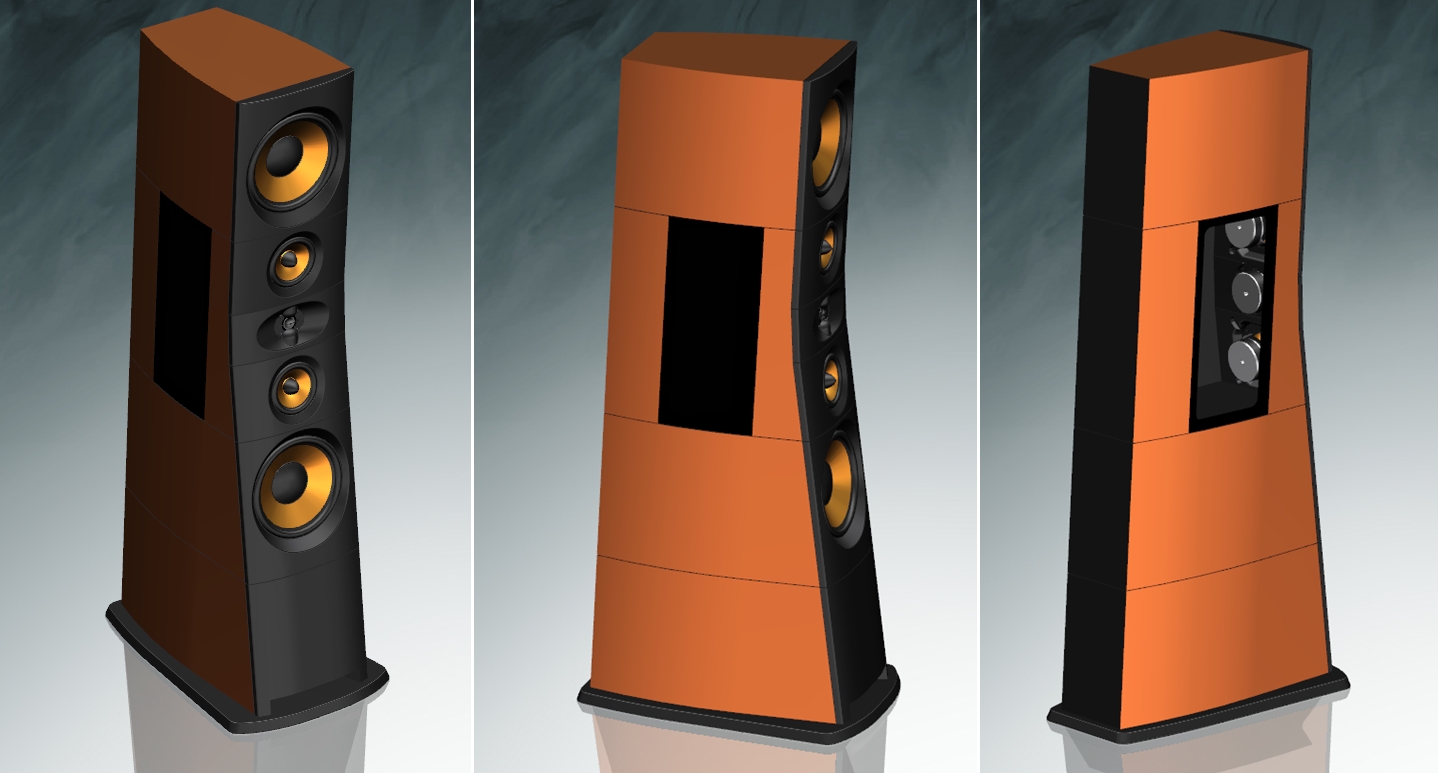

The latest Aurora iteration but I'm still playing about with bits:
attachment.php
Strike are pretty busy so the CNC has been pushed back towards the end of January.
Any recommendation on CAM packages?
I use Solidworks 2011 and I've noticed there are a number of plugins. This is seems the most logical step as your working within two programs that are integrated and (hopefully) both understand one another.
The two I've been looking at are SolidCAM and MasterCAM. I've seen some fairly reasonable prices for used copies on ebay and they both appear to be good. No idea which is more suited to someone starting out though.
As mentioned before Mach3 will be running the CNC.

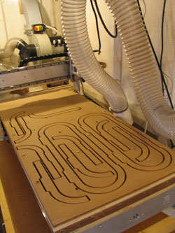

I use NX7.5 CAD and CAM (at work) for my DIY CNC router (at home).
I'm making these, using rear mounted Focal drivers. A PC will be the crossover (starting with Allocator, then maybe Soundeasy UE3 or Audiolense), playing around with perfect phase.
If I don't like the Audiom bumps on the tweeter, I'll machine a baffle without the bumps. If the open midrange doesn't work out, I'll box in the side walls.
The speaker is modular, 3 boxes, so I can move it, but it will also allow me to try different configurations.
As for CAD/CAM, I can use NX, Solidworks and Pro/E. I like NX best, for speakers it's magic as you can quickly build single solid model driving the concept, then cut and shut associative panels from it. Then blow them out to individual parts for machining. Creating internal volumes is easy too.
Solidworks is reasonably flexible for this too, but Pro/E is woeful. You'll spend all day playing at building it panel by panel and mucking with assy's rather than getting the job done.
It's not how I use NX for work projects, but it's quick and gets the job done.
I can only use NX CAM, but I have heard good things about Solidworks+Mastercam.
I'll start my own thread, one of these days.

All of these (including the dino) were done with free/cheap packages (i.e. ProgeCAD Lite + SheetCAM + Mach 3):
