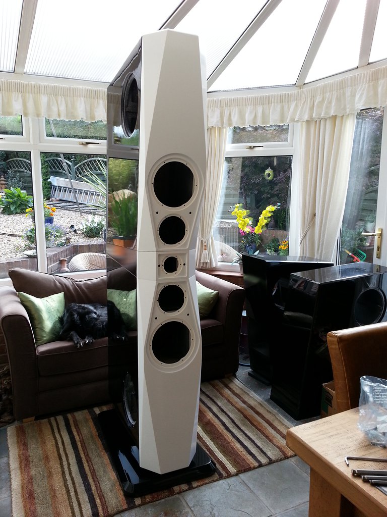

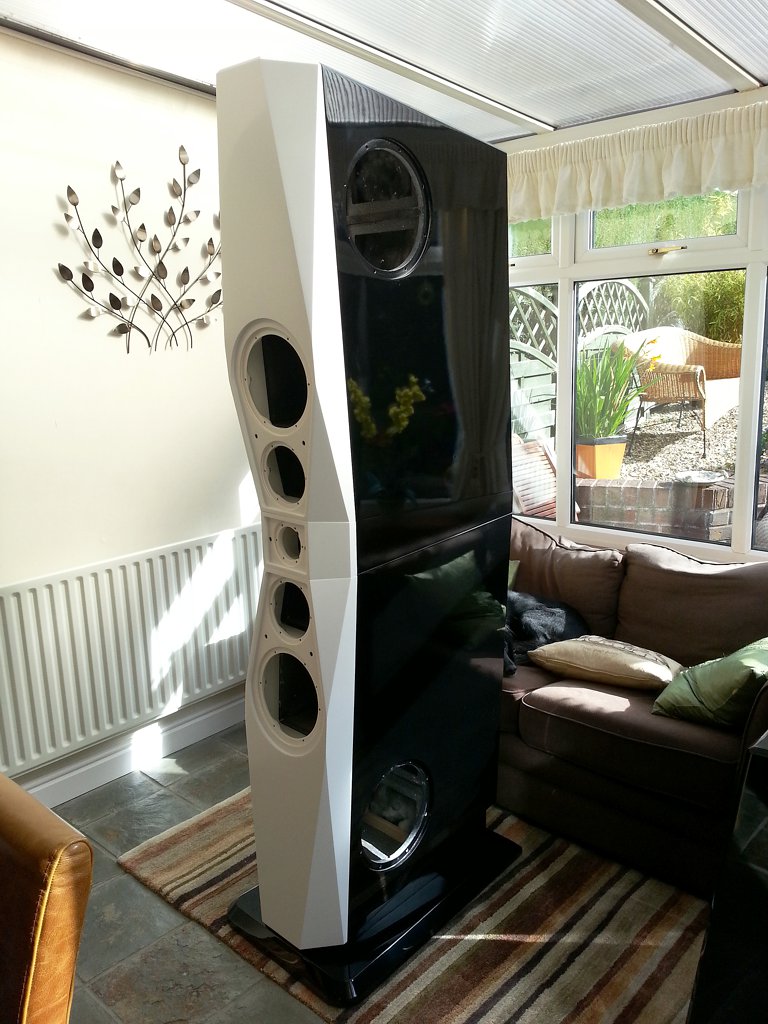

The apollo is now complete. Just fitting and finishing touches left to do.

Superb work Ant.
I do hope you're going to leave them in that room, as they're merely adequately large for the space 😀

Amazing looking speakers.
I rally look forward to seeing these completed and how they measure.
You should be doing this for a living!

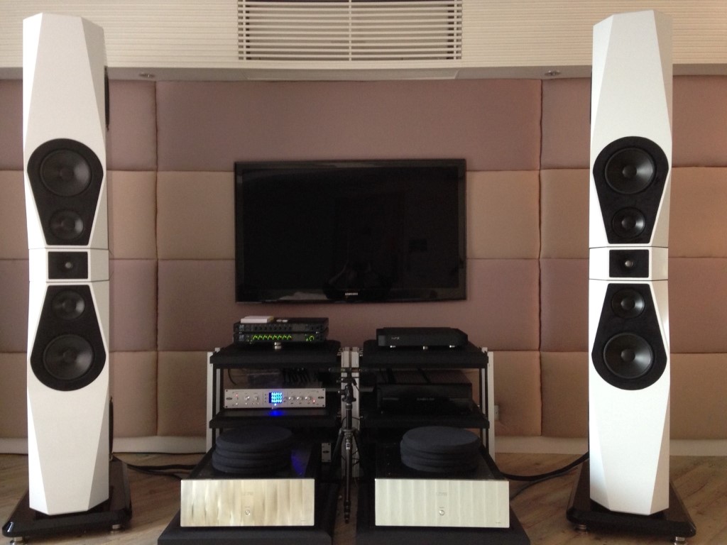

Happy to report these have safely been delivered to their new home in Hong Kong. Arthur has a fantastic setup that will do justice to these speakers. I hope he gets many hours of enjoyment from them.

..I hope he gets many hours of enjoyment from them.
It's assured. 😉
