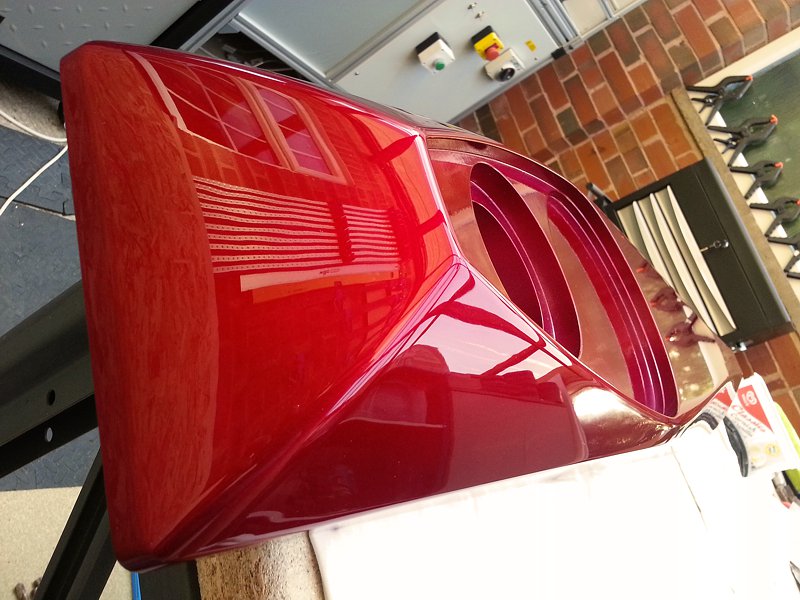

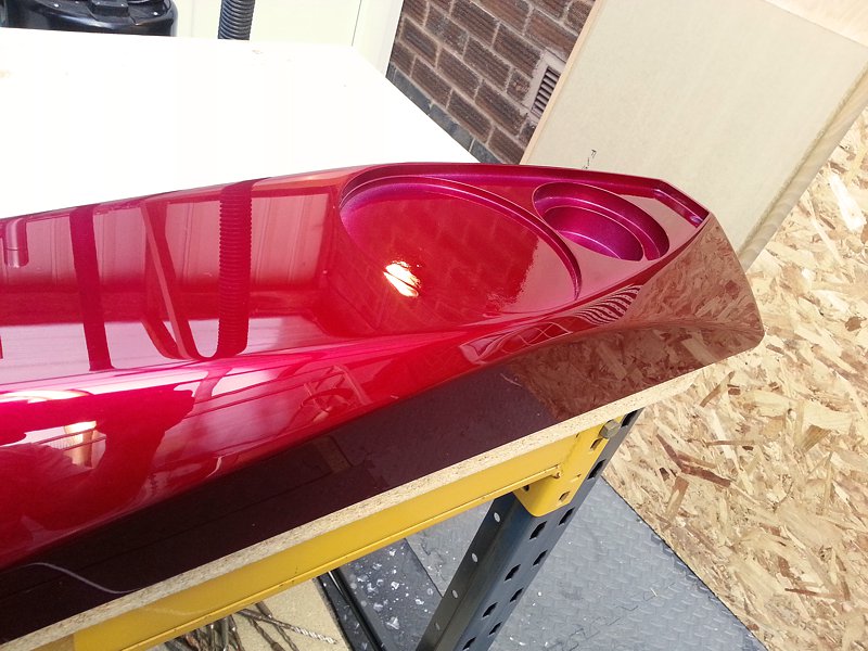

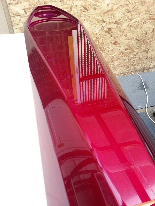

I've worked with them before and consistency is the key. Disciplined spraying is the way. Keep the pattern tight, gun distance constant and your good. Not spraying enough coats is a factor too. It depends on how deep the candy is but for darker colours I'd go 3 or 4 and lighter would be 5 or 6. This will ensure your getting the correct coverage and an even finish.

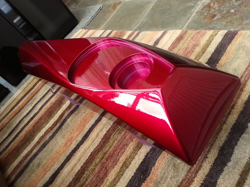

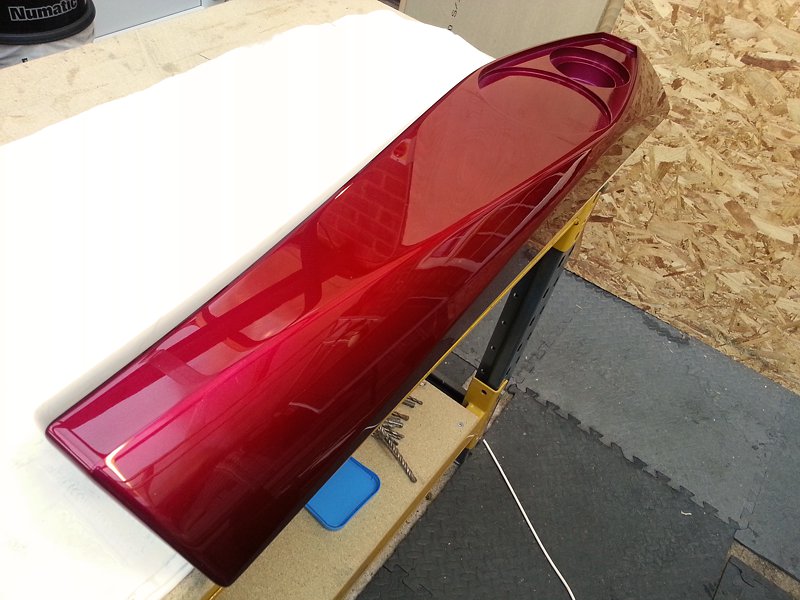

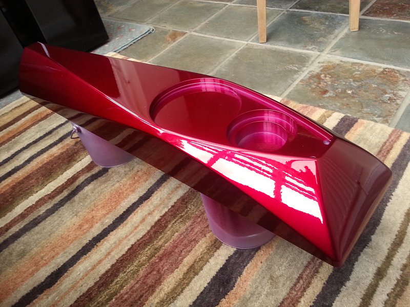

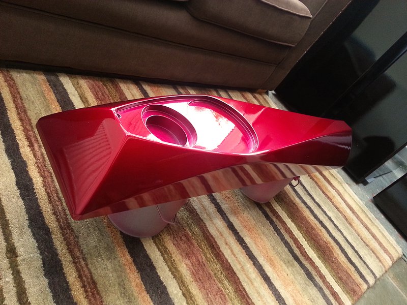

The Apollo parts are all sprayed and ready for finishing. Won't be long before these are complete and I'll post back with a few shots.

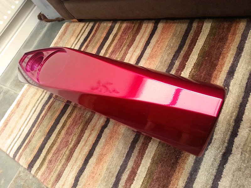

Had a quick play around on the test baffle to see how the deep red candy would come out. Still needs sanding out and buffing but looks nice in the flesh if not so subtle.

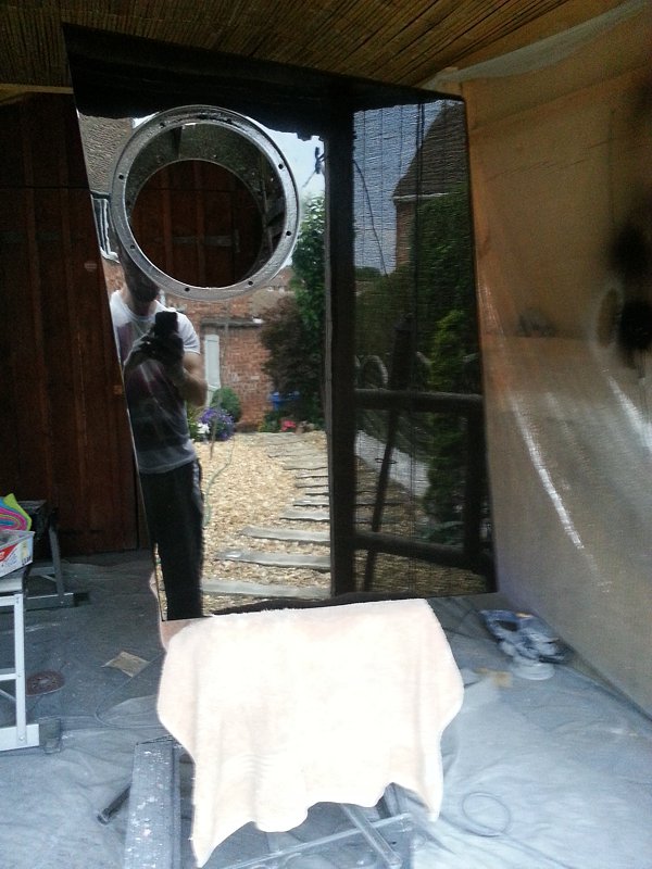

The plug for the mould is now finished. As you can see its very shiny and should give a nice release along with a great surface finish. Looking forward to casting the first proper baffle out of resin.

Whoa!!! Epic paint job!!!
Mind we ask what materials u used?
Paint and spray gun?
Heya Gravedigger and thanks.
The paints used are standard acrylics type often used by automotive refinishers. If we're talking exact brands I believe the primer and clearcoat are both from Nexa Autocolour but I often use Upol too with good results. And the basecoat/colourcoat are mixed by a local small specialist supplier.
I use a few guns depending on what I'm spraying.
The primer goes on with a 1.8mm Airgunsa AZ3 HTE2 : Anest Iwata Europe - AIR GUNSA - GRAVITY SPRAY GUN AZ3 HTE2
For basecoats there's a 1.3mm Anest Iwata WS400 Evo : Anest Iwata Europe - SUPERNOVA - SUPERNOVA WS 400 EVO<br>EVOLVING INTELLIGENCE
And finally for clears I use a 1.4mm Anest Iwata W400WB : Anest Iwata Europe - CLASSIC plus - W400 WB CLASSIC plus

From your mirror finish pic, we see you- you're younger than I would have thought. Usually it's only the old dudes who take the time to do things to the level you have. "Mad props yo".
Not that young badman, 34 here.
Thanks though mate 🙂
