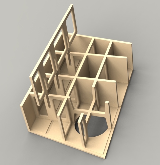

Updated the cabinets with interlocking bracing and channel rebates within the walls.

One stupid (woodworking) quesiton.
How do you assure there're proper amount of glue (and pressure during drying) on all those contacting surfaces of interlocks? (and you got plenty of them)
I've done only one lock and just relied on excessive glue for the bonding, very crudely😱 I guess that's not good enough for all those (preciesely cut) interlocks.
Hi CLS
Only a small amount of glue required on any joint really. By the time you clamped it together(or interlocking like this is self clamping) tight any more than that will only end up squeezing out.
I normally apply a thin bead along the joint and then evenly spread this around the contact area with my finger. This method seems to have the least mess for me yet still ensures good air tight contact.
If in doubt using more than necessary is better than too little when it comes to air tight cabinets.

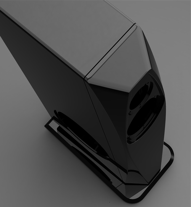

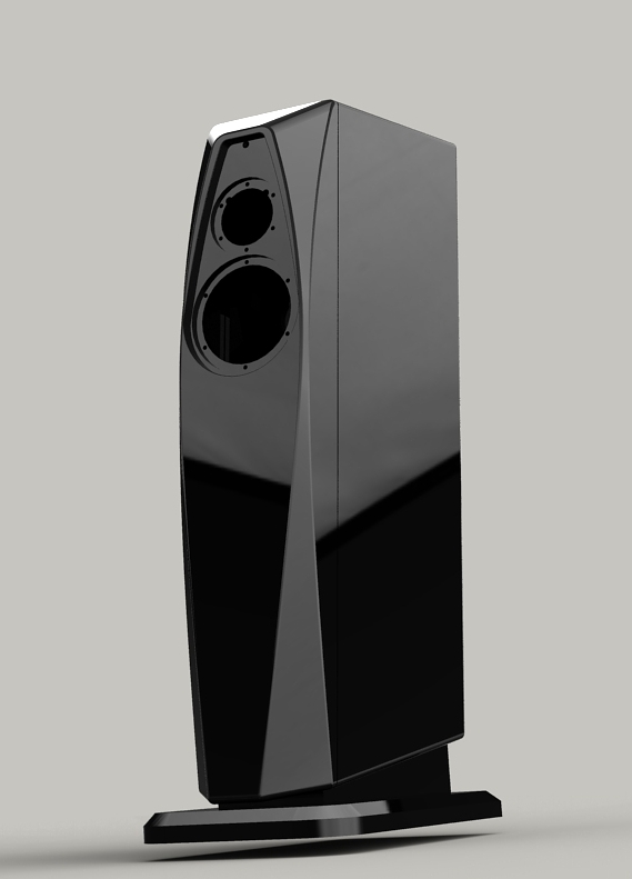

Damn this CNC machine. With the options it opens up I've felt compelled to go back and rethink the Aurora. I'm working to give it a make-over including reworking the bracing in similar way as shown a few post ago.
Before that however I wanted to take a look at the baffle. CNC allows for more complex shapes so I went ahead and adjusted the facets to a more sweeping feature that follows a similar profile to the original shape and added large radius's to the previously sharp edges. Diffraction should be reduced even further.
Here's the first iteration of the baffle which I really like.

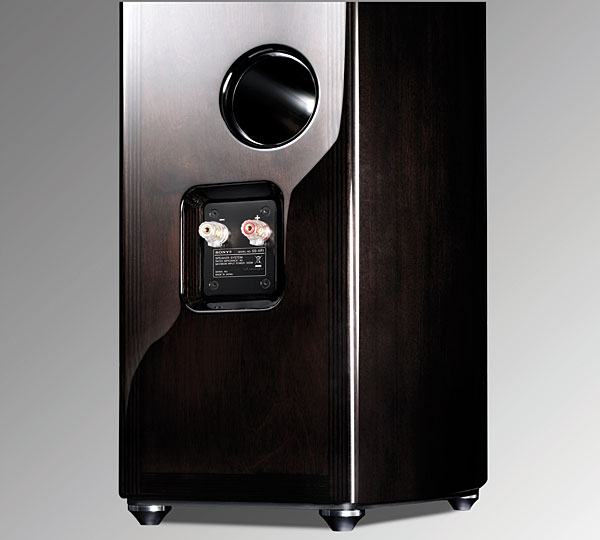

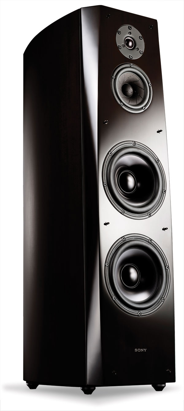

Do you plan to use a sealed bass cabinet or also offer ported options?
My last speakers used a lower front baffle MLTL port with very good results, but a 4" hole is ugly. A bottom port location would have more style and might integrate with your design theme. Rear ports allow more style flexibility, but I have found rear wall placement complications.

I like the sharp edges and more triangulated facets a lot more. It makes a much bolder statement as design.
This more sweeping design, in my humble eyes, bears parallels with the Dell/Alienware PC's..... 🙂
If you persue this more rounded design: what about replacing the straight edge above the tweeter with a rounded one following the radius of the tweeter....the narrow portion of the baffle becomes an elipse which might fit better to the overall design.
Huib
Thanks for the input.
I too like the angular look, its something I've done for years now but with more tools at my disposal I want to take advantage of the possibility to improve the sound further with more complex cabinet construction and baffle shapes that I didn't have the facilities for previously.

Well actually if there is one thing I would have criticized the old design for is regarding to the baffle. I don't have any experience with this myself but many designers (I can probably quote Lynn Olson and Dr. Geddes) are pointing to the the fact that sharp edges around the source actually means diffraction sources. So I'm all about rounding everything near a driver.
The thing is that your second design also isn't a low diffraction one, the radius just isn't large enough.
Hi Sunra
A basic baffle is often a rectangle and even though the angular one had edges at facets it had a step up over those in this regard because it was non square. This also led to minimising the width of the baffle around the drivers so it strived to adhere to the minimum baffle width philosophy.
Re: the radius. These are between 5-30mm depending on where your looking but your correct, the design isn't intended to eliminate diffraction. Its designed to reduce them over what you see from the more common baffle designs. If the goal is almost zero diffraction then a sphere would be a good starting point but that brings about its own problems too. As always its about balancing the variables within the constraints of a design brief.
