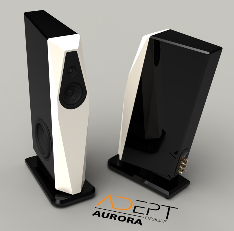

This makes my efforts building like a stroll in the park! This makes my problems feel much lighter, thank you. Very nice design!

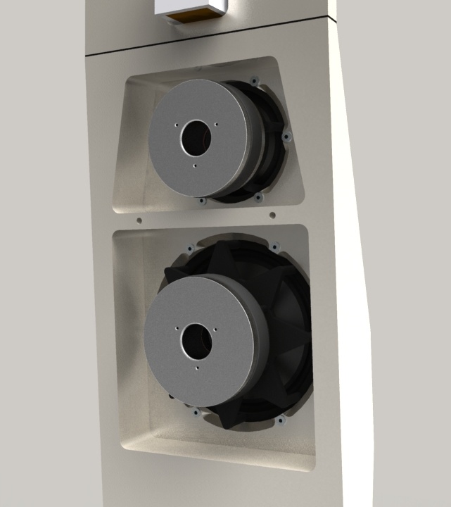

Rear baffle detail:
WOW! (..crap-out sick for a few days and I miss the good stuff.) 😱
Ok.. that has to be real and not a render.. correct? 🙂
Is a professional manufacturer sneaking around here in the 'DIY' group?
OK, I confess I'm jealous. I'll never have that level of craftmanship. 😱
Hi Scott,
Its a render sadly, I wish it was the real thing because then I'd have the baffles 😀

Some people can draw, some people can make tangible, but you can do both.
Got to buy you beer sometime...

Then you'd have open baffles and maybe you would've been reconsidering your design 🙂
Seriously now, when I first saw the title of the thread I told to myself that I won't post in it because then I'll have to do what I did with your last builds: constantly refreshing the page and check for new posts 🙂

In amongst all the excitement I forgot to mention I'll be building alongside the Apollo, a pair of Aurora for myself. Gutted I can't accommodate the Apollo but I doubt the upstairs floor joists would hold the weight 😀 I'm sure Arthur is going to have a lot of fun unpacking and setting those up 🙄 😛
I'm not sure if I'll create a separate thread for the Aurora build. Most likely they'll end up in here.

Hi Scott,
Actually that it's a render is even more impressive (to me). It looks real. 😱
I'd say "someone" is getting *really* good with material textures and lighting with Solidworks. 🙂
Now if they just come out with that perfect 3D printer that would print everything correctly.. 😀
Funny, I was going to say the opposite. The texture on the steel is obviously fake, and the geometric resolution in the motors is lacking.
Why such sloppy work, shin?

Can we please see more of the Auroa too....? 😉
I mean , -- it is almost X-mas and all....

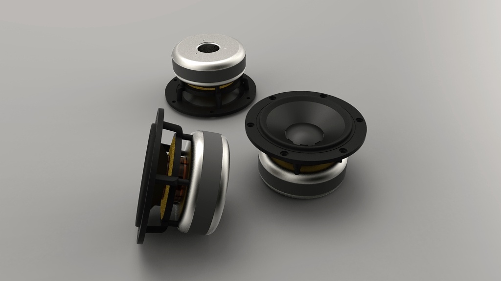

The mids are turning into something cool.
The top and bottom plates of the motor will have a large radius fillet machined around the edge. This will allow better airflow, less reflections and compression. Good thing too because the magnet on the CQ 15H is on the large side so every extra bit of clearance is worth it. This fillet along with the chamfers on the inside edge of driver cutout within the baffle will go along way to reduce reflection back through the cone.
If you look the surround profile closely follows that of the cone. The surround profile on these utilise the midrange specific type for reduced cone edge resonance and surround reflection giving a better FR. You do sacrifice excursion and a small amount of extension however.
Then on top of that the voice coil former is a kapton/alu hybrid and a short coil in long gap motor with symmetric drive for an improved BL curve.

52mm VC on the 5" and 8" with the PP, AT are likely using a different mix for its cones compared to others as they throw in some portion of magnesium silicate dust along with the polypropylene.
The 10" are 77mm VC with a sandwich cone construction - two thin carbon reinforced paper cones, which are glued together with an expanding foam.
What are the drivers for the Aurora?
Hi and thanks. Drivers are Scanspeak D3004-6600, Scanspeak 5" Revelator and Peerless XLS10
Hi Shin,
Is it the midrange version of the ScanSpeak 5" Revelator or the mid-woofer version of the 5" Revelator you intend to use in the Aurora project?
