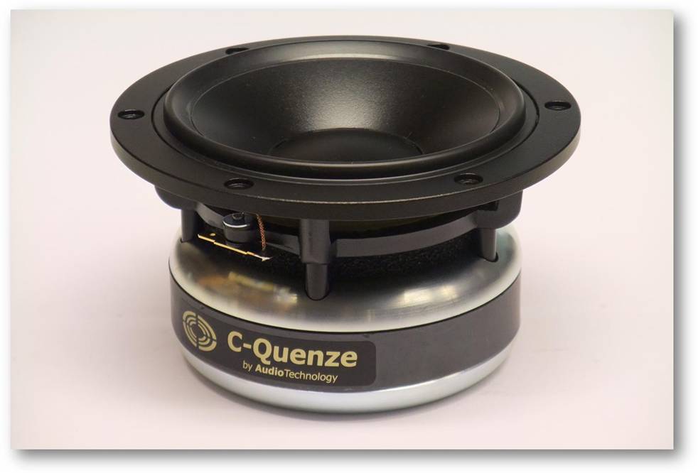

I'd guess around 5kg
Coulda been a lot less..... and a lot less concern with magnet reflections, if you went with neo 😉
Are they avail in neo?
I have not seen the neo version yet.
It would have to be a different driver, or a custom dealie. I'd not have gone there but it sounds like the radiuses were custom.
I always want to try audiotechnology c-quence. The poly cone keeps me from using them.
With the prices of Neo right now I'm not sure I'd want an AT driver with such a motor. 😉
