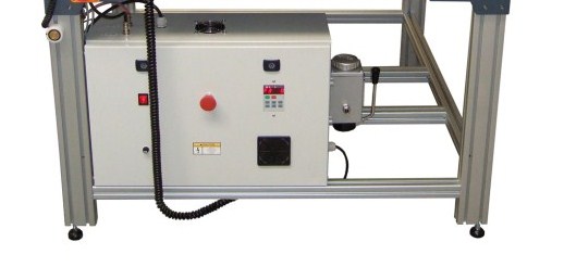

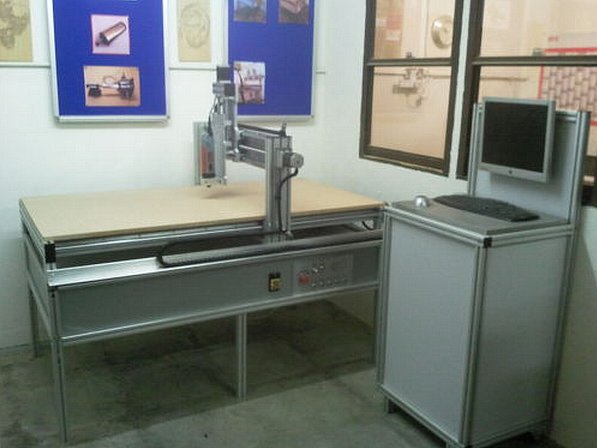

OK well I guess the best place to start with is the machine.
Mine is similar to this model from Strike except that has 1450x850x150 working area and mine is 1220x1220x200 with an enclosure covering the top section. Other than that they're identical(EDIT: Mine doesn't have the 4th axis either).
Here are the specs of the model:
- Y dual 4nm motors
- X 4nm motor
- Z 3nm motor
- 4 axis integrated control box with interface spindle control
- 36V PSU
- 16x10mm anti backlash ball screws
- 25x10mm ball screws
- Precision supported linear rail
- Quick release cables
- Kress spindle mounts 43mm
- Kress milling spindle (FME 1050F)
I also found out besides Mach 3 it comes with a copy of Vectric 2D CAD CAM but am told this isn't much use for 2.5D.
I understand this isn't an industrial machine and is hobby orientated and I'm fine with that. I only ever plan to put MDF, wood and acrylic through it. Maybe when I'm more confident I'll have a go with some soft grade aluminium but it will be light duty and rare.
I'd appreciate if you can see any significant short comings with the machine but please bear in mind my requirements also, I'm not trying to gouge out 18mm depth at 100mm/sec here 😉
Also any advice on what the machine looks like it could handle in terms of the feed rate and cut depth in say MDF would be nice too.
One of my main concerns was noise so that's why the Kress was selected. I couldn't stretch the budget to a water cooled spindle and the powerful air cooled spindles are very noisy by most accounts. What I didn't want was to have the machine deafen me whilst I worked on other things since its all in the same room. I'll probably still need to wear ear defenders though.
I was looking at a rack and pinion machine from Marchant Dice but something about the guy I spoke to put me off. I got the sense he was telling me what I wanted to hear in order to get a sale and wasn't as helpful or open as Michael at Strike.
I'm sure once I start playing around these questions will begin to answer themselves but for starters:
- For multi-sided parts how do I set the start point once the work piece is moved and flipped over? It has to be exact. The baffle for example requires this.
- Strike sell sensors to set positioning, are these useful or is there a simpler and cheaper method?

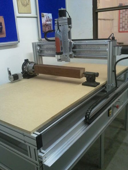

Well... my $0.02...
From the attached images, I'd say that the gantry looks a little under supported. At 200mm tall it might flex a little more than desired (unless the 200mm z option has more bracing).
Steppers. Nothing wrong in principle, but if you push them too far you risk missing steps (the controller thinks the machine's moved, but actually a stepper 'missed a beat' and you're not quite where you thought you were). Hopefully they'll have guidelines for safe cutting speeds & feeds in different materials.
The Kress spindle is interesting (I've not seen that before). If it were a 3 phase unit, then I'd say fine - I've seen 1,000w spindles crunch through wood with a 1/2" bit way better than a 1500w router. However, for that price there's surely no way it's 3 phase... is it? If it's single phase then it looks like a glorified trimming router, albeit with maybe better bearings. I may be way off the mark here, but the cost does look low.
Having said that, I see the Kress site indicates "Full wave electronics for consistent power and speed", so I wonder if there's some smart speed control that doesn't require voltage chopping. 5000rpm is a very low minimum for a router, so it might be something a bit more special. Interesting, they also do various metric collets (DamenCNC.com - KRESS Milling Motor). The manual states max milling tool dia of 36mm. That's pretty big!
So, if it's effectively a mini router, then I'd start with 2000mm/min linear rates, 1/4" spiral upcut bit, and maybe 1/8" depth of cut (for MDF). You may well be able to ramp up the speed and DOC. Hopefully Strike will be able to advise.
Look out for acceleration (motor tuning) config in Mach. I found that being a bit greedy can cause the machine to 'bump' with rapid acceleration/deacceleration, which can trip out the controller. Being a bit more conservative didn't increase cutting time much (even for intricate jobs like lettering) and seems to have eliminated the problem. Again I'd expect Strike to be able to advise you.

Yes, the gantry is very tall. I've found on my machine that I can go faster if I profile along X, and then step over in Y, as my gantry is less stable in the Y direction.
You may find the same.

OK I just got a reply back from Strike regarding beefing up the gantry to accommodate the addition z travel.
That's good to have it confirmed, so yep the gantry and frame in general will be beefed up.
Hi Anthony
With the addition of the larger Z axis the machine has to be modified to support this. You cannot simply put a larger Z axis on there as it is because this will put the machine under too much stress under load. We have to upgrade the gantry, supports ect. So please dont worry, your machine is the second this year with a larger Z axis, our other customer also asked for an 8" one too.
Also yes, your machine will have supports at the bottom of the stand as well as cross supports. It will need these supports as the bottom provides the support for the enclosure.
Overall they are very stable solid machines so I wouldn't worry at all.
