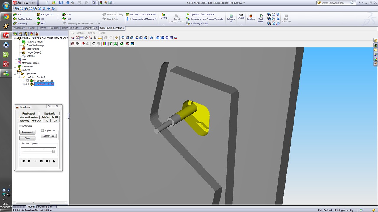

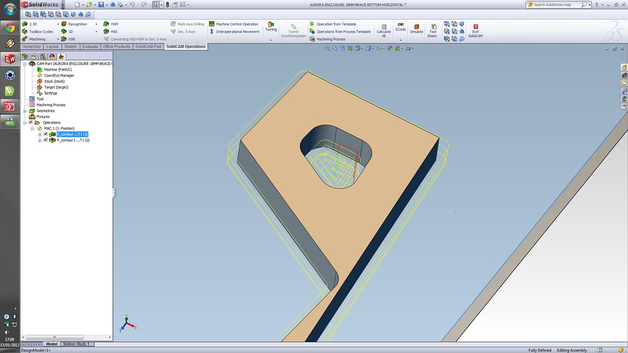

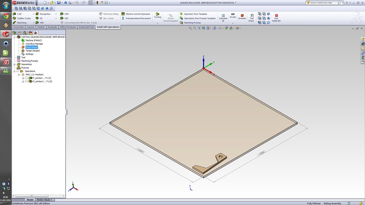

Ha! Progress...
It was a lazy Sunday with nothing doing so I've spent the best part of the day looking at tutorials around the web and playing within SolidCAM.
Slowly but surely I'm getting the basics down and so far I've managed to:
Not a particularly long list but it'll cover around ~70% of the parts made by the machine. The other 30% require some 3D trickery and other operations.
Some shots of SolidCAM in action:
Stock material and part
Tool paths
And simulation to verify
Tool paths
