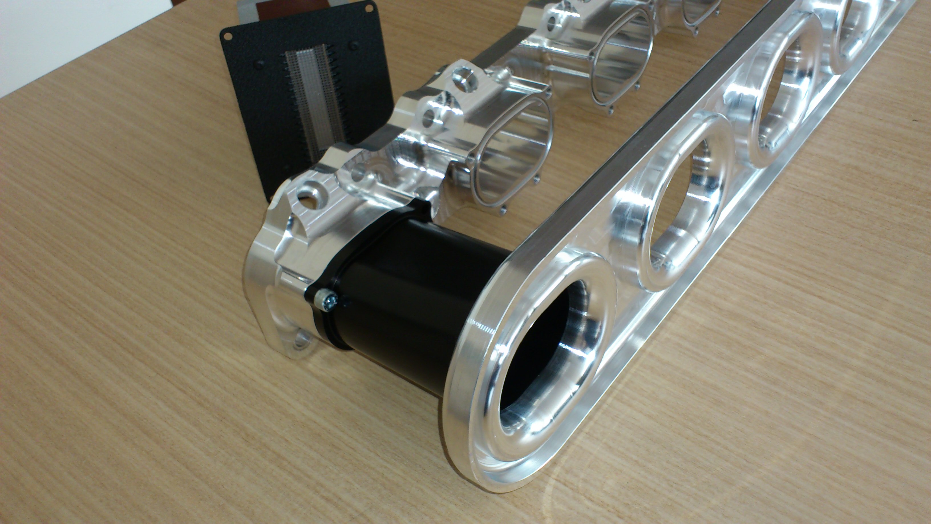

Read this at work and thought I should take a vid of what I was doing today. 32mm drill, 650mm/min feed at 3200rpm in aluminium 😀
32mm drill 650 feed 3200 rpm - YouTube
Now that really does make mine look like a toy!
Nice video, can I ask what it is your machining there?
Part of an after market intake manifold for a car.
Edit: here's a pic of one finished and annodised black. 70-10 there to keep it on topic 😉

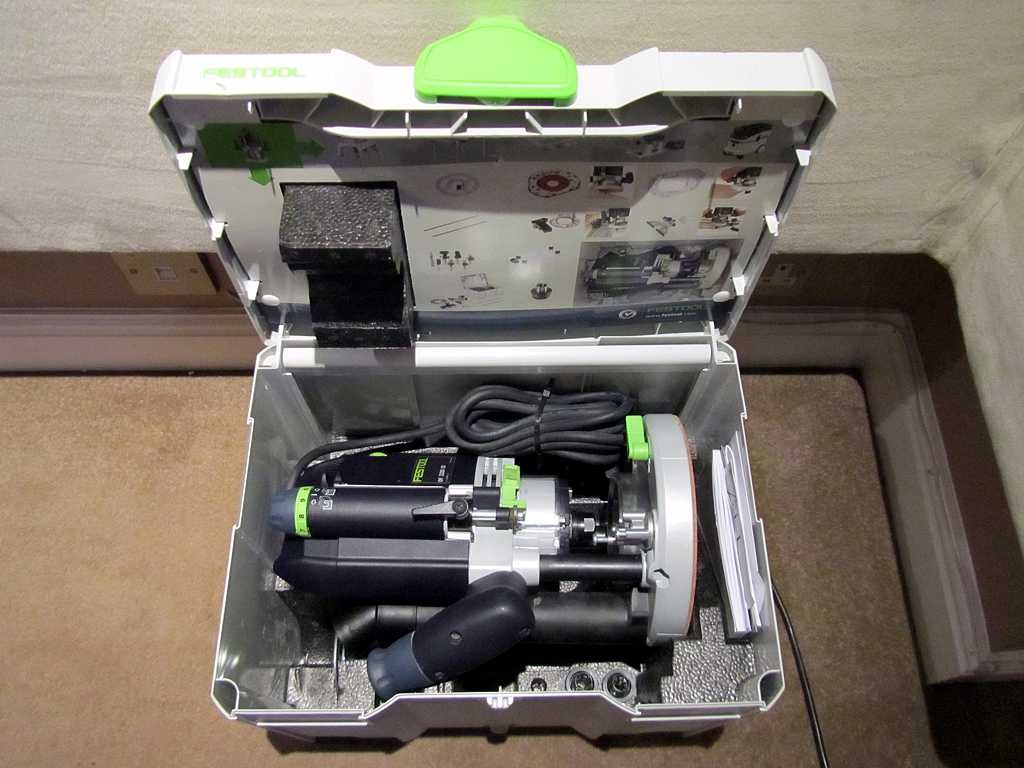

In the meantime I got a replacement Festool OF2200 after the old one mysterious went belly up and refused to work. Rare for Festools to go faulty like that but I'm really impressed with Festools after care service. Its the first time I've dealt with their service department but within a period of two weeks they'd arranged to pick the faulty router up, tested it and replaced with a new one.
However I'm not sure just how much I'll be using it now with the cnc machine. I can imagine there are still uses like bevel or roundover details on fully constructed cabinets that are impossible to fit under the gantry of the cnc but its a bit overkill for that task and a smaller machine would be fine.
Gotta decide whether to downgrade before using so I can still sell it 'as new'.
Yeah, I still use one of my routers as you mention - round overs mostly, but it's typically only for things that aren't complicated enough to warrant doing on the cnc or that it's a lot easier to do after parts are assembled. But I do almost everything on my cnc now. Where as before I would have made something round and cut it with a circle cutting jig on my router, now I make it an ellipse (or whatever) and cut it on the cnc just as easily as if it was round.
