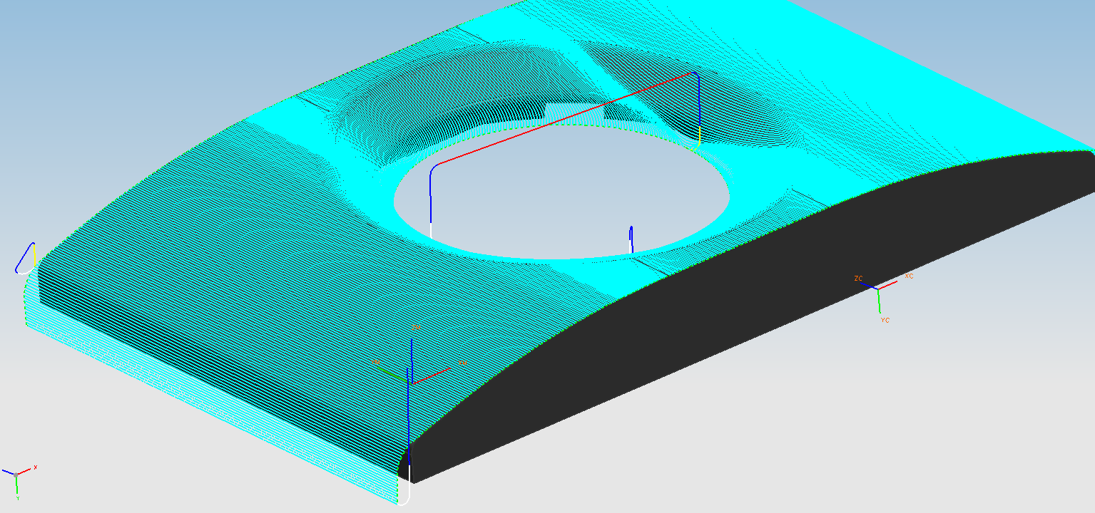

I really do like SolidCAM. I've been messing around with 3D milling and it seems very easy to use. In fact its so easy that I feel like I'm cheating and it should be much harder! Maybe I'm doing something wrong but it seems as simple as defining your model and then selecting the working area within that model and afterwards picking the type of operation you'd like to do on the working area ie. roughing out material or finishing. After that you click ok and it calculates all the toolpaths.
Couple of things I'm not sure about is the step over rate and tool type to get the best finish.
For the step down on roughing I'm using a contour pattern with a 5mm step down and a straight cutter. And for finishing I'm using a linear pattern with a 0.5mm step over and bull nose cutter. Is this even remotely correct? I came to those value with 'educated' guesswork aka. I didn't have a clue at the time 😛

50% stepover for roughing.
Tweak it to get about 0.5-1mm stepover for finishing a 3D part, and use as big a tool as you can.
Or you might be able to specify a scallop height - say 0.2mm, and have it work out the stepover.
Really it's about time. 3-4 hours per part (with maybe 3 or 4 programs and 2 setups) is my limit. If it can estimate time, use that as a guide (it won't be totally correct as Mach3 will accel and decel the tool in a way the CAM doesn't know).
So yes, you are pretty close.

Thanks Mark,
Something does worry me though. The program does indeed attempt to estimate cut time and to do the whole baffle its telling me 349:38:54!
Its so slow I though I was reading 349 minutes but nope its definitely hours as the last two only count up to 60. So 349 hours is a bit excessive I think. I'm probably using too small a step over value (1mm would be twice as fast) but I've also noticed the feed rate indicator is kinda stuck at 100 when roughing and 33 when finishing. I'm working metric so 100mm/min and 33mm/min are extremely slow. However I still haven't found how to up these speeds with SolidCAM.

In this video at about 1:00 there is a page showing feedrate:
SolidCAM HSM Example1 Rough Cutting - YouTube
Is that the same as the version you are using?

I figured out the feedrates and now have machine times for the baffle down to approx 7hrs with a 2000mm/min feedrate. I have the Solidworks Xpress 2011 trial version and it looks identical to that although some features are disabled as this is a slimmed down version of the full program.

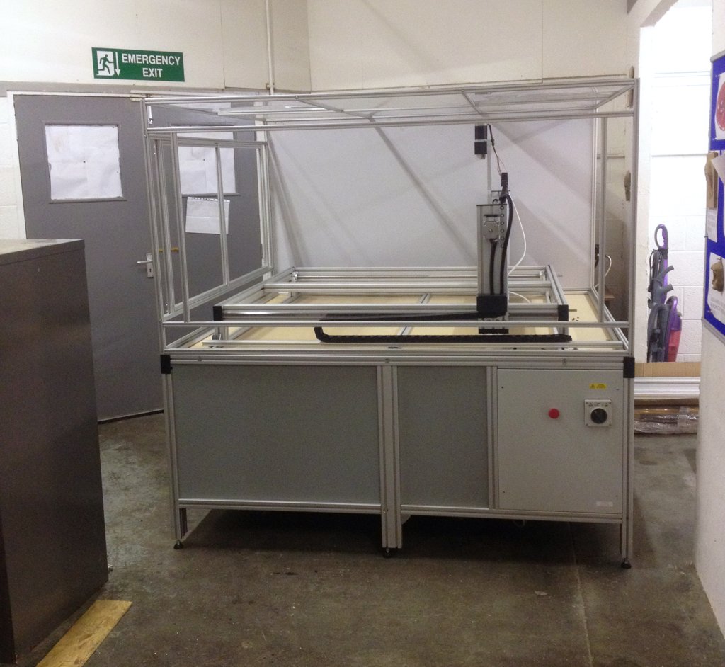

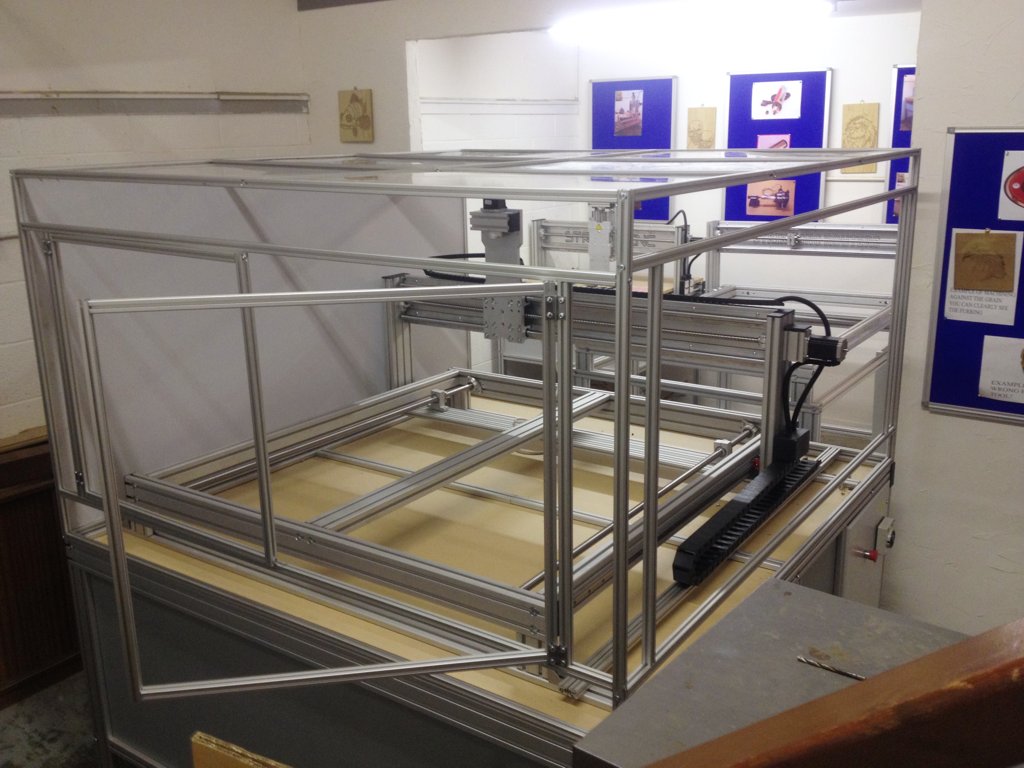

Michael over at Strike sent me a couple of nice images of my work-in-progress machine. The Z axis still needs finishing and lots of small jobs here and there as well as testing but its starting to take shape now. Should be finished within 2 weeks.
I've added on upgraded controllers and dual power supplies in addition to the hiwin rails on the Y axis too.
Getting excited now!
What's the max feed rate and spindle speed? I would think you could feed quite a bit faster than that especially when finishing.
I set 2000mm/min as a conservative figure, at least when starting until I get a feel for what the machine is comfortable with.
The figures I have as absolute maximums (although you'd generally run below these was the impression I got) are as follow:
5000mm/min feed for 10mm DOC with 10mm dia end mill.
7000mm/min feed for finishing
12000mm/min traverse
I'm unsure about spindle speed as all I know is the rpm range; 5000-28000

I'd definitely try 7000mm/min at some point after you've started to get comfortable with the machine if the manufacturer says it can do it. A real industrial router might cut at 25kmm/min or faster, just for reference. And it might be doing that with a 12mm bit going full depth through 19mm plywood. You can find some fun videos of things like that on youtube.
Start slow and work your way up.

Machine looking good. Ah, I see they're using a pair of ball screws down (what I would consider) the X axis. Nice.
Big machine. Big enclosure! Doubt I'd fit that in my garage, sadly.

On a router the base axis is the Y axis - the gantry. The X axis moves across the gantry.
It's because the operator normally sits/stands facing the router/spindle head for good access/visibility (rather than at the side with the gantry right leg in front of you).
On a router the base axis is what you set it up to be 🙂
When I set up my machine, the general advice I was given was that the longest axis is often configured as X. On my machine the travel across the gantry is ~25", and the travel of the gantry along the machine is ~39". As the only space I had for the machine in my garage has me standing with the 39" axis going left/right, that became X.
Obviously with a square machine like Ant's it doesn't really matter. The fact it looks like the access into the enclosure is from the front, then yes, I'd agree that in this instance it would make much more sense for travel across the gantry to be X, and travel of the gantry to be Y.
