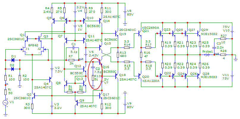

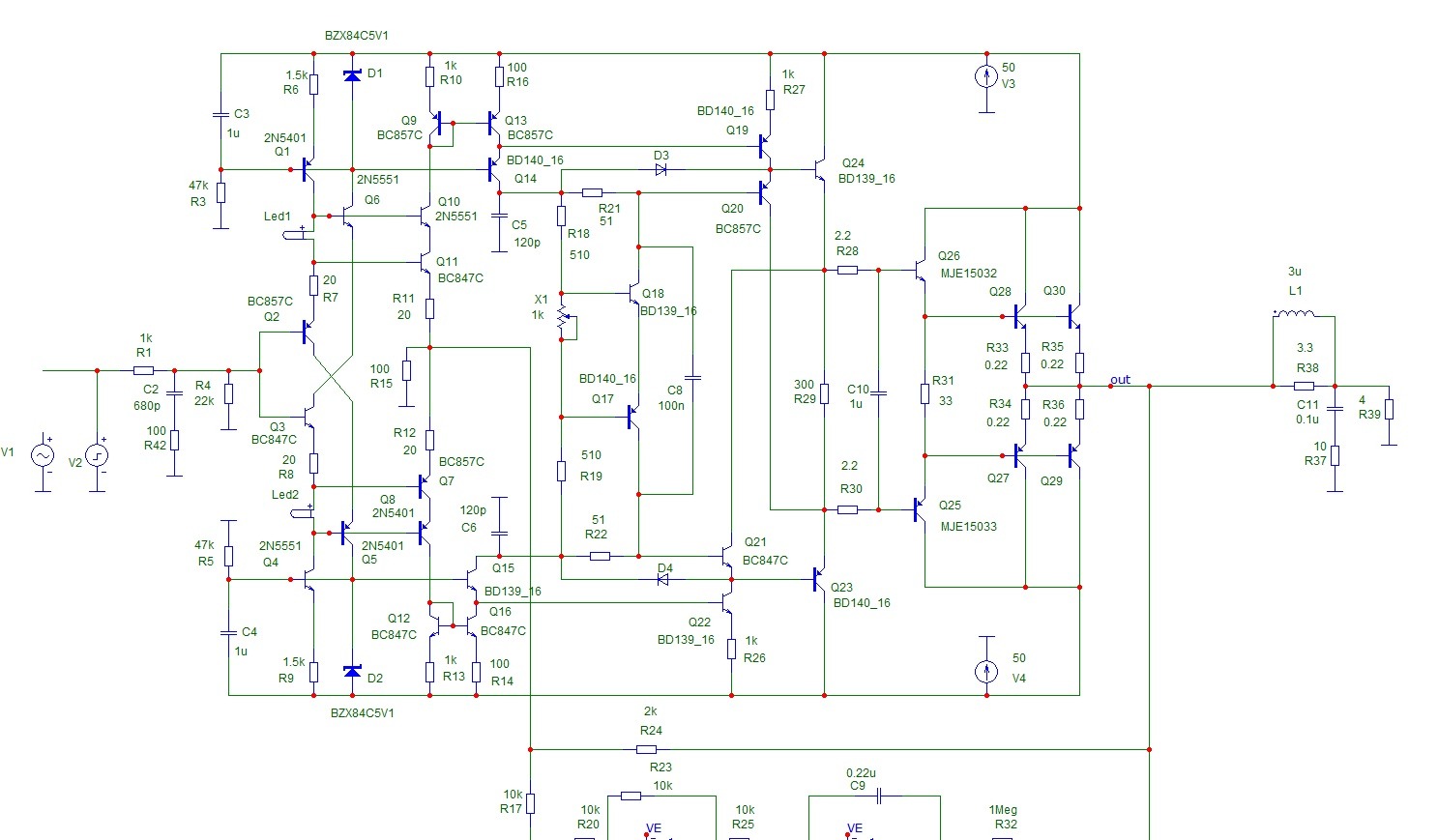

Well, if you had at least a little understanding of electronics, you would be able to adjust the frequency correction according to your transistor models.
Instead, a Probe1 split the high-inductance, high-capacitance feedback to the generator.
And then see the true frequency response of the amplifier without feedback.
Idiot experimental setups lead to idiotic results.
Probe1 should not be between the output of the amplifier and the load.
It should be in series only on the feedback R7C1

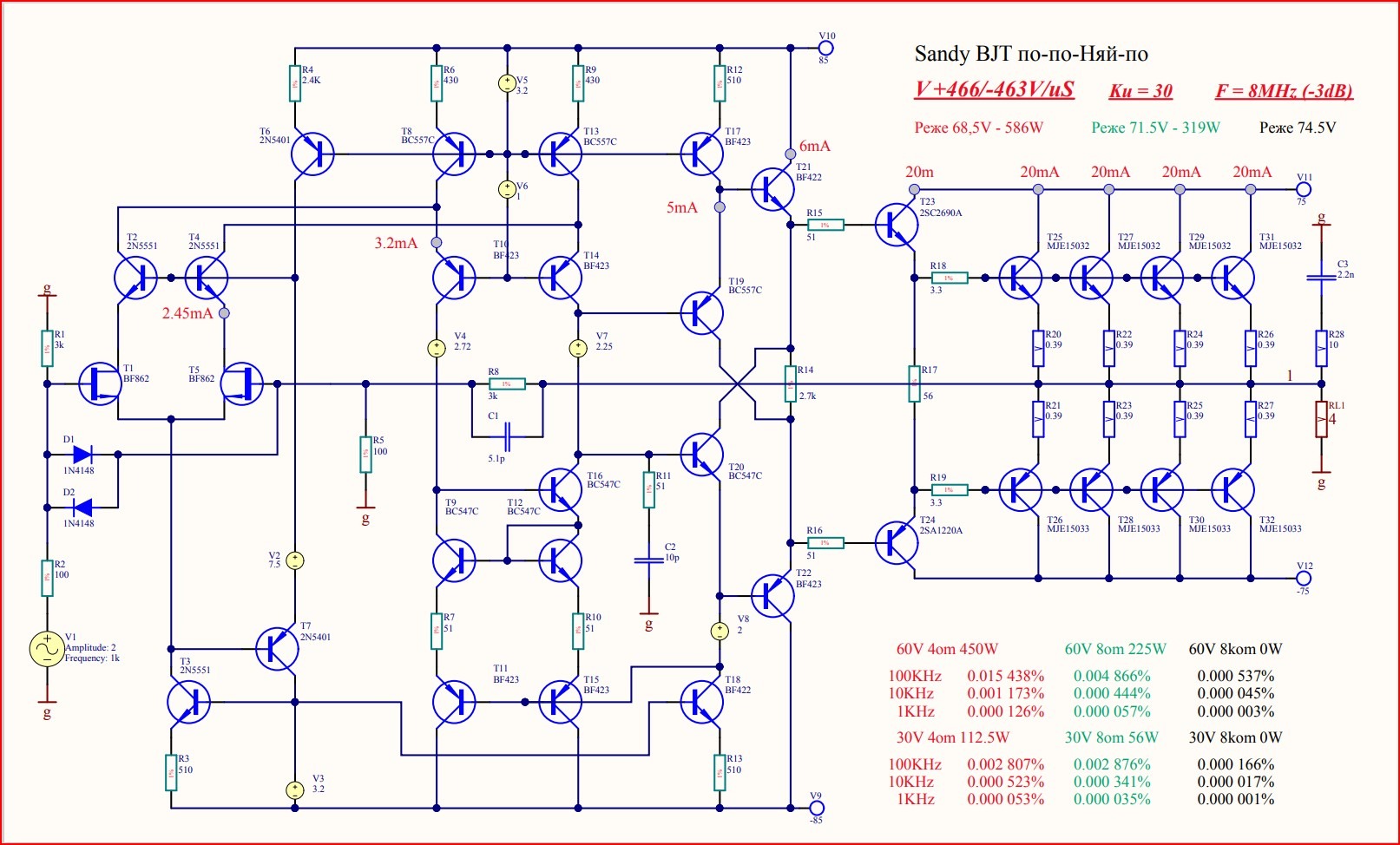

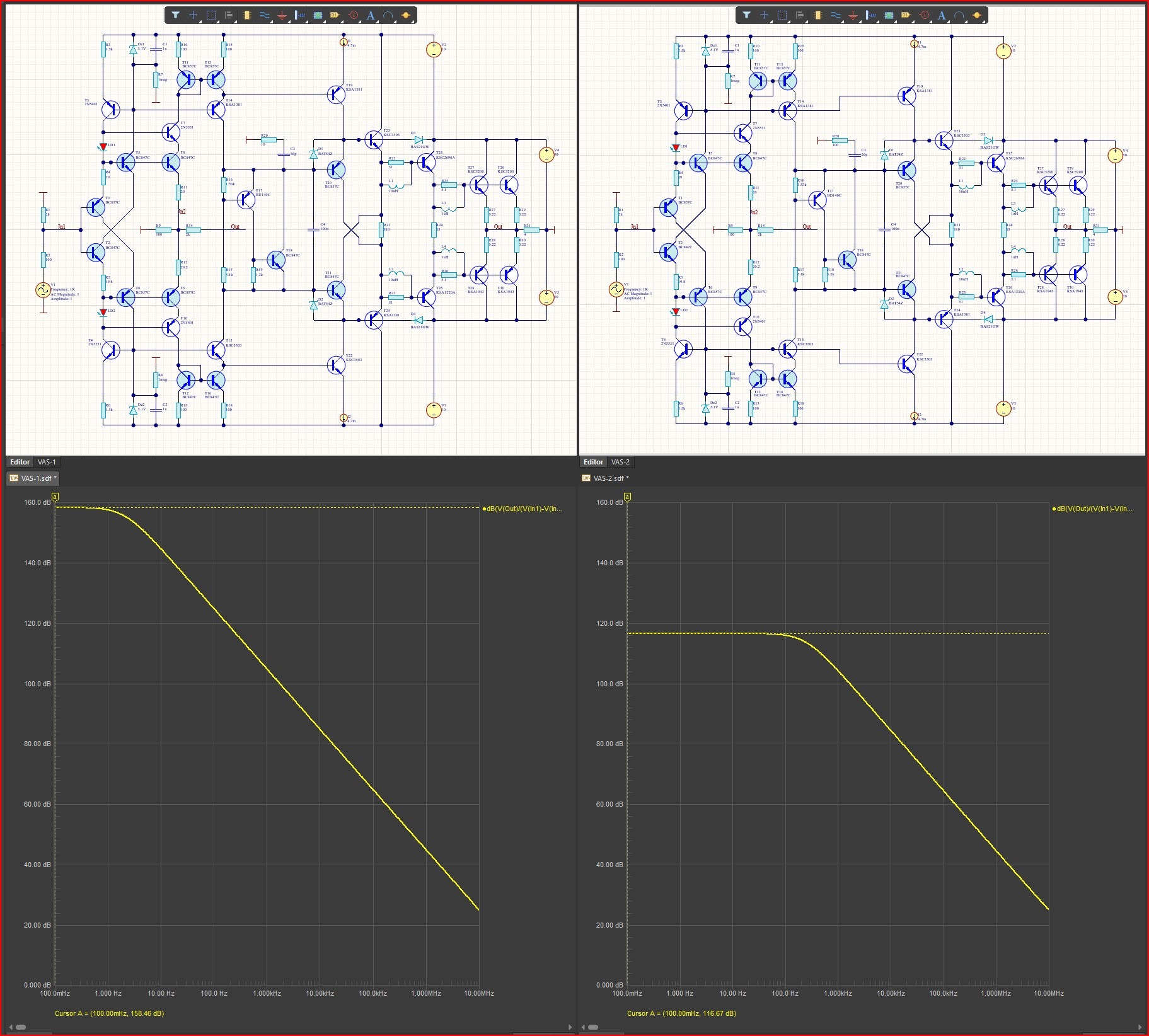

A characteristic feature of Apex A40 is the use of compensation of h22b and Сcb of transistors in VAS.
This allows a further large reduction of THD occurring in the output of the VAS.
In my version, such compensation is also used, but it is done by a different method.
Here I show you the difference VAS1 is compensated and therefore has an additional gain of 120 times.
VAS2 is without such compensation the bases of T19/T20 are connected to the zener diodes.
Sandy and Hennady, you can prove to each other for a long time which of you is right.Probe1 should not be between the output of the amplifier and the load.

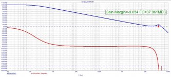

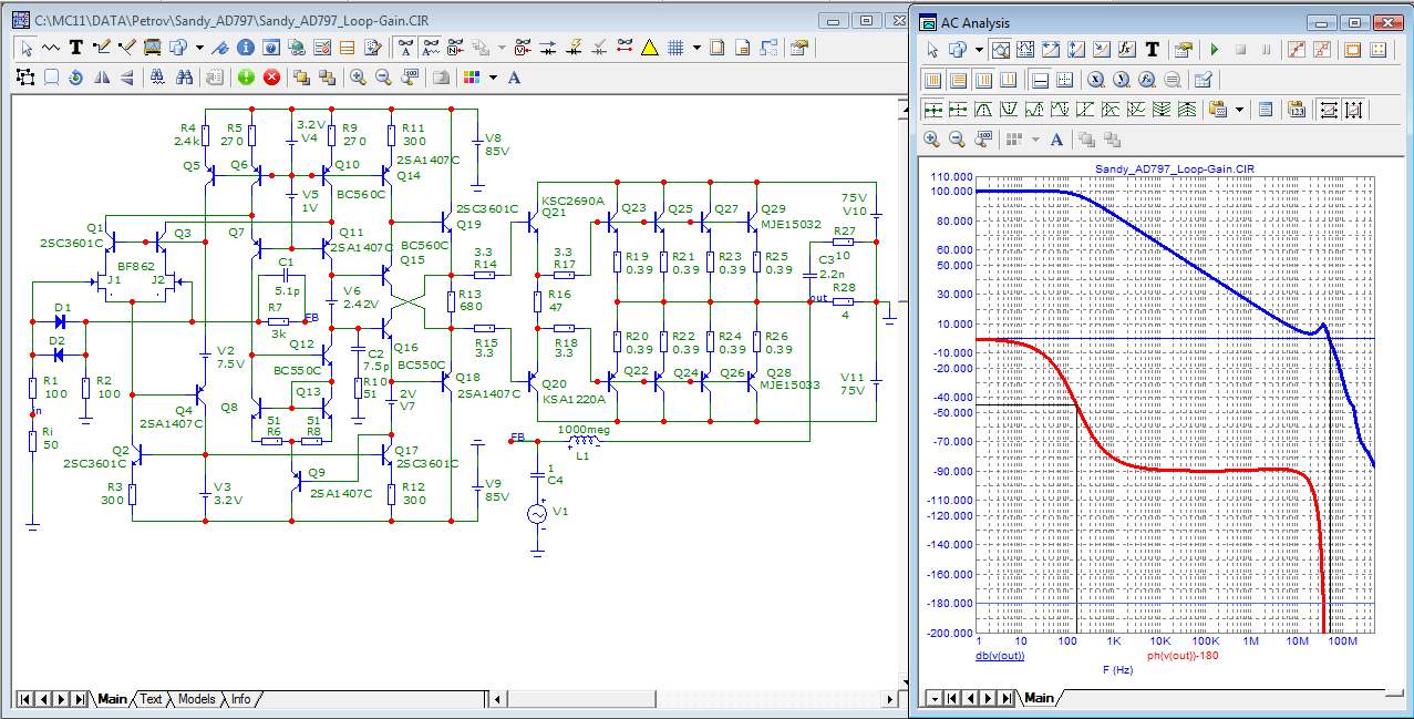

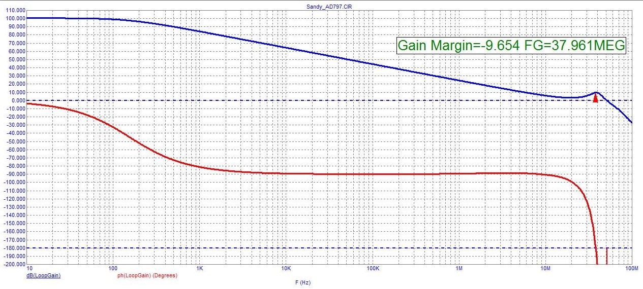

Sandy, regarding loop gain measurements using the old-fashioned method.
Even the old-fashioned method does not save the day! As you can see, the result is the same.
Use corrected models, not those in simulators.
There is no dispute. When using models from Cordell in my version of the mod, it is only necessary to exclude the 22pF capacitance that shunts the 1 kΩ input resistor. Everything else remains the same, at least for me...and diodes D3D4 must be transferred to the collectors of the transistors of the voltage amplifier.
The fact that you don't know and can't do the frequency correction according to your models is your problem!!

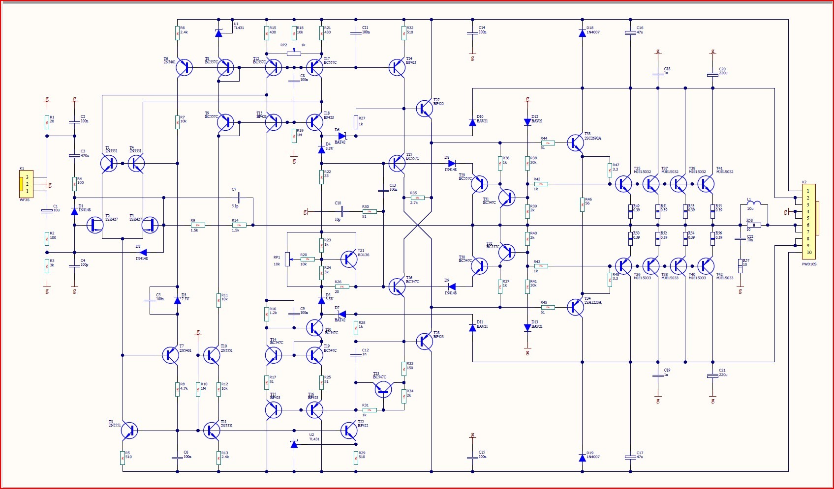

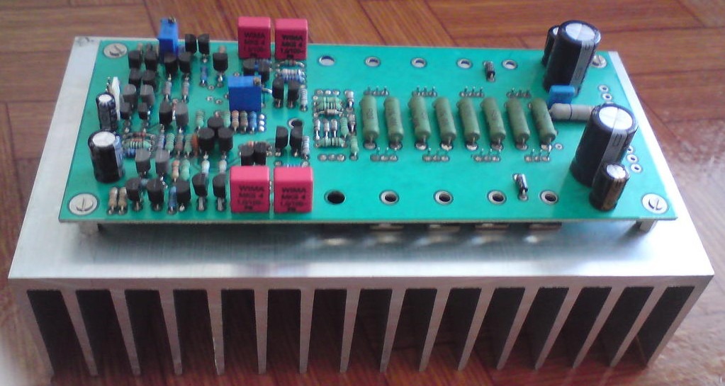

Here is the same circuit with other BF420/BF423 transistors (Audio-PA-4xMJE1532 sim)
Here is the working one and not one for simulation (PA-4xMJE1532)
And whether it works can be seen by doing it live.
And if it works live and in the simulator of a prodigy it doesn't work, the problem is with the prodigy.
Naturally with MJE15032 and 75V power supply it cannot give 450W because it will overheat.
Live it should run at 8 ohms when powered.
But there is such a simulation to see the capabilities of the scheme itself.

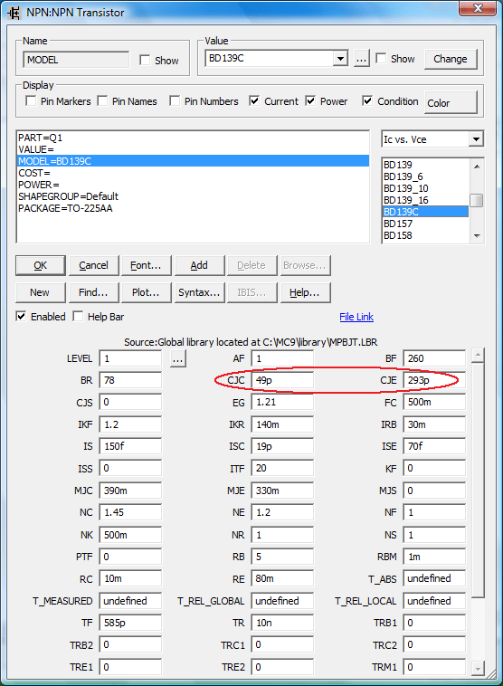

Here is the BD139/BD140 model provided by the company that manufactures it.
One time I was stupid and took transistor models from this forum.
. МОДЕЛ BD139C NPN (
. МОДЕЛ BD140C PNP (
- IS=150e-15 BF=260 VAF=99 IKF=1.2 ISE=70e-15 NE=1.2 NF=1.0
- RB=5 RC=0.01 RE=0.08 CJE=293e-12 MJE=0.33 VJE=0.67 CJC=49e-12
- MJC=0,39 VJC=0,52 FC=0,5 TF=585e-12 XTF=10000 VTF=35 ITF=20
- TR=10e-9 BR=78 IKR=0.14 EG=1.21 XTB=1.14 XTI=3 NC=1.45
- ISC=19e-12 NR=1.0 VAR=7.5 IRB=0.03 RBM=0.001 XCJC=0.53 )
- IS=120e-15 BF=113 VAF=140 IKF=1,5 ISE=1000e-15 NE=1,5 NF=1 RB=5
- RC=0,01 RE=0,1 CJE=220e-12 MJE=0,35 VJE=0,7 CJC=68e-12 MJC=0,35
- VJC=0,6 XCJC=0,5 FC=0,5 TF=320e-12 XTF=10000 VTF=35 ITF=20
- TR=100e-9 BR=25 IKR=0,1 EG=1,2 XTB=1,5 XTI=3 NC=1,4 ISC=7e-12
- NR=1.0 VAR=8 IRB=0.01 RBM=0.01 )

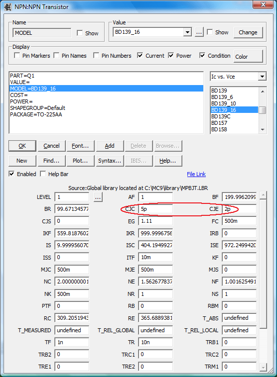

This is exactly the same to Cordell models used by most here with LTspice.Here is the BD139/BD140 model provided by the company that manufactures it.

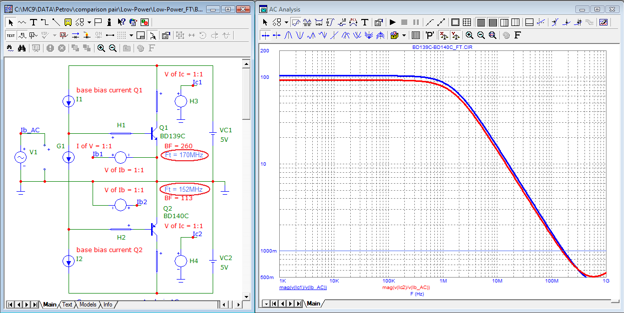

I once had a problem with models taken from this forum.
The simulation of the growth rate came out 5 times greater than the one calculated on paper.
And I immediately checked the models of the transistors in the VAS, they turned out to have no capacities at all.
That's why I no longer use models taken from audio constructors announced here as great.

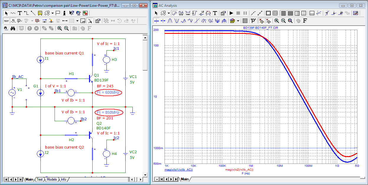

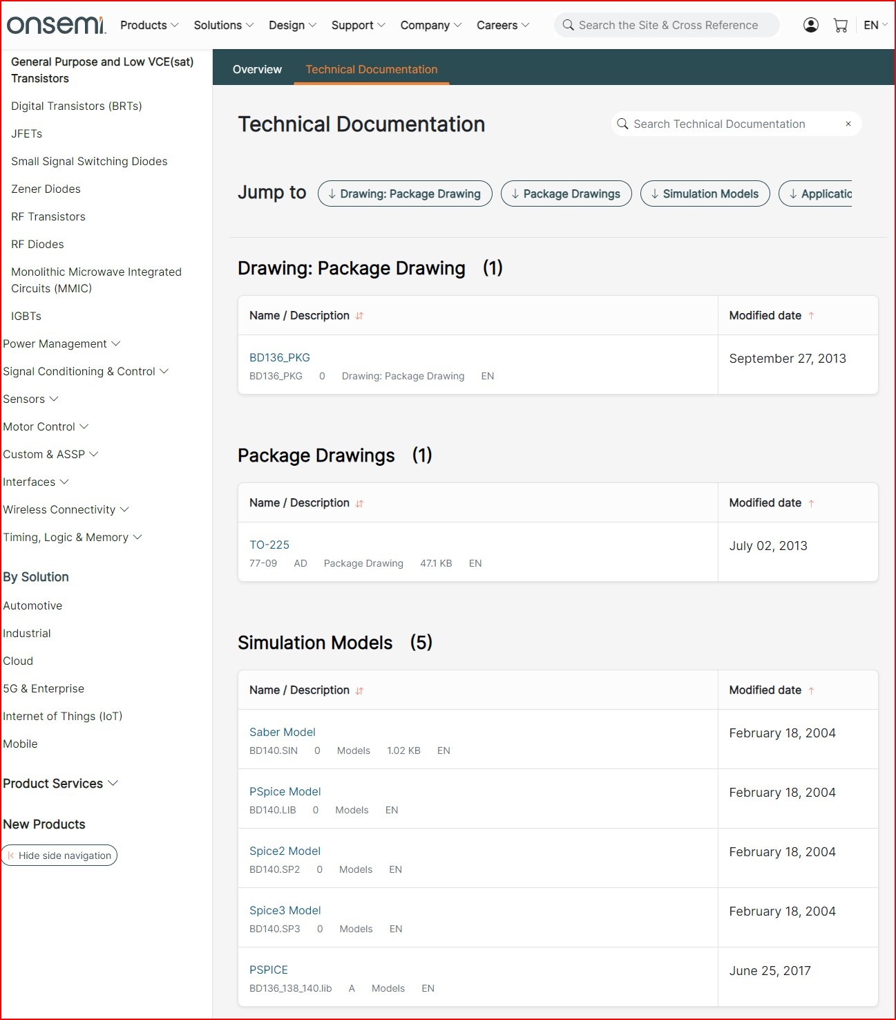

Sandi, show the manufacturer's document from which you took these models with the "C" index. You don't even know that these are Bob Cordell models.Here is the BD139/BD140 model provided by the company that manufactures it.
BD136-BD140
I can't remember where I got all the models from, and there are >1000 of them in my computer...!!!
But most of them have been tested and give satisfactory results.
Hmmm, one who gives no respect deserves no better. 🙁... And I'm not using Cordell's made-up models.
I use the latest models from the manufacturers of the element.
* BD135/137/139 NPN EPITAXIAL SILICON TRANSISTOR 2017
.MODEL BD135_137_139 NPN (
* BD136/138/140 PNP EPITAXIAL SILICON TRANSISTOR 2017
.MODEL BD136_BD138_BD140 PNP (
