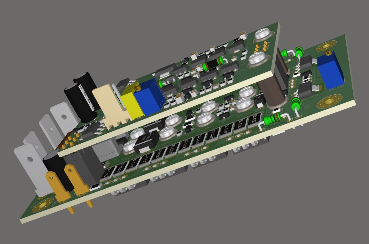

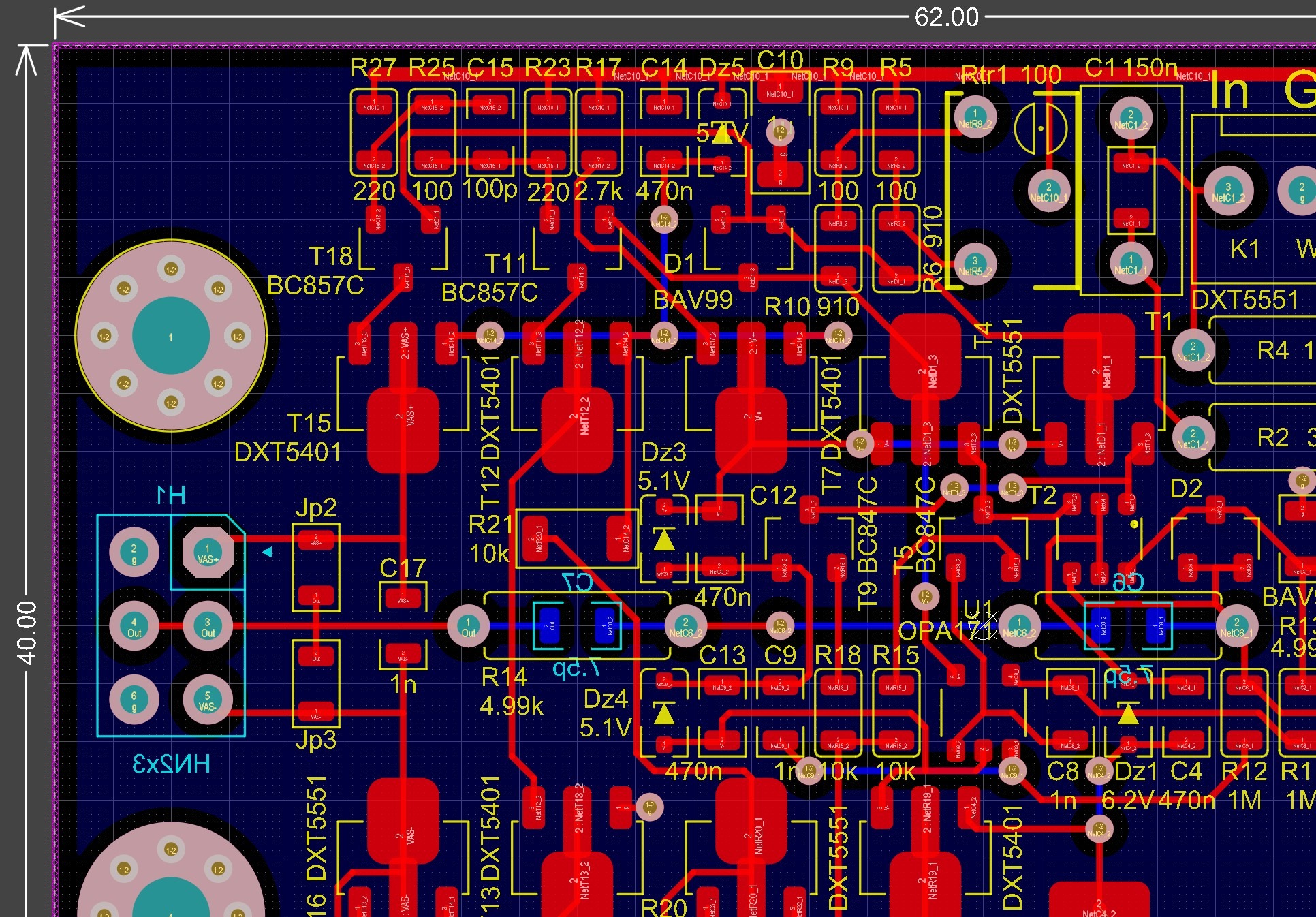

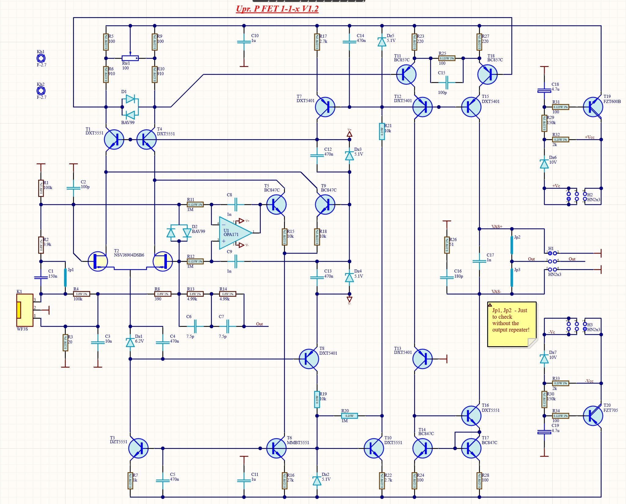

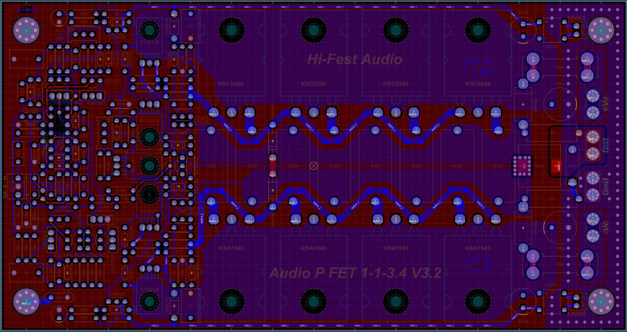

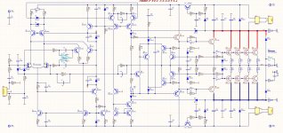

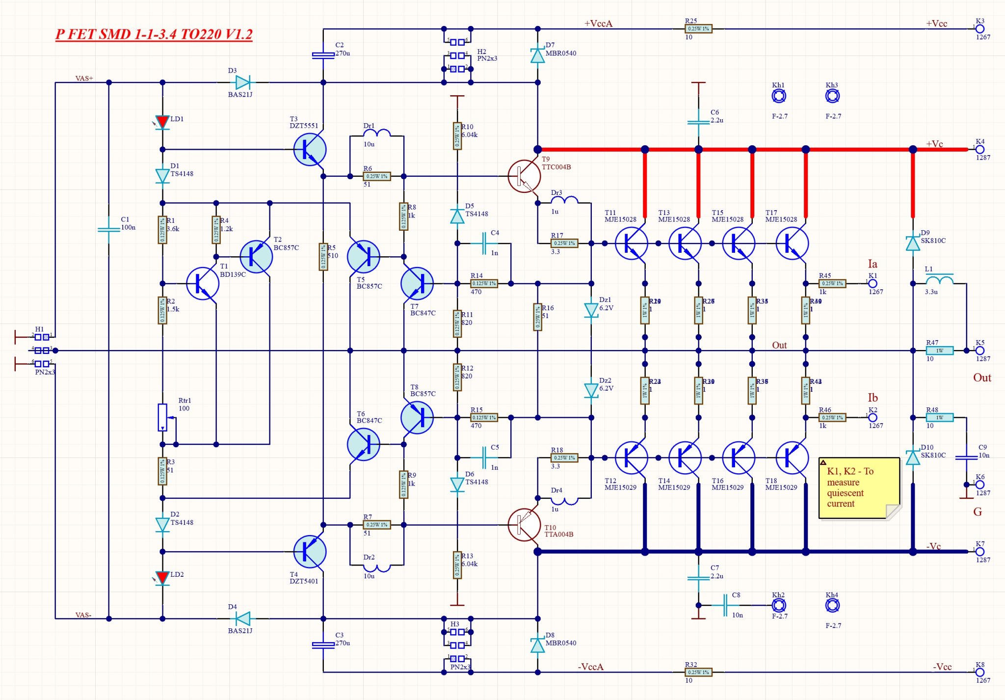

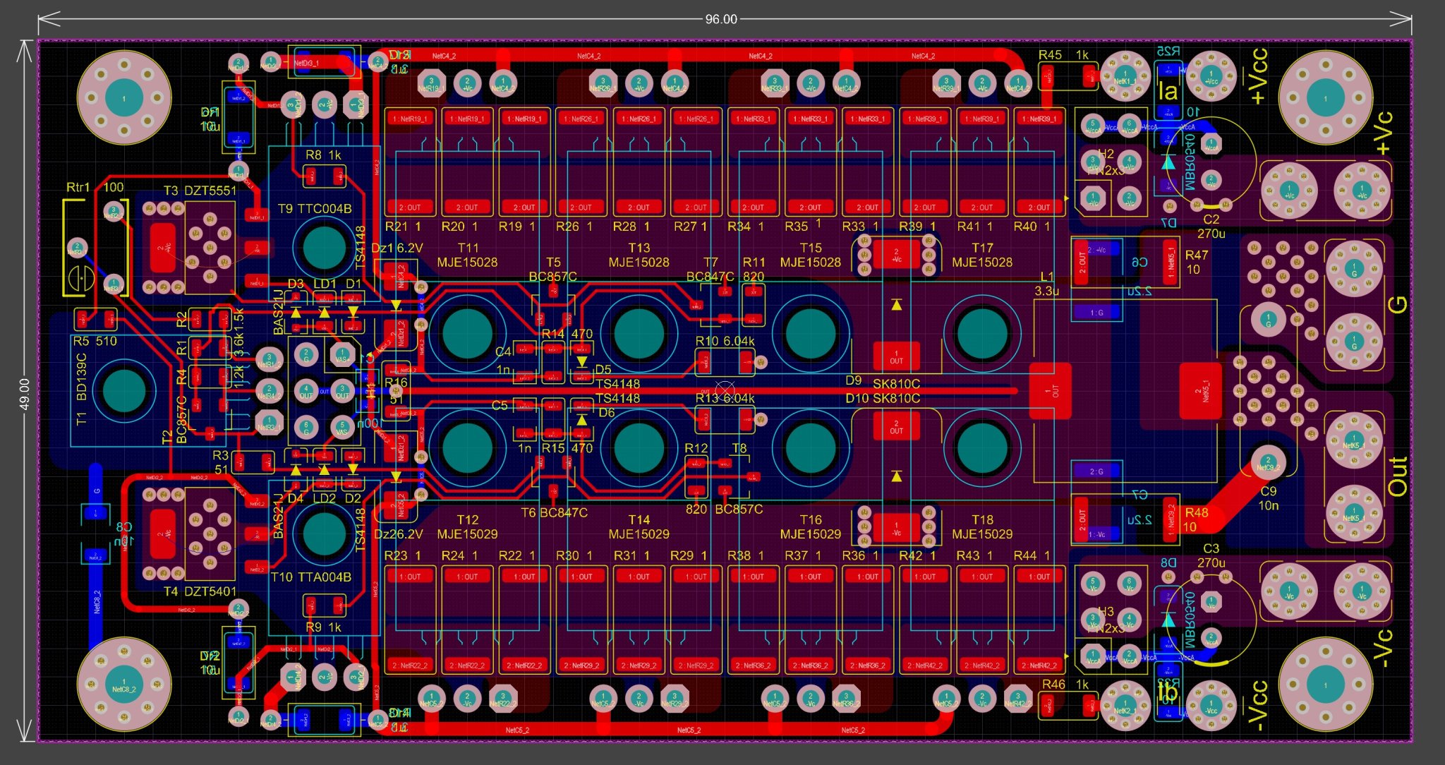

This is a more compact version of the same circuit (VFA) for lower power with 4 TO220 final transistors.

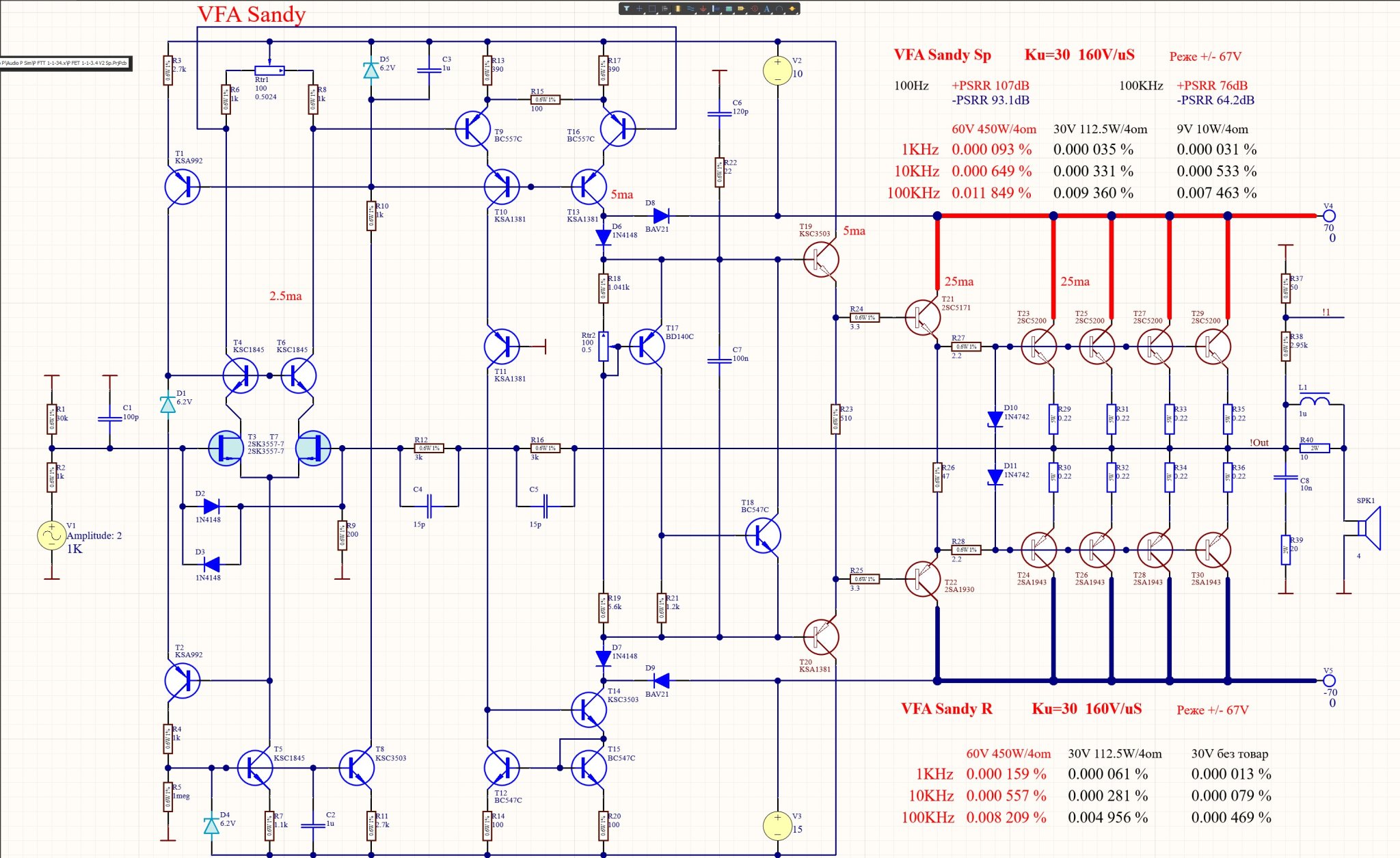

This is just your opinion, both type could be equally good or bad, depends on designer capability.I prefer VFA amplifiers for audio they are significantly better.
Of course a mediocre designer can make a worse than good CFA for an audio VFA amplifier.
But you cannot with the same number of transistors make a CFA amplifier better for audio than a VFA one.
And in order not to talk nonsense, propose your personal project of a CFA amplifier, and I will try to construct a VFA with better parameters and with the same number of transistors.
Or show a CFA amplifier with better parameters than the VFA shown here above, with approximately the same number of elements.
The only advantage of CFA amplifiers is the high rate of rise of the voltage, but this is only the case for strong signals.
But with VFA amplifiers, such (enough for audio) gain rates can also be achieved, and even for weak signals and not only for high-amplitude ones.
At the same time, the other important parameters: noise, THD, PSRR at VFA amplifiers are significantly better.

Hello, Sandy! I would like to try build one !! Do you share layout or shall ? #410

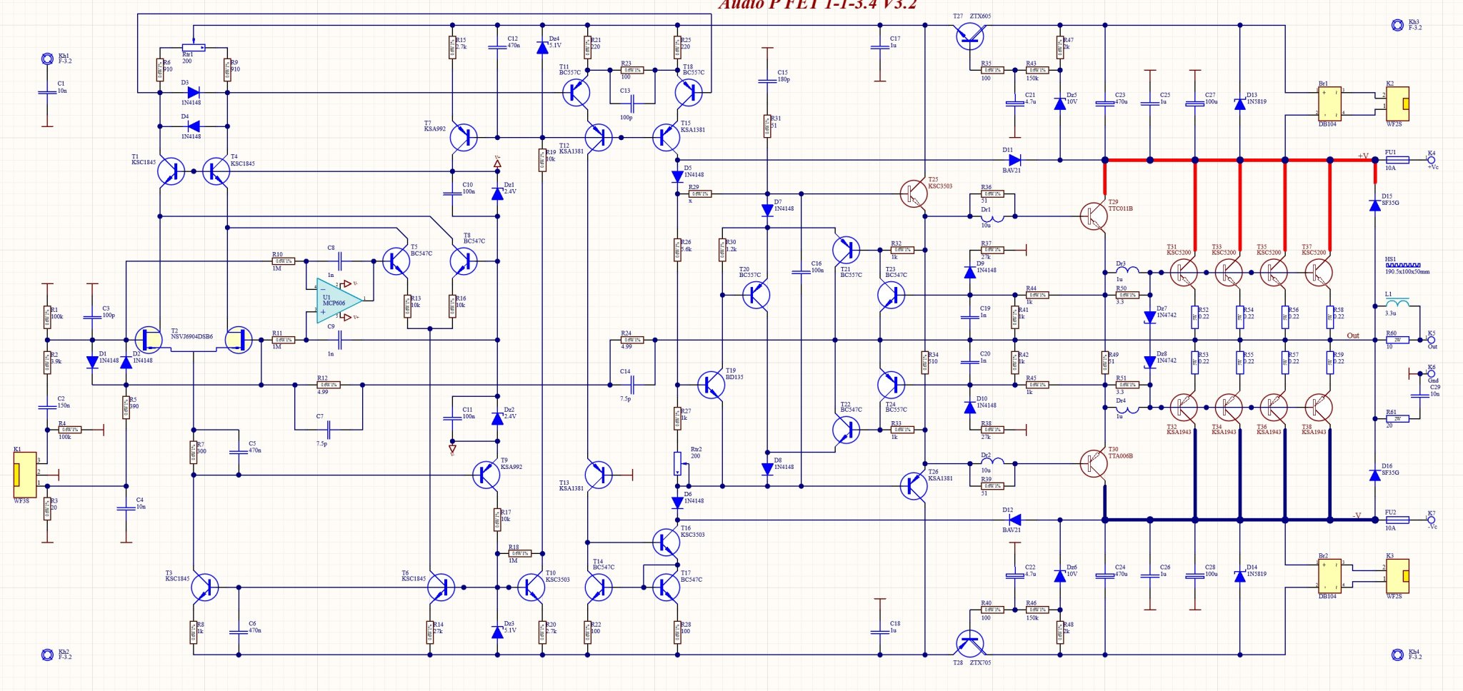

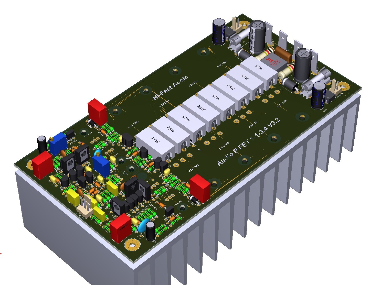

VFA P FET 1-1-3.4 V3.3
I recommend this fully finished project.
Its data is not worse than the one you are referring to, but it is easier to implement because it does not have complex positive feedback links.
