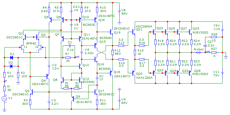

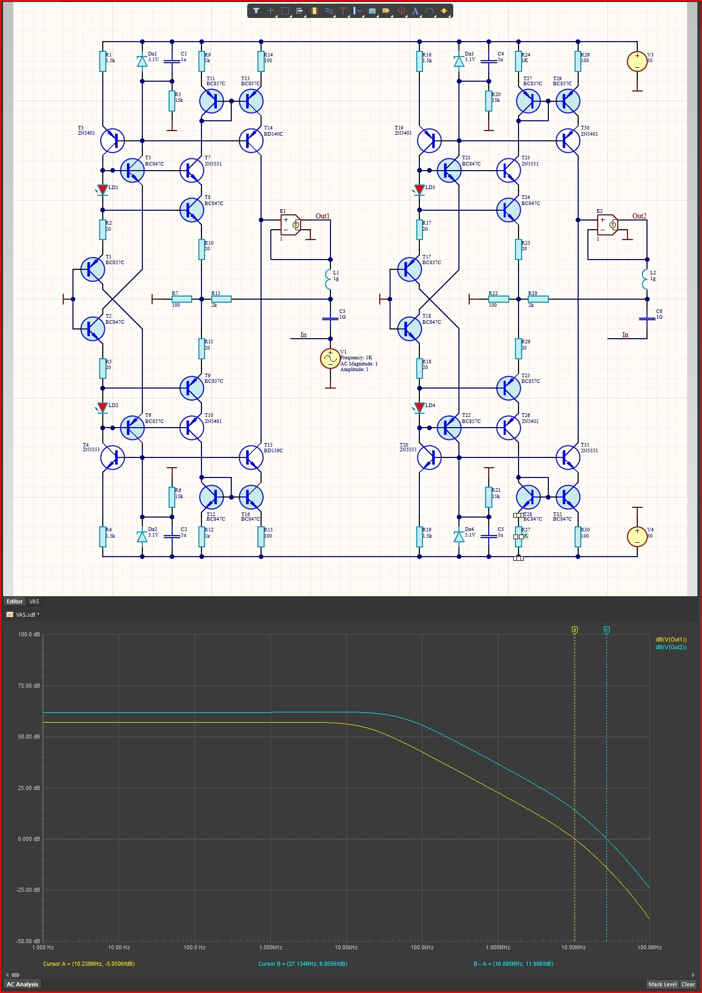

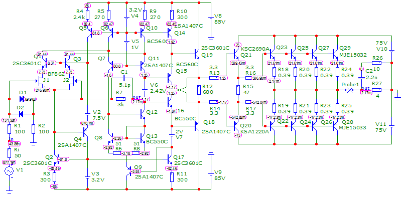

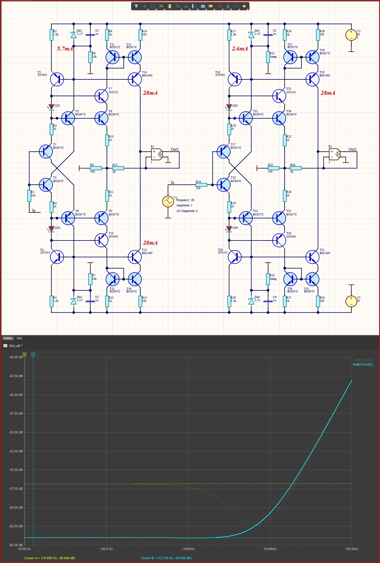

modified Sandy's circuit for +/-50 volt supply voltage, 200 watt output power into 4 ohm load.
what was done?
1. increased current to 5.6mA through zener diodes
2. Increased input stage gain from -3dB to 12dB
3. Gain is reduced to 26dB, because supply voltage only +/-50 volts
4. applied progressive correction at the input of the amplifier and increased the current through the main stage of the voltage amplifier
5. Malcolm's scheme was used to improve thermal stabilization
6. To stabilize the operating point at the output, a servo circuit on a dual op-amp was used.
Distortion does not exceed 0.001% (1kHz) with a short spectrum at maximum output power.
and of course, it cannot boast of hundreds of volts of slew rate and a minimum delay group, but everything is stable, stable and, judging by the simulation data, it is quite suitable for repetition even in amateur conditions.

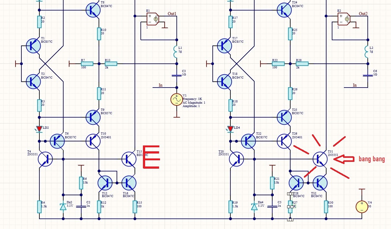

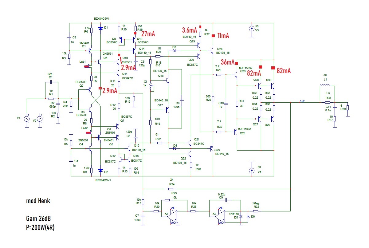

Why is your gain 10 between input and VAS ??
Why is your VAS current 27mA?
Gain 10 (R10/R16) makes 10 times the low frequency.
And it already takes 10 times as long as a large capacitor (C5/C6)
Using BD139/140 for 27mA current is a huge folly because of 10-20 times their large Ckb capacities.
The biggest distortions come from VAS and from the capacities Ckb they are varicaps !!!!
What is the point of Q19/Q22 being BD139/140.
There's more nonsense, but let's discuss those first.
Even if a person doesn't understand much about electronics and has never calculated anything on paper, he can at least compare 2 things easily in the simulator.

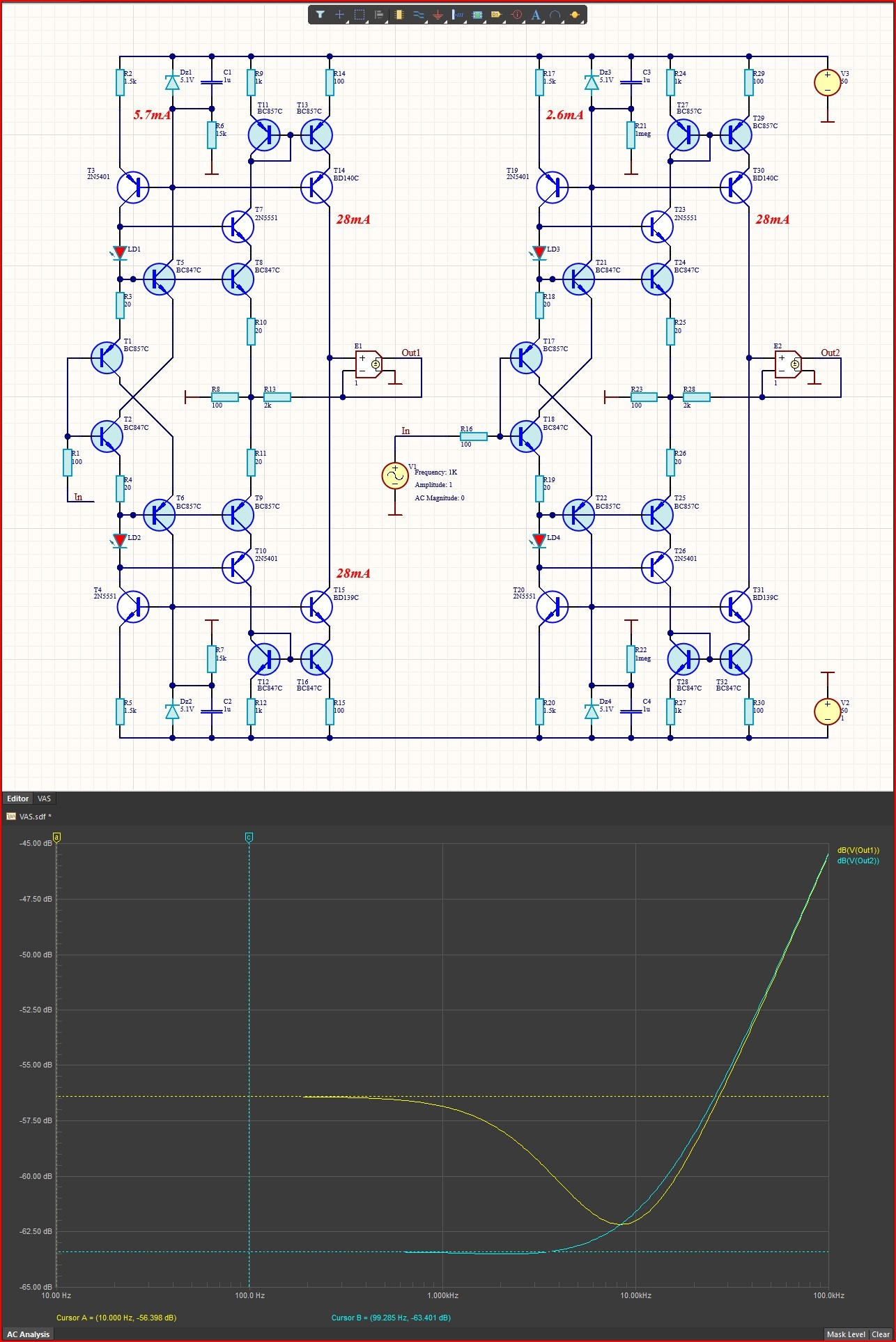

Here is the difference between the BD139/2N5551 used in the VAS
are you sure what you write?
can you calculate on a piece of paper the power that 2N5551 needs to dissipate?
and write here the maximum power dissipation 2N5551 Pкmax(т)!!!

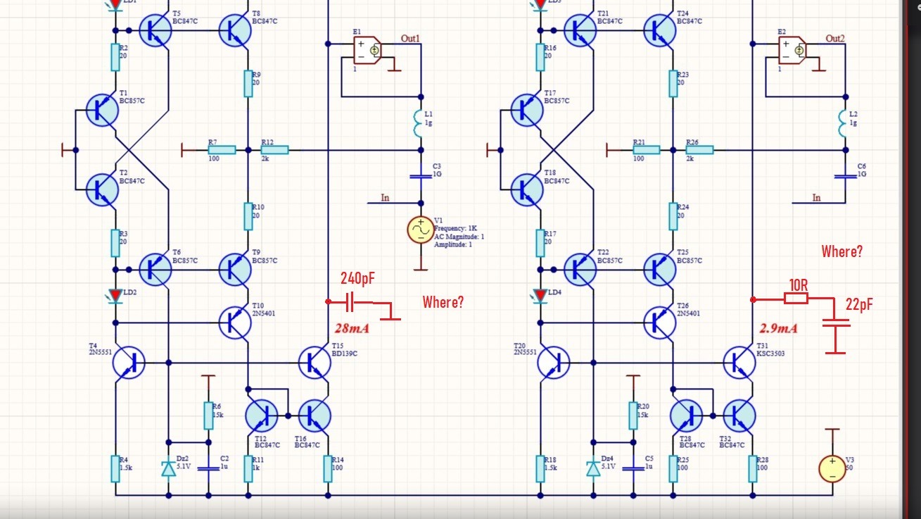

It was not by chance that I asked you what the current 27mA in VAS is for??
As your next stage, Q20/Q21 operates with a current of 3.6mA
I just wanted to show how the transistor capacitances affect.
There are enough transistors in the TO126 package for a current of 50-100mA with little Ckb.
But if we reduce the VAS current to 2.5-3mA, 2N5551/2N5401 become perfect for this place, or similar for current up to 100mA and with small powers.
You see I use KSA1381/KSC3503 precisely because of Pk although I use low current but voltage is high.
For your lower voltage there are even faster 2SA1538/2SC3953 Ft=400MHz
So are you happier with a TO126 case
Last picture VAS 2.9mA current!!
What is the benefit of high current ???

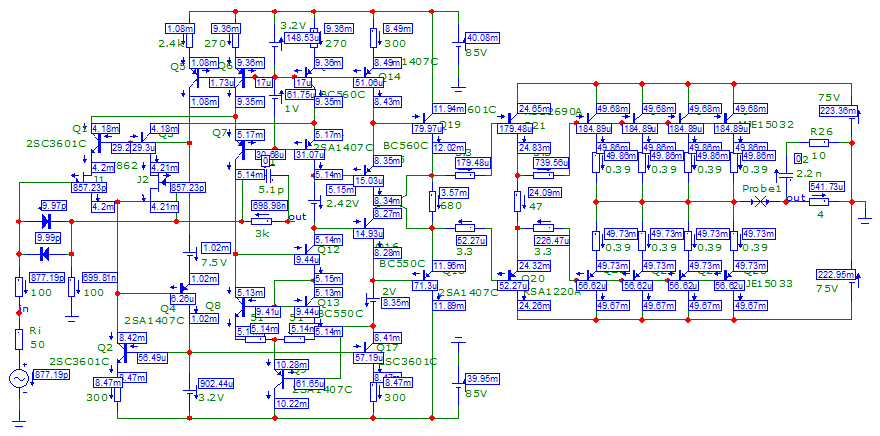

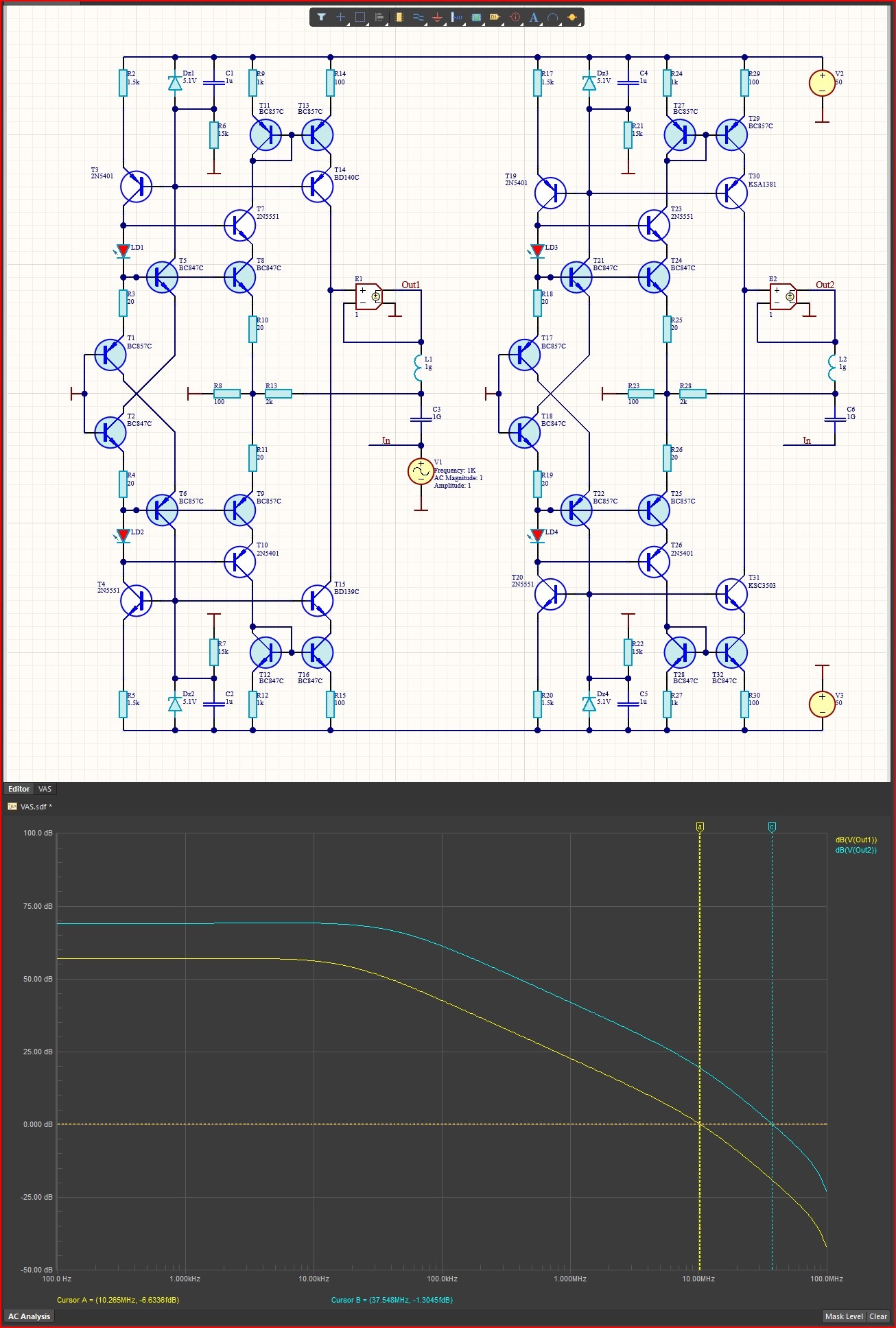

on the one hand, I received a linear gain of the input transistor according to the scheme with a common base Ku8 Ku10 equal to 12dB, on the other hand, the current was increased 10 times for the main driver transistor, which will easily pump the correction capacitors C5C6 and its parameters will not depend on changes in the differential resistance of the multiplier Malcolm on signal strength and temperature.
Оf course, the power dissipation increased and the 2N5551 / 5401 transistors were no longer suitable for the maximum power dissipation parameter.
Q19/Q22 also replaced by medium power transistors, because the current increased by 1.5 times.
this will require high-quality PCB layout.
P.S. Perhaps later it will be possible to increase the order of correction in order to raise the pole up in frequency.

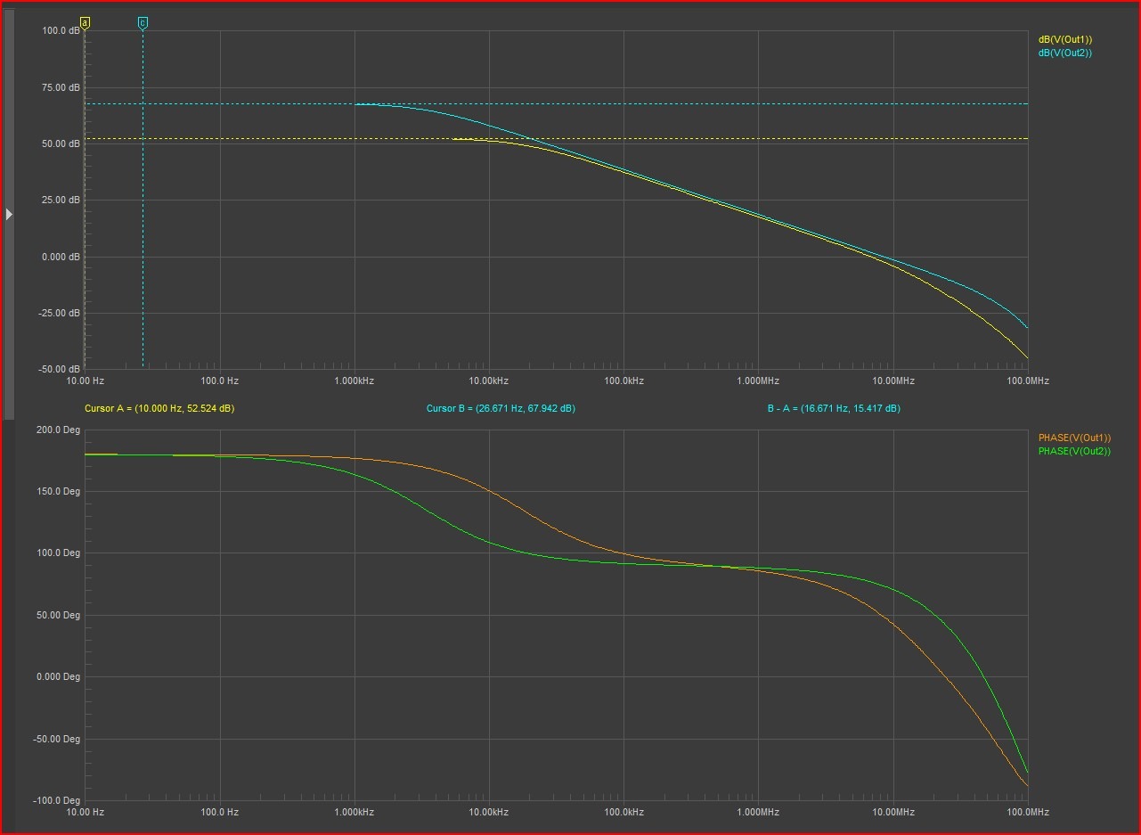

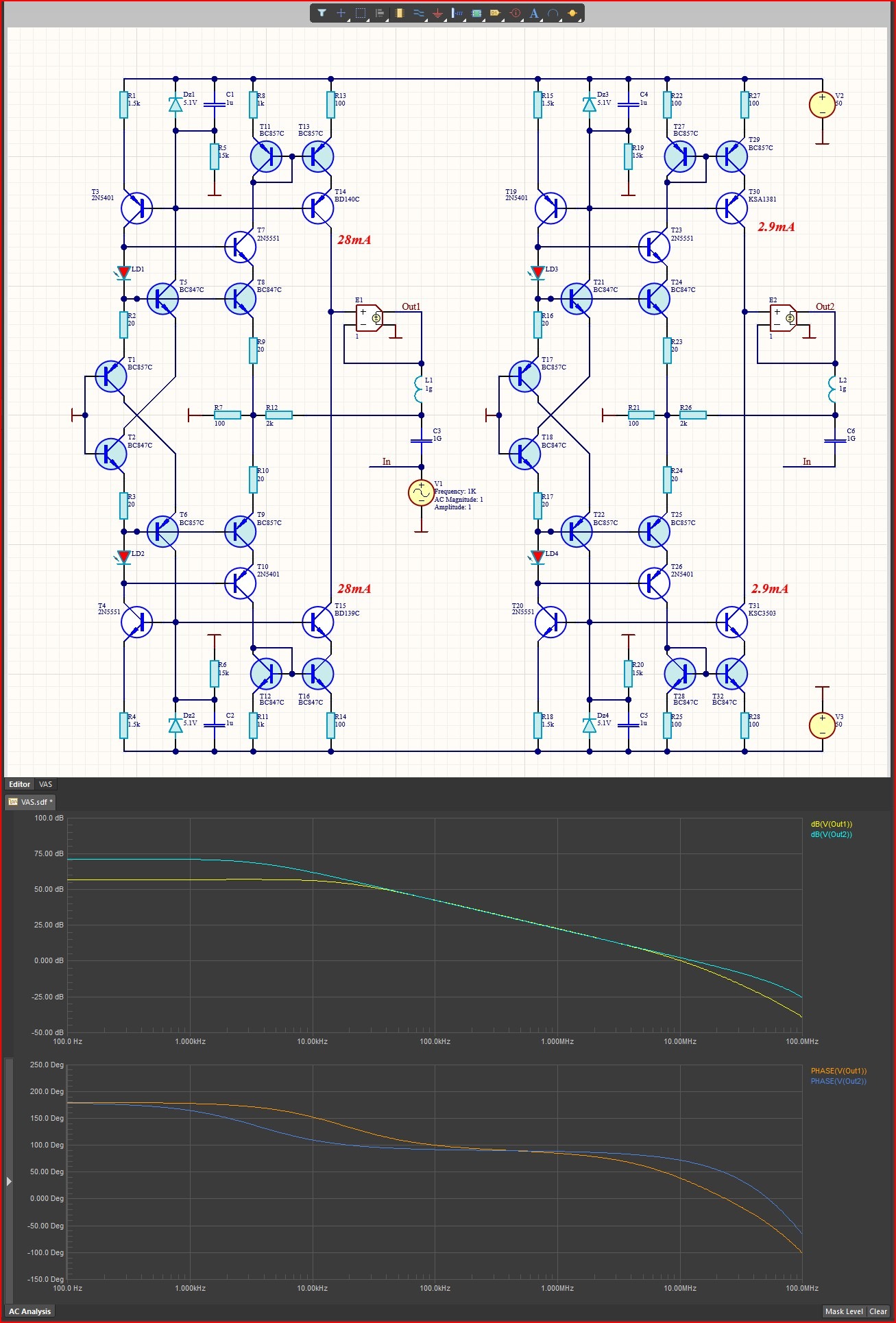

However, the results are the exact opposite of your reasoning!!
As we use a current mirror (Ku=1) and not a current amplifier with Ku=10.
We get 15.4dB of apparent gain for the low frequencies almost the same for 100KHz-1MHz and higher above 10MHz
And why this is so is simple.
At 10 times higher current the transistor has 10 times lower h22e. And on the powerful transistor there is also a larger Ckb which is the main load for the high frequencies.
In one place we amplify 10 times, but in another we reduce it more than 10 times and the result is the opposite.

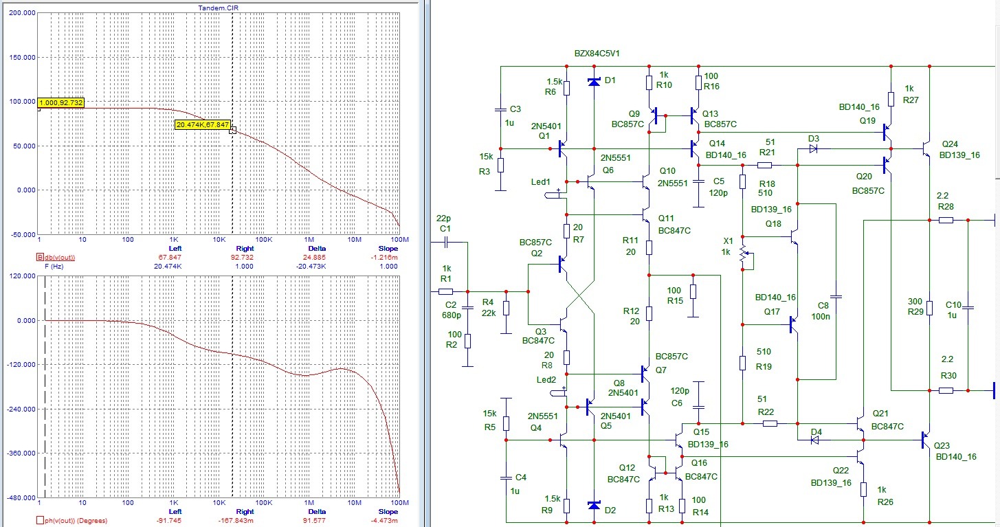

Sandy, what's wrong with the model again that it's inoperable? For good, it would not hurt to indicate at least a prototype.

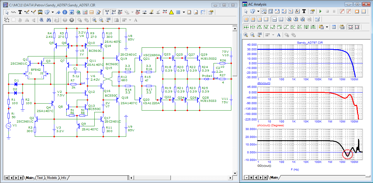

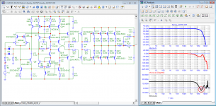

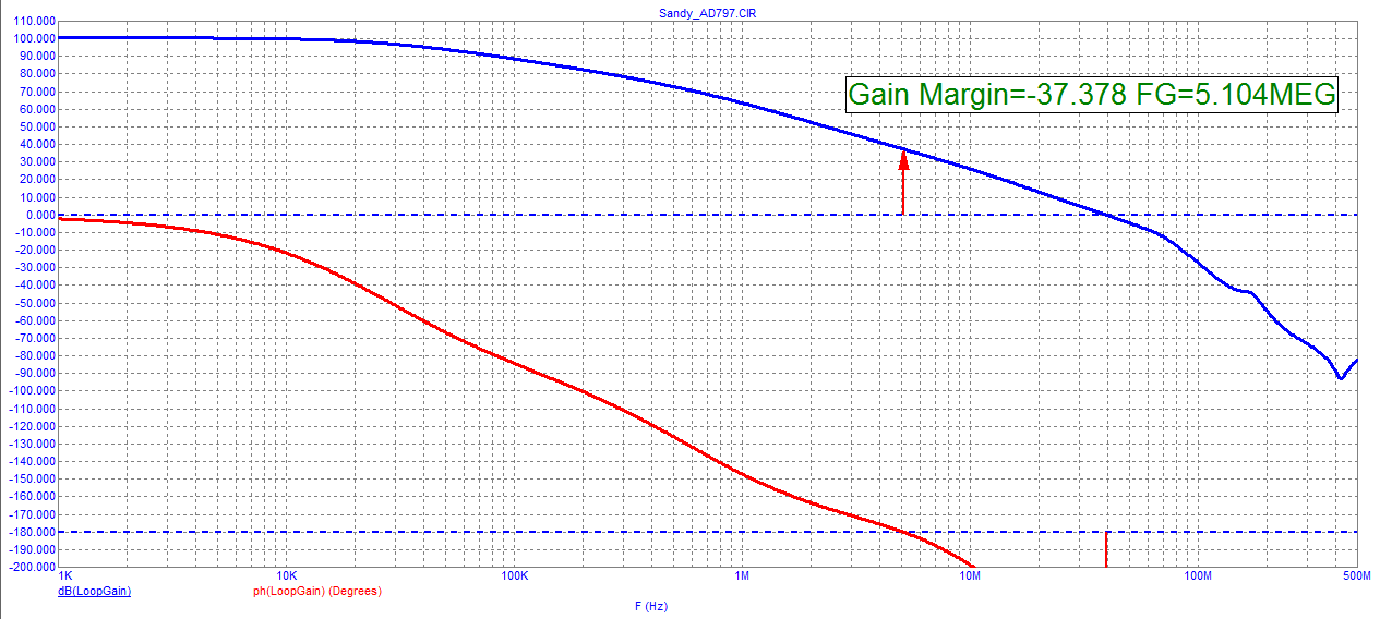

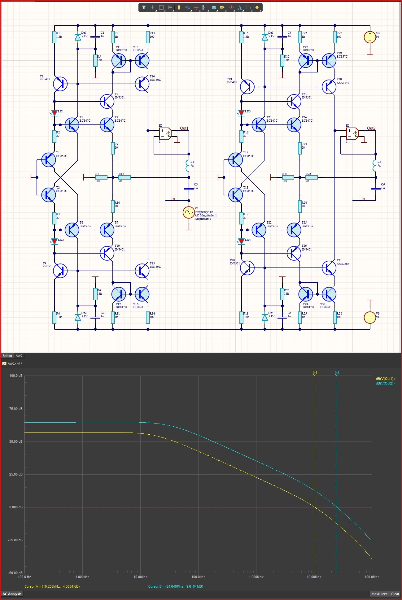

To answer this question correctly, you need to add a correction capacitor in your model, which you don't show for some reason.
First we need to see things without frequency correction.
It is clear that the amplifier that has a wider frequency band without correction will be better even after the correction.

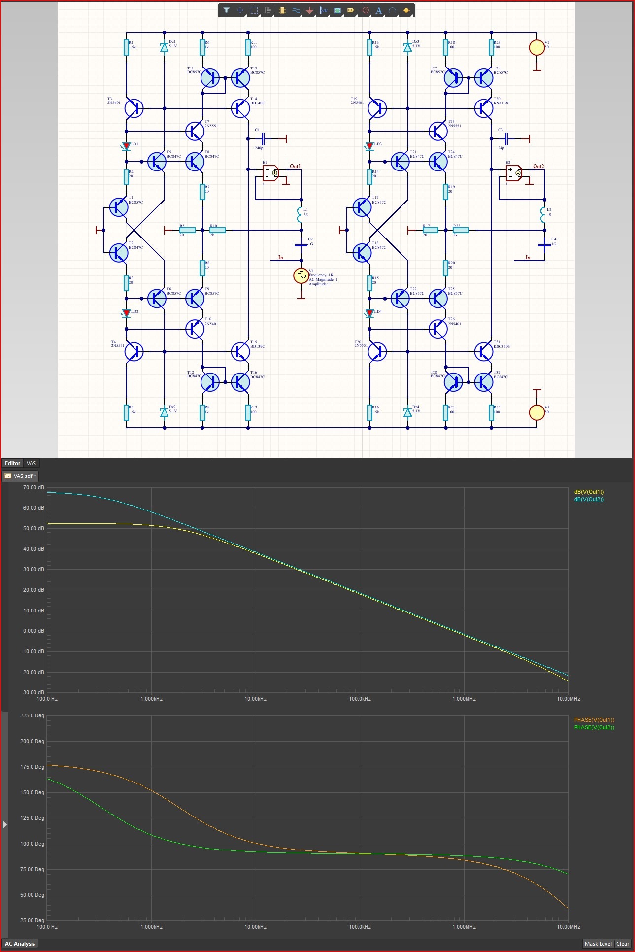

240pF/24pF
Same Ft in practice but worse above 1MHz.
And here the phase shift of the next step will also be added.
We can see that the amplification for low frequencies is much worse at the high current of VAS
And there is no benefit from this large current, even at high frequencies the phase is worse.
However, the linearity of the gain with such a low-current driver is higher. I'll try to re-correct for a low-power driver, but the current increased due to the poor quality of the output stage control due to the weak driver current.

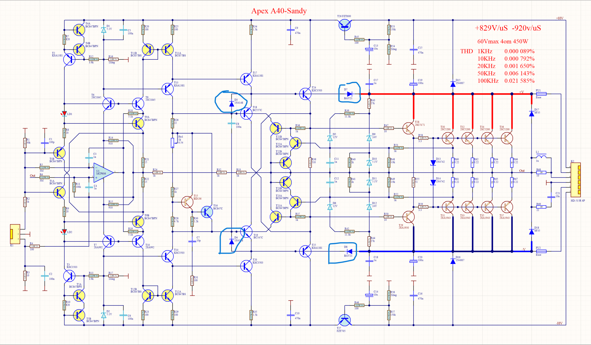

Which gain linearity is higher and how did you know that?
The transistors in the VAS should never go into restriction.
This is solved in another way, noting the diode scheme.
R18/R19 are not there just for offset adjustment.
They are there to keep T13/T14 from clogging up under restriction.
A minimum current of at least 0.5mA always remains in the inactive arm
This is how you get out of the limit quickly.
And this does not allow them to change the voltage determining the quiescent current (U on C8) under limitation.
In your scheme, when the current through the transistors is limited, this voltage will become 0A
Here, however, even if T16 is blocked, T15 at 0.5mA remains unblocked and keeps the voltage of C8 from changing radically.
Also, C8 should never be large (electrolyte 100uF) as audio designers usually do, so that this voltage after the limit quickly returns to the required value.
You have to think about mongo things at the same time and their interrelationship.
