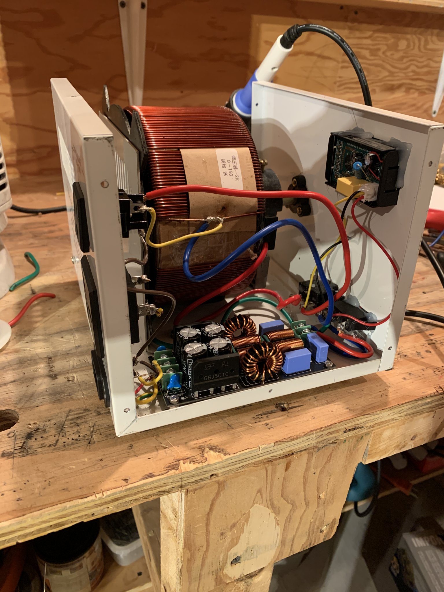

The audio filter (Chinese module + Variac) + external additional filter, just brings a huge soundstage, full micro-detail and so much fun!
The filter helped the emu0404 which is old technology to boot properly without lights flashing for 20 minutes.

If you have a varistor, you could connect it to the input of the filter between the L and N terminals to protect against overvoltage. At the output, you could also connect a large X2 capacitor (2.2uF - 4.7uF) between the L and N terminals to achieve a lower cutoff frequency.View attachment 1444191
Ich habe die Eingangs- und Ausgangsstecker ausgetauscht und das 20-Ampere-Modul in den Variac eingesetzt.
I have a 1uf X2 somewhere !, Franz you use AI translate? I try to learn germanische ! What a great mind to place the verb at the end of phrases haha.
Yes, I'm German. We write like that, and many people have despaired over our grammar. I'm translating with Google Translate.
The 1uF X2 capacitor is good, try it. The filter you're using has very small X2 capacitors compared to the coils. With 1uF, you lower the cutoff frequency a bit. You can do that easily.

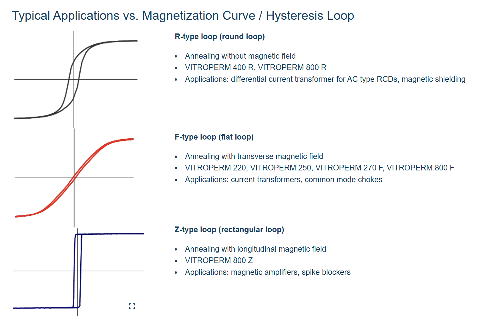

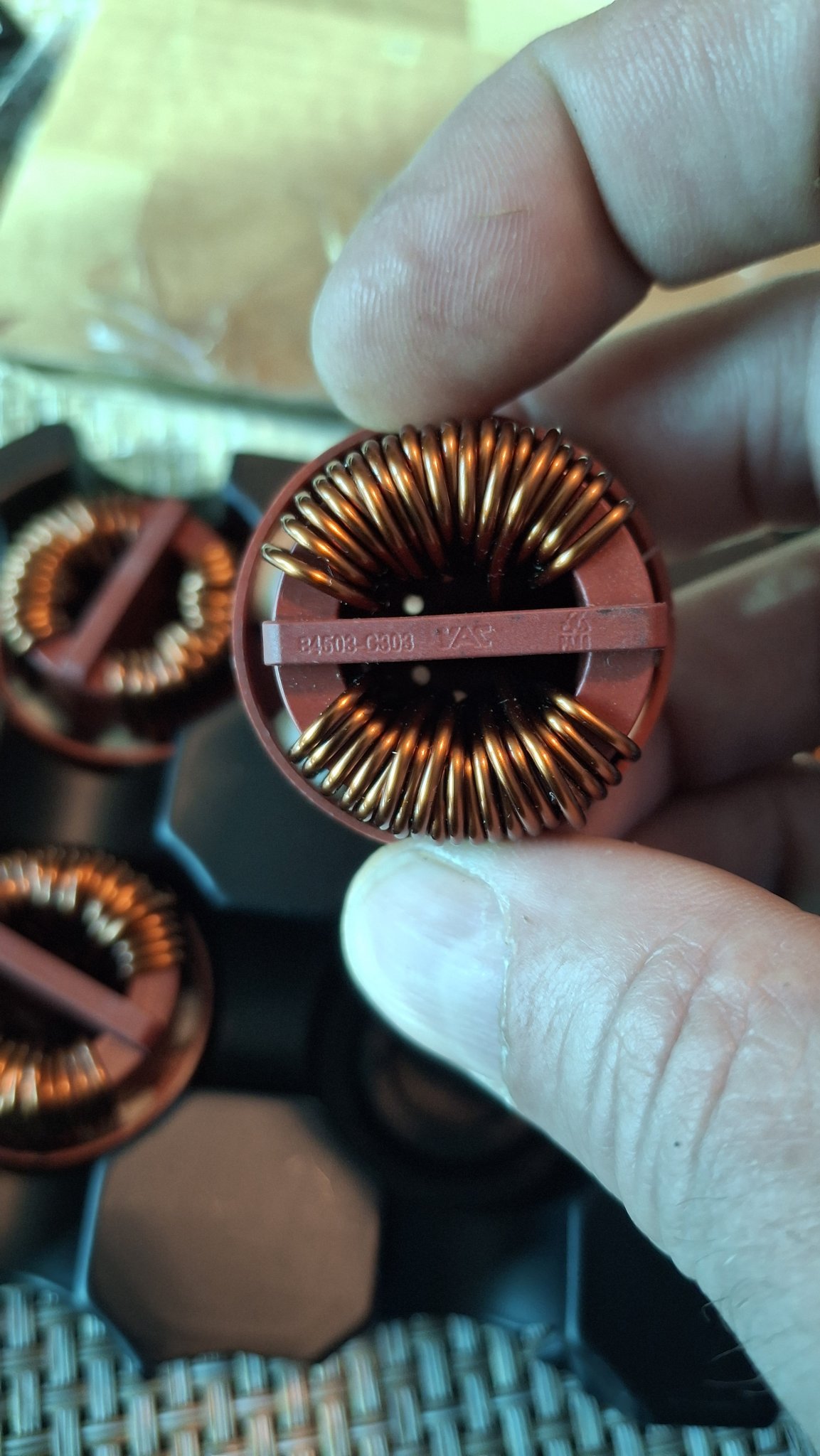

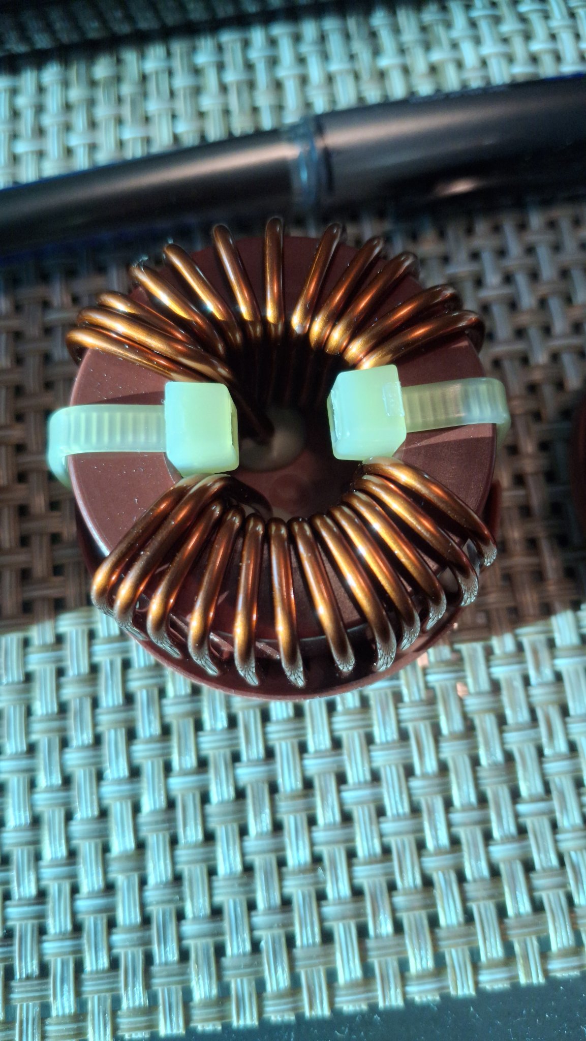

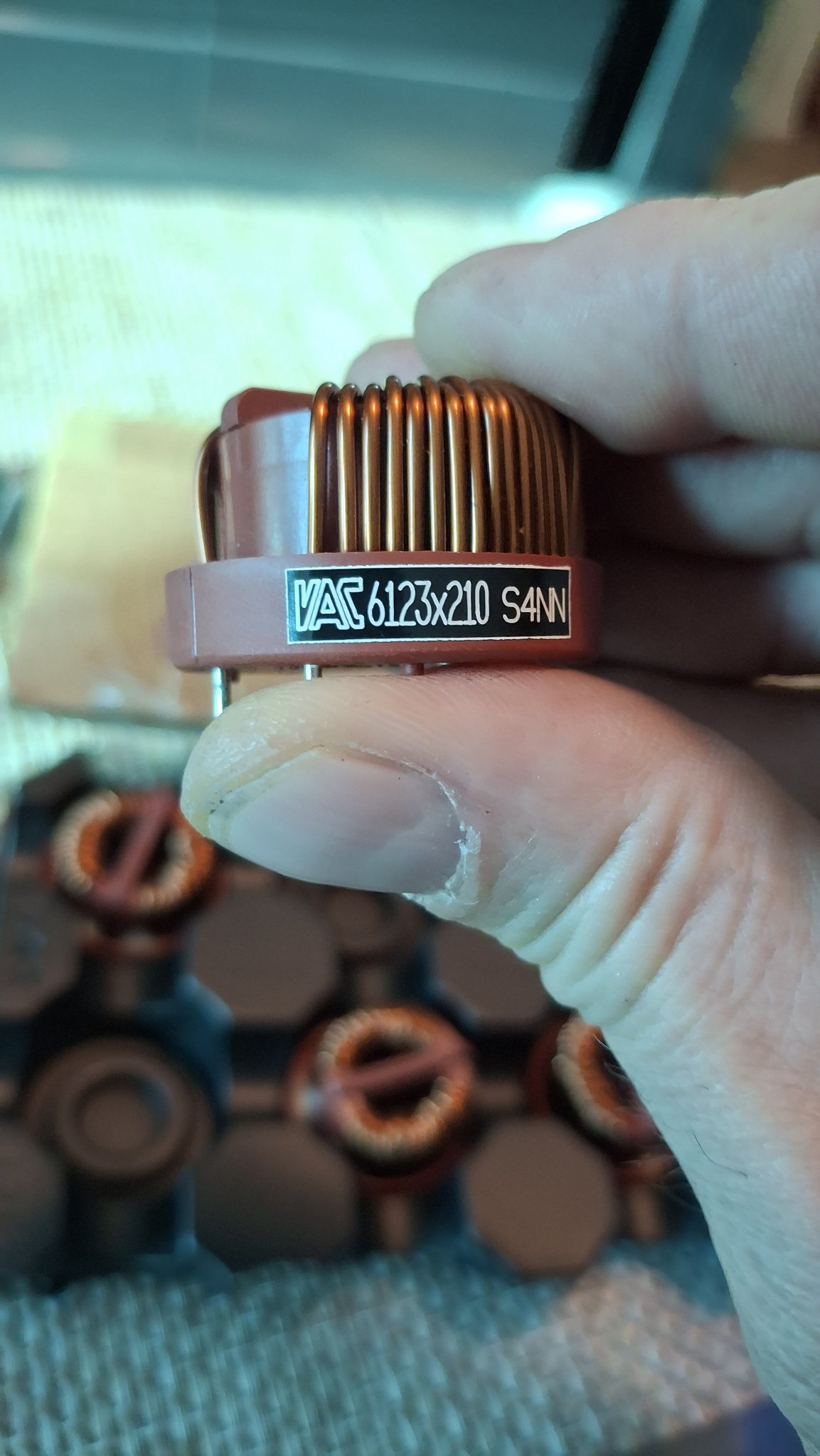

F-Typ for common mode chokes.
https://www.mouser.de/new/vacuumschmelze/vac-VITROPERM-chokes/
https://www.mouser.de/ProductDetail/Vacuumschmelze/T60405-R6123-X232?qs=sGAEpiMZZMtyFaoUegSfpuSbysziqcJNnU3torIyGlc=

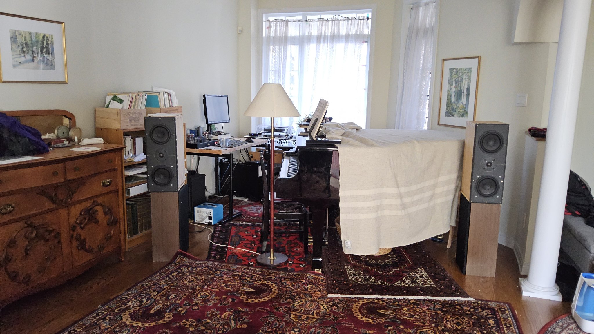

Yes! I usually listen with the dac or the phono stage, you cannot see the big boxes they are on a metal furniture behind, where the turn table is, its a 2 m long table, I have better listening rooms, but this is where I place it to enjoy. I use the computer a lot for youtube streaming, I have a laptop too that I use.
I have another filter after the transformer variac for the DAC and PHONO, so : chinese filter ---> Variac --- amps ----> Filter #2
You cannot see in the picture I have two mono solid state amps (top of line stuff, crazy good to play Mass in C minor of Mozart the most difficult passages, Kt427 , Sanctus, Hosanna,
please ban this video, this is the most horrible sound ever on youtube) (same thing with Gardiner, it is so horrible, I prefer the high distorted sound of Frensiz) Give me this (more compressed) any time:
) which I use, they are clearly more transparent than my basic tube amp, in the future I will build kt120 mono's all regulated and it will power a 3 way all Scan-speak, just need to build it.
