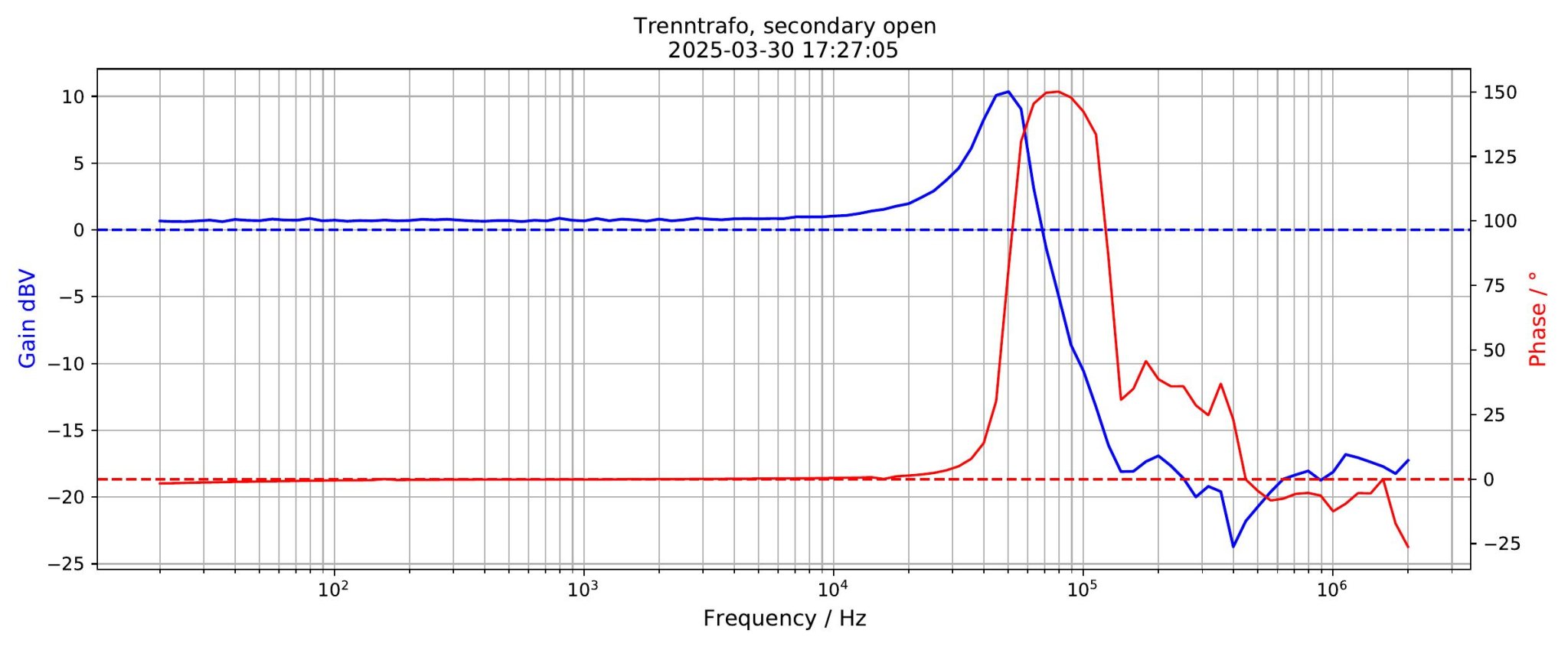

Today I measured an isolation transformer (no label on it about VA, I guess around 200VA from weight) at various situations:
First measurement with seconday winding open, primary winding with a 50Ohm resistance in series:
We see that the voltage going into the primary winding is transferred 1:1 to the secondary winding up to about 10kHz, then the gain increases together with an increase in phase into the positive direction. The maximum gain around 50kHz stems very likely from the self-resonant behaviour of the EI core, where winding capacitance takes over.

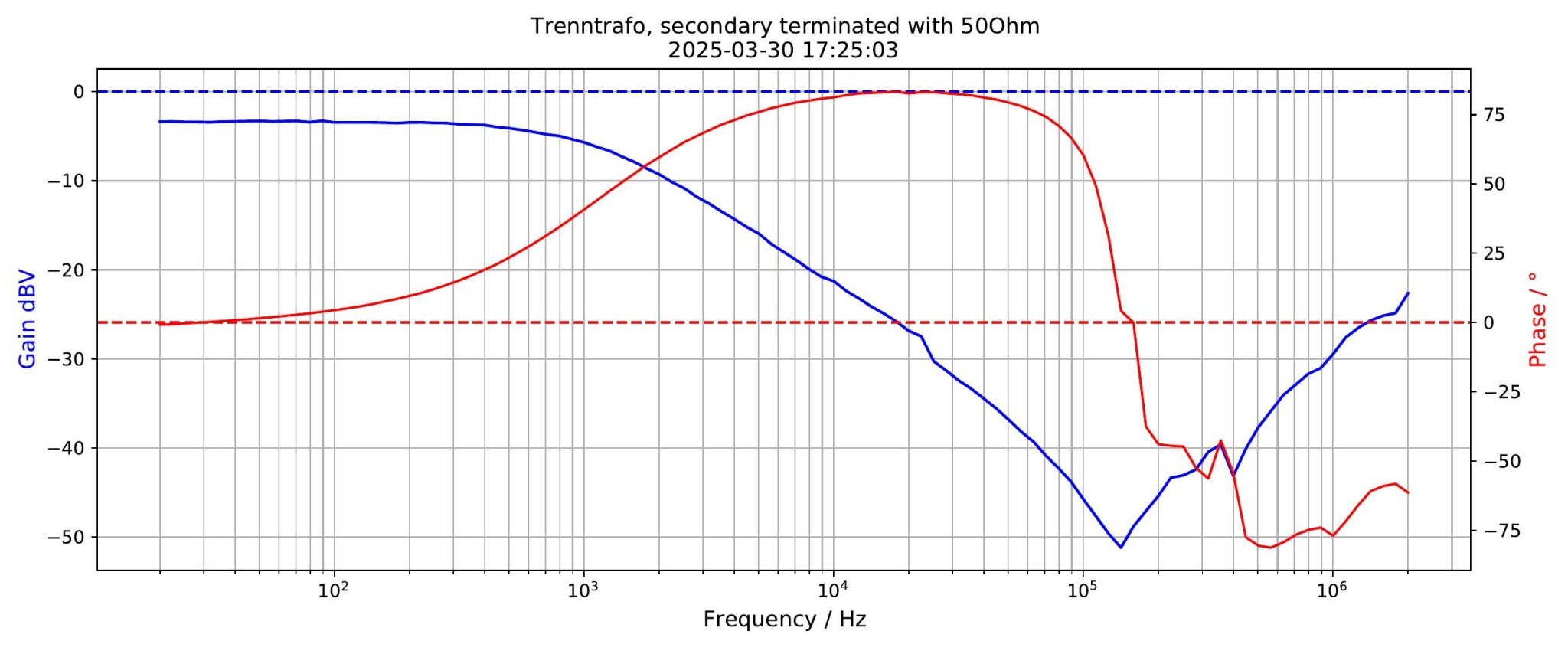

In the next measurement the secondary winding is loaded with 50 Ohm:
In contrast to the open secondary winding, the 50 Ohm load is transferred to the primary winding, the ingoing signal is attenuated by about 3.3dBV up to about 1200Hz, which is roughly the -3dB point of the increasing attenuation with a slope of about 20dB/decade. The inductive behaviour changes around 140kHz to a capacitive behaviour.

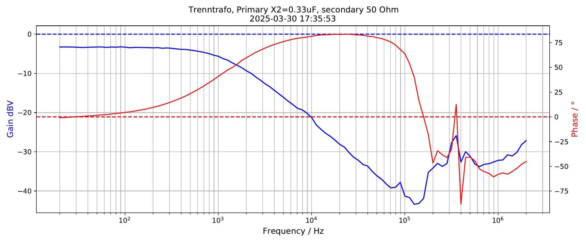

In the next measurement I added a 0.33uF capacitor at the primary in order to simulate some X2 input filtering:
The addition of the X2 capacitor had no effect except above 200kHz, where some resonances might occur.

1) An isolation transformer attenuates in fact at quite low frequencies. A toroid transformer might do this as well (to be verified by measurement!)
2) The attenuation will depend strongly on the (ohmic) load on the secondary side (make R_load 100 Ohm?).
3) Adding capacitance at the input of the isolation transformer had negligible effects on the attenuation below 100kHz
4) Regarding HF (which starts conventionally around 30MHz): very likely (no data shown!) no effect because of working above the self resonance.

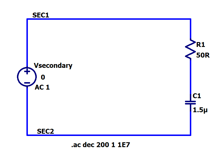

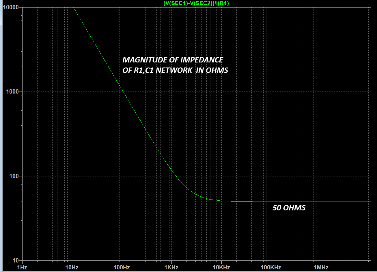

Hi @Grauwacke , you can greatly reduce the power dissipated in your 50 ohm damping resistor, by noticing that the resonant hump only begins to appear at 10 kHz and above. So it's possible to install a capacitor in series with the 50 ohm resistor and achieve huge reductions of the current & power dissipation at the (very much lower) mains frequency. Here's an example.

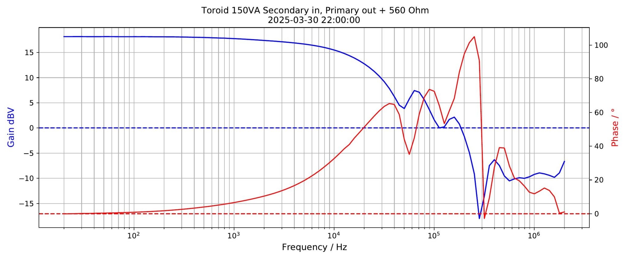

And here the promised measurement of a 250VA toroid, measured in reverse direction: input into secondary (24V), out (230V) loaded with 560Ohm. Gain starts at about 18.2dBV. which corresponds to the winding ratio of 230/24=9.58; 20* log (9.58) = 19.6dBV
1) Several resonances above 50kHz.
2) Onset of attenuation at much higher frequency than the isolation transformer (EI core)
3) Maximum attenuation much smaller than that of isolation transformer
4) Filtering of toroid transformer seems less efficient than of EI core (is it a function of wattage? => check)

The critics of the 50Ohm:50Ohm measurements are old, as the paper says, but one needs standardized conditions for not comparing apples to peas. The 0.1/100 and 100/0.1 Ohm measurements provide further details, of course, but who knows the source impedances of the mains connections up into the MHz region? So finally, as noted in on the Thel homepage: It depends!
Furthermore, may I note that a transformer is not directly comparable to a LC filter. What I measured was only the transfer function of the primary side to the secondary side. In detail more measurements would be necessary: The leakage inductance, the magnetizing inductance, the DC resistances, the intra and inter winding capacitances; parameters, which are all accessible by measurements, see the attached pdfs.
Btw, I would never rely on some "filtering action" of a transformer because it is not its purpose and there exist much, much better ways to get rid of AC pollution (e.g., the R21 module or the various regulators of Jan and others).
Which apples to which peas? Testing a random unknown brand/type EI transformer of unknown power rating and a random unknown brand/type 230V:24V 250VA toroid (not the discussed 230V:230V isolation version) used in reverse on 24V produces leading data? Both unknown/unnamed DUT also not used in 230V setup with nominal load. We learnt that they are transferring LF signals of 8Vpp rather well (till a certain frequency) besides the 50 Hz they are meant for. That is what transformers do for a living. Revelation: they can even be used as output transformers for 20...20 kHz audio.
The tests show exactly that both exhibit indeed some kind of filtering in the area of interest. What is not mentioned: isolation transformers generally also reduce leakage and reduced sensitivity to pick up radiated garbage.
So conclusion could be that they do filter and provide galvanic isolation but are best helped by an added mains filter and an RF proof PSU. Instead of spending years on one aspect have a combination to fight pollution. A pollution that changes randomly so why not fight it somewhat at all fronts?
