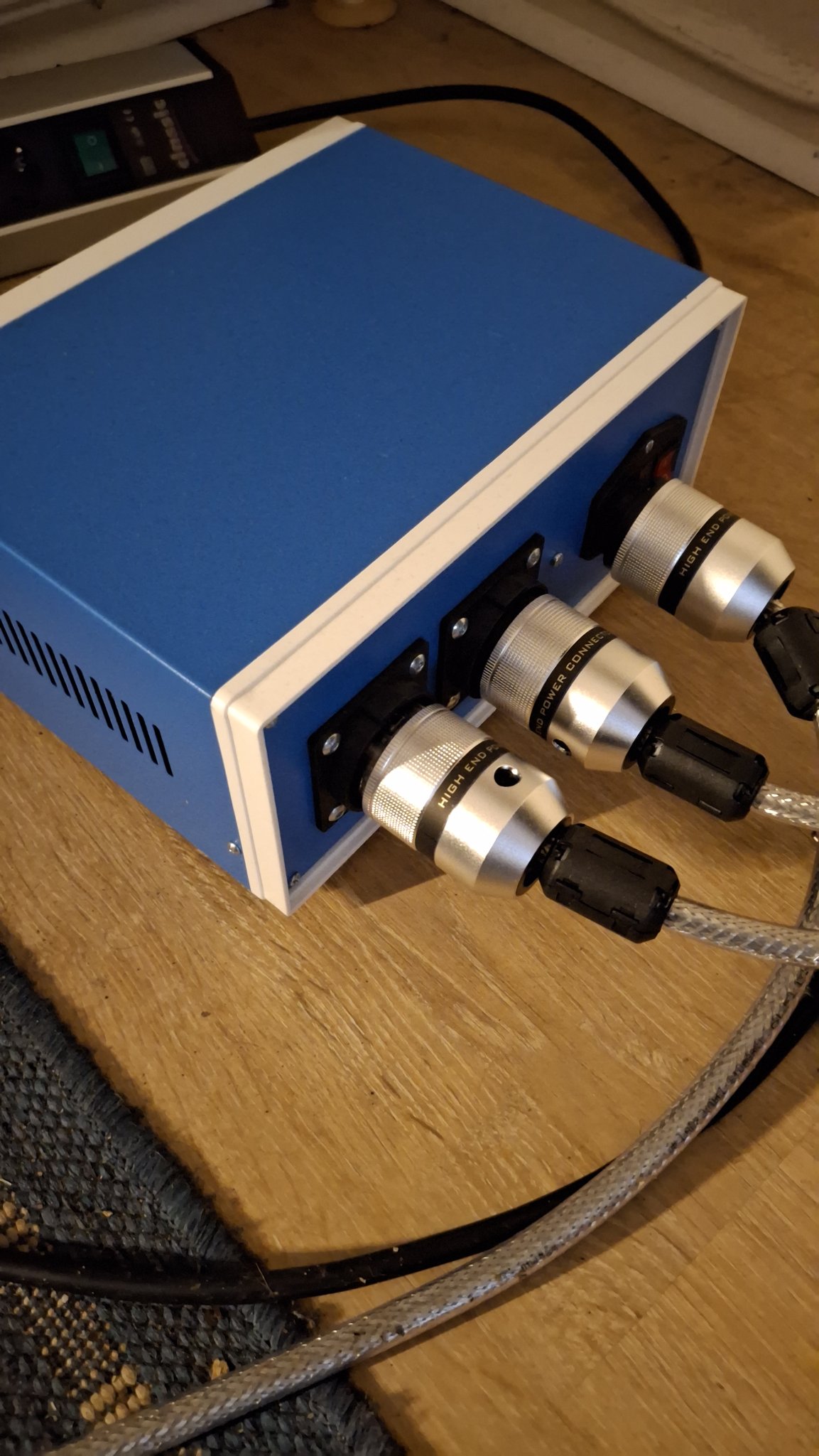

So far my setup is 200 for variac (20 pounds china) and 25$ for the DC blocker filters, add 10$ for inlet outlet, and 20$ box,
250 which is the price of some power bars alone, a variac made in USA of same size is 3000.

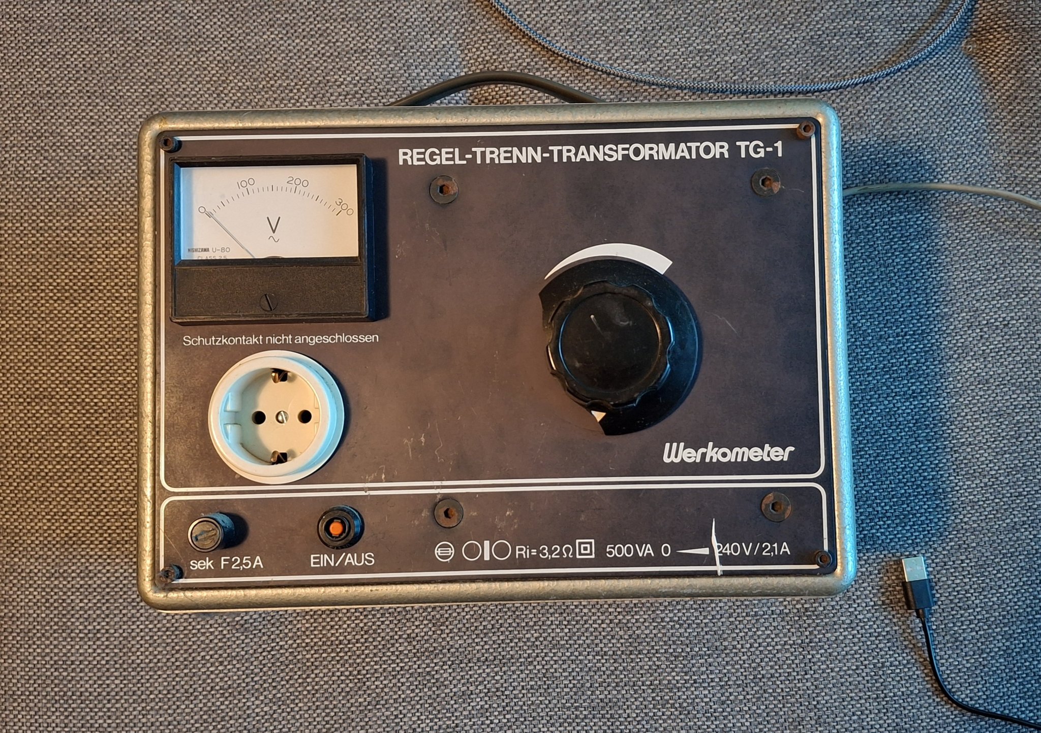

I had used this adjustable isolation transformer before. The noise suppression was okay, but the 3.2 ohm impedance also caused a loss of dynamic range.

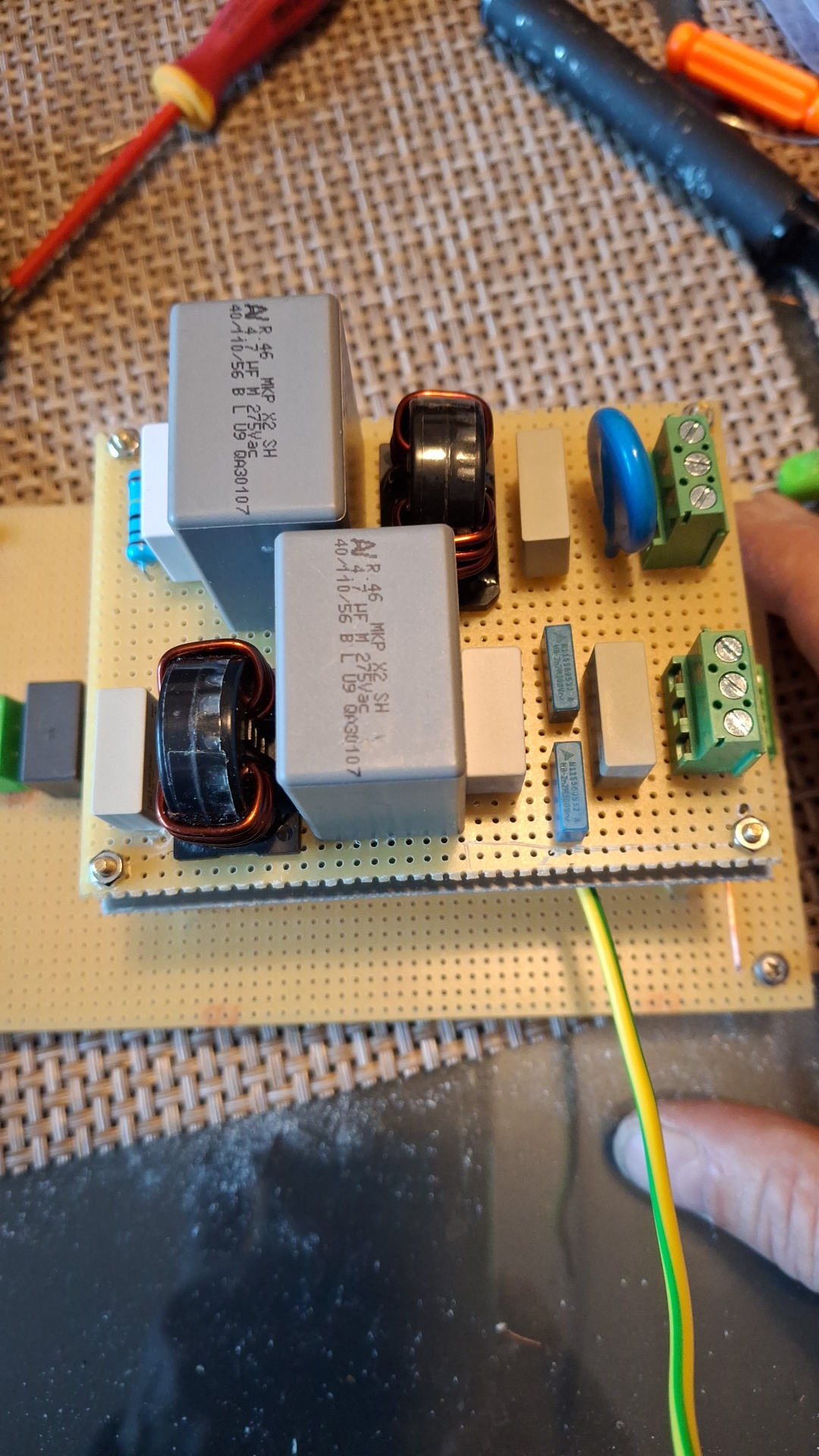

This is the DC and EMI filter I built myself. It has two filtered outputs with different filters, one for the network player and one for the amplifier.
Never have an opinion based on just 1 case. That is an isolation transformer/variac combination used by the Romans. Something totally different from just an 1:1 isolation transformer.
The mechanical indicator in the switch (instead of a lamp or LED) indicates early seventies.
I've heard various variacs in front of stereo systems. They all have their advantages and disadvantages. For me, the line filter is the best compromise. The device in the photo is a German variable transformer from the 1980s. I sometimes use it behind a generator.
Why add a high impedance variac? That is something different from a 1:1 transformer. Simple. A variac has a wiper. Variacs are generally also not meant to be used continuously in a circuit.

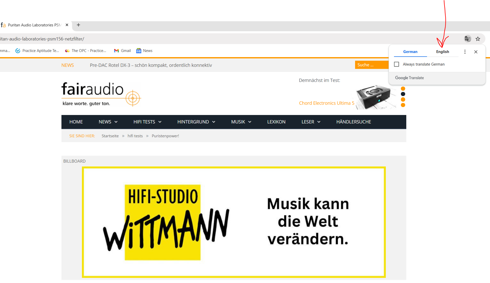

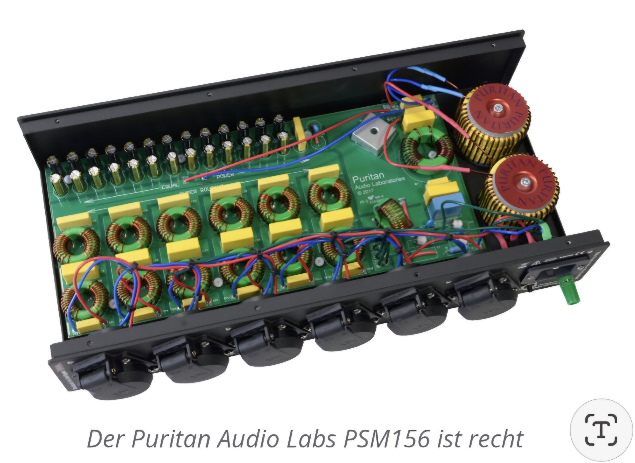

This filter from Puritan costs over €1500. It uses large common-mode coils (the large yellow coils on the right) and simple ferrite coils. This line filter is not suitable for power amplifiers; dynamic losses are clearly audible, which has been clearly confirmed by numerous tests.
Well-functioning line filters are only available through DIY!

If you look at the coils in my homemade filter, you'll notice that they have just four turns (1.6mm², 10cm long). The internal resistance is difficult to measure, and the required low cutoff frequency is achieved using a very large X2 capacitor. Dynamic losses are not audible with this filter as long as the amplifier's power consumption remains below 400W.

You talk and talk without ever having built a line filter or even heard a homemade one. You have consistently held preconceptions that you can't substantiate. I'm trying to demonstrate a viable approach to solving certain problems, and you keep arguing against them, even though you've apparently never really studied the subject matter. Thel actually provides good explanations. The link to the refraction principles is also rather non-commercial, and I cited the Puritan filter as a bad example, so it's not really an advertisement either!
