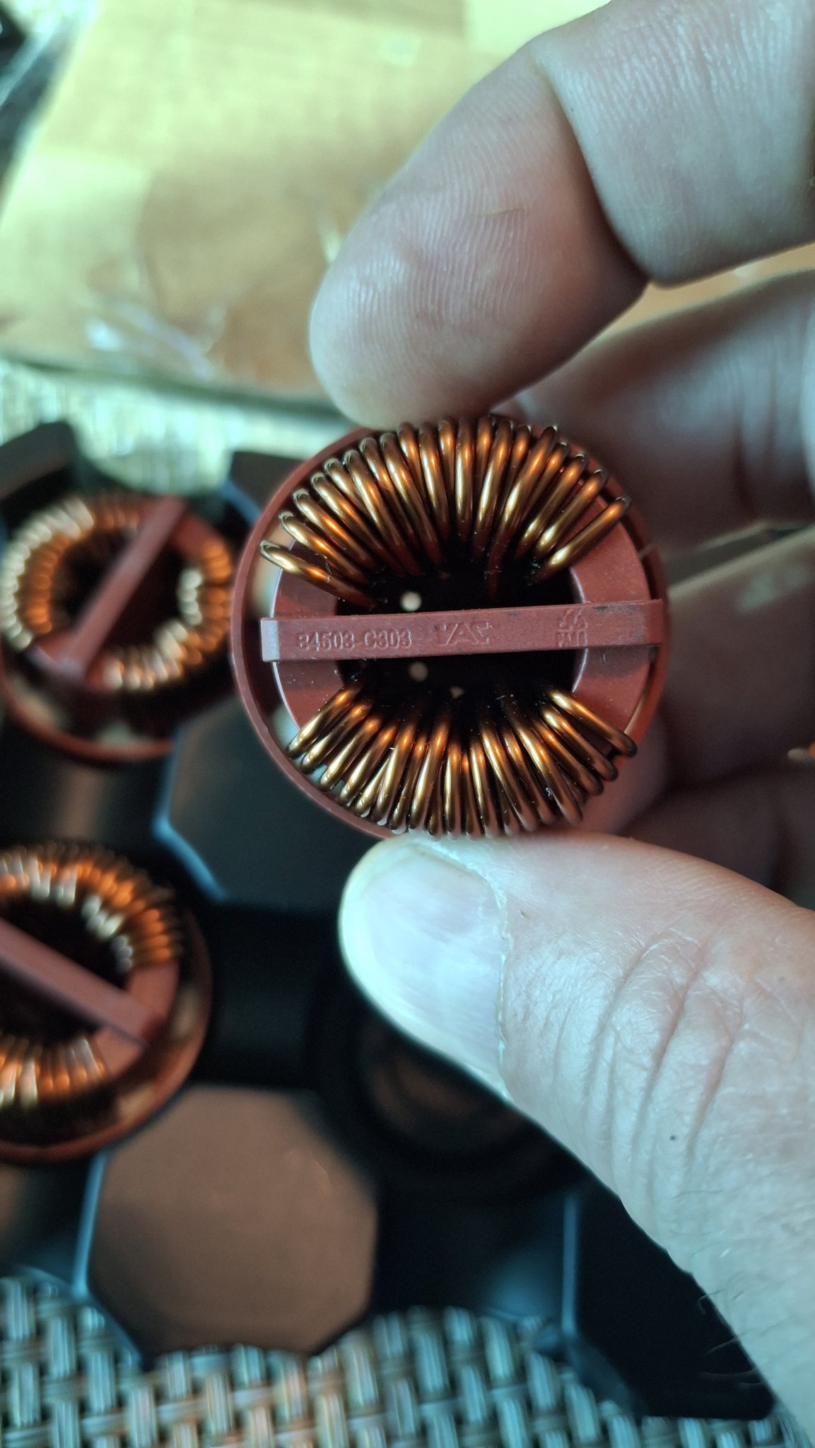

I only use Vitroperm coils from the vacuum melting plant, in my opinion these are the best

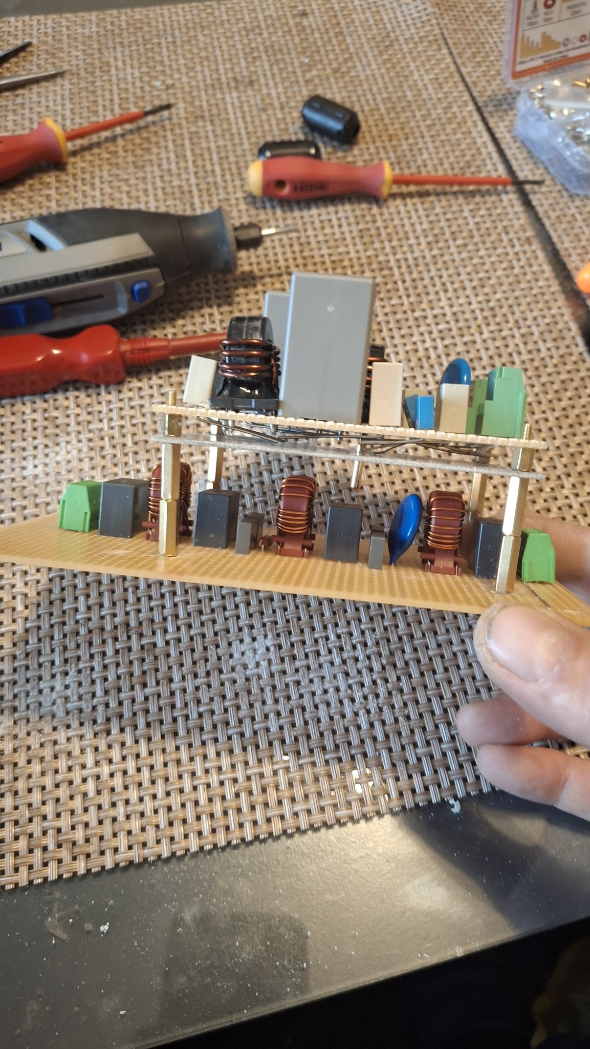

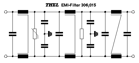

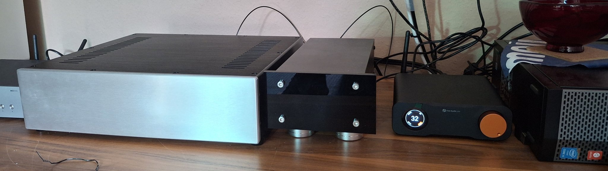

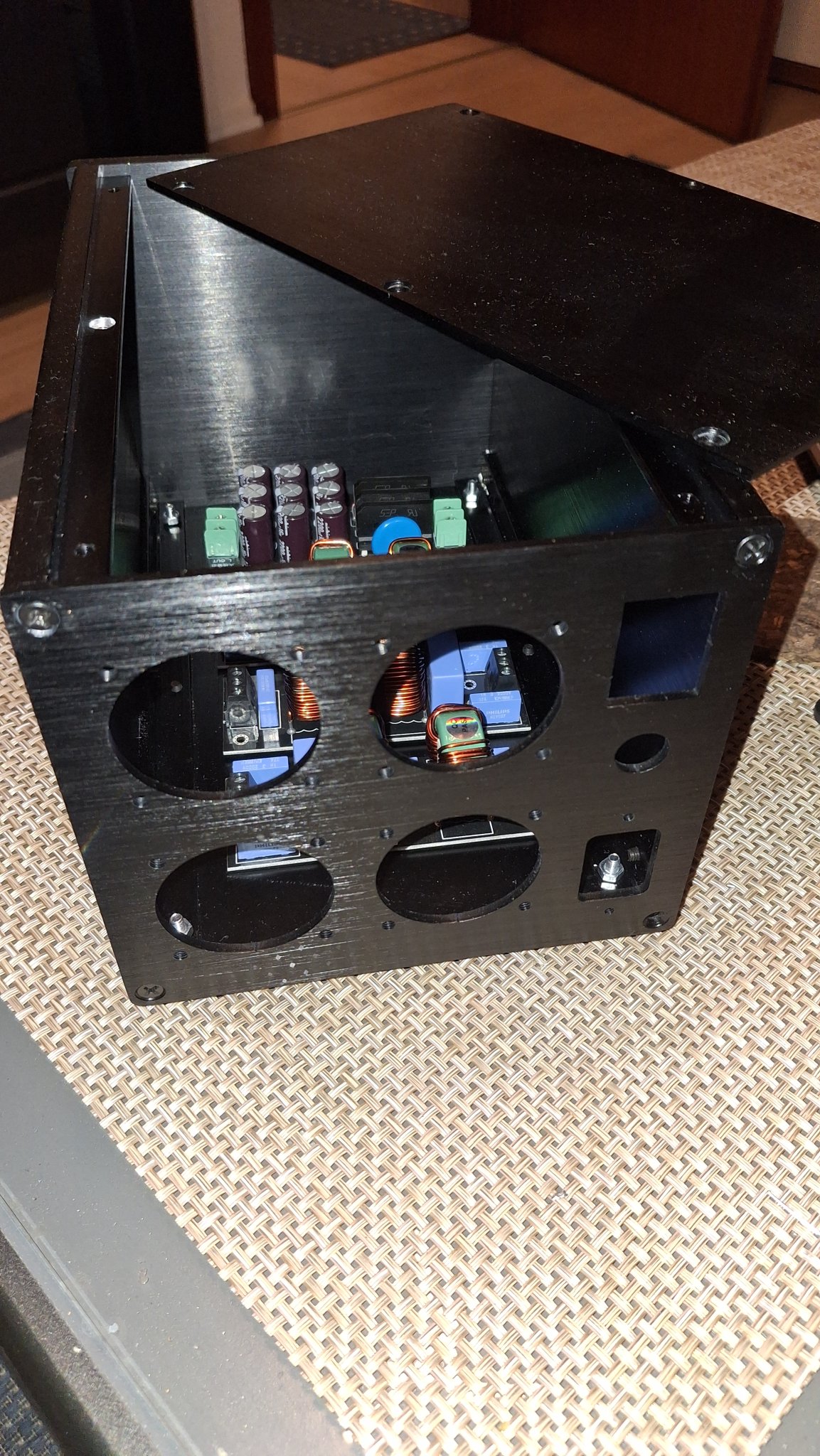

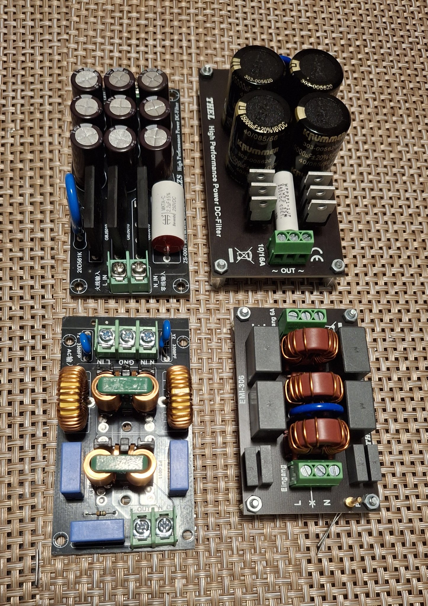

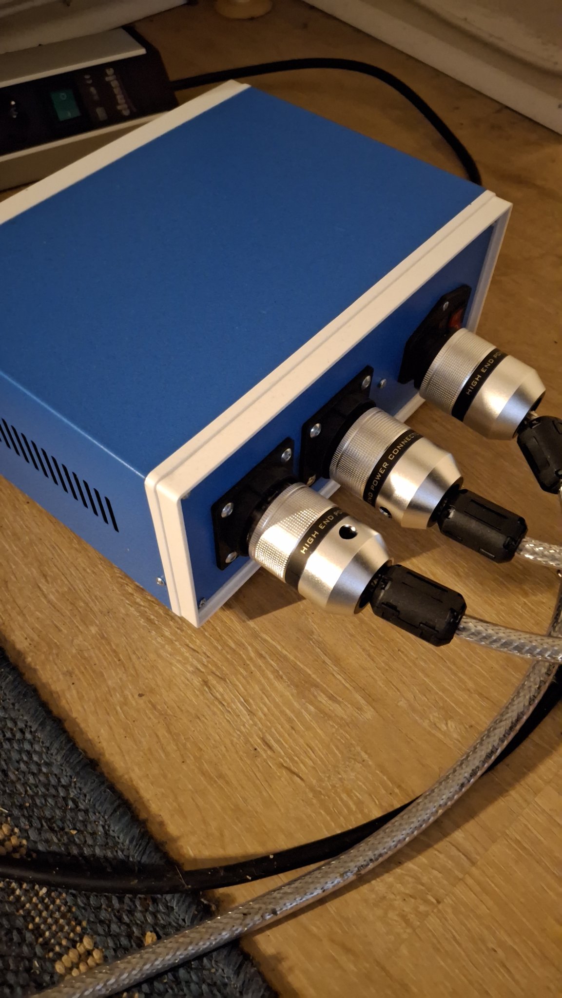

This is my homemade EMI filter. The upper board contains the filter for my amplifier, the lower board contains a replica Thel filter for the network player, and I use the Thel board as the DC filter.
On the left of the photo are a Chinese DC filter and a Chinese EMI filter. On the right are the Thel circuit boards.

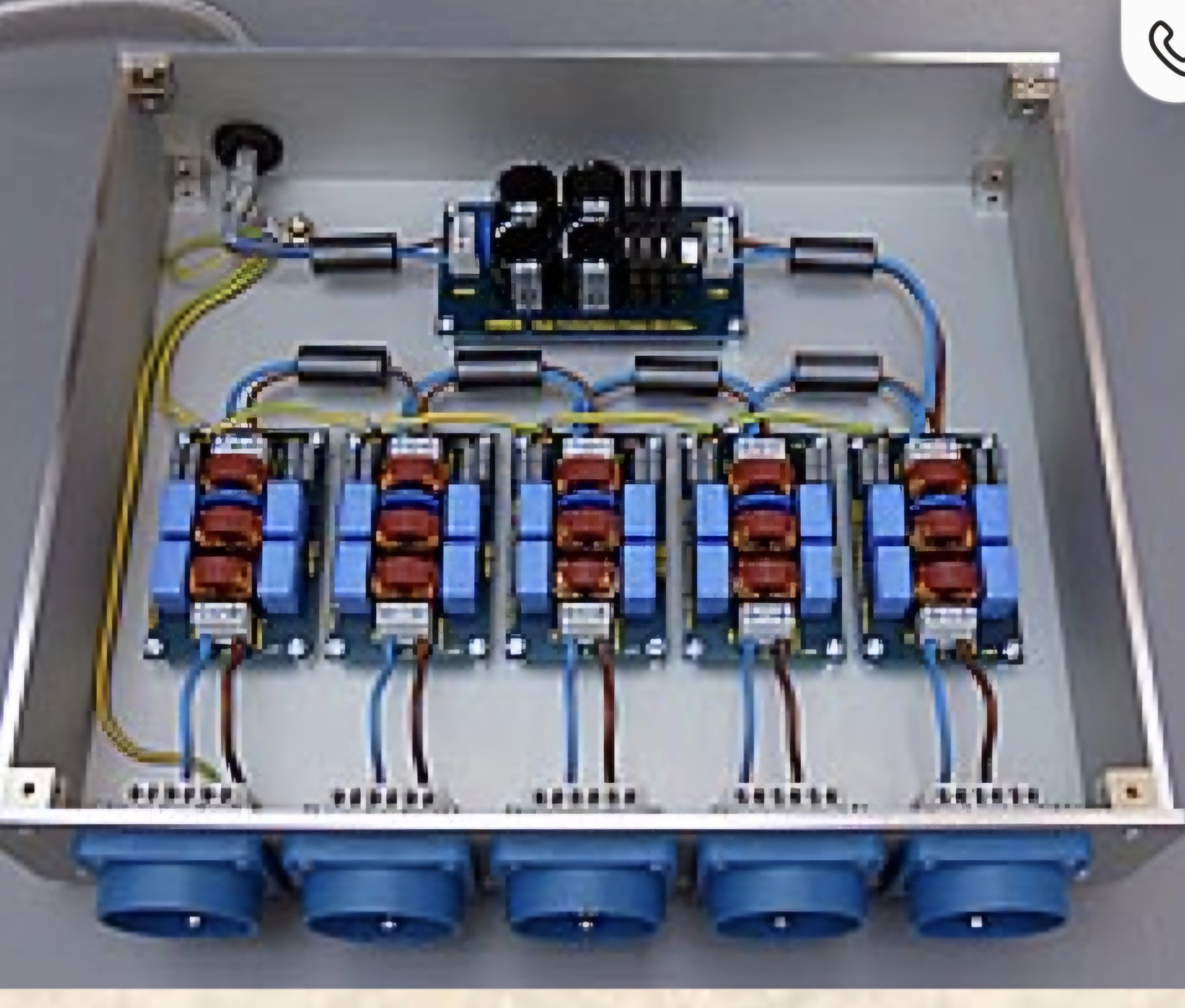

Ich nutze USB nicht von meinem Computer. Es dient als Filter für meinen Netzwerkplayer und Computer. Alibaba, eBay und Amazon bieten große Gehäuse mit vier oder acht Anschlüssen für Netzfilter an. Dabei handelt es sich um Aluminiumgehäuse. Rack-Gehäuse sind ebenfalls eine Option. Ich bezweifle, dass man für jedes Gerät einen DC-Filter und einen EMI-Filter in eine Steckdosenleiste integrieren kann. Mehrere in Reihe geschaltete Leisten wären kontraproduktiv.
Besser wäre es, den Filter direkt in das Verstärkergehäuse einzubauen.

I don't use USB from my computer. It's a filter for my network player and computer. Alibaba, eBay, and Amazon offer large enclosures with four or eight outlets for line filters, and these are aluminum enclosures. Rack-mounted enclosures are also an option. I doubt you can integrate a DC filter and EMI filter for each device into a power strip. Multiple strips in series would be counterproductive.
It would be better to build the filter directly into the amplifier enclosure.

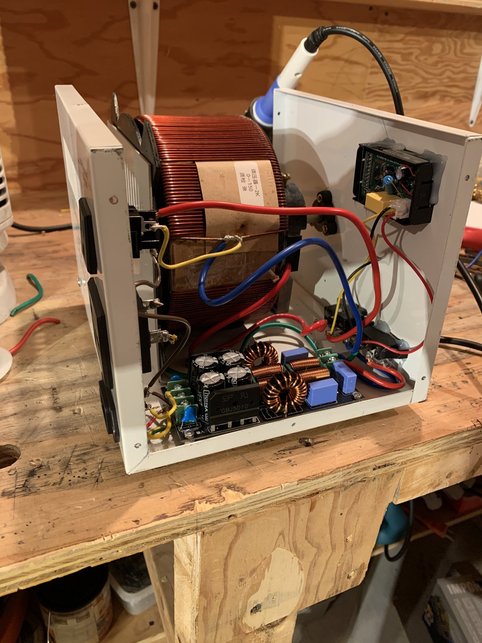

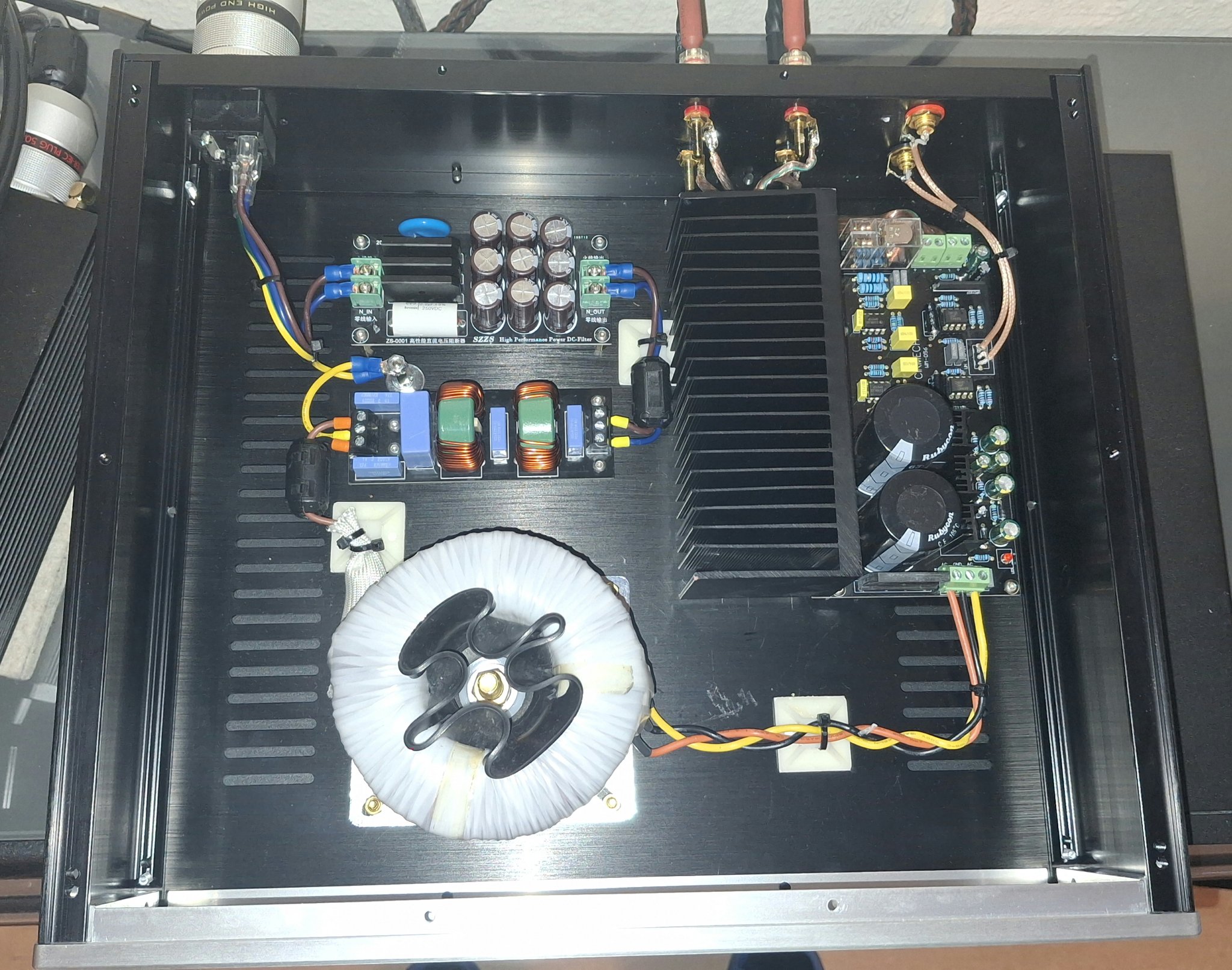

Yeah, I get the idea. Man does it makes a difference in the soundstage...
Just the chinese filter module, I use the 20A one just like that for now without any case for the USB emu0404
The passive transformer (I replaced the stock switching one) is now very happy and the dac starts without rebooting for 10 minutes like before.
This is a MUST and cleaver to install it in the Amp chassis so that you bring the amp anywhere you are sure the Toroid is protected.
My problem now is that the computer is sending video card and cpu noises inside the dac and it goes through the input through pollution of the power supply . It is only from the USB line and originates in the computer.
I am looking for options but tonight I could listen back to what music sounded 20 years ago.
I think I am going to cry. This is so emotional moment after what they CLF, Switching cars power supply etc have done to the Grid.

Here's another link to Vitroperm coils. Mouser offers them!

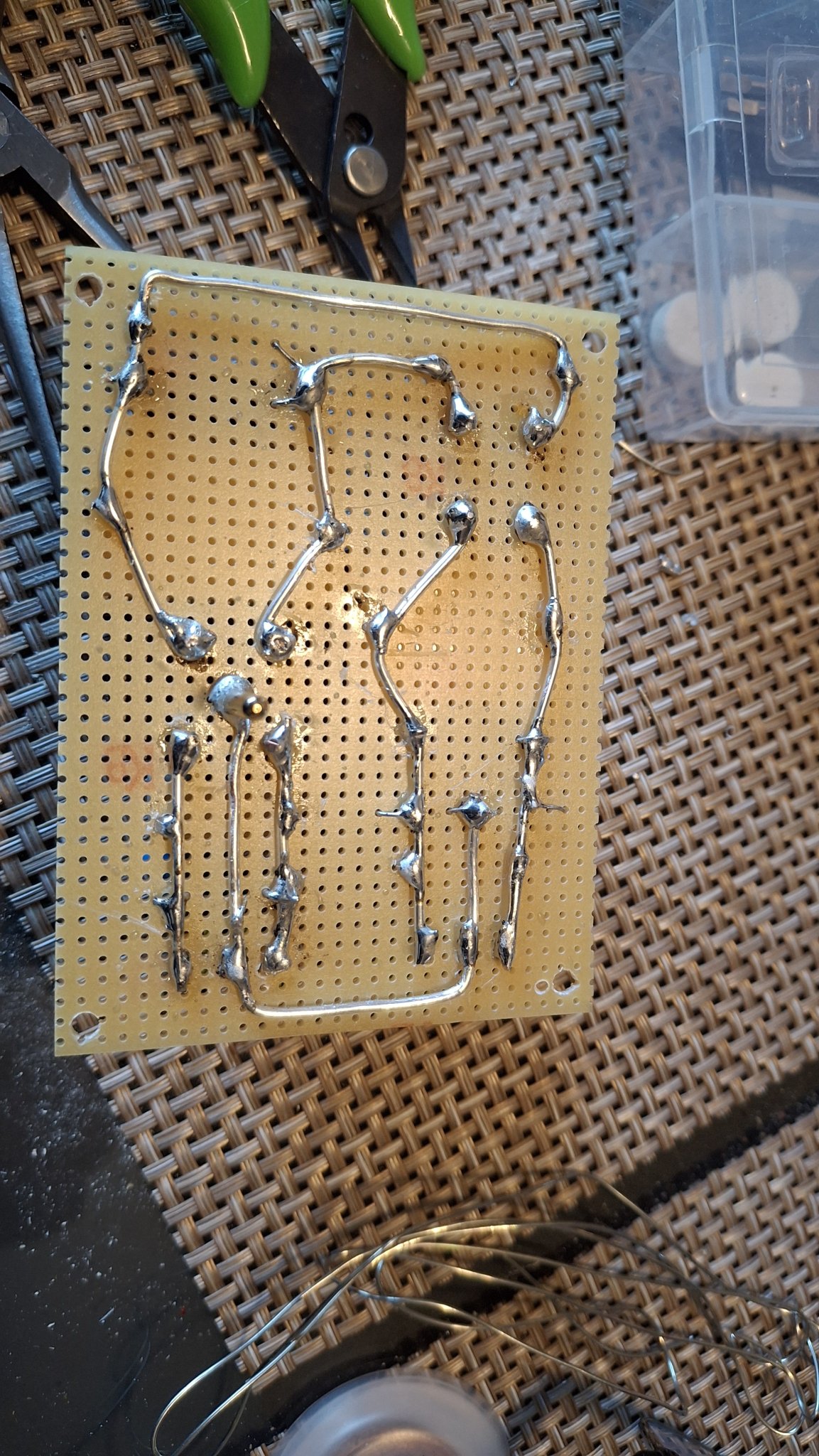

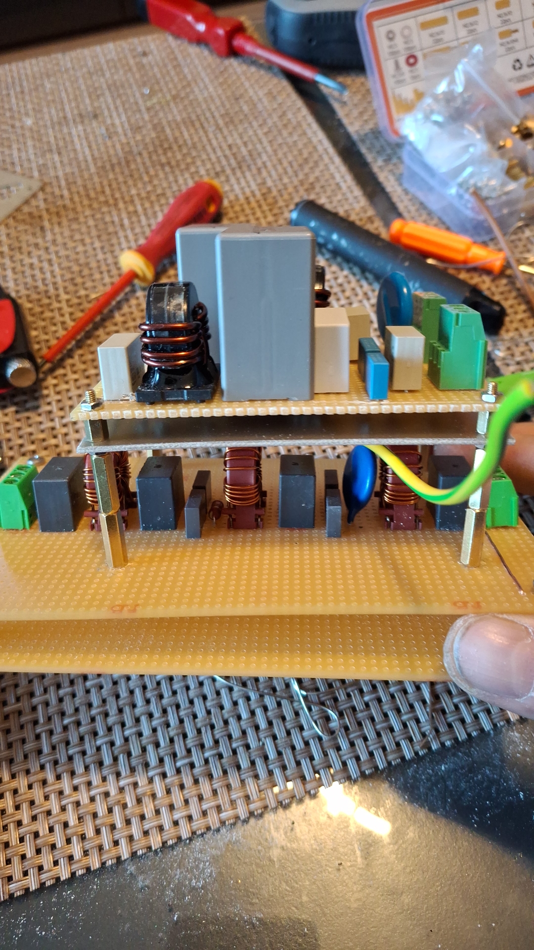

I usually build filters on a breadboard without a copper overlay and wire the components directly with 1.5mm² silver wire with a copper core. I then attach a second circuit board underneath with spacers for safety reasons. The filters work perfectly; there's no need for a separate circuit board for the filters.
VAKUMSCHMELZE(VAC)
is the manufacturer and the coil cores are Vitroperm

I changed the input and output plugs and placed the 20 amps module inside the variac
