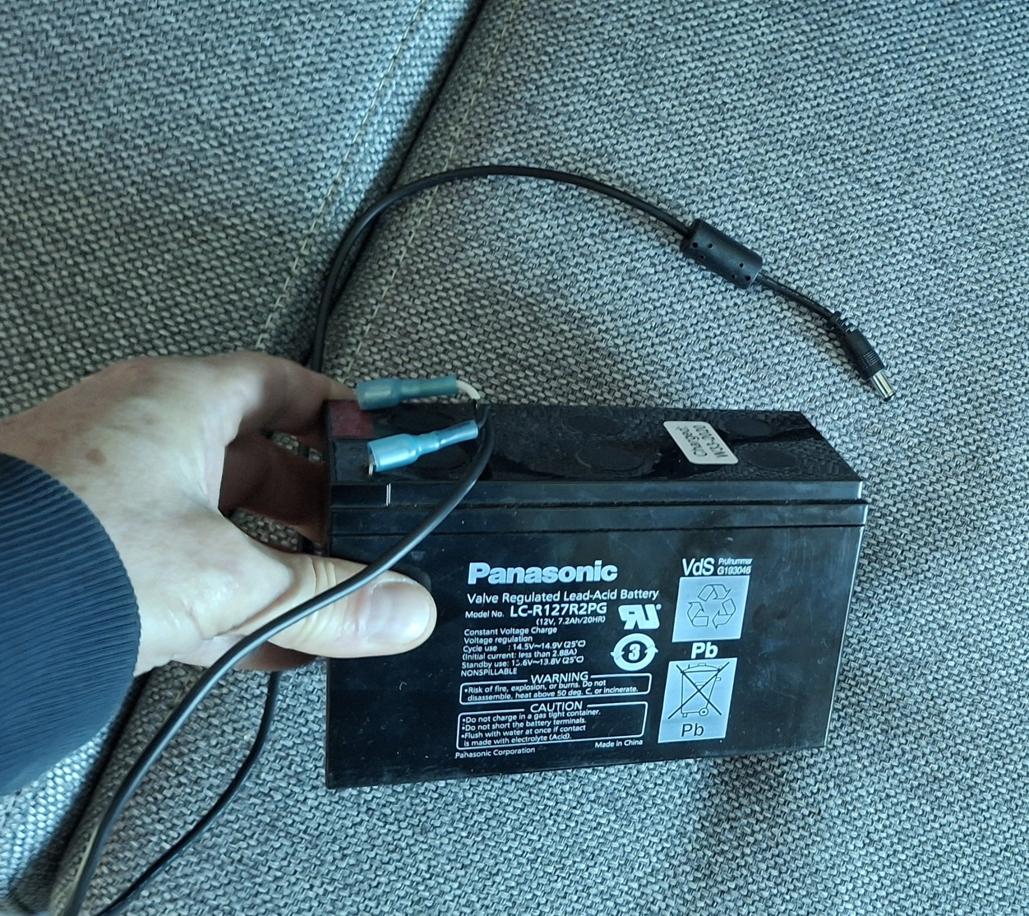

Have you ever considered running your DAC on a battery and keeping the cable runs short? Then you shouldn't have any EMI problems anymore.

I don't think batteries would change anything to the AMP input wires catching noises.
