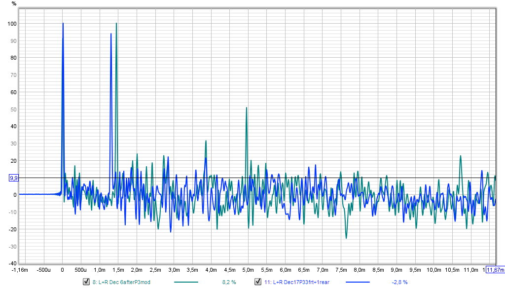

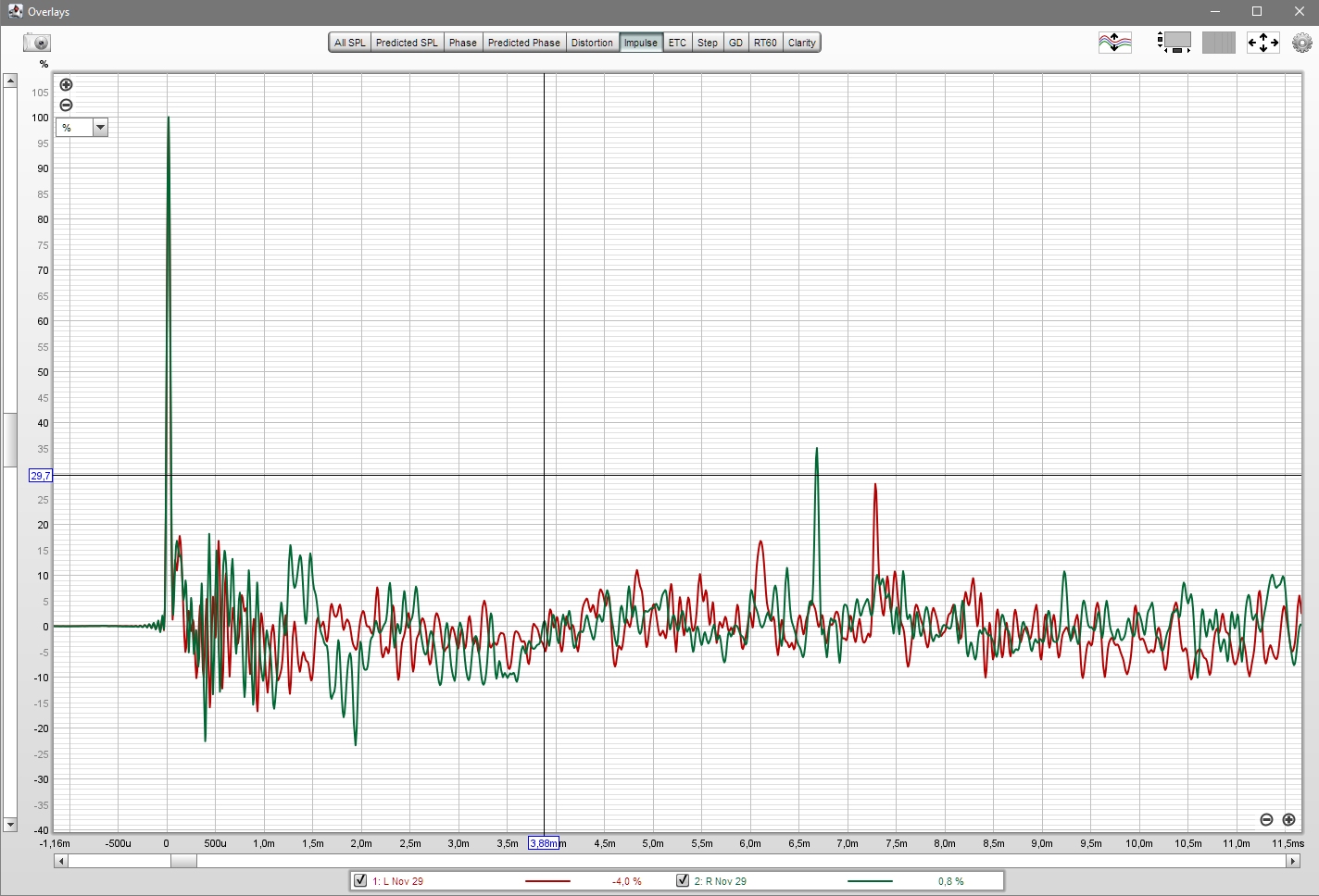

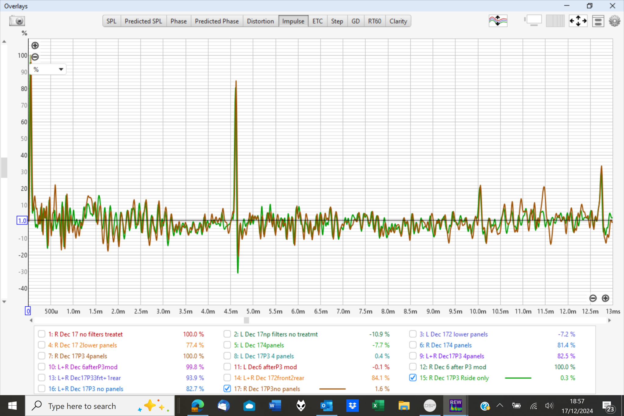

Yes, if you have an REW file with a few measurements you can view those IR's simultaneously using the "Overlays" button (top center) and select the "Impulse" tab within the Overlays window:
Example overlay window:
Here's the REW file you posted a couple of days ago (fundamental only29th november), comparing left and right IR with Overlays.
I think it's correct, that large spike probably is from the back wall. If we look at what happens early on, at about 700us there's a peak missing in the measured result with panel. A reduction from 22% to about 8% at that peak. An IR like this mostly shows high frequency material. That's just the nature of these graphs. But it does help to identify things like wall reflections, if you know where to look. The wall is nearby, so the time travel distance is shorter than that peak at ~4.7 ms.

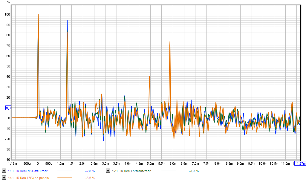

14 is no treatment, 12 and 11 are differing front and back wall as described. 4 panels in total distributed 3 on front wall and 1 on back or 2 on front, 2 on back.
I only look at SPL, because i don't understand better/more
If one looks at 7,11, 12 and 14 it seems that treating the front wall and a small back wall panel may smooth things significantly, if the front wall could do better at less than 100Hz, even better. and i like the front wall ideas as i feel they may enhance the room!

Here's a little sample of how the panels in the back operate:
Both 11 and 12 have a panel at the back, right? Compared to the orange "no panel" we see the peaks at 5 and ~5.8 ms disappear. The high peak at 1.3 probably is either the left or right speaker in a stereo measurement? (and not being in the exact sweet spot?) I usually make sure to be in the exact sweet spot for these type of comparisons.
I'm not exactly sure what the p3 mod is, I'm guessing panels on front wall?
Comparing that to one rear panel it is quite obvious which one makes the most difference 😉.
Yet again a slightly different spot in the room used for this measurement judging from the peak shift at start. This way REW couldn't auto adjust position of the peak zero and I had to use the cursor on the first peak to set that to zero.
When chasing wall reflections it is best to do it one channel at a time. For instance, we get a reflection from the right wall. Measure the right channel and you'll most probably have a clear peak at that reflection. Play a stereo pair and the left speaker wont have the right wall reflection at the same spot due to different distances to that wall. Now it will look like there's only halve as strong a reflection from that wall. In a similar way arrays average away the floor and ceiling reflections. Yes, there still are floor and ceiling reflections but each speaker is at it's own height, different from the one above or below, so they all have a different point of reflection and 24 others that average that spot out. 😉
Don't ever think there are no floor and ceiling reflections with arrays 😀.

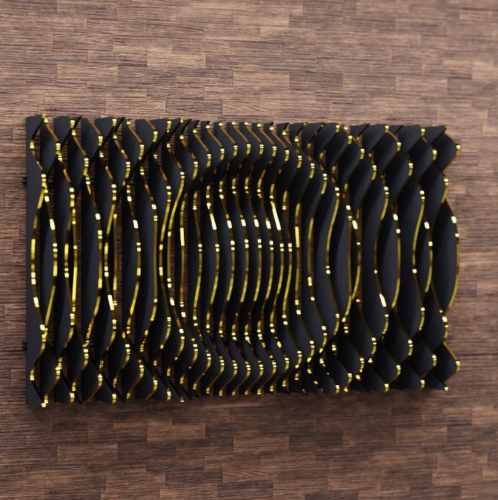

Maybe something along these lines:
A Do It Yourself version of course, see my post here and the reaction from @jzagaja : https://www.diyaudio.com/community/threads/a-3-way-design-study.376620/page-107#post-7874350
So templates are available to create something like that. This may be a very useful addition to any setup that wants some ambience from the back.
I took a look at the link for that panel, its rather expensive!
But yes, we are a DIY community.

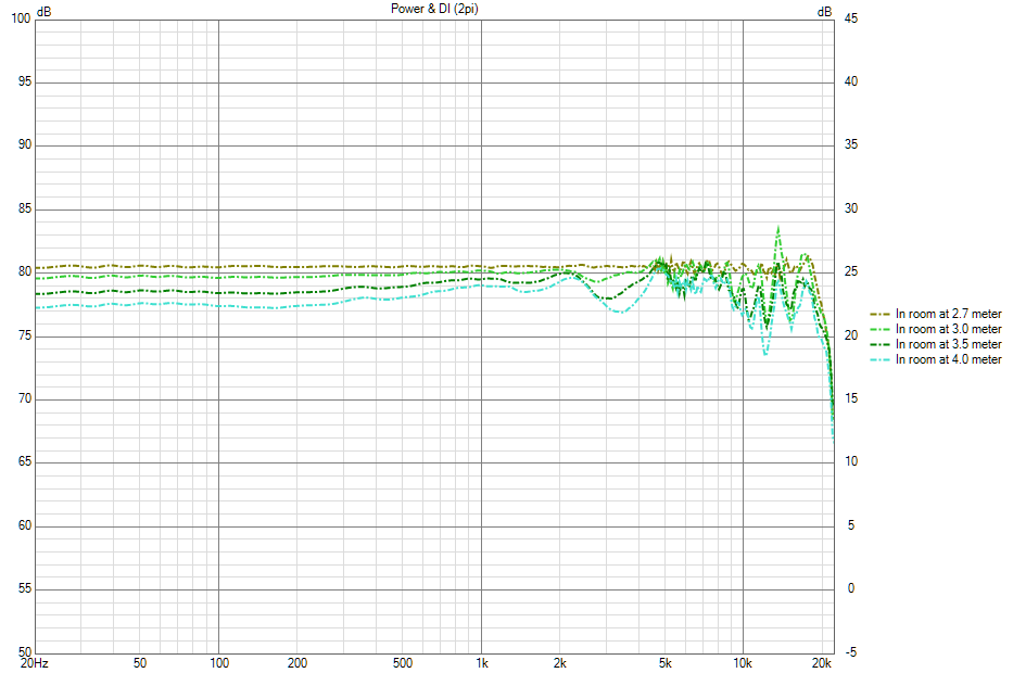

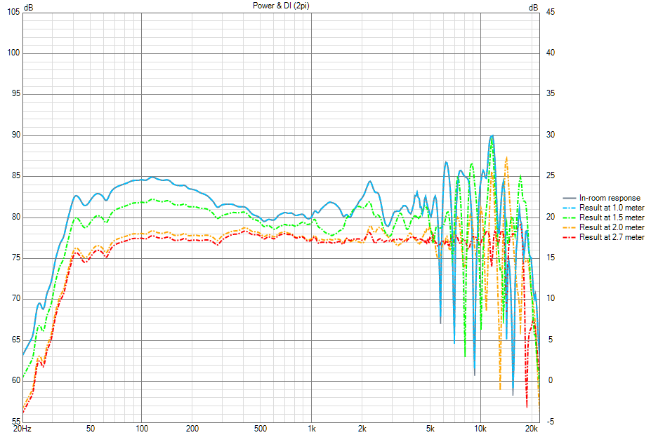

Before you proceed with the above mentioned strategy, I'll give you the following picture to "consume".
It's the in-room prediction of an unshaded array of 25x TC9 FD18-08 EQ-ed flat at a listening angle of 10 degree and 2.7 meter.
Negligible floor and ceiling reflections were used (20 dB suppressed), just the position/distance change is shown here.
Take from it what you want, just wanted this effect to be clear. It might influence your current thinking 😉.
Intriguing reading and looking, currently wondering what effect i am looking at, I see 3
1, bass rolls down from 40Hz, is this the EQ as applied?
2. The levels are reduced as distance increases, not surprisingly
3. The response goes wild in upper frequencies at lower frequencies when measured closer.
Now i have read about and failed to understand (or observe) comb filtering at close distances.
Might this be what its about?
Anyway, a gated measurement at 1m would be irrelevant below its low frequency limitation at ~200Hz and all over the place like this above say 2K, so perhaps not much use!
Yup, that's just the EQ
That's a given 😉
I just wanted to show that moving closer to a line array just messes up all that's good about them. Once you get past a certain point things level out much more. You need to be at that certain distance to have a good outcome. Starting at about 2.5+ meters would be a good step forward (but not moving the mic forward 😀). The closer you go, the worse the frequency response is going to be, yes that is where comb filtering gets worse and there will be more uneven 'spray patterns' (or lobes) hitting floor and ceiling. See a little write up here. So I would not recommend using a close up measurement for anything with arrays. You'd be better off taking multiple measurements at a few different spots and average those (which would also serve a great deal to remove room effects that are local). I would not recommend using the average of a multi spot measurement in a FIR generating tool but for general EQ work it would work quite well. You could even average the total measurements of the left and right speaker (measured separately mind you!) to average out the room even more.
Next you can measure at the sweet spot, one speaker at a time and do either fine tune EQ or some FIR correction. Whatever you may wish. Sounds like a plan? 🙂

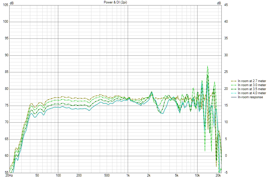

To show the results of moving further away I've made a similar sim to the one I posted earlier:
It isn't perfect but it isn't bad either. We optimize at listening spot and get some deviation if we move further out. Even the one at 4 meter is within +/- 3 dB up to 11 KHz. Mind you, this is looking at it without adding the room effects, if we add those, that's where most other type of speakers would show more/higher deviations than line arrays in frequency response evenness.

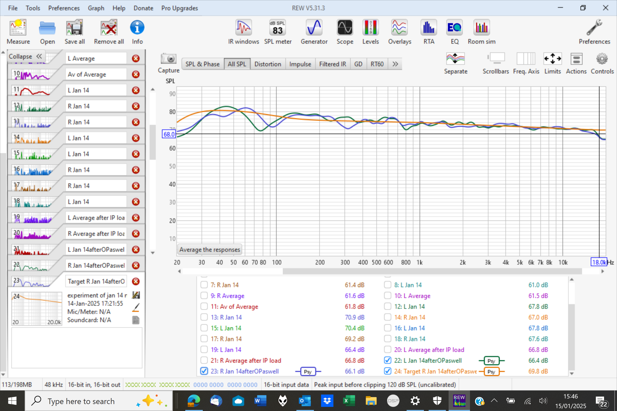

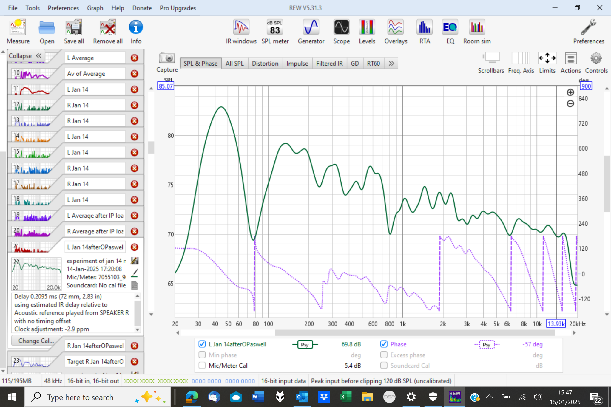

Anyone have some thoughtful views on what to smooth and when please.
Following advice above i revised my (current!) EQ strategy as follows
1. make a series of measurements around the whole listening area at different heights, both left and right channel. Average them. Smooth quite significantly and note the level difference on average, and set the Flex channels at that difference. I found 1.2Db and set that. This way the filters are not used to match levels and i find there is effectively more capacity for later on.
2. Measure as above again and average as before. This will be to create what should be mostly the Speaker EQ which goes in the input side of the Flex and is limited to IIR. Smooth extensively and ask REW to create the filters to match the target curve from 35-20K, first off it may not use all 10 bi quads available. reduce the smoothing until it first uses all 10. Install this same filter on the input side of both channels. NB, i could also create that filter set in REW manually if i thought i knew better?
3Measure again and average each channel separately and smooth with Vari or Phsyco, ask REW to make a filter set for each channel and load those.
4. Measure and compare, it wont be as good as the predicted because its based on an average, and no chance i get the mic back in the same positions
5. Have a look at phase and wonder if i will get my head around FIR in Rephase.
6. By the way, i do feel i am getting a gradually more coherent sound as i play around.

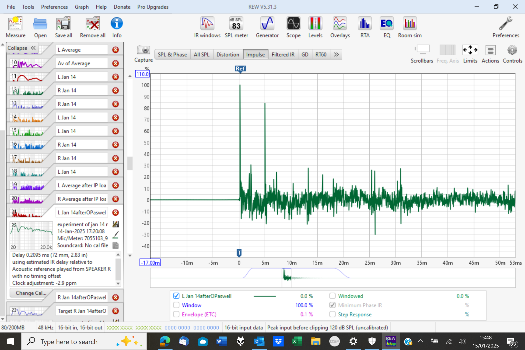

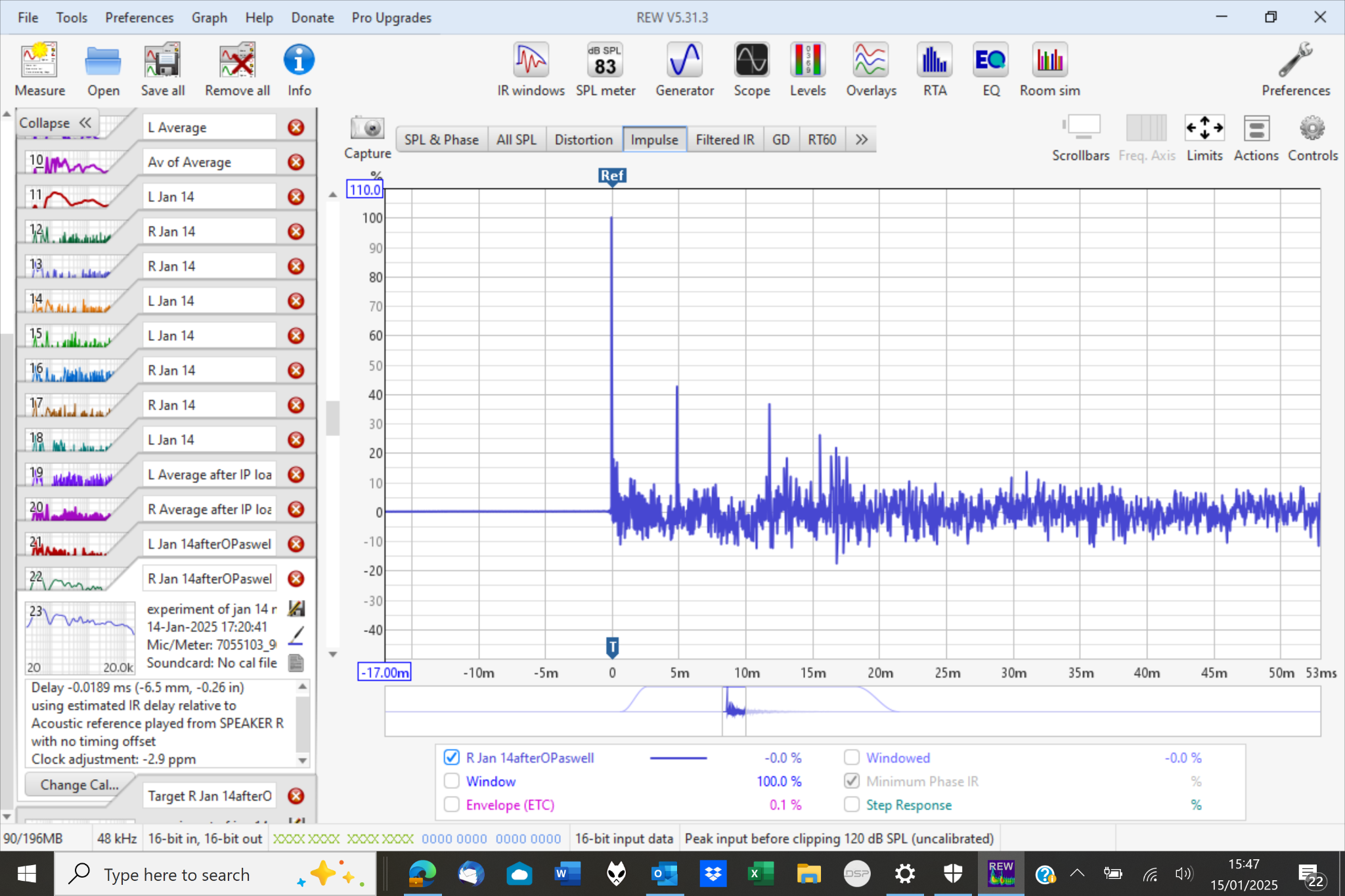

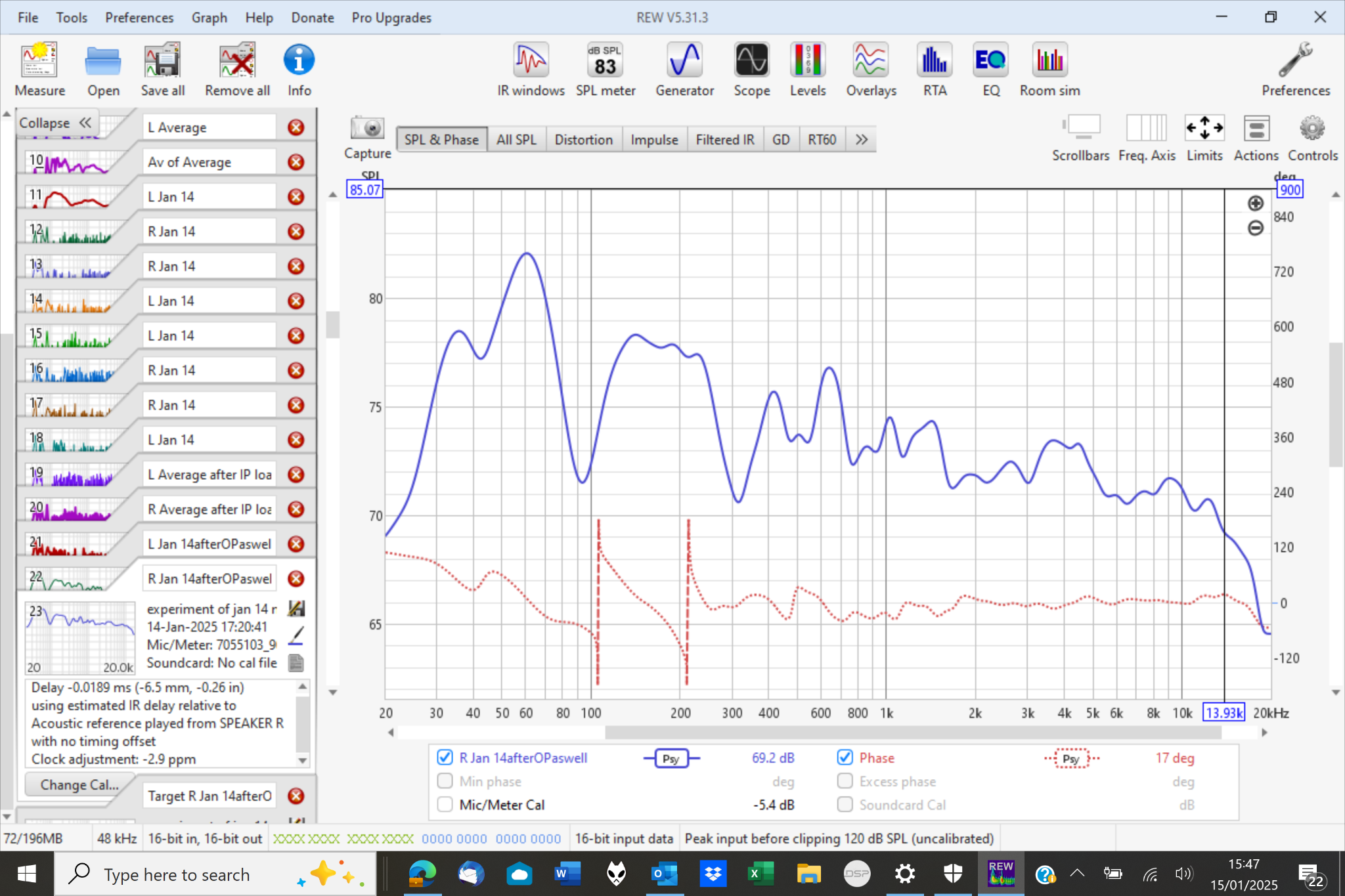

The whole REW file exceeds attachment sizes so i made some screenshots
Please be Honest!
