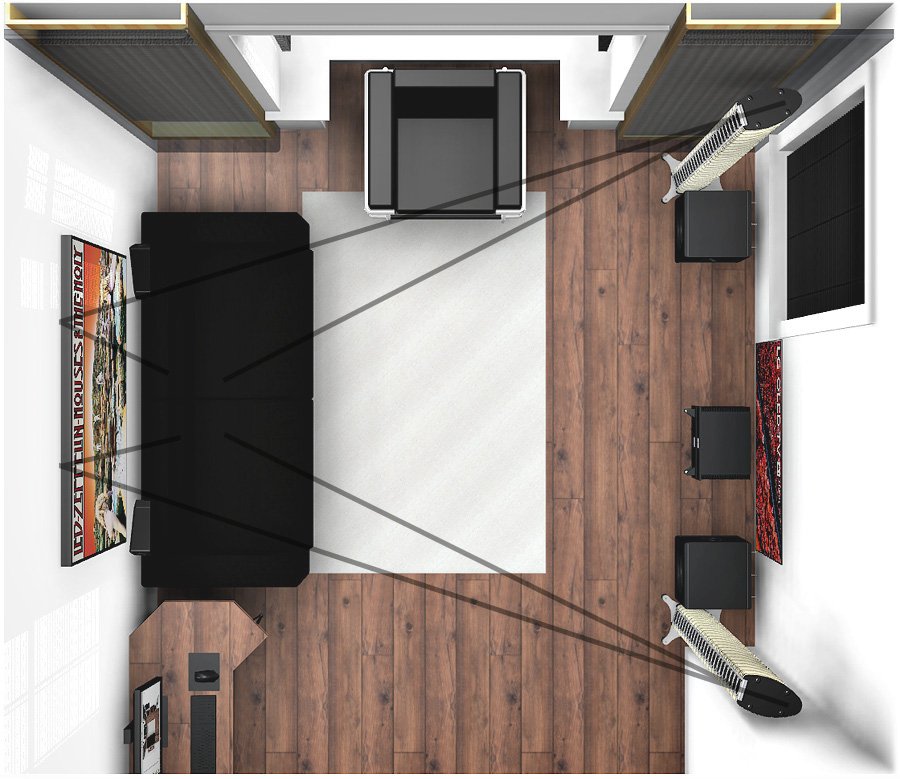

For a pure Stereo experience, there will always be one sweet spot or money seat. Equal distance to both speakers unless you start to compensate for both distance to listener and SPL levels. So yes, you can move the money seat around with some clever delay and SPL tweaks and you could save such a setup as a preference. Is that what you're asking?
I've always put my microphone in the exact sweet spot, usually takes me a couple of attempts to get it there by playing a sweep trough both L & R and aiming to getting a single IR peak. That's my money seat right in the middle of my couch. That's the spot where I base all my phase tweaks on etc. If I use multiple measurements and average it's FR is almost the same as the single spot. Probably because of the absorption I put at first reflection points.
I don't optimize for other seats even though I often sit in a lesser spot during movies etc. As long as the overal balance is right, it sounds sweet all along the couch but the money seat is just that bit better for music at least. In my previous car I've manipulated time delays and SPL levels to get the sweet spot at the driver's seat and optimized for that position. Worked quite well as this was the setup that sparked my home build.
The most important question is: what do you want to get out of it? Even when building my frequency shaded filters, I've never stopped to look at off axis positions so I could aim for a "sweet area". You could take that to the extreme by crossing the toe-in in front of the center seat. I couldn't stand how that looked with the arrays at such an angle so I never went with that. But it does have many advantages to play with toe-in like that.
Here's a good picture how I have set my toe-in:
(picture courtesy of: https://insheepsclothinghifi.com/speaker-placement-room-treatment-basics/)
Let me insert a picture of my room here:
(the lines toward the listener are hand drawn so don't draw any conclusions from them (lol))
It's not optimal for multiple seats but it worked better than aiming the speakers straight at the ear. I've played with this extensively to find my preference.
Now if you want a true sweet area, you can aim the speakers so that they cross in front of that center position:
(I would give proper rights for this picture but it looks like they too found it elsewhere)
Found this image here: https://insheepsclothinghifi.com/speaker-placement-room-treatment-basics/
The above is what Dr. Earl Geddes promotes and is known as intensity trading. With a constant directivity horn the SPL levels of the side positions will still somewhat match, as for the left listener his left ear gets sound from an off-axis angle, slightly lower SPL levels are expected there. The right ear is on-axis and has the highest SPL level but obviously the right speaker is further away. This is the intensity trading. The center (sweet) spot has both ears at the exact same angle to the speakers.
Does this help your quest? If one would want to optimize any of the seats except for that center seat, you could by adding time compensation. But generally this type of setup works quite well to get a good sweet area. As arrays SPL levels falls off less rapid with increased distance than any point source speaker you already have a benefit there. That's why even my non optimal toe-in still works quite well along a larger area. Things like a close by wall on one side of the room do mess with this ideal though 😀.

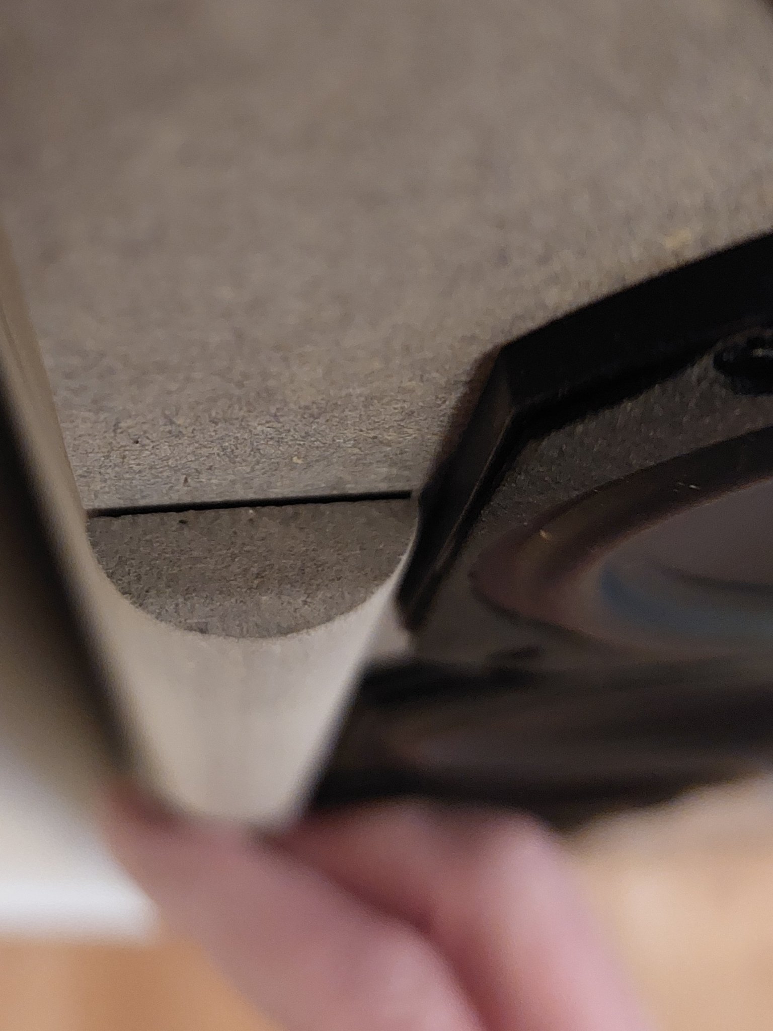

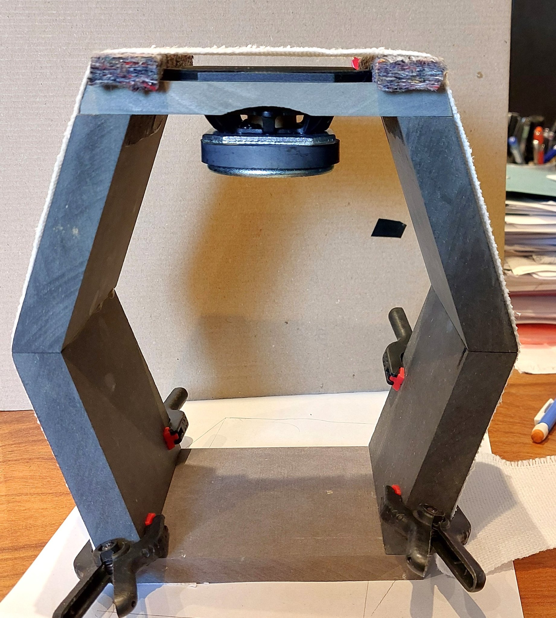

When i made the mock up i intended to have a baffle edge shape of either half round wood or felt. since then i have looked for a half round silicon rubber sectiion, all to space off the grille sock that is supposed to be present.
Any views on materials or effects please?

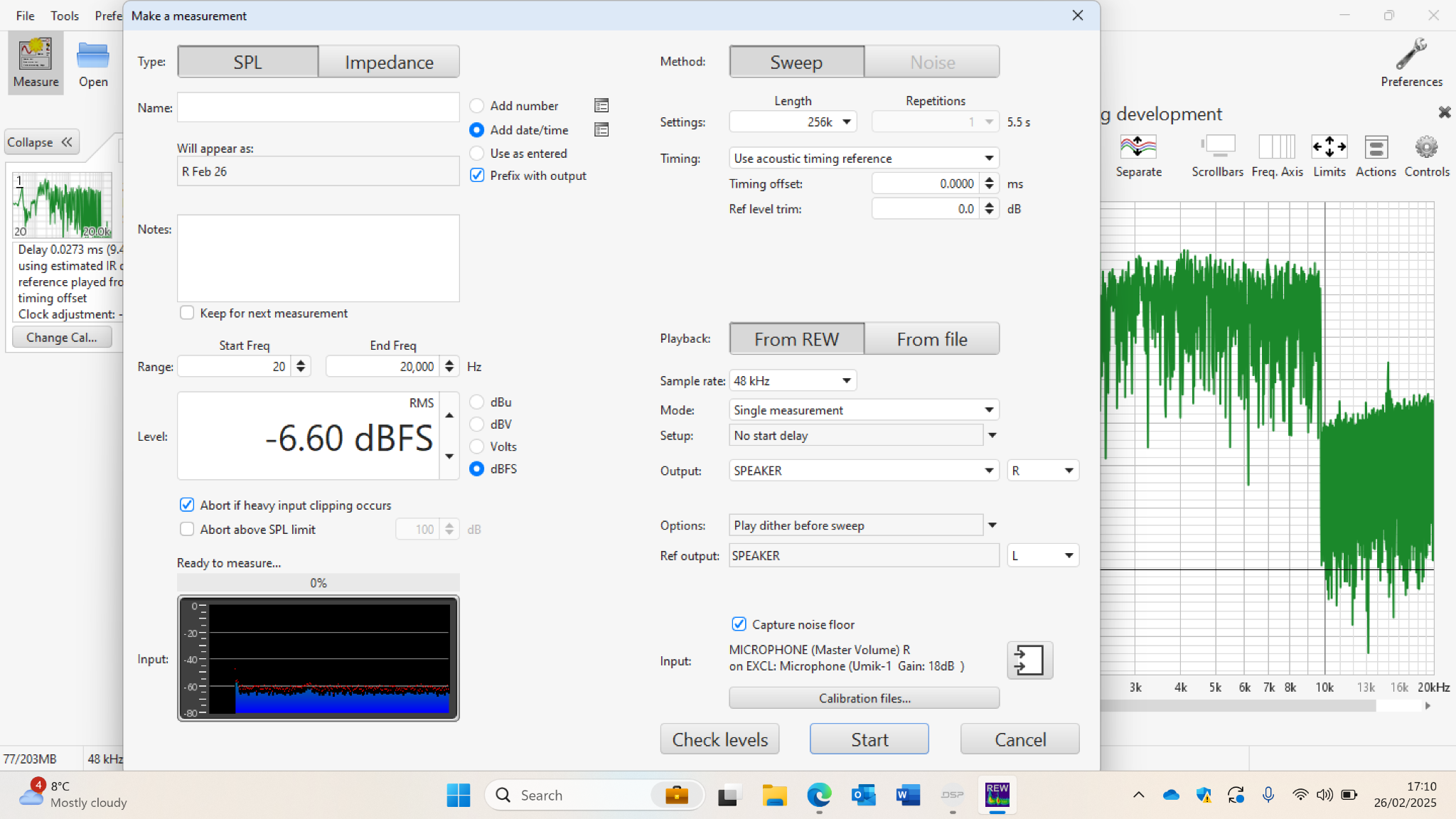

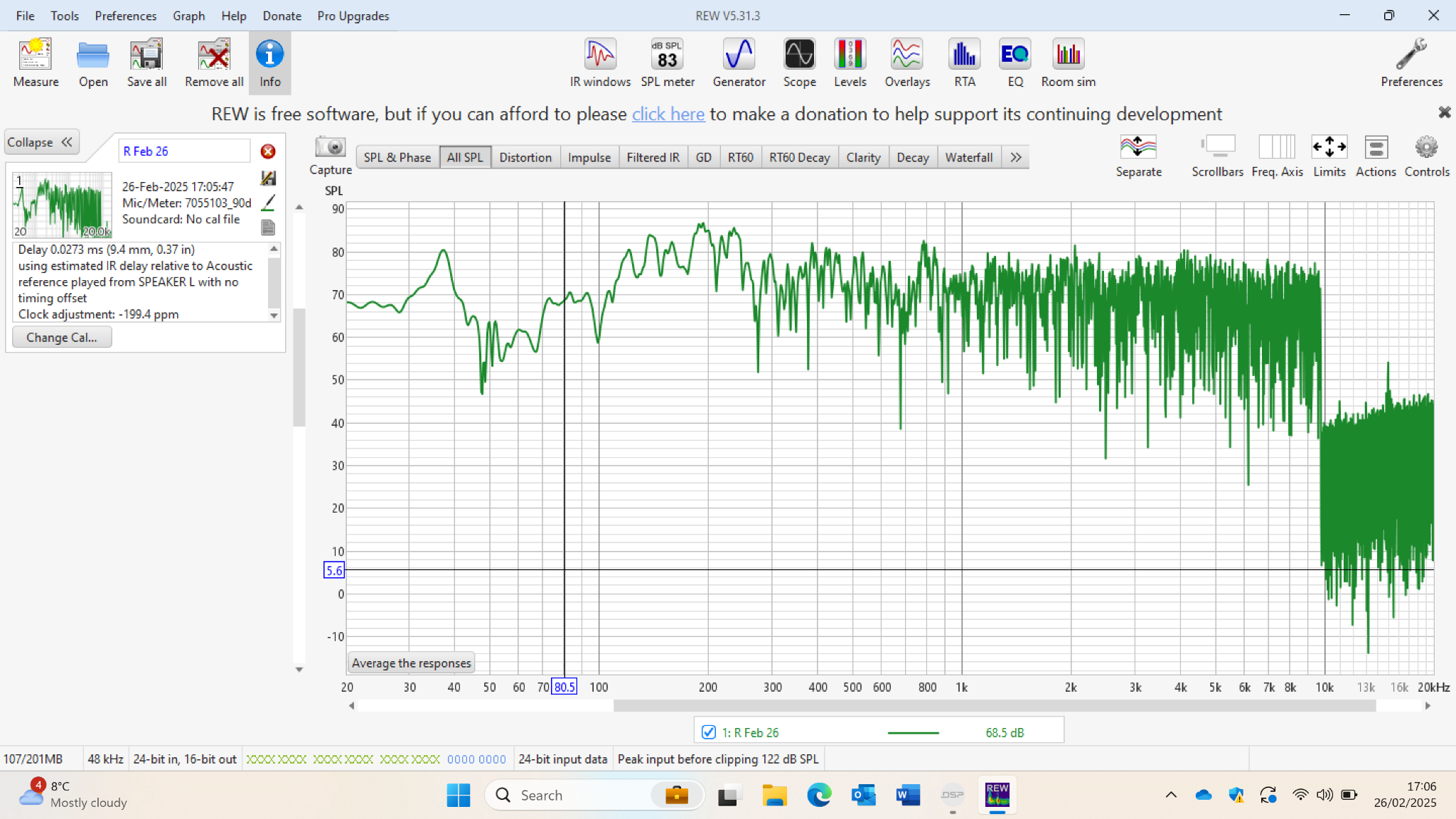

Finally thought i could get back to looking at EQ, connected up and made afirst test measure.
Abrupt stop at 10kHz puzzles me.
Sweep screen shot attached and settings screen.
All ideas appreciated as always!
M

Finally got something working by setting CPU priority to high for the Flex and REW programmes, only now need to make that permanent (i dont quite understand the instructions yet) and i can have the new computer as good as the old one, surely that should be included in the downloads?
M
However i reset filters and it all sounds pretty good now!
Reactions: perceval and wchang
My first foolishness was falling for the more power more speed idea, thinking it would be future proofed with its new Snapdragon processor, nobody mentioned it wouldn't run the old established stuff now, so that went back (and saved £500!) and this has an i9, but no-one told this one to run audio seamlessly, so i have found how to establish priority for it, shouldn't have to do all that in this era!
But my new filters are good, nice balance to the sound which, as you guys said, sounds damn good to me!
