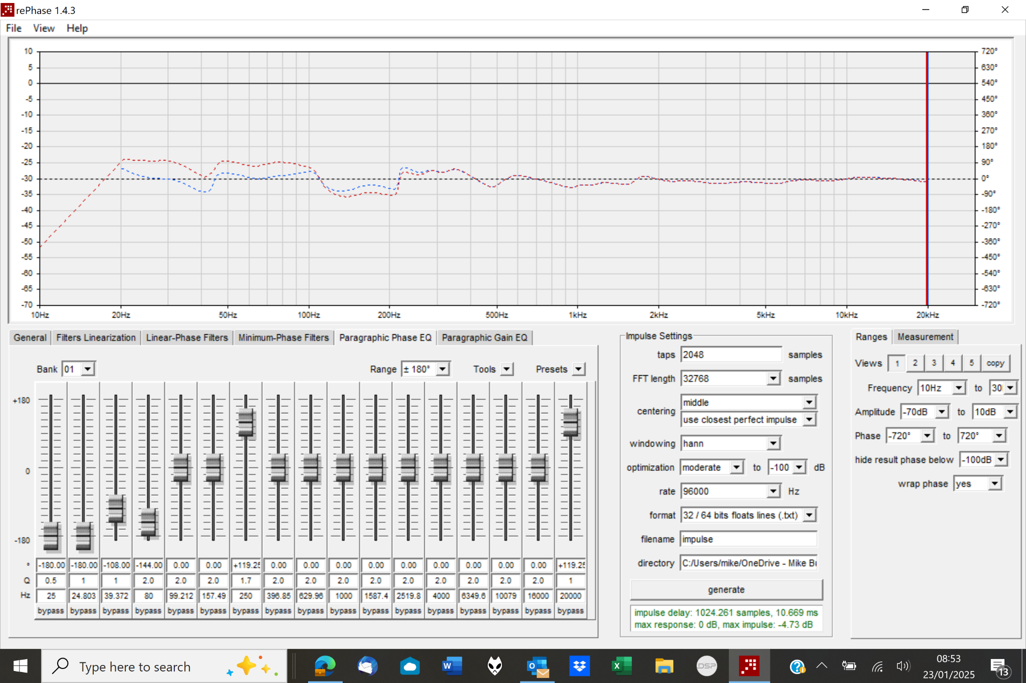

I set the impulse panel as shown on the attachment, moderate optimisation seemed to give better results, i now need to learn how to get best results from smallish (?) taps power.
That seemed to help
6 phase EQ's got me +-90, how terrible is that?

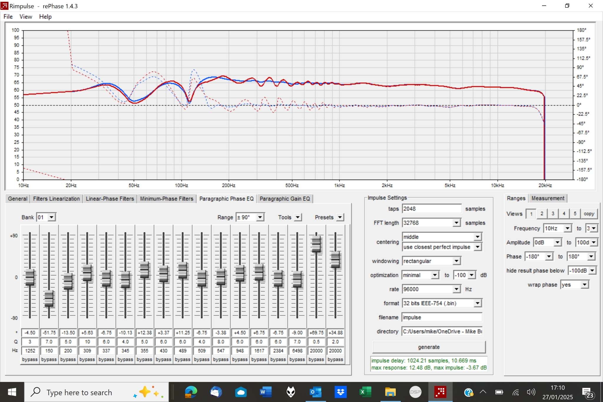

Todays update, i created and loaded and listened through some FIR based filters, mostly to prove i could do that.
No great structured listening session, but sounded to have good focus and clarity.
However, in getting there i read that my amount of Taps wont allow phase correction in the bass, i am not sure what those limitations are or how much they matter. Further, i just roughed out some EQ in 10 minutes so phase above 120Hz remained within+/- 10 or 20 degrees. how close do i need to get that for acceptable results? - and whats the truth about the bass if anyone might advise please?
I didn't yet measure the actual result, only looking at the predictions in Rephase so far.

Well, every tweak of the phase does cost some room within the limited FIR taps/file length you have available.
But using the phase compensation option within RePhase might make it easier to get rid of some excess phase rotation making it a simpler job to phase EQ the rest of it.
I'm not used to limited amount of taps and use 65536 taps on the PC. That's a whole lot more than 2048 right? So at best you'll get an approximation with that limited tap count.

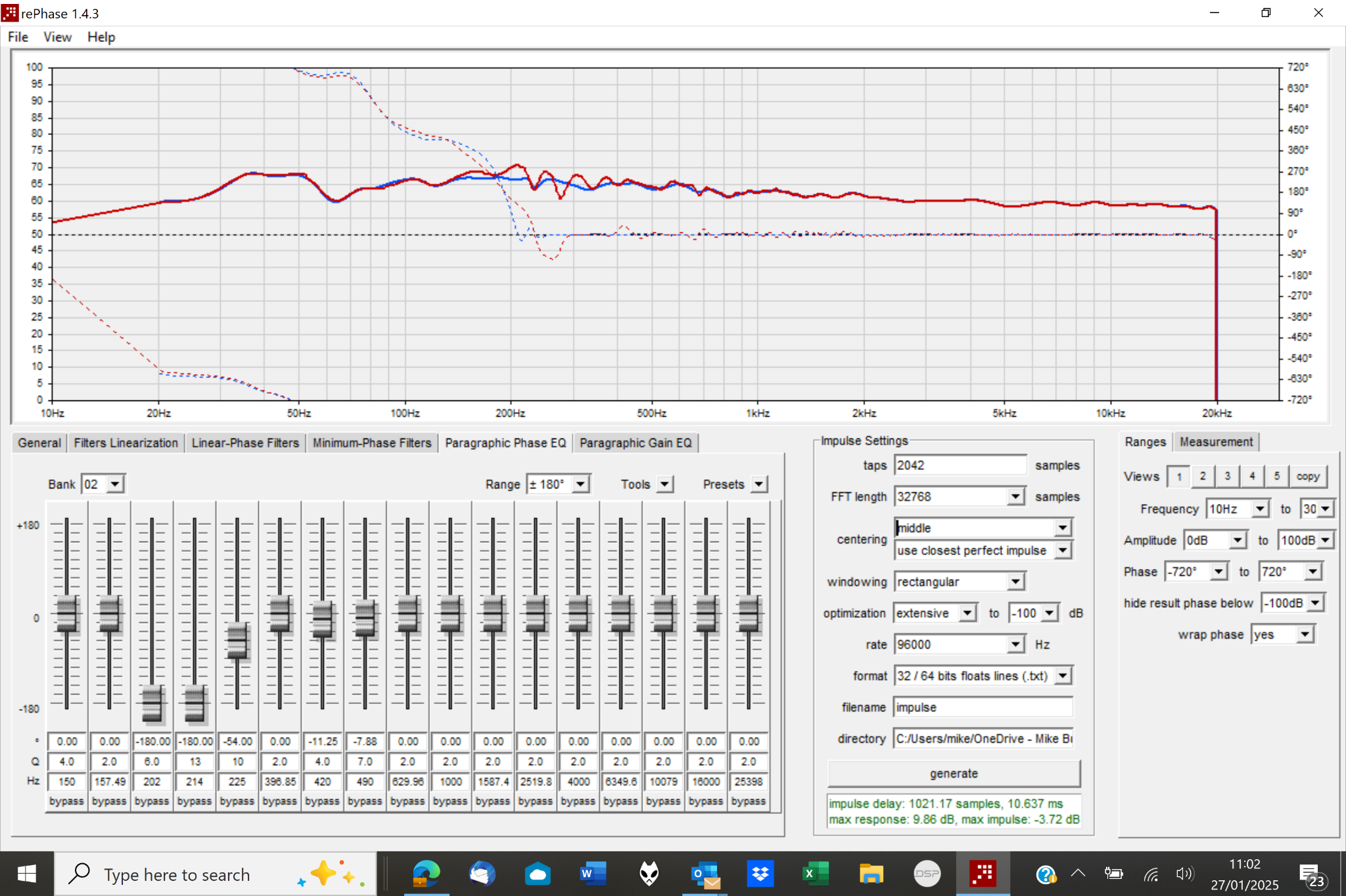

This might help? The Phase Linearization tab in RePhase is meant to compensate for a true crossover but can also be used for the linearization of the phase wraps in your case. You can set it as steep as needed and at any frequency you want. If it fits well within the limited tap size is another matter though.
You can use this for the larger correction of phase wraps and use phase EQ to fine-tune. You don't need to correct the actual roll-off of your arrays, just aim for the phase to follow minimum phase over the frequency curve you've dialed in. So if your frequency curve starts to roll off at say 30 Hz (to name a figure) don't correct the phase below that.
I tried implementation in Filters Lineraisation and it looked good until i hit create, it seems i may still be limited by the "power" available!

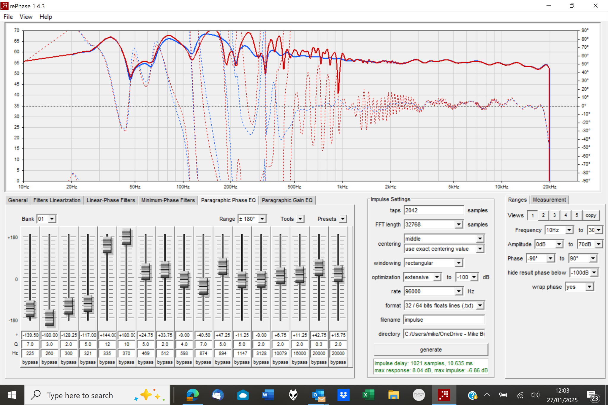

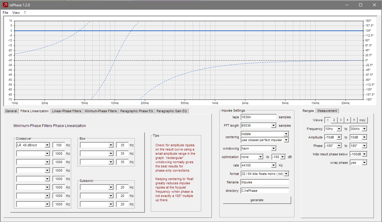

Latest report on the journey.......
I had a good play around with Rephase to try and achieve this suggestion (thanks for it) and although all looks good in the setting up, as soon as i push create with the Flex settings in place the lower frequency phase corrections go wild again, so it seems this does not escape the frequency limitation caused by relatively few Taps and High rate of Flex.
My new reading says this is approximated by (Rate/Taps)*3, so ~(96,000/2000)*3=~150 Hz, but REW doesnt use all the Filters at that level, so i thought to go higher.

What you do is that you pass the FR EQ results from a REW auto EQ session to rePhase so that all the levers are set automatically in rePhase. It takes two imports in rePhase - one for EQ data and one for phase. You still have to tweak the phase manually if you want that...
At least that is how understand it and have made it.
So the target curve is achieved by using a target curve in REW EQ and then export the EQ PEQs data - so no targets to rePhase for FR. And not for phase either - you need to tweak it by hand to zero as you have already done...
Did you use a frequency dependent window to export to RePhase? I'd say 6 cycles being enough to prevent over-correction. Obviously, the right side suffers from being close to the corner and has lots of reflection within that measurement. I'm hoping a 6 cycle window might reduce the consequences of the reflections somewhat?
I have gone for 4 as an experiment.
However i cannot get it to save as .bin, which i need, even though i believe i set it to do so..............
I will have set something wrong but dont know what?
Any ideas welcome and i shall play around meanwhile!
