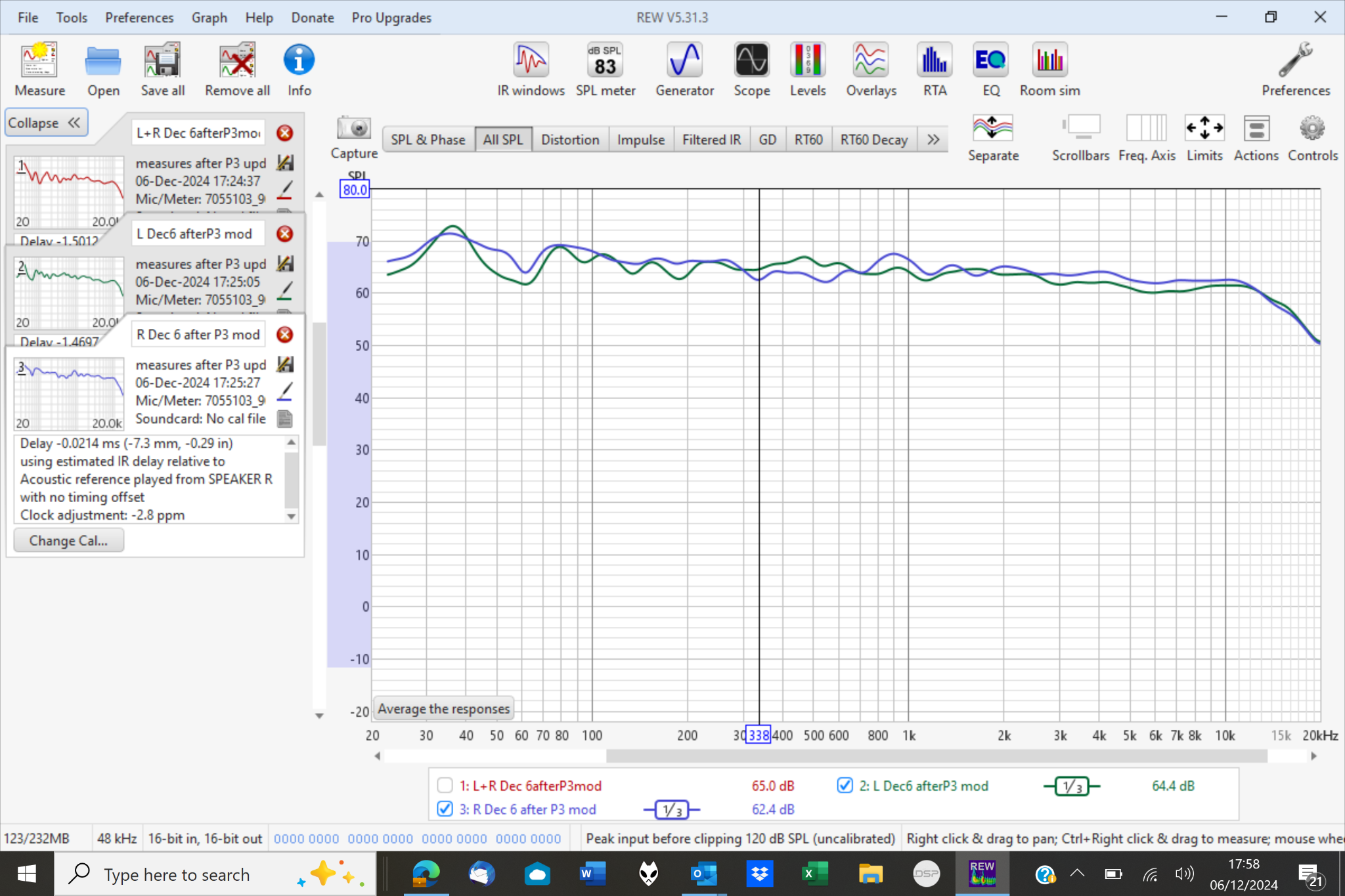

Meanwhile I learnt to input a couple of shelf filters by hand to bring the high and low frequencies near the target curve before asking REW to match the target line and got the attached measured channel match after that. They match the target curve well.

Thanks Karsten, i hear it being not harsh/tiring.
One learns with use, and i have a long way to go!
Inevitably other things change at the same time because to achieve that filter input using REW and Biquads and there are only 10 one has to free up some resource, so i find it very difficult to make and listen to and measure only one change at a time. one way to free resource is to ask for a looser match to the target (2Db instead of 1)
That may be a limitation of such user friendly approaches.
So far i have found it very convenient to input the filters this way and the Flex also provides good input selection and controls.

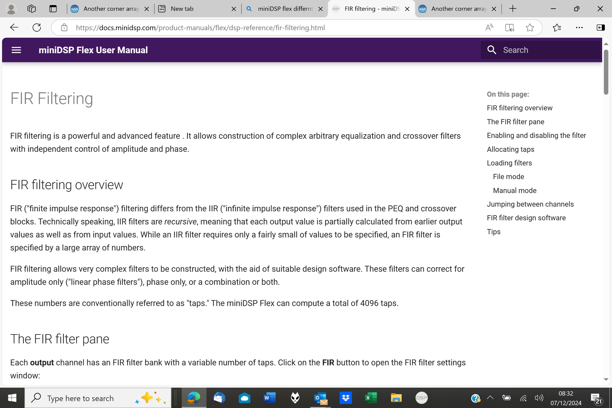

Now, it also allows/provides FIR filtering, see a page top of the manual attached, although i must admit i have never seen it yet, that may be because i already used PEQ and that one can only have one or the other, not both?
Is this a more powerful/refined approach that TNT suggested earlier? - a whole new learning curve perhaps, but we have storms this weekend!

I believe Flex only allows use of FIR on the output side, so currently my thought is to use IIR on the inputs and FIR on the output.
Separately i will look at FIR and phase.

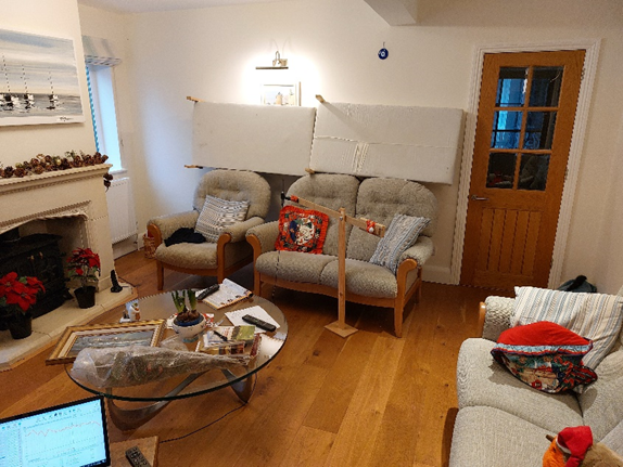

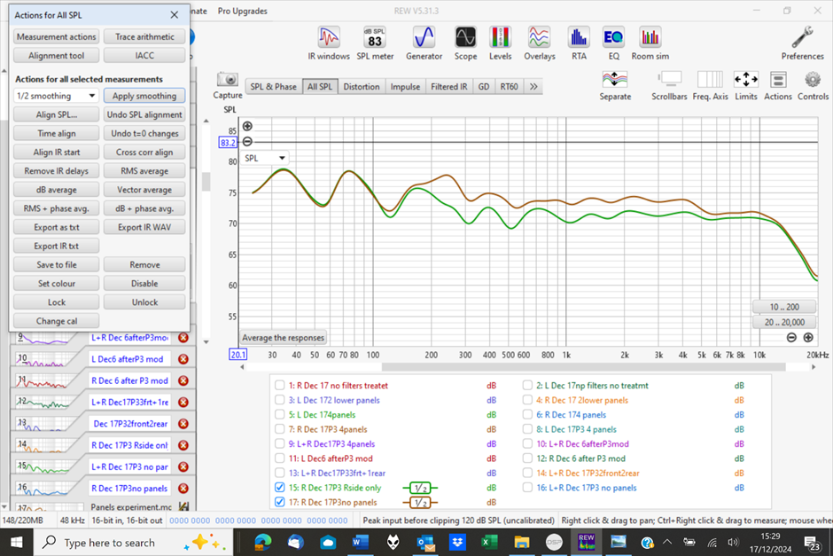

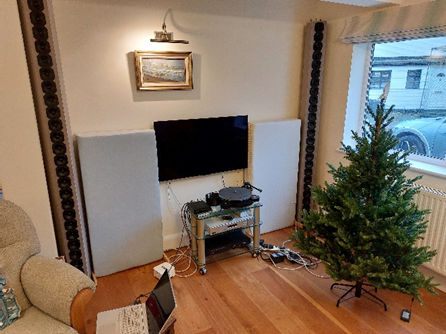

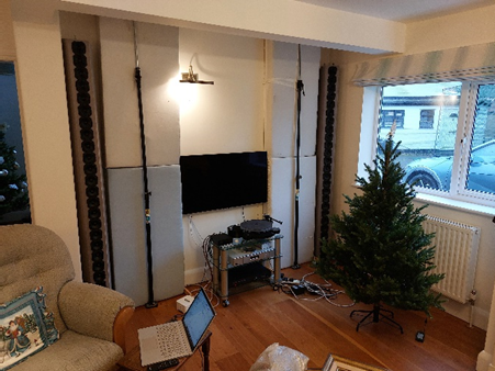

Knowing it will take me a while to get into RePhase etc i decided to tinker with some room treatment experiments.
When I say tinker, I mean I have 4off 150mm High density Rockwool panels 1200mm x 600mm which I made for a different room and different set up.
So, I carried these across and did 3 series of experiments, which as I write about them I see could have been done more consistently!
Diffuser also in place

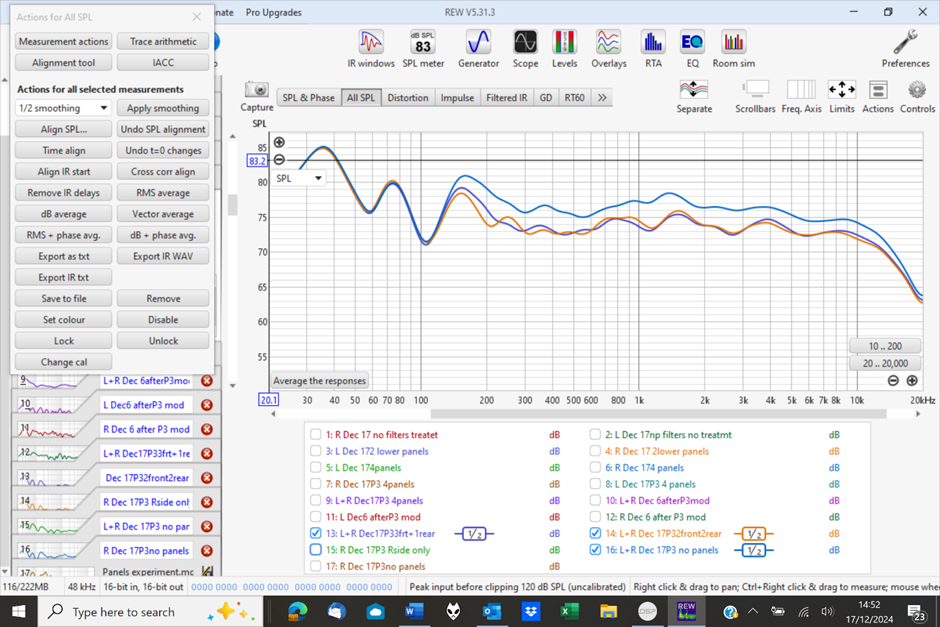

Series 1, No EQ add panels to the front wall.
Series 2, with my current EQ move some panels to the back wall.
Series 3 Look at the first right side reflection, NB the left side is about 2m of open space.
I looked at them with various smoothing applied and found heavy smoothing to be revealing about the trends.
I did some L+R, some L or R but the trends are similar.
Series 1
2 panels low on the wall didn’t do much really.
View attachment 1395013 View attachment 1395014
4 panels covering more of the wall higher up started to lower some peaks by a few Db after 80Hz and may be worthwhile and caused some dips at 600-800Hz. Don’t worry about the props, i didn’t want a catastrophe!
In both cases the effect at higher frequencies above 1000-1500 Hz seemed small.
Lower panels only above
4 panels results above
Series 2
Moving some panels behind the listening position reduced some peaks by a few DB from 150 Hz upwards.
Series 3
I put two panels on the Right side of the right speaker, in a position that wouldn’t be practical but I wanted to measure the effect, forgot to take that picture it seems but imagine the radiator and window and wall next to the speaker covered up by the panels used previously.
This took a bite out of peaks at 250Hz plus.
In review, nothing i did touches anything below 80Hz – i have elsewhere, used MLV in combination to some better effect lower down.
It may be practical, with the approval of management (!) to treat the front wall by building a shelf for the equipment below the TV and covering the whole wall to the depth of the TV (150mm) which would mahe the TV appear flush and tidy lots of things………..wiring behind the wall etc
The rear wall treatment would have to be very clever and good to gain approval
The RHS could combine with the front wall project, but would be thinner and less extensive than my experiment.
If i made some combination of this lot would it be worthwhile?????
