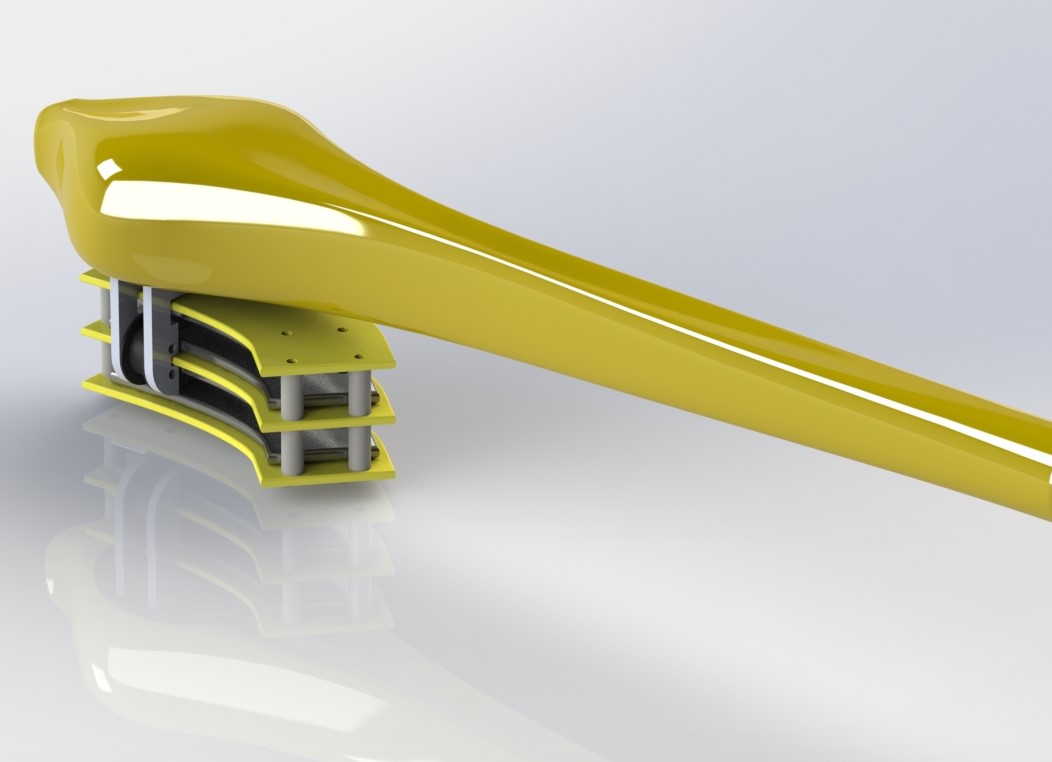

Here's a doodle for a pivoting arm on a rail that I've been dreaming of building.
Uses a single phase rail.
Devil is in the software, angular chip (fallback is linear encoder) measures the offset from zero to drive the rail (it's not linear), but the bobbin's tangential line does not follow the record's. So there is a variable change in the distance moved:rotation of pivot.
I'm banging on that atm.
It does not need to be bent, a straight linear slide can achieve the same result.
Oh my goodness, you are right.
Back to a simpler drawing board then. 😛

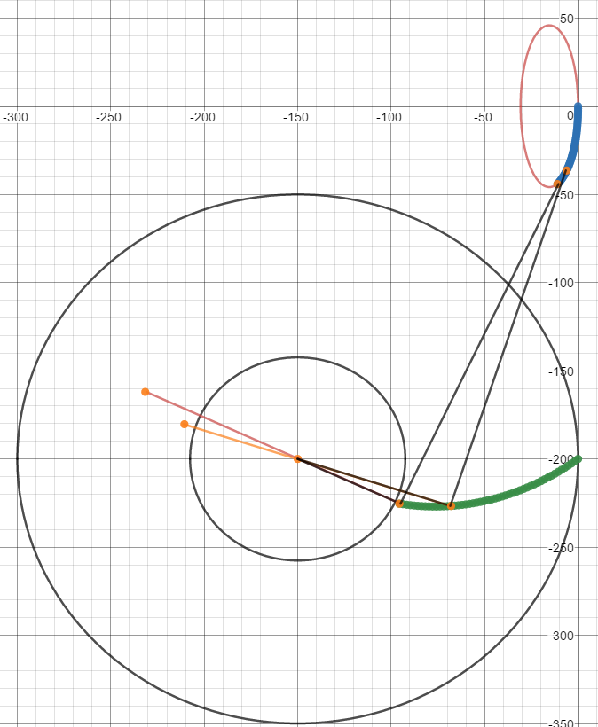

Is this the curve you have in mind? The segment out of a Birch geometry?
No not at all, it's the tangency curve from another mechanical arm I tried to design. I got too involved in the math of that curve and tried to use it with a servo design where it's not needed.Is this the curve you have in mind? The segment out of a Birch geometry?
It's this one
I didn't know you were talking about the green curve. I was referring to your blue curve and my orange curve having similar function, since your yellow arm in the picture sits on a curved rail.
