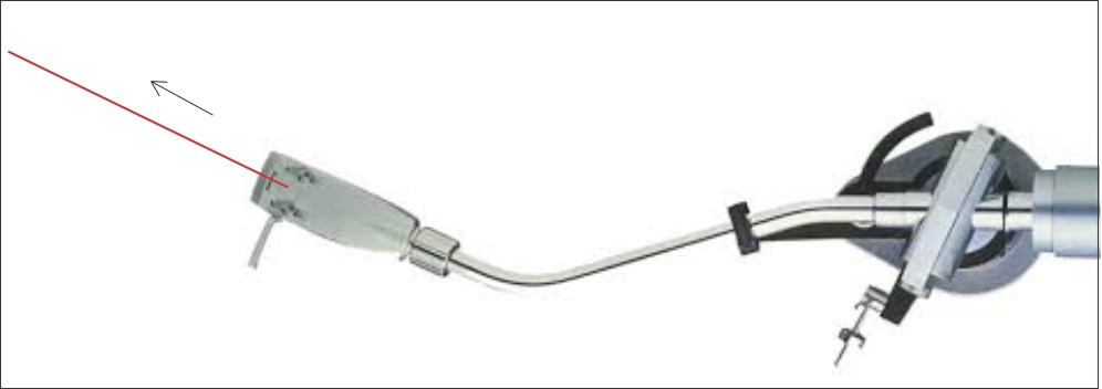

alighiszem,
The test you describe is correct, but you are a latecomer crashing the party with this one. If everyone would read my post #949, I proposed this exact test a year ago on this thread.
In post #949 I said:
See post #949:"Rather than engage in debating theory, I propose a simple litmus test for determining whether a given arm design is susceptible to skating forces or not:
Take a string 12” or longer, it doesn’t really matter, and tie it to the headshell or the cartridge body so that it stretches straight out from the cartridge and in line with the stylus. Balance the arm for zero VTF and let it float above the record surface. Now, gently pull on the string along the axis of the cartridge and in line with the stylus. In a true linear tracker, the arm will stay put as the string becomes taut. In a conventional pivoted arm, the arm will veer towards the spindle as the string becomes taut. With a multiple linkage design arm, if the arm veers in either direction over any tested area of the record surface, then it is susceptible to skating effects induced by stylus drag, at that tested area."

2wice,
Please see my litmus test for skating in post #949:
http://www.diyaudio.com/forums/analogue-source/165878-angling-90-tangential-pivot-tonearms-95.html
The string test is unambiguous and separates theory from fact. As a practical matter, the string should be attached to the headshell, not the stylus. We don't want to damage the stylus and besides, it would be hard to tie a knot that small! Pulling the string in line with the headshell, i.e. tangentially, simulates the stylus friction force. Yes, the simulated 'friction force' is tangential, but if the tangential string force vector is offset or not in line with the pivot, be it fixed or virtual, the tangential friction force will resolve itself into some rotary component about the pivot point, and this manifests itself as skating. The various types of 'multiple linkage' arms might have a fixed pivot (like Garrard Zero 100) or a motion that behaves as a virtual pivot which may move (like a carriage moving on curved rails like yours).
It can be difficult to visualize the forces on a complex linkage, but the litmus test is definitive. Pull on the string. If the headshell moves sideways, then the arm will skate.
Ray K

The trajectory of the stylus will have a component in the direction in which it is pulled AND a component toward the spindle, since it moves on the Thales circle. The component toward the spindle is the skating.
2wice,
Thanks, I get that now.
I was hoping for a clearer theoretical explanation, but a physical test will. do.
As a thumb rule: skating can be excluded only when the trajectory of the stylus is straight (speaking of tangential arms, of course).
Like this string shown in red and direction ?Pulling the string in line with the headshell, i.e. tangentially, simulates the stylus friction force.
