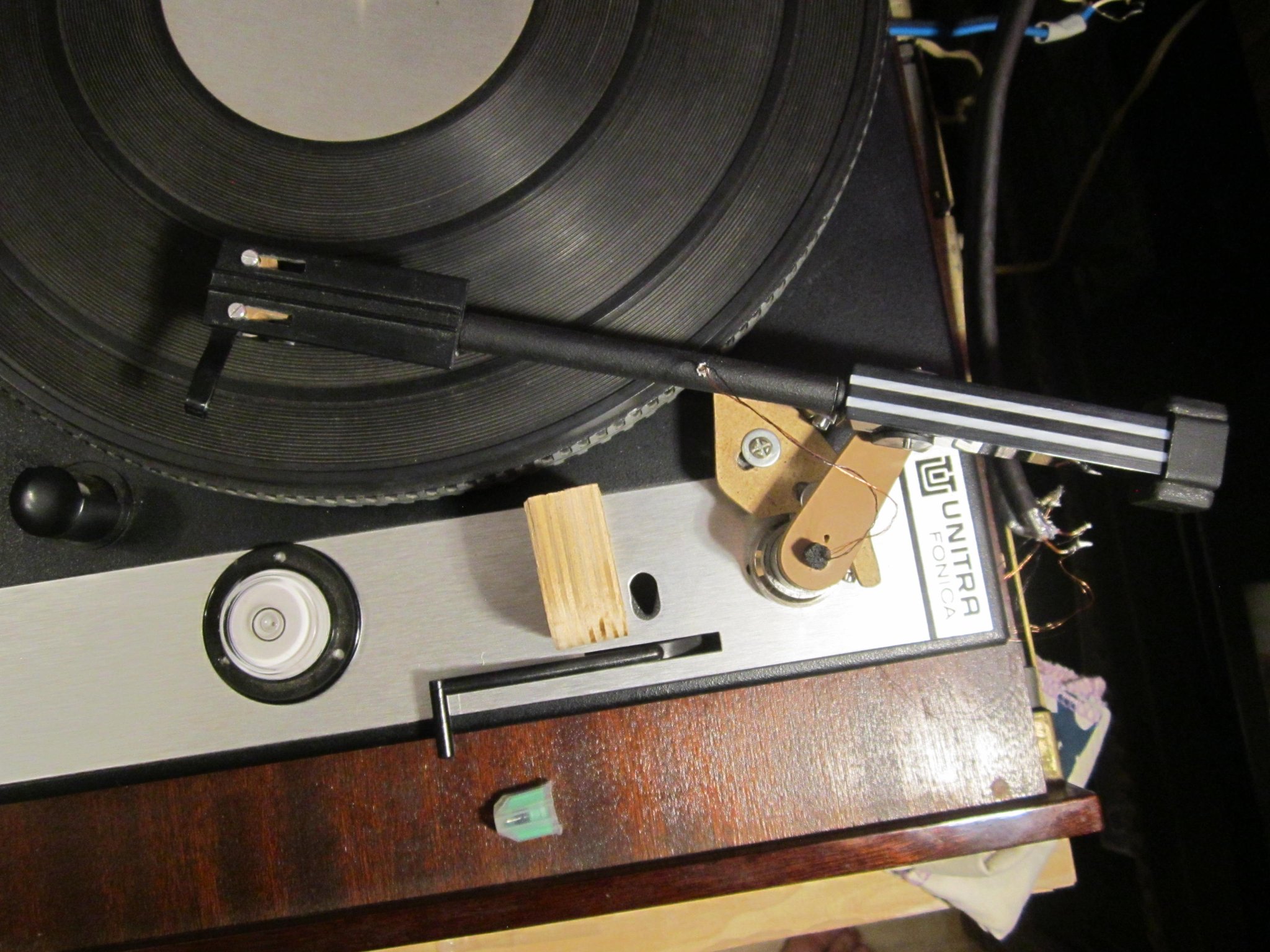

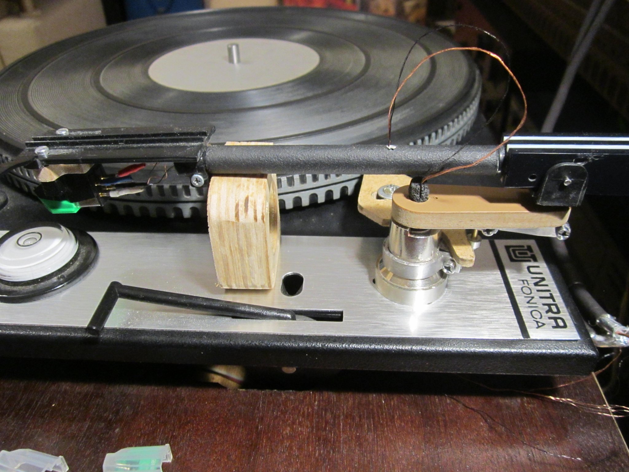

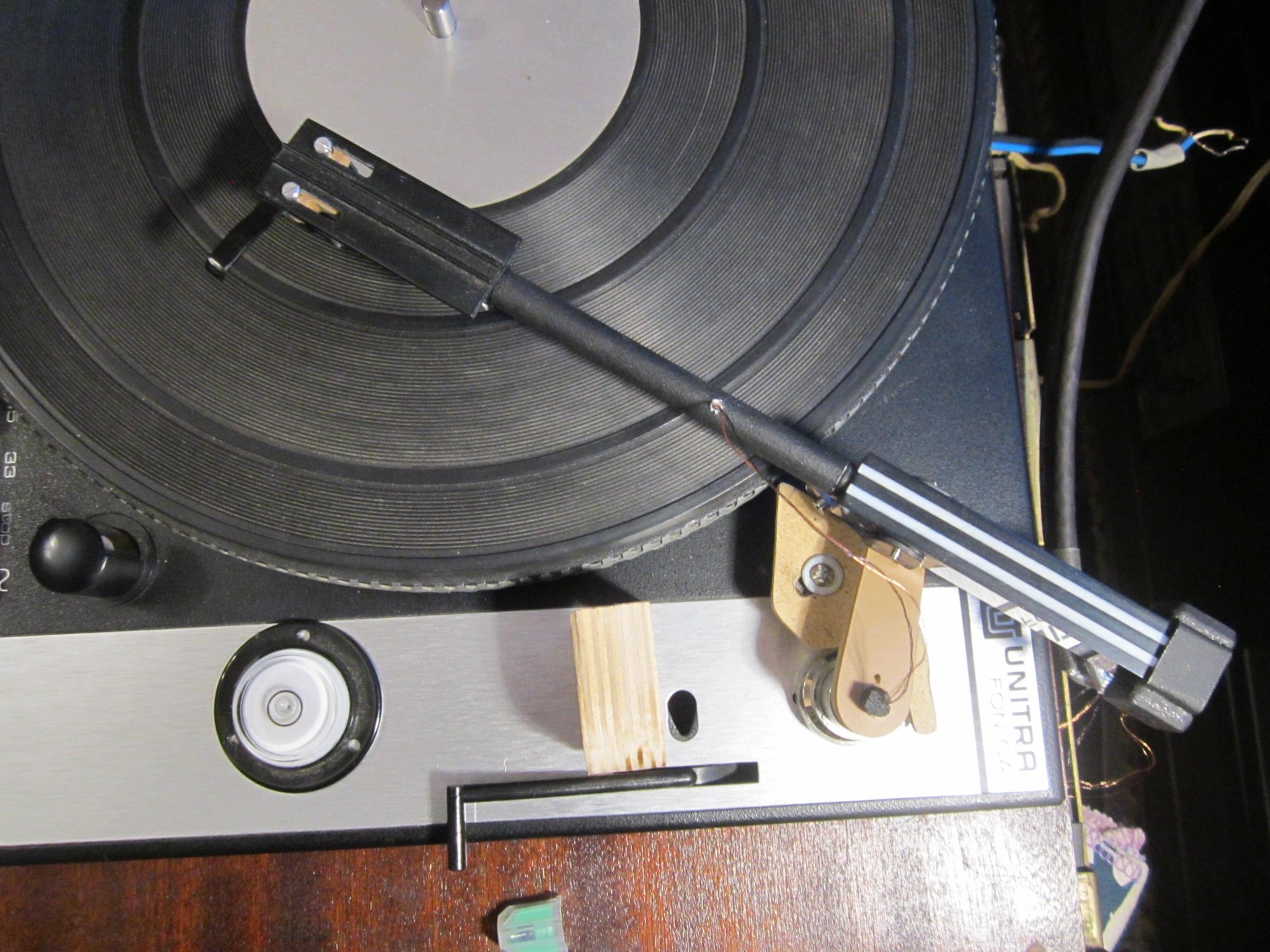

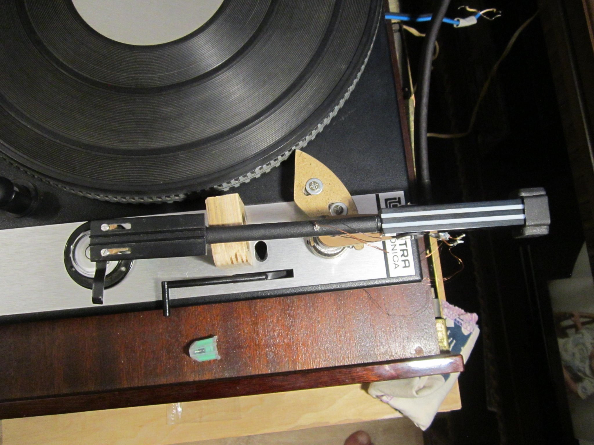

hI,

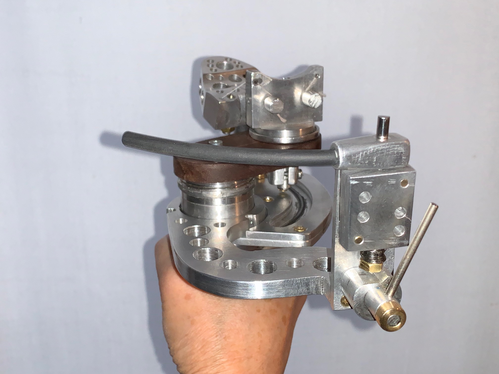

I got all the parts for the new lighter wand, now need to find the time to finish it.
I also got the new parts for the ceramic bearings , also need to find the time to finish it.
Completed the TA lift.
Rgds
Adelmo

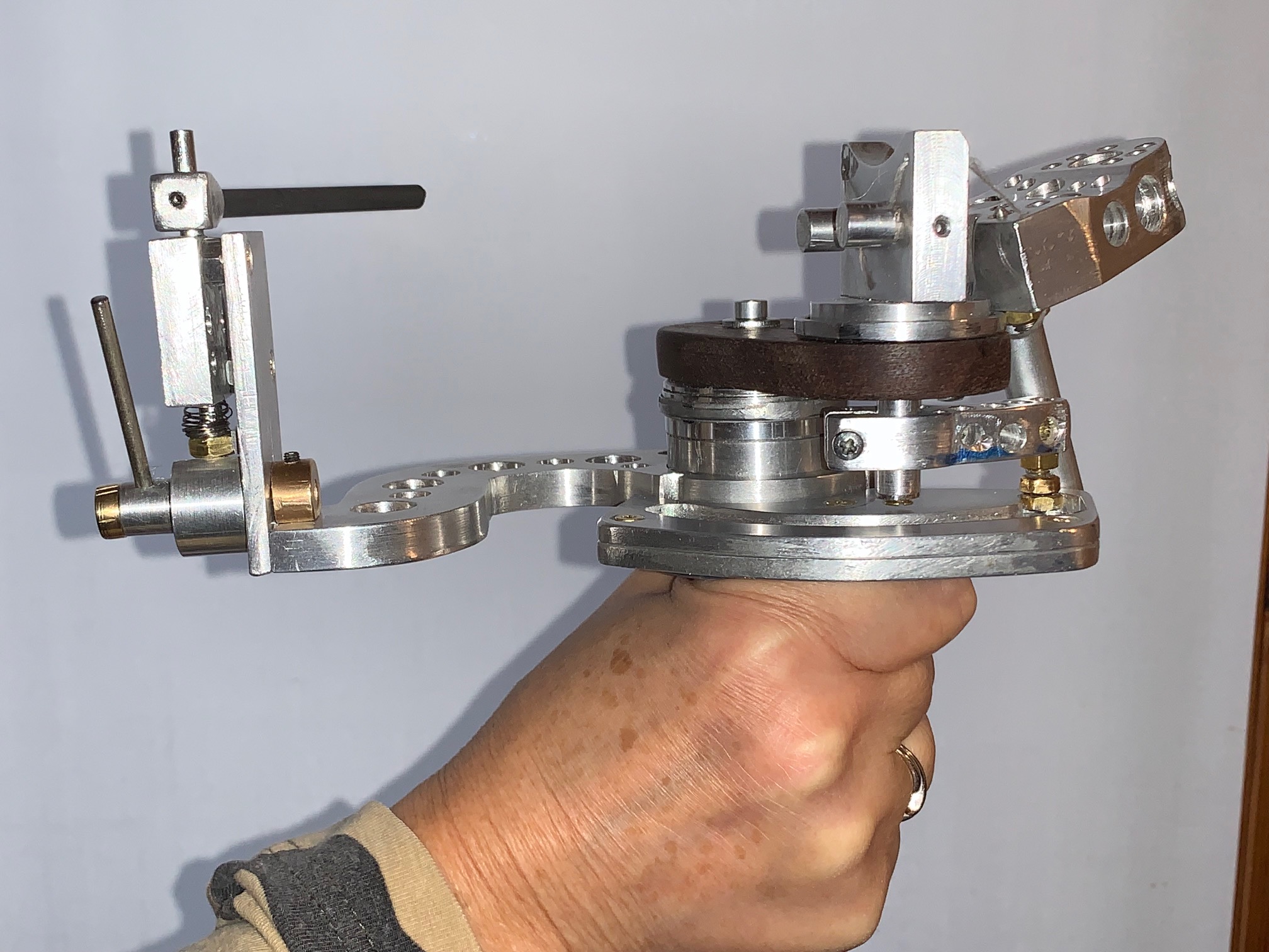

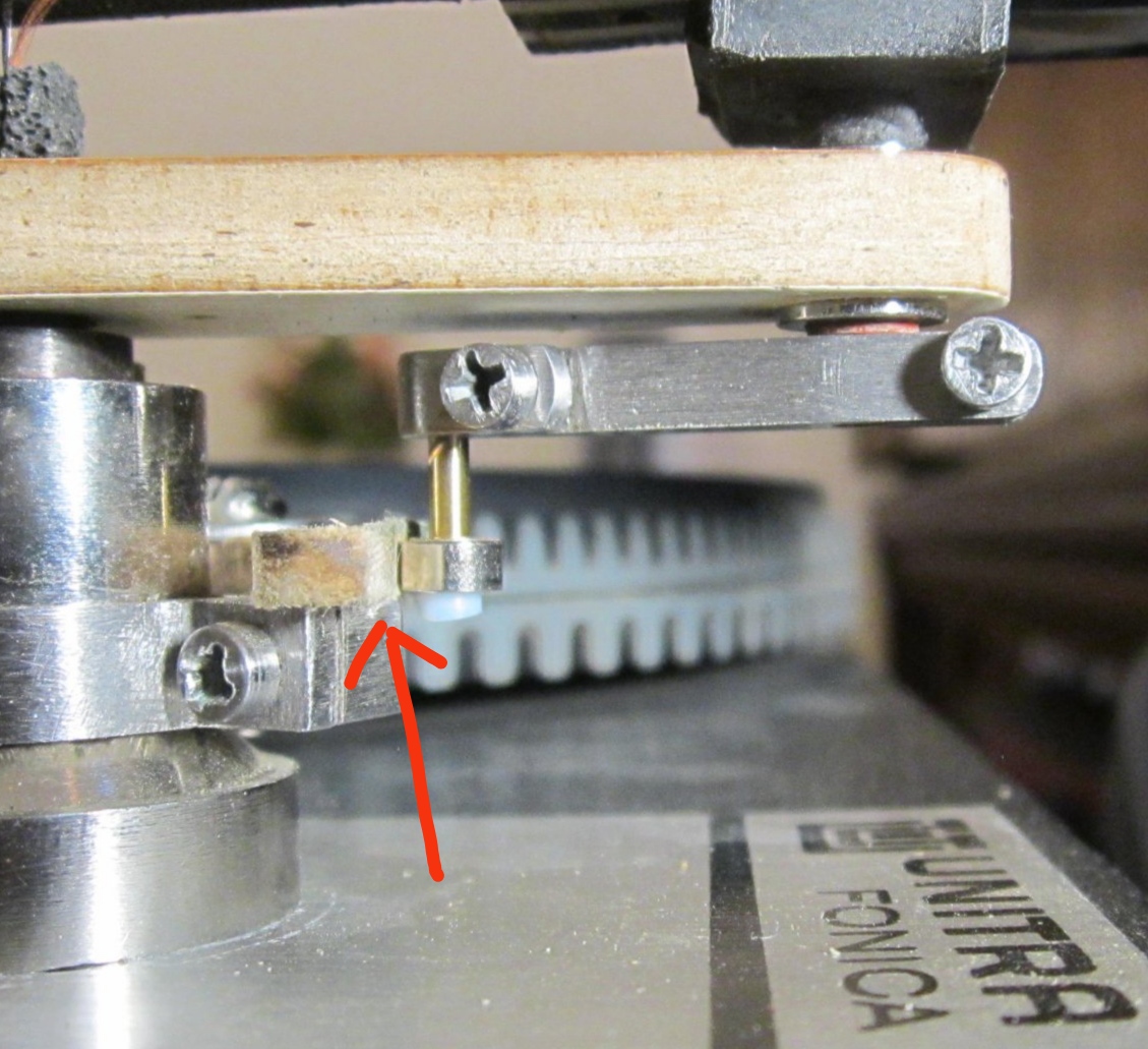

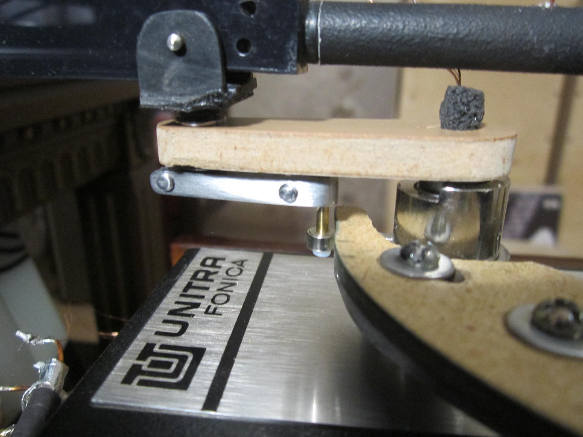

Hi Niffy,
I have careful assembled the ceramic bearings in the secondary shaft of my TA. I paid lore of attention to the bearing house allowance and also to the shaft. Must slide smooth but not tight not lose. I also pre load checking the best pre load for turning and no play.
Mechanically speaking it is better, also the new design make more easy to pre load bearings.
Changed the thread of the V motion bearing as I stressed them too much lately and play Rickie Lee Jones, Pirates, 1981 LP. I will not dare to say it sounds better yet but for sure not worse at all. I compared the same music since I have the same CD as well, but CD did sound too much worse. Hard to say, I think the CD have been poorly mastered comparing to the original LP.
In the end I will keep the things for a while as they are, in future I may try other bearings as suggested.
Tks n rgds
