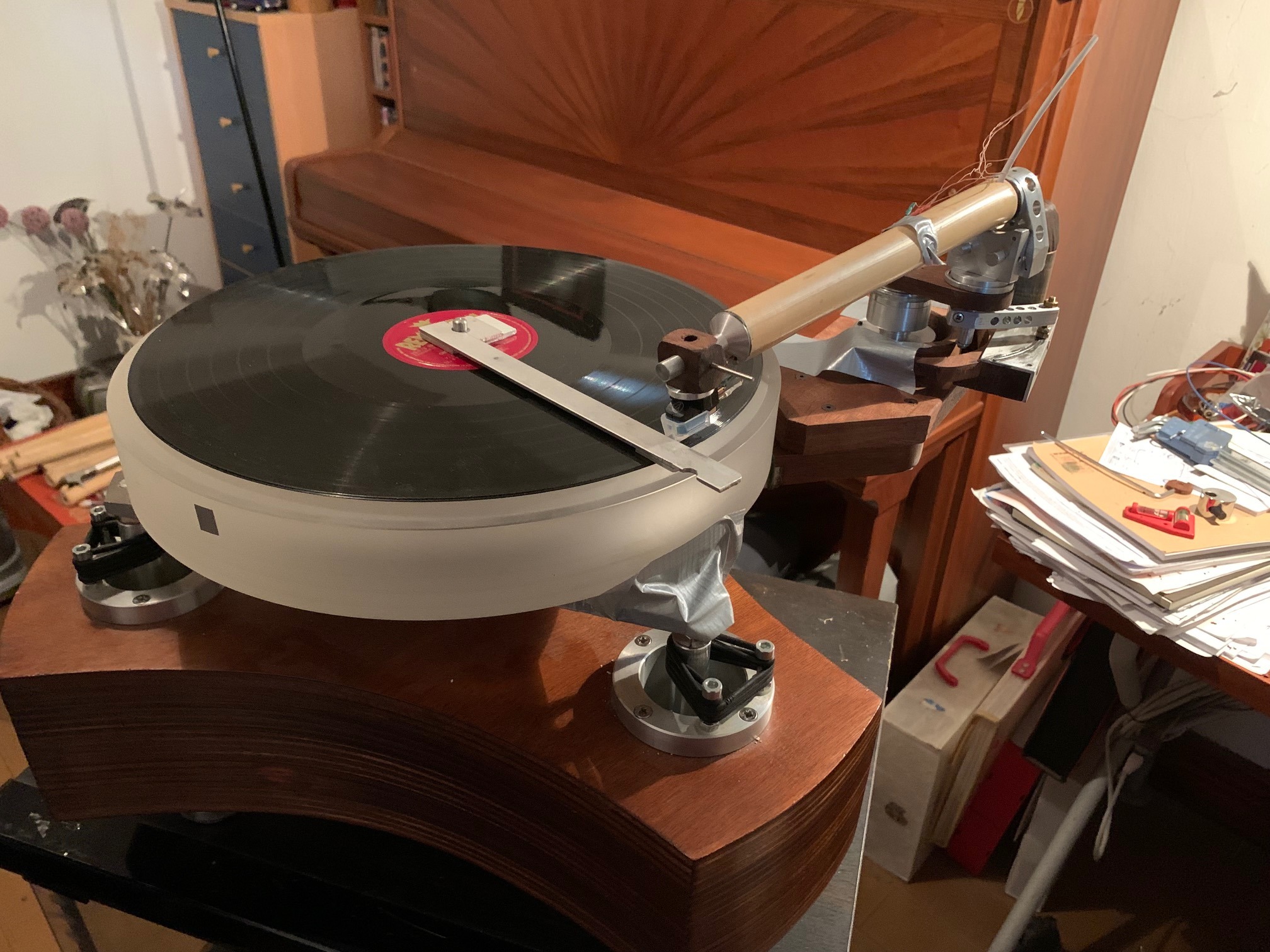

Decided to test the LT clone with my floating TT hoping shall work despite the floating. Decision made since the Lenco need too many upgrade and not in the mood to make them now.
Since the mag cam is separated from the tonearm, I need some tweaking to fit it on this TT.
Work ing progress.
Rgds
Adelmo
Work ing progress.
Rgds
Adelmo
As I supposed my floating TT is not the best solution for my rough LT clone. The TA need a steady not floating TT.
However at the present I am using as it is, need to be soft in cueing the TA due to the floating. Also bit more difficult the precise and good tuning of the whole TA as levelling is much sensitive.
Perhaps I have to take in serious consideration to build a good Lenco based TT for this TA.
I have to say that AT cart is very strong, despite my mishandling playing around with this TA, the AT cart is still working!.
Rgds
Adelmo
Rgds
Adelmo

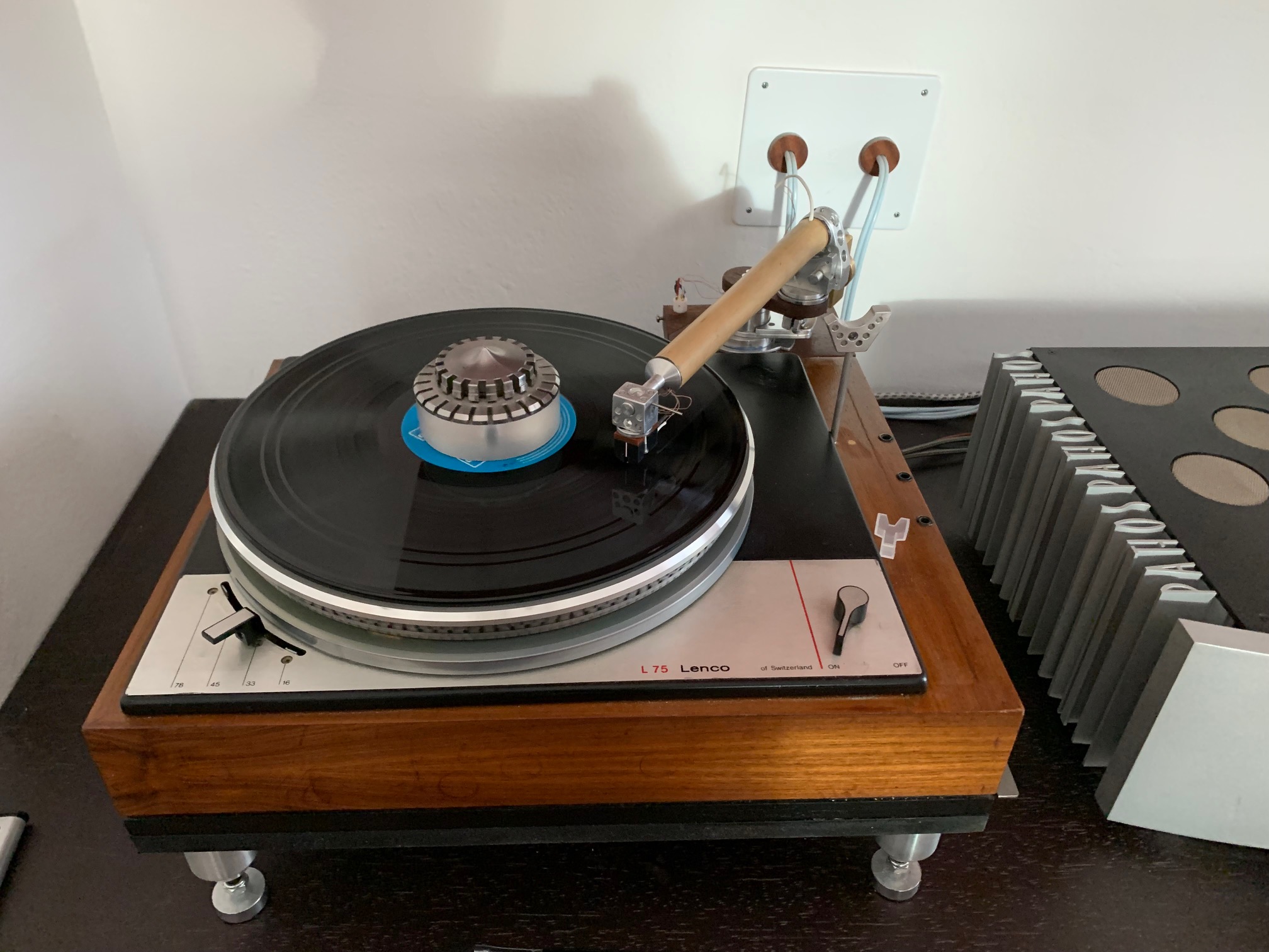

Adelmo,
Congratulations on reaching the record playing/testing stage. A fixed stable TT will really help. Could you put blocks between the platter support and the feet or base?
Doug

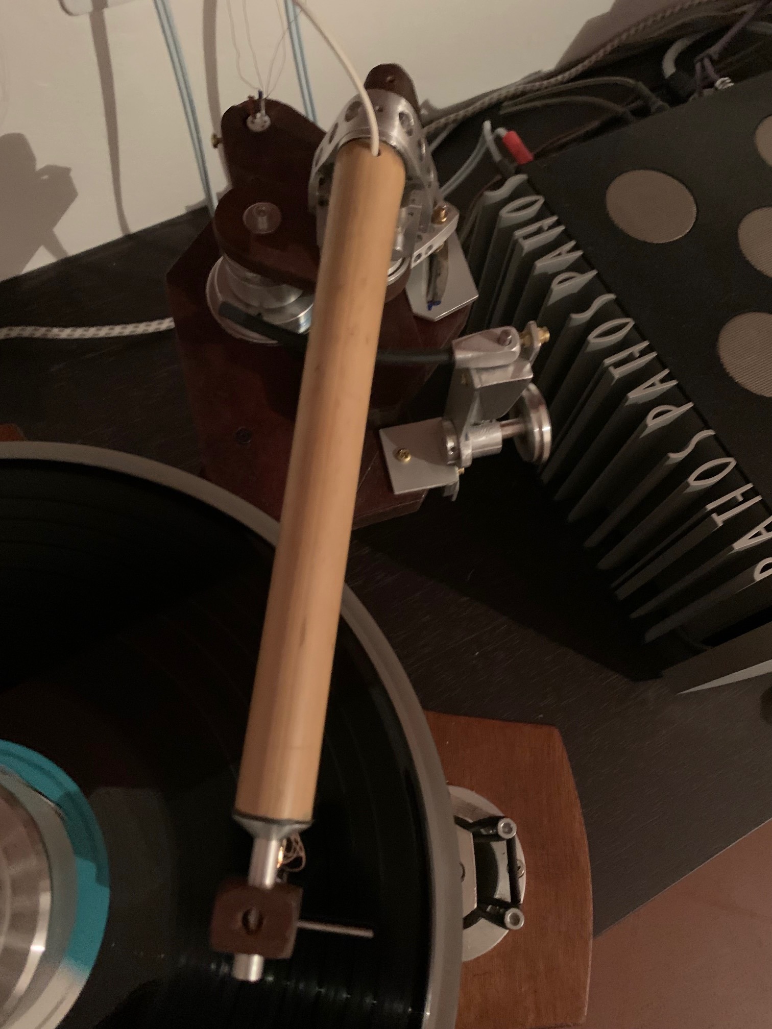

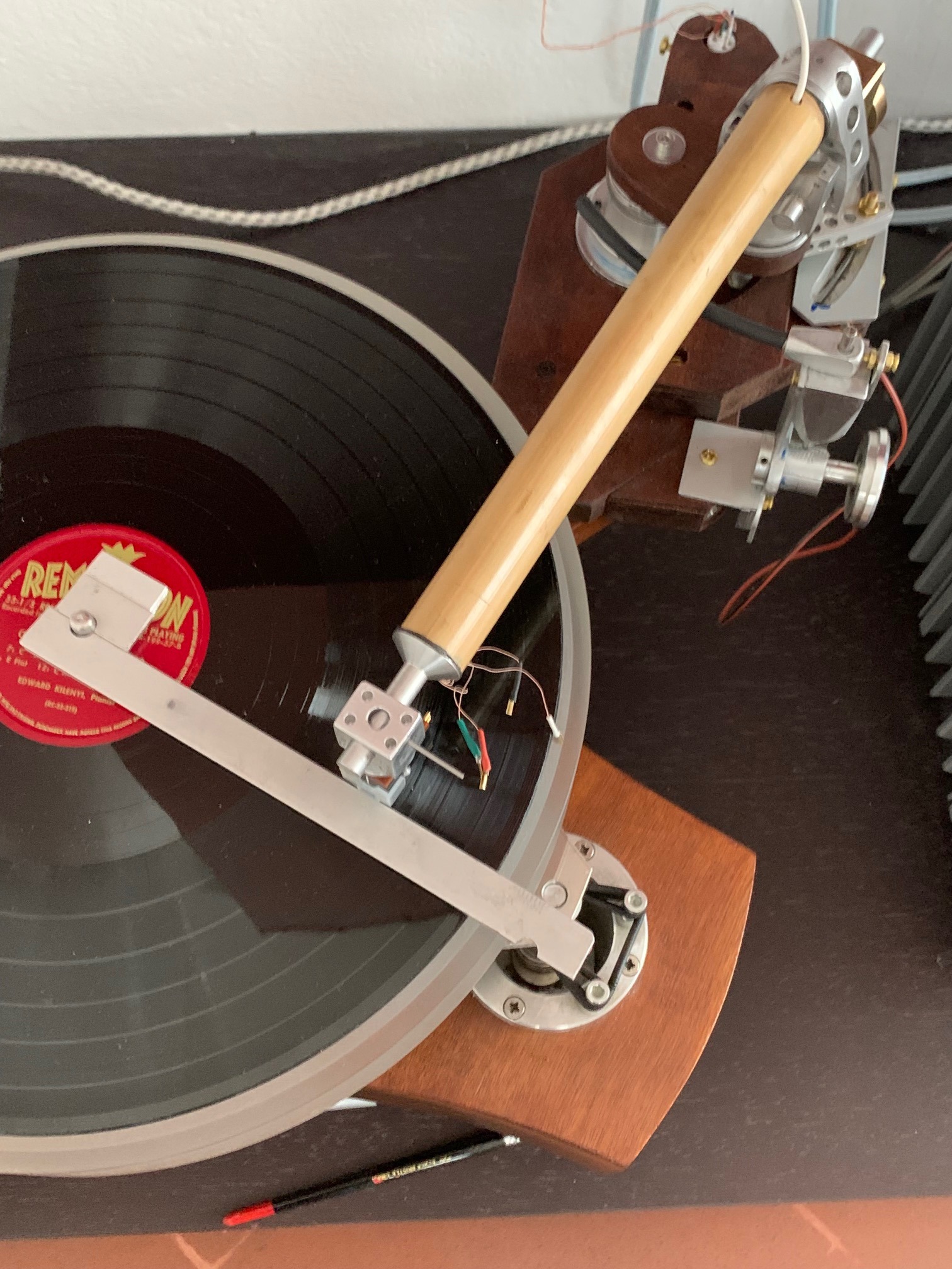

Small update:
New CW, ugly but raise up the center of gravity a bit as I wanted, it is closer to the bearing, has more clearance in the bottom so I can further lower the TA, has the VTF fine tuning.
New head shell, I reduced the number of material to 2 near the cart, Panzerholz spacer and aluminium. Also now it locks better to the tA.
Rgds
Adelmo
Small update:
Rgds
Adelmo

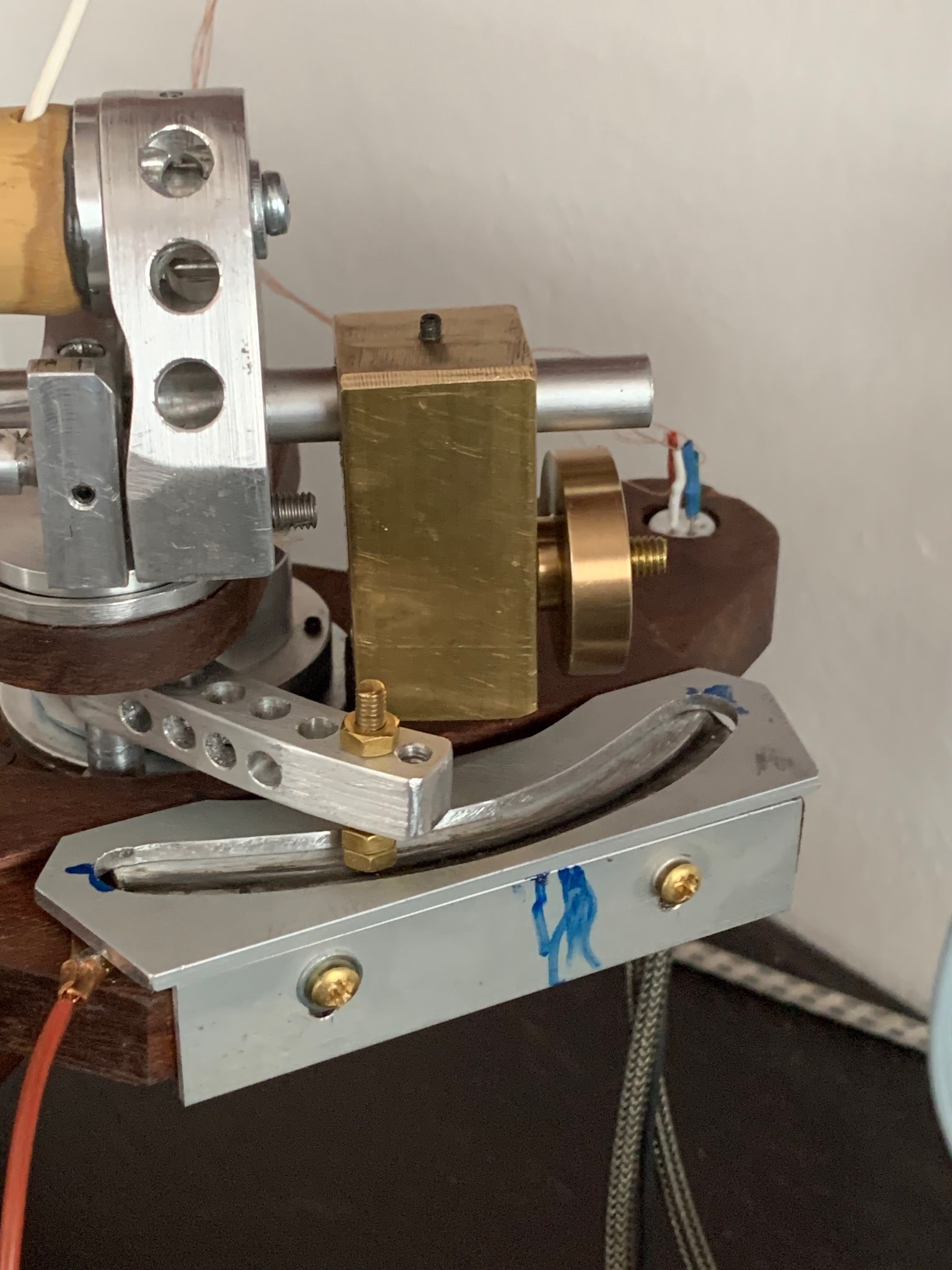

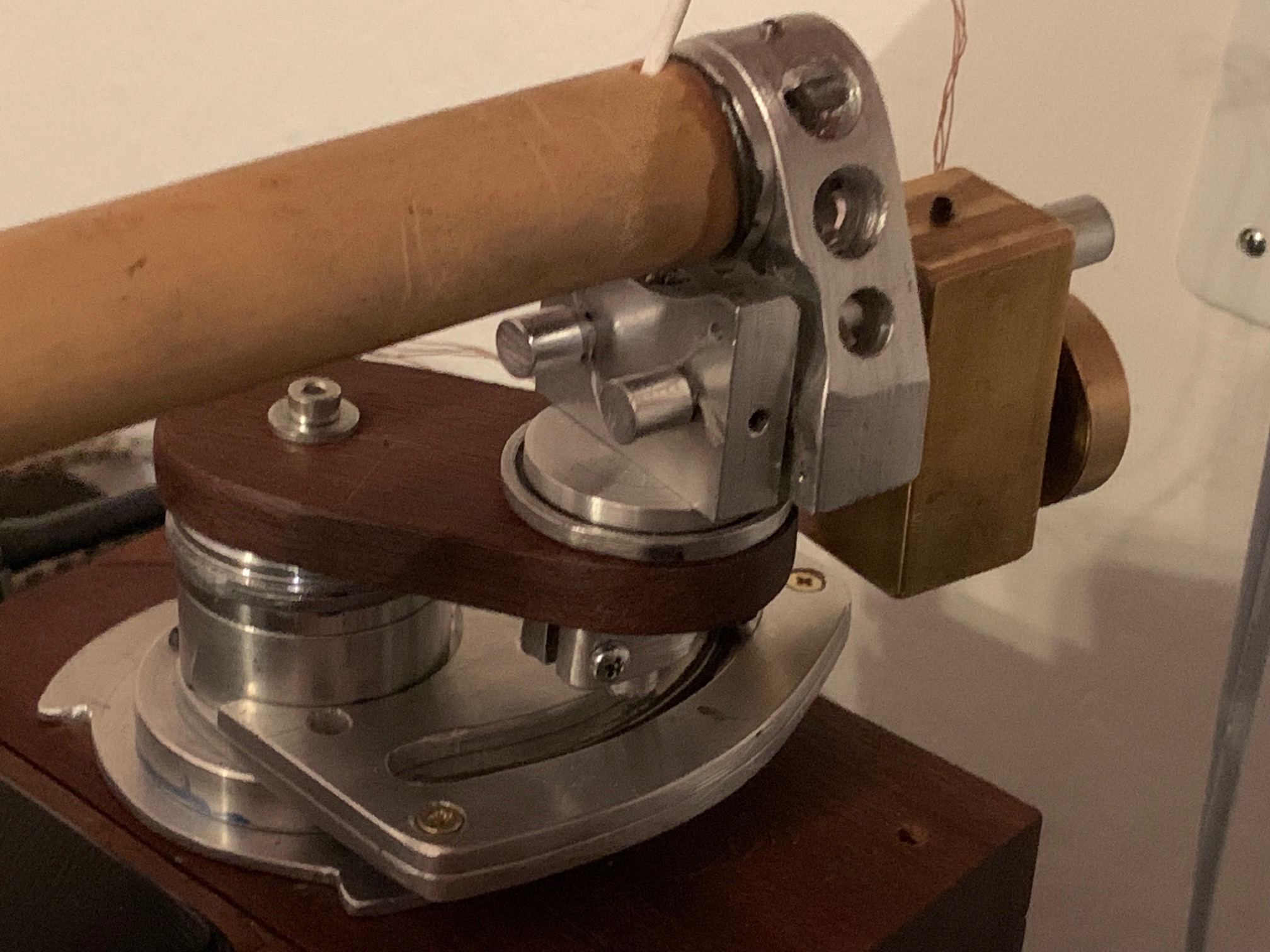

HI,
Made a new mag cam integrated to the main TA s post. Makes more easy the levelling of TT and TA. Also the cam is more compact and smaller, now more easy to fit the TA to other TT. Reduced the mass of the wand to 60 gr but still too heavy, I am making a new wand of 35 to max 40 gr mass.
Planning to add a TA lifter.
Making new pivot for the secondary TA shaft and use better ceramic bearing pre loaded.
Skating not perfect for all the tracks yet, still working on it, but much better compared to before.
Rgds
Adelmo

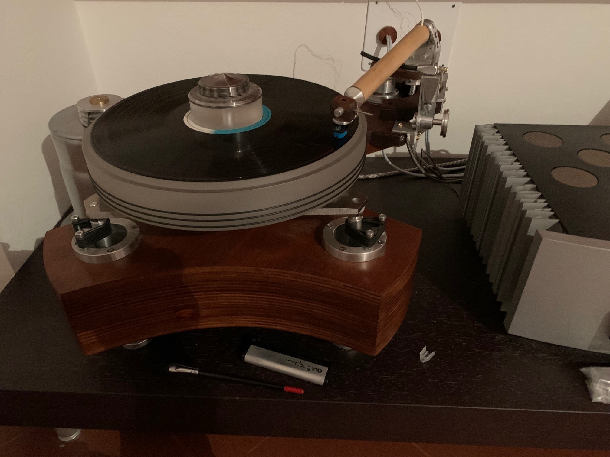

Hi Doug,
Now I am playing records with the Lenco. The other TT despite it is not a soft floating, I decided to make, as u suggested, a kind of mod that allow me to have that TT either floating or not floating at all, depending on the use I like at the moment, just turning 3 small knobs.
With the Lenco, the new cam integrated to the main pillar, the steady level and a better setting the TA work pretty well and much more precise as supposed to be. Skating is almost perfect ( no skating ) for the whole track list.
Still space to make some improvements such as :
Good ceramic zirconia bearing pre loaded for the secondary shaft ( just waiting the new pivot from the lathe guy )
Make a potted mag hoping I get a more precise function
Add a TA lifter integrated to the TA for the safe of the cart
All these new mod shall also allow me to switch easily the TA to almost any TT.
Best regards
Adelmo

Hi Doug,
I got 4 ceramic zirconia bearing 16mm x 8mm x 4mm. Checking by hands seems they are the best of all the bearing I bought recently. Trying to fit them in the bearing house I feel I damaged one, may be 2. It is important a perfect allowance to make them turn well. Shall see as I have 2 more untouched.
I have ready the lighter bamboo wand, waiting for the tale and tip aluminium part from the lathe guy, then I shall adapt and bond to the wand. Each TA with bamboo is like a custom made as diameter vary a bit each time.
Waiting to receive the bearing pivot with perfect allowance for the ceramic bearing. Perhaps next week I got it,
The TA now works much much better, steady TT and perfect level it is a must, so the use of this Lenco.
I feel I only miss a TA lifter so I am working on it.
The 60 gr wand mass also sound not bad with DL 103, better than the previous 70gr, but still in the too heavy side I think. 40 gr should be better, shall see. New Kuzma Safir TA is said to have 60 gr mass for a 9 inch TA.
Currently I am making from an aluminium plate the support for the TA lifter and a TA park support. I do not like to use mag for the TA parking position, they look good but I feel is not a so safe solution for the cart.
With these mods switch the TA to other TT is possible and much easier.
