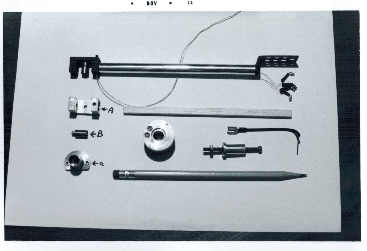

Unipivot servo
Been there, done that 42 years ago. Works great!
Ray K
Thanks Ralf.
A little abstract thought😱. How about mounting a unipivot on a servo controlled linear tracking platform ?
Ray K

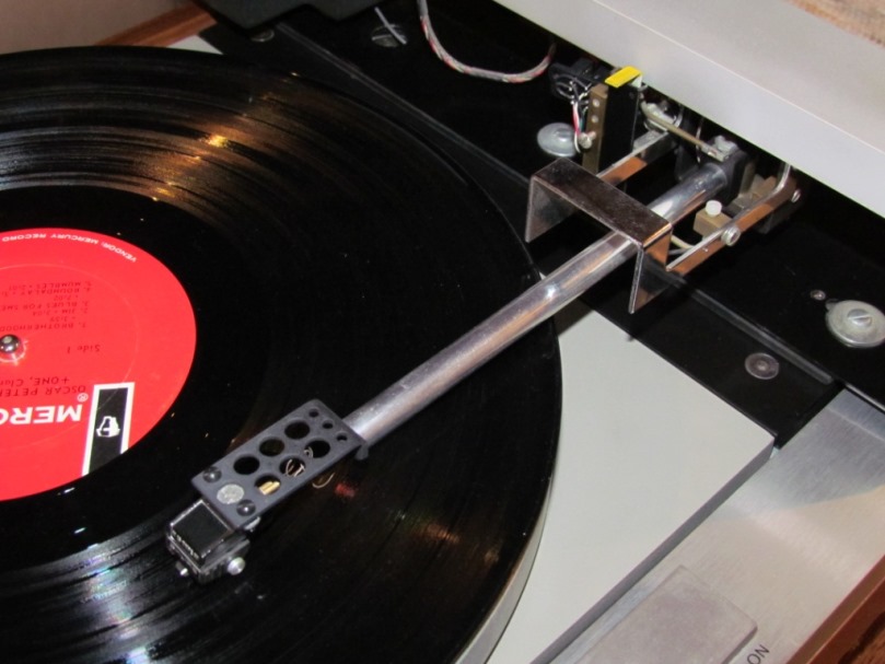

Klaudio Tangential Tonearm
Looks like the Klaudio tonearm is a commercial reality. You can check out its instruction manual.
Some observations:
It has two versions: 10.5 inch and 12 inch lengths.
It has no servo, no motor.
It has no pivoting point above the stylus tip.
It has detachable SME style headshell.
It has linear bearing so not only it pivots but also slides back and forth.
It has a complicated guiding mechanism at the base. More pictures from post #1033.
It has dual armwands that reminds people of Thales Simplicity arm.
It has resemblances to Straight Tracker's design.
This thread is mostly about tangential tracking using only pivot bearings so this design is a really a hybrid of using pivot and linear bearing. This is too Rube Goldberg for me (but fun to look at!). And if linear bearings are to be used, I think there are simpler solutions. Some would even argue why not just make a parallel arm already! This arm appears to be a rather belabored way of doing tangential tracking. Hey, at least somebody is making an effort here!

The Klaudio arm is somewhat of a parallel arm only at the front end headshell part. All that sliding and pivoting is to move the stylus in a straight line across the record without the carriage moving along laterally like an airbearing or other parallel arms. So this is not exactly in the genre of articulated tonearm a la Garrard Zero 100, Thales Simplicity, or even Schroeder LT. I would assume there is some inherent skating force, however minute, but there's no antiskating device visible.
In this YouTube video, it shows there's a cam system with a guide pin and wire guide, picture below, in the back below the counterweight that helps guiding and moving the whole assembly back and forth on those linear bearings.
A curious device.
A curious device.
