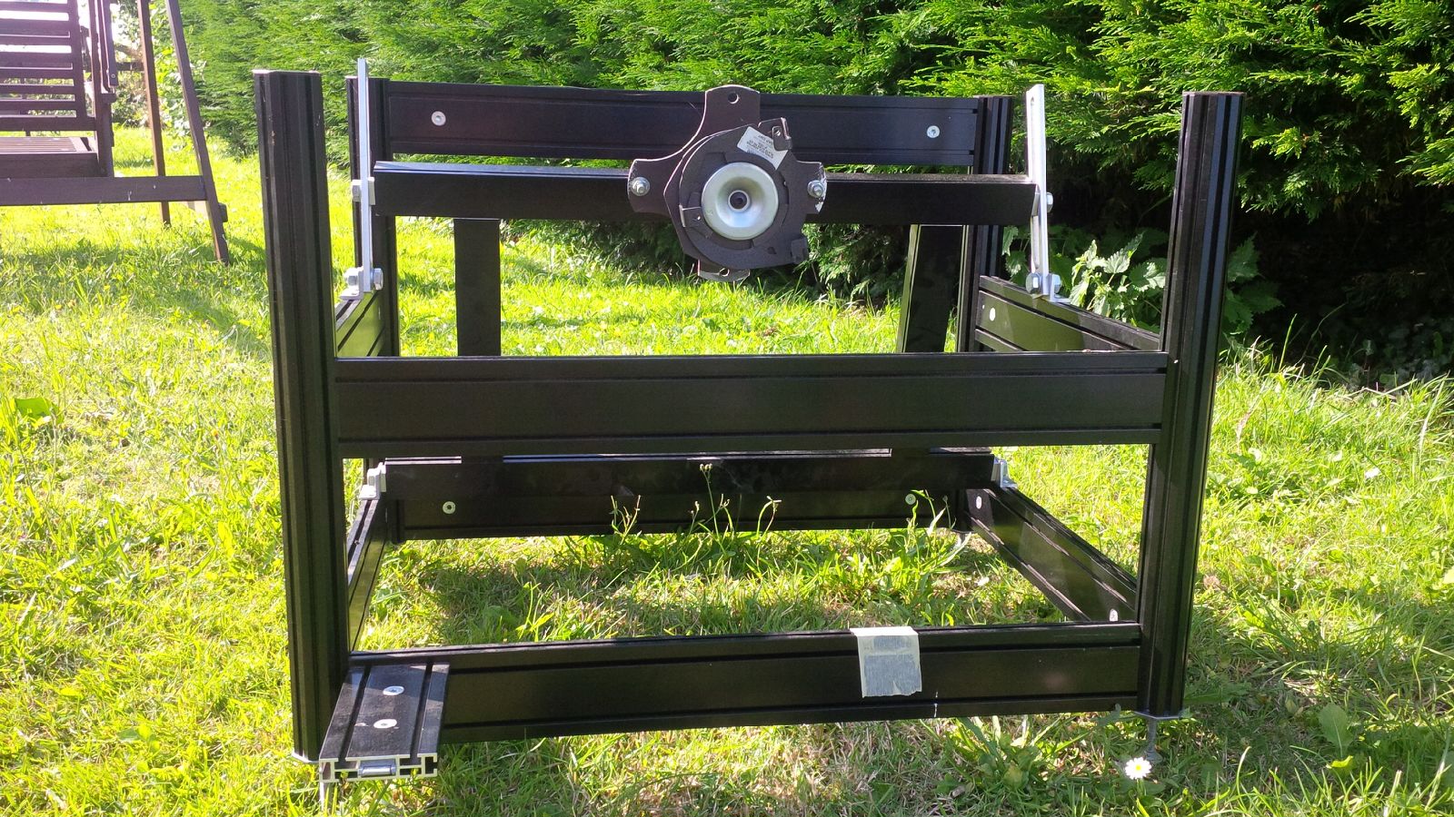

I did over lunch read the first few hundred posts and did note that Rabco's were out of the question but was too embarrassed at the time to admit it. I'll mull more. I suspect size may be a problem, but I have a solution in that space. As an inveterate skip diver, when they threw out the mount that the back projection unit was fitted to in the office I just HAD to have it. Gives me some room in experimenting with modular turntable parts.
Hi billshurv,
There are a few hundred dollars worth of aluminum extrusions in that unit. I would not have passed it up either. (note the spelling of Aluminum)
Sincerely,
Ralf
