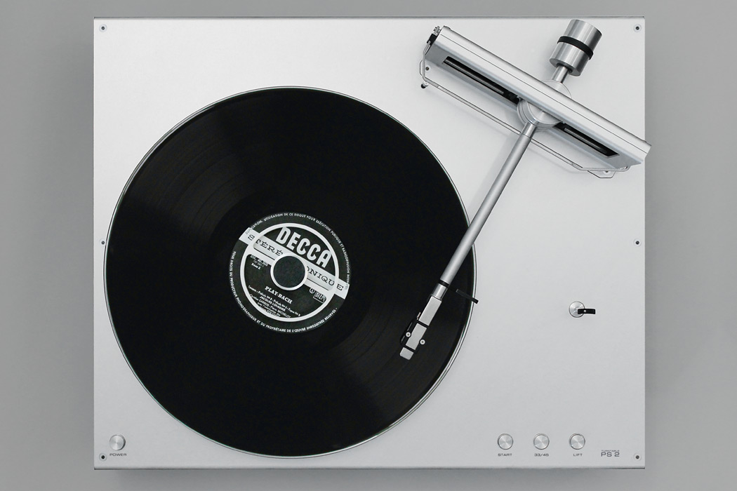

The ballfinger arm is actually a linear tracking arm. I don’t know how they deal with eccentric records. It seems to me that there is no active tracking mechanism. If they just let the arm to swing left and right to deal with eccentric records, I think there will be a lot of tracking errors. It is really bad implement.
To me, a perfect active linear tracking arm should use active tracking system as laser record player, but the playing mechanism should be a cartridge.

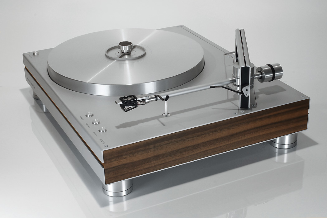

Ballfinger PS2 Turntable

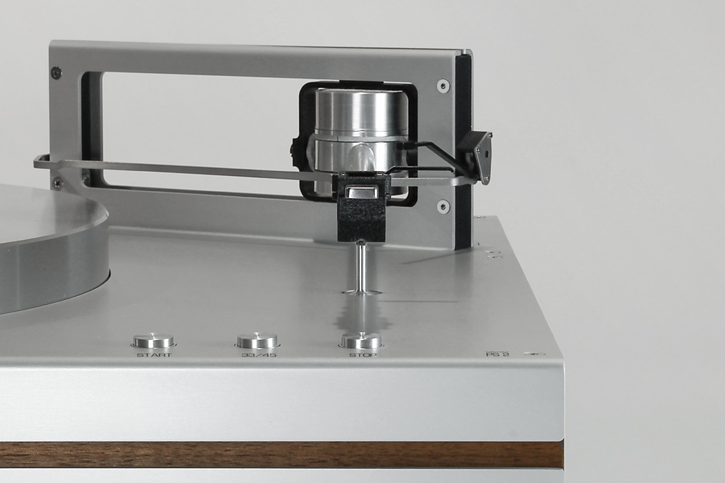

The Ballfinger uses an active servo tonearm. Looks like a fancy modern Rabco.
Ah view from above makes more sense than the earlier linked picture. Does look like a unipivot on a track. Is 70s revival the current look BTW?

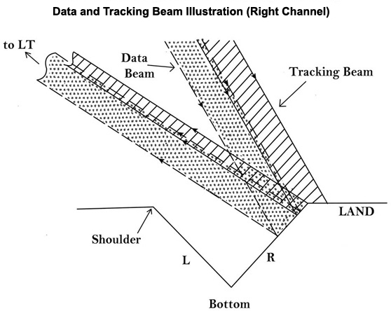

Active linear tracking arm can move both ways. But it requires a very accurate tracking and a fast and precise driving system. Please see the image to see how ELP laser turntable to track the groove. As I said before, a prefect active linear arm is with ELP laser turntable tracking system.

Not sure I buy your line of reasoning. The ELP needs pin point tracking because it has to shine a laser into the groove. Mechanical playback has a stylus that locks you into the groove. If you tracked a linear arm as accurately as the ELP system you would end up with no net movement of the diamond.
What you really want is to track the mean of the groove, straight down the middle so the stylus can accurately do its wiggling, or at least within the limits of something that's oscillating around at 8-10Hz ! A strain gauge cartridge would possibly be a better starting point as you get position data off that which you can use to steer.

Please look at the diagram. There are two beams. One is tracking and another is data. If only the tracking beam can be used on an active linear arm and feeding the information from the tracking beam to the motor controller, the motor will drive the cartridge to follow the groove precisely. This is what I called a perfect active linear tracking arm. I am not sure how the tracking beam works. It may track the mean of the groove. Or it may track the bottom of groove. However, it is just a thought.
