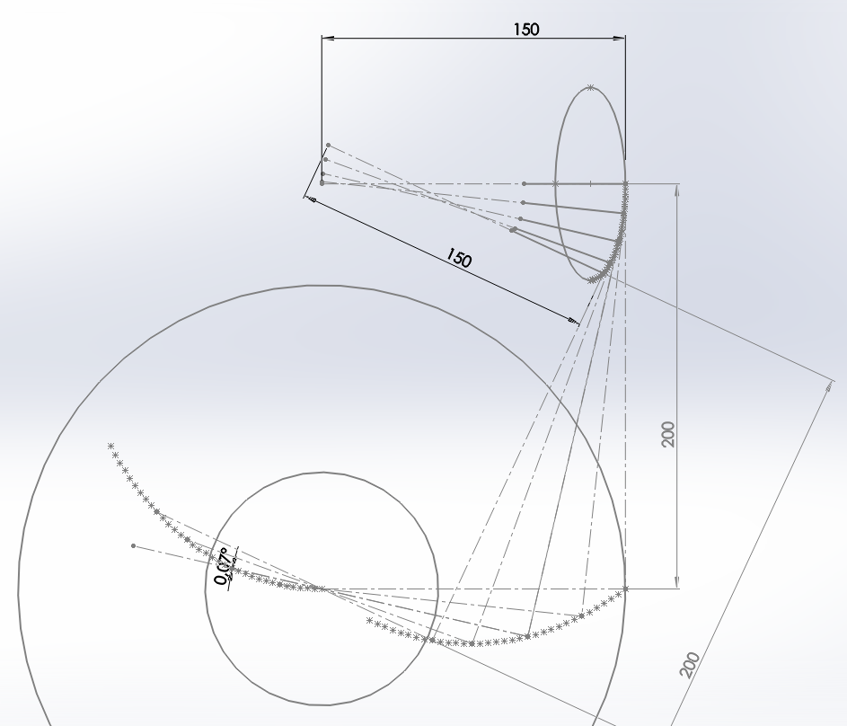

I've been looking for a simplified mechanical ellipse follower and I thought something like this ellipse trammel might work, but it doesn't.
I CAD out the point cloud from excel and the most accurate simplistic ellipse has a 17.319 mm minor axis and a 47.692 mm major axis, for a 200 mm arm
Deviation from the simple ellipse to the tangential point cloud data is 0.07 Deg
A normal tangential tonearm can have a 0.5 Deg deviation off tangent, so still very good.
I'll keep looking though.
