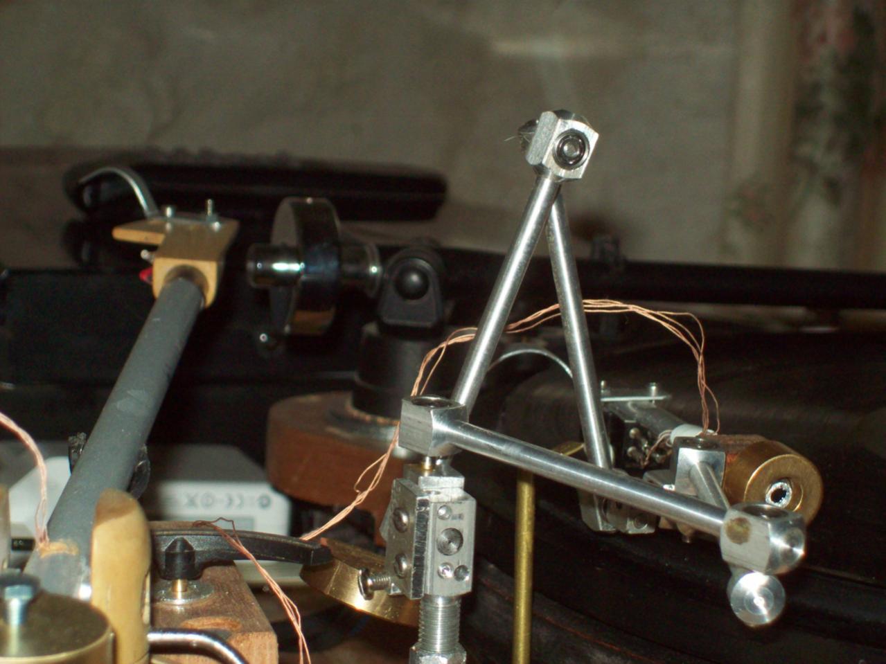

That's a good looking effort. It's a shame it apparently didn't work out. I was hoping we could compare notes.
A couple of questions for when you have time: What cartridge did you use and did you try removing the main pivot counter weight?
Hi Doug,
The cartridge I use for testing all these arms is an old Sony, not sure of the model number but it tracks very happily in all the conventional arms at 2.5 grammes and sounds OK. Once I'm sure stuff works, I can then put a decent cartridge in to see what the sound is really like.
I didn't try removing the main weight. I will try that at some stage.
I'm busy fighting our linear tracker for the time being. The damn thing sounds fantastic, it moves incredibly freely and yet, every time it plays, no matter where I start across the LP, it goes for 4mm and then stops!! Some sort of loading taking place on the bearings but I can't figure it out. If my genius brother in law has no suggestions, I'll post it here (or in my other thread) and open it up to see if anyone has any ideas.
The whole thing felt as loose and smooth as most of the arms but it just won't track. Obviously not as free running as I thought.
Somewhere, one or more of the bearings is clearly not set up properly, probably not dead on 90 degrees. the metal section is a little flexible so it probably didn't show up the duff section as much as a rigid bar would have done.
You can't give up now. I'm still waiting for parts, so at the moment I'm just a theoretic engineer. What if we reduced the mechanical ball/needle bearings to one instead of four. A simple unipivot straight arm, anchored at the end with a string and a spring😀. The spring will have to be just pushing enough to keep the thread straightened all the time.

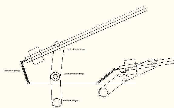

Not quite yet but nearly there. (on paper anyway)
This one is obsolete, too complex. I've got a simpler design that I'm hoping will work.
The biggest problem is the change in length between the primary and secondary pivots.
Trying to shoehorn a complex problem into a simple mechanical solution is near impossible.
I'm trying something like this now. Not as complex because you only need a small part of the ellipse.
Here are some further mock-ups of the design.
I'm not inferring that this will work but only that it was the simpler way of tracking the arc of the ellipse.

Hi Steen
Thank you.
In this mock up there are no vertical bearings.
This was just to model the tangency of the moving pivot.
The vertical bearing will have to be sorted out still.
2wice,
You and gus 3049 are in serious contention for the audio sculpture prize - the drawings and the video are beautiful. Both of you are taking LT development in great new directions.
Are you going to try to implement it as drawn? Will it involve linear bearings and do you think they'll be free enough for the stylus to move them?
