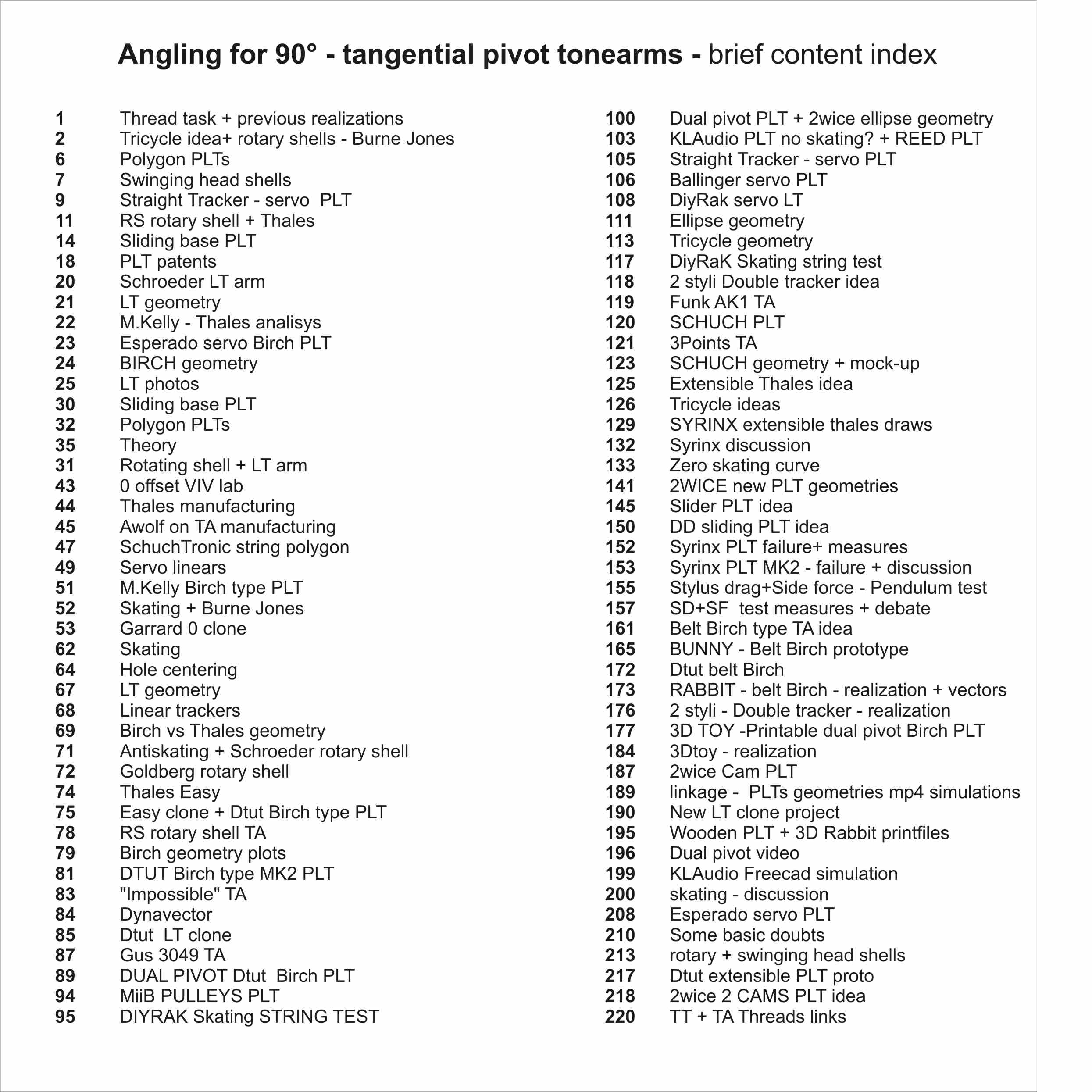

Hi Direct driver, I tried to write an index of your great thread, indicating the initial pages of the main topics (from my viewpoint, of course).
As references I had to use mainly the various PLT typologies, because the theoretical part - which instead has a bigger importance - shows a karst like behavior, appearing and disappearing while discussing individual solutions or problems identified, so it's difficult to locate. Presently this index does not do justice to the quality of the scientific and technological contributions of the experts we all know and thank.
Hope other followers will correct / add their favorite topics; meanwhile perhaps we should point out the thread's "zones" where the various theories are discussed in depth. Not a simple task for my level of knowledge.
hope this helps - carlo

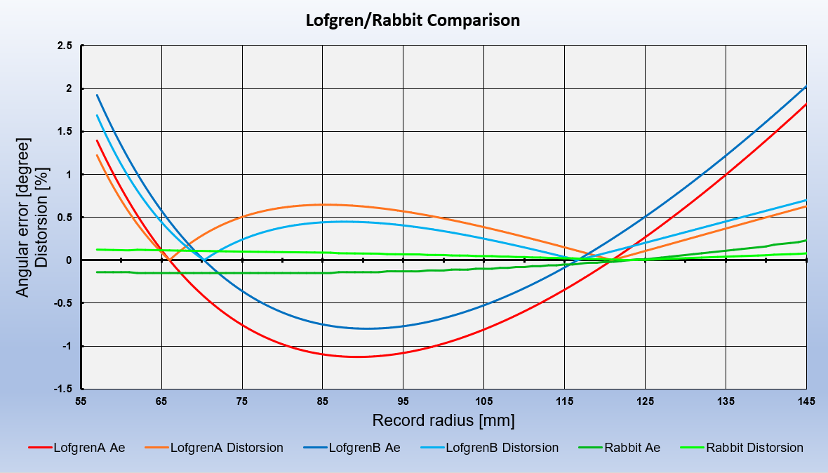

Geometry - It is not a tracking error problem (it's evident that is extremely less) but the price to pay in terms of variable forces and frictions (side force versus skating an so on); but the discussion is so complex that we are talking about it from some thousands of posts.
Now back to the Rabbit: the gears are not wrong per se, but the problem is that on the eccentricities the shaft goes back, and this starts the unavoidable play of the gears.
Here attached the simulations of the original Rabbit and 3D Rabbit. You have to avoid extending completely the arm, for the reasons highlighted in my #1733 hypothesis.

Thanks for the two attachments. But the 3D one makes me wonder: Is this an older version? Why 24:16 gear ratio? Indeed, 1.5:1 is an easier ratio to attain than using a ratio involving a prime number.Here attached the simulations of the original Rabbit and 3D Rabbit. You have to avoid extending completely the arm, for the reasons highlighted in my #1733 hypothesis.
When I'll have some time I'll make the same angular error graphing as I did for the 25:17 one.
Of course complete arm extension is not feasible, but luckily it's also not needed because it takes place when the needle is over the record spindle 🙂

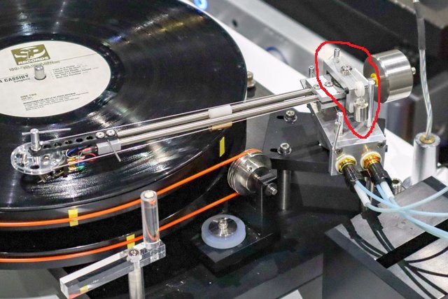

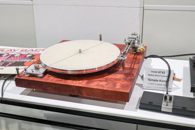

Dear directdriver,We can always count on 47Labs to introduce some Rube Goldberg toys. This one is under the radar and came out earlier this year. Some pictures below and couple videos.
Rube Goldberg toy or not, the concept is not at all new. See this 6 years old post: Schuch Tronic's "The Perfect Pick-up Arm | Analog Planet about Daniel Schuch's almost identical design.
But this is not the point of my comment. As soon as I saw the pictures you posted, I have immediately modeled this tonearm in Linkage (attached). Even though I was initially skeptical about their marketing claim "NON Error Tracking Tonearm Exact Trace", the results I obtained are truly exceptional! With the proper pulley ratio: 0.00 degree angular error from 0 to 183mm record radius!!! With this design you can even play studio transcription records without any tracking error! 😀
You obviously haven't gone through the whole thread. We covered the Schuch arm already, even his other versions. Schuch is not the only one uses string (our member inventor Andy might have something to say about that!) but that requires you to browse through nine and half years worth of posts!
Just about everything in the market of the tangential pivot tonearm genre has been covered in this thread. The point of the 47Labs post is that the arm is new and was introduced in early 2019 so I have to update it here. Also, 47Labs is known for Rube Goldberg contraptions not just tonearms (they also distribute the RS Labs RS-1A arm with the swiveling headshell) but other components as well such as their turntable with counter rotating platters, etc.... It's part of their marketing strategy.

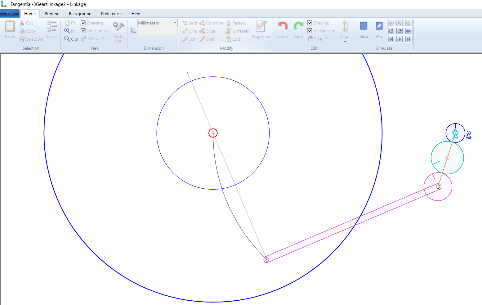

Hi Consty - I can't make the two last simulations work - block signal at the starting point - where i'm wrong?

Hi Carlo,Hi Consty - I can't make the two last simulations work - block signal at the starting point - where i'm wrong?
Sorry to hear that. You're probably not wrong at all. What Linkage version are you using? I have just installed the latest version I found on their website (3.10.11 64 bit) and it works fine on my Windows 10. Are you using Windows or Mac? I'll post soon for you a video of my 47Labs TA Linkage simulation.
Regarding the disadvantages of this design, indeed, I'm not very happy with ball bearings just above the cartridge. That's one of the main reasons I abandoned Micha Huber's Thales design (even though it produces perfect alignment) in favor of the Rabbit. The same applies for this one. On top of that, who knows what resonances may produce a violin string attached to a tonearm 😱
Regarding the YouTube video you linked, it's really sweet 🙂
What I like the most is the USB cartridge 😀
Say, I do believe I see a string-and-weight antiskating device on this arm. With the way the AS weight string is attached to the bearing yoke, it will correctly apply compensation force outward away from the spindle at the outer grooves, zero compensation in the middle, and compensation force inward toward the spindle at the inner grooves.
Ray K
