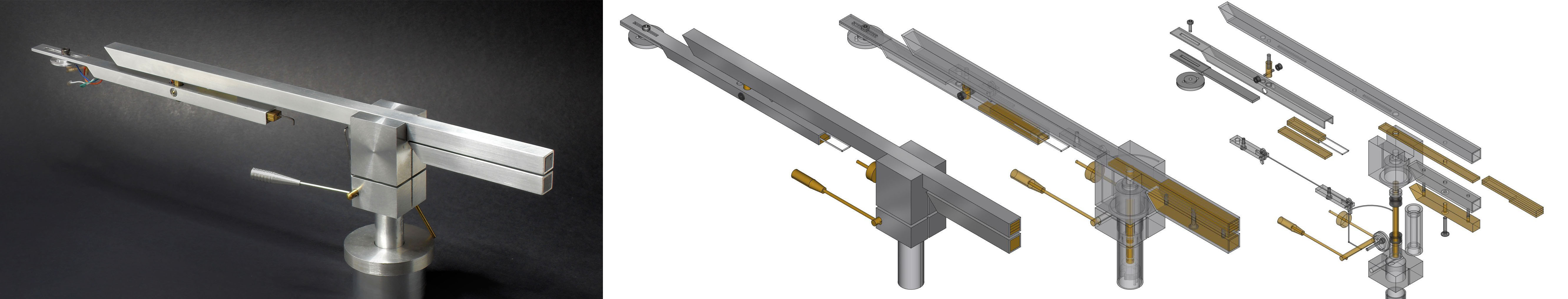

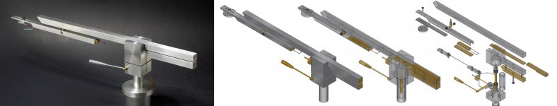

Reed 5A
I don't know it's true or not that this prototype from Reed is POSSIBLY inspired or tickled by this thread. They even use this thread's title in their blurb below! If it's true, I think all who participated in this thread would feel really flattered! The prototype appears to be a passive version of their 5T model minus the servo. It also reminds me of Carlo's 3DTOY PLT creation.
In this years Audio Gourmet 2019 show in Vilnius, we’ll be unveiling the prototype of a new Reed 5A tonearm. Introduced as angling-90-tangential-pivot-tonearm, it is based on Double Birch/Thales geometry and will complement our tangential tonearm lineup.
As Reed 5A is still in development, neither its price tag nor market launch date is currently set.
Below is scheme of Double Birch/Thales geometry.
Maybe Doug, who invented the double pivot geometry, is entitled to royalties!
It is nice though that Reed clearly indicates the origin of their project: far differently from many other "inventors"

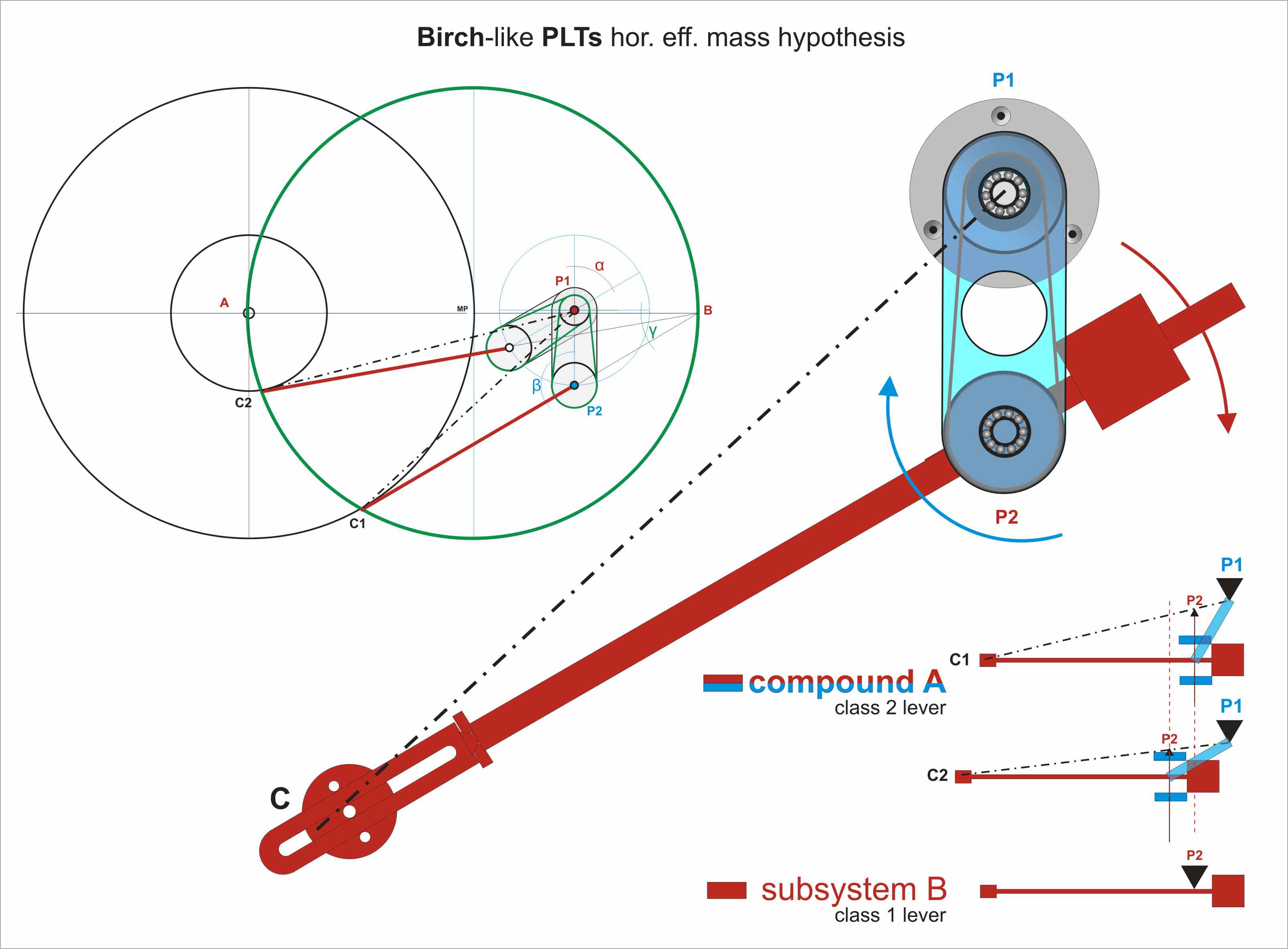

an attempt - some hypothesis for the analysis of horizontal effective mass in PLTs Birch like. (belt-type - double pivot - guided - etc.)
The complex of the mobile masses may be -maybe- regarded as split in the subsystem B (headshell + shaft + CW) and in the compound A of the whole (subsystem B + cranks + pulley + bearings + vertical pivot support)
B is a class one lever on P2 fulcrum, and can be calculated as a normal pivoted one, both for vertical and horizontal mass.
A is instead a class 2 lever on P1 fulcrum, with the load roughly located at the mobile pivot P2. However, the length of the lever (segment C - P1) and the position of the load is variable, in relationship with the angle. (attachment)
This greatly complicates the calculations, and brings an Hor. effective mass to some extent variable. The Beta angle variation of the rotation of the subsystem B is strictly tight to the corresponding variation of the Alpha of the compound A, where Beta = 2/3 Alpha ca. and in this proportion its hor. eff. mass should perhaps affect the total.
To make it worse, as rightly noted by Ray, it should be added that the movement is not a simple rotation, but also an advancement (32 mm ca.), that perhaps should be computed as simple weight, similarly to that of the carriage on linear trackers.
Forgive my naivety, it's just to solicit qualified interventions
carlo
carlo
In what sort of a mess we came into?
For a regular pivot arm, its internal damping is neglected to simplify the calculation of effective mass. But for linear arms and tangential pivot tonearms, it may not be neglectable. Therefore, it is better to directly measure resonance frequency.
For a tangential pivot arm, its effective mass may change. I don't know it is a shortcoming or it is an advantage of a tangential pivot arm.
Therefore, it is better to directly measure resonance frequency. (super10018)
You're right. But does this allow us to distinguish the resonances related to the horizontal mass from that of the vertical one? And since we are measuring a system, how can we separate the behaviors of the arm from those of the cartridge used?
The intent of this reasoning would be to predict the consequences, not to measure them; to design the PLTs on factual data, as is done with the other types of tonearms.
carlo
carlo
