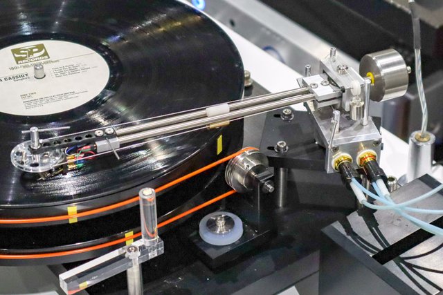

Say, I do believe I see a string-and-weight antiskating device on this arm. With the way the AS weight string is attached to the bearing yoke, it will correctly apply compensation force outward away from the spindle at the outer grooves, zero compensation in the middle, and compensation force inward toward the spindle at the inner grooves.
You always have the eagle-eyed observations, Ray!
But in their two videos and few pictures, they have one arm with no anti-skating compensation at all. And another one using leaning weight on the left side of the arm. So I'm not sure which one is the final production.
Here are couple more close-up pictures. Looks like the pulley is adjustable. Not sure what the bottom string is for...
Hi Directdriver,Not sure what the bottom string is for...
We were talking about Rude Goldberg toys, isn't it?
I think that bottom string is nothing more than the tonearm lift.
Turning the pivot CCW will stretch the string and the tonearm will lift off 😉
Having a closer look at https://www.phileweb.com/news/photo/audio/205/20570/IMG_6287.jpg we can see the TA playing late Eva Cassidy's record and the pivot is slightly turned CW to allow the TA land on the record.

Could be also a mechanism to facilitate inner movement (or outer, it depends how the pulley is wound). A small "trick" somehow like the rail slanting on some linear trackers since the inextensible string has to exert relevant pressure on bearings, to work properly.
But in the detail the pulley seems unwound, so it could be just a friction dampening, adjusted by the nylon pulley position. (that weight seems too heavy for antiskating or to aid the movement)

Going, maybe, a bit further: one side of the string is fixed on the left, the other one attached to the weight via the nylon pulley. If the string is wound clockwise around the pulley it could only lift the weight (antiskating), but the position of the nylon pulley has no role, and why not to fix it directly on the pulley?. Wounding the pulley anti-clockwise can only stop the arm movement. (my movement aid idea was wrong)
So the dampening hypothesis seems truer. In effect with such a pulley and bearing at the shaft's end there is a great horizontal mass to control on eccentricities

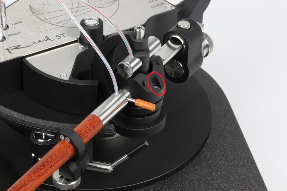

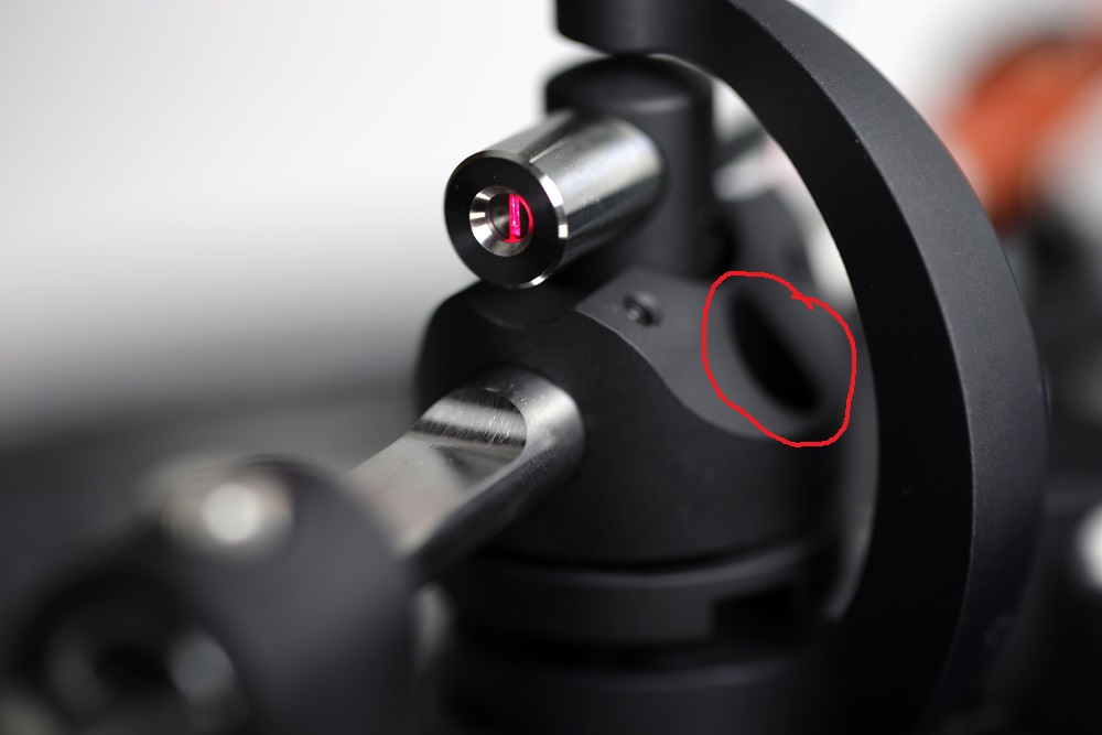

Once you step into the arena of servo driven arms you are essentially dealing with a 'conventional' tonearm that has no offset angle and has a feedback controlled motor drive to move the pivot to maintain tangency.
I just need to add one more thing. Many conventional pivot tonearms have an offset angle at the vertical bearing matching the offset angle of the headshell. In a servo arm, we need to remove any antiskating device and delete the offset angles at the headshell AND bearing so the stylus to the cantilever to the pivot point can form a straight line. (Before the string test principal can rap our knuckles! 😀)
(Reed 5T) Servo linear tonearm with no offset angle at headshell and bearing.
(Reed 2G) Conventional pivot tonearm with bearing offset.
