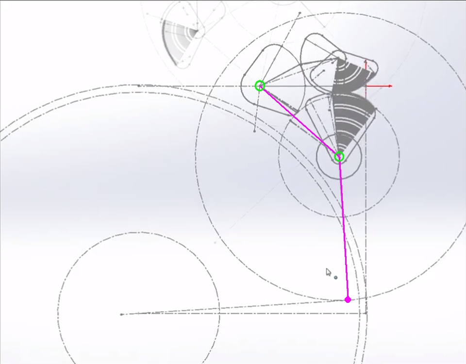

I've tried to understand it's behavior on a graph, but without result. Do the 3 (or four) cams - or gears - share the same platform?
ciao - carlo
ciao - carlo
Hi Carlo
No, not so easy to see, but the fixed and moving cams are connected with a cross bar, bottom leg of triangle with 2 single point contact jewel bearings.
The idler cam floats, is split into 2 cams sections. The bottom connected to the fixed cam and the upper to the moving cam.
They are constrained with the metal bands in 2 loops.
Theoretically, once the skate torque is compensated for, it would require the same amount of force/torque to move in or out.
The skate torque is compensated at the pivot as it is easier because the torque is reduced linearly approaching the spindle.
I have given up thinking of skate as a force vector at the stylus tip (it is), as the torque method helps simplify my design intent.
This video might make it clearer.
It is not of the design posted earlier but works on the same principle.
Only now the idler is offset and split, instead of 2 cam arcs combined in one cam.
The design in the video failed but not because of the geometry. I had the cams' laser cut and stacked to build the mechanism only. It ended up being impossible to manage the metal bands as it was all too small and the tensioning was a problem.
Also, getting the cams aligned was impossible even though I had guide holes in them.
Scaling it all up, redesigning the curves from some new maths and making planner surfaces on the cams to align easier.
I have modelled this, it works as intended with mechanical constraints only but not rendered as yet.

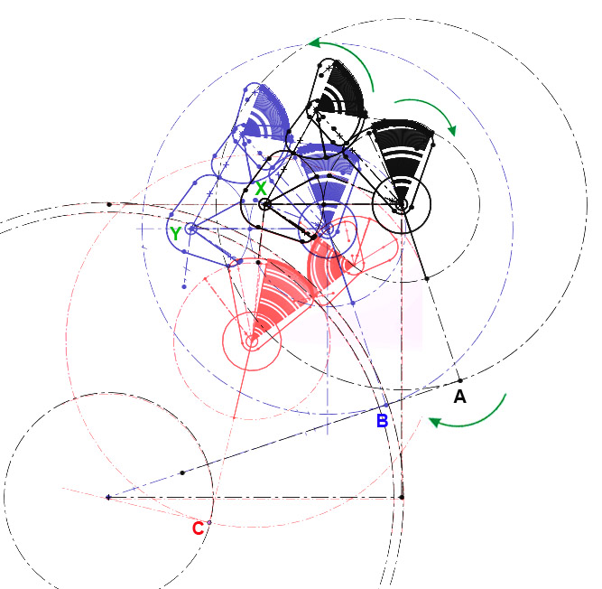

Hi 2wice, there is something I just can't understand in your graphs. (the one in black and red #2176)
fixed cam position: X or Y?
stylus position at the starting point: A or B?
with X position the C situation is ok, but B does not seem possible
with position Y the A situation is ok, but C does not seem possible
furthermore, given the direction of rotation of the shaft, the situation of the idler weel seems to me problematic (it would immediately lose contact)
Thanks in advance. Of course, if those graphs are made, as usual, to protect a possible patent, I don't expect an answer. Perfectly fair and understandable.
ciao Carlo
Hi Carlo
I'll always be willing to share the information. There is a provisional patent, but for non-commercial use it will be fine. I'll even share the method of calculating the cams once it is confirmed to work. There are an infinite number of solutions to the geometry and some might be better than others.
There are programs to calculate these cams automatically from mechanical constraints only, but they cost more than my car. They offer an educational trial and I work in Maths and Science tuition, so I tried to use our company email, but they never replied.
I'm also trying to see if there is a way to counter skate just by changing the geometry so that added tension in the metal bands does the job, but it looks like a dead end ATM because it adds to the starting torque.
Please see this Video if that clears it up for you.
Great work 2wice, and that video couldn't be clearer - thanks.

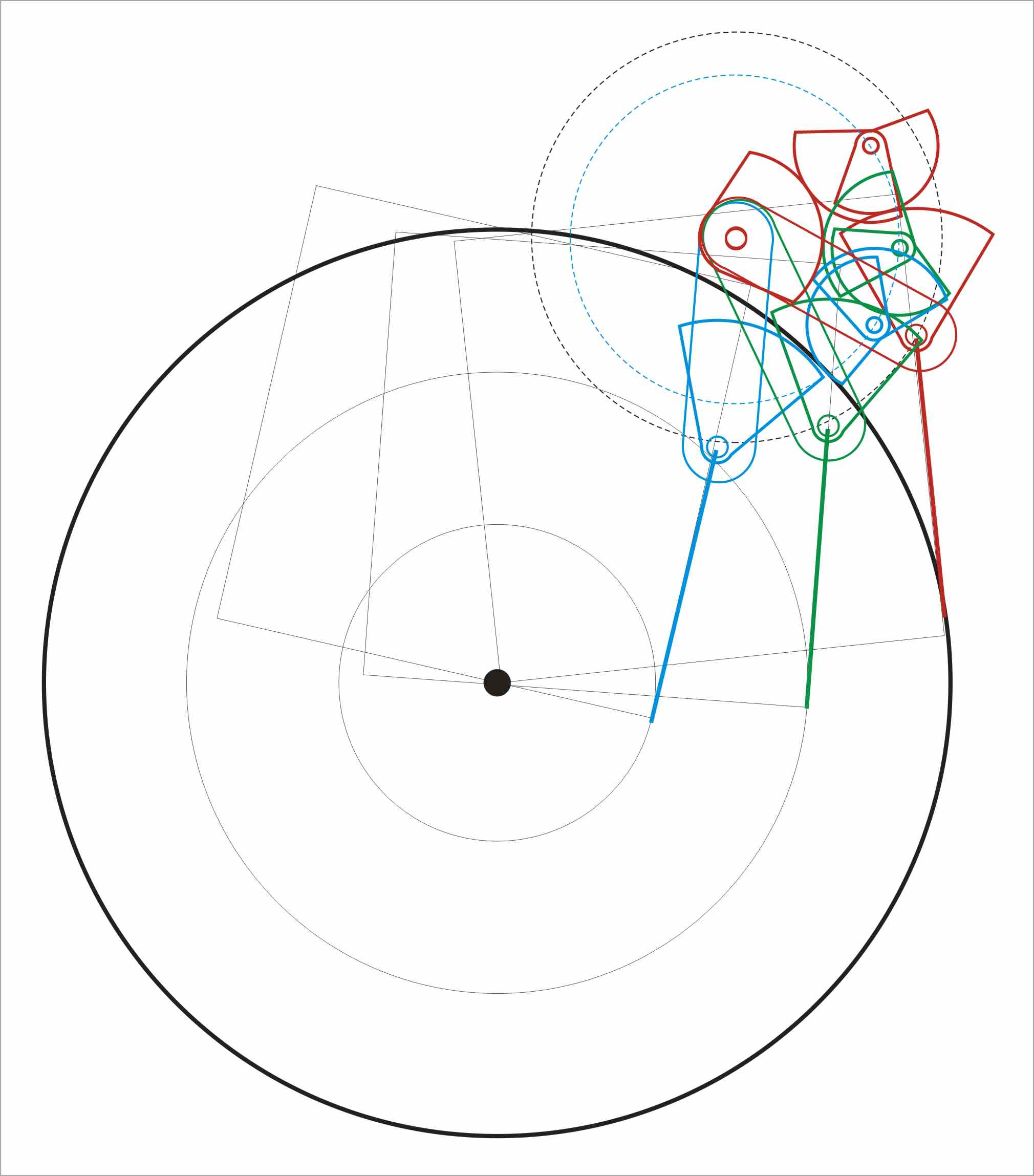

My graphic method drove me just to this point (attachment) but I could not see how motion was possible.
The torque, which at first sight seems to prevent it, should instead, together with the stylus drag, realize the rotation-translation, as in the video.
Now I really hope to see it realized: it doesn't seem simple, but neither impossible, considering the trajectory of the pivots.
