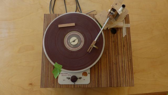

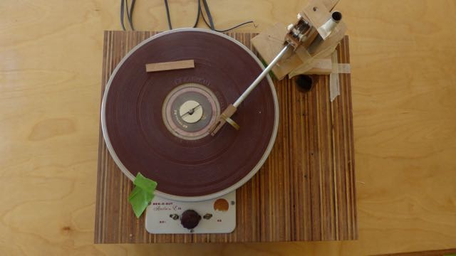

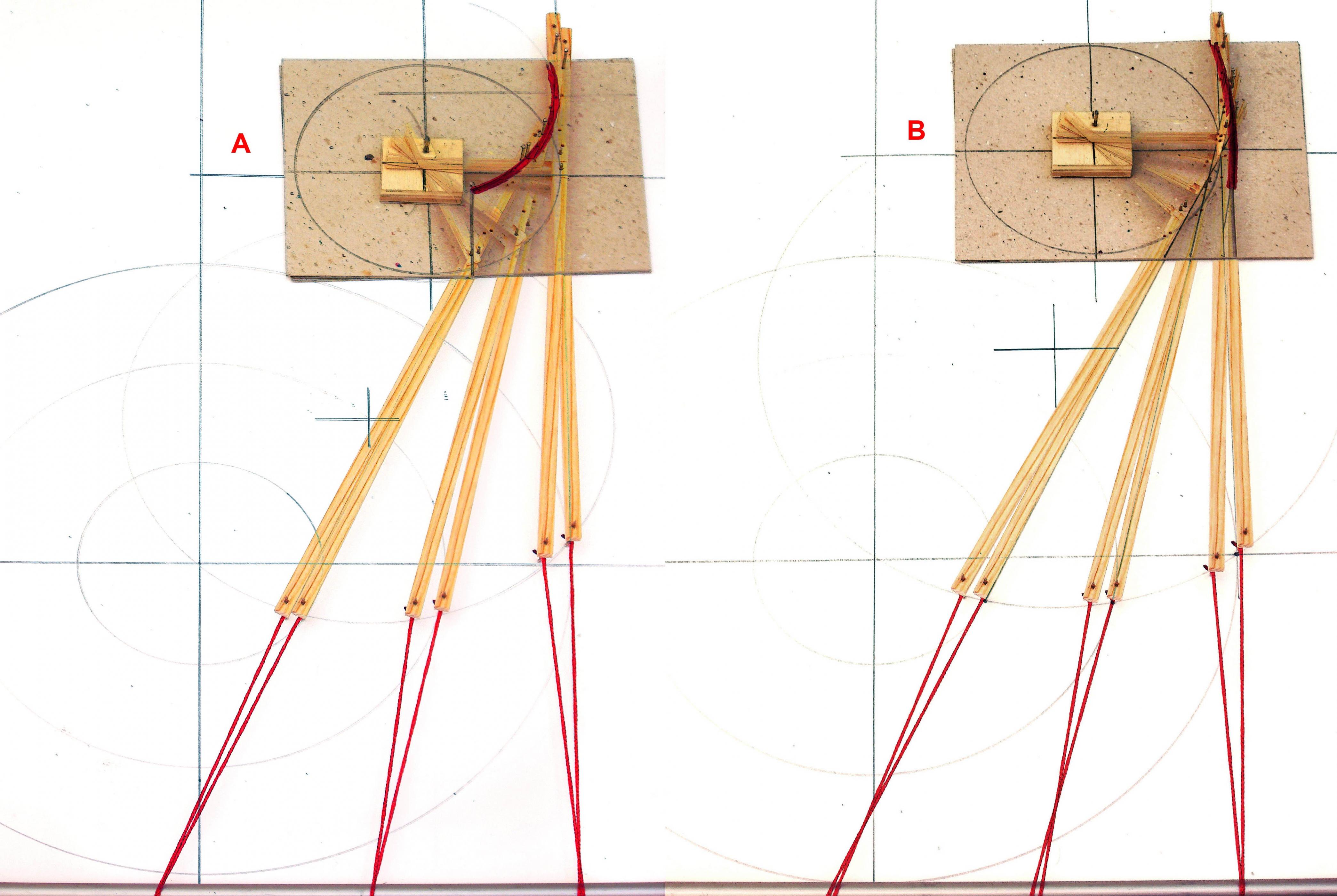

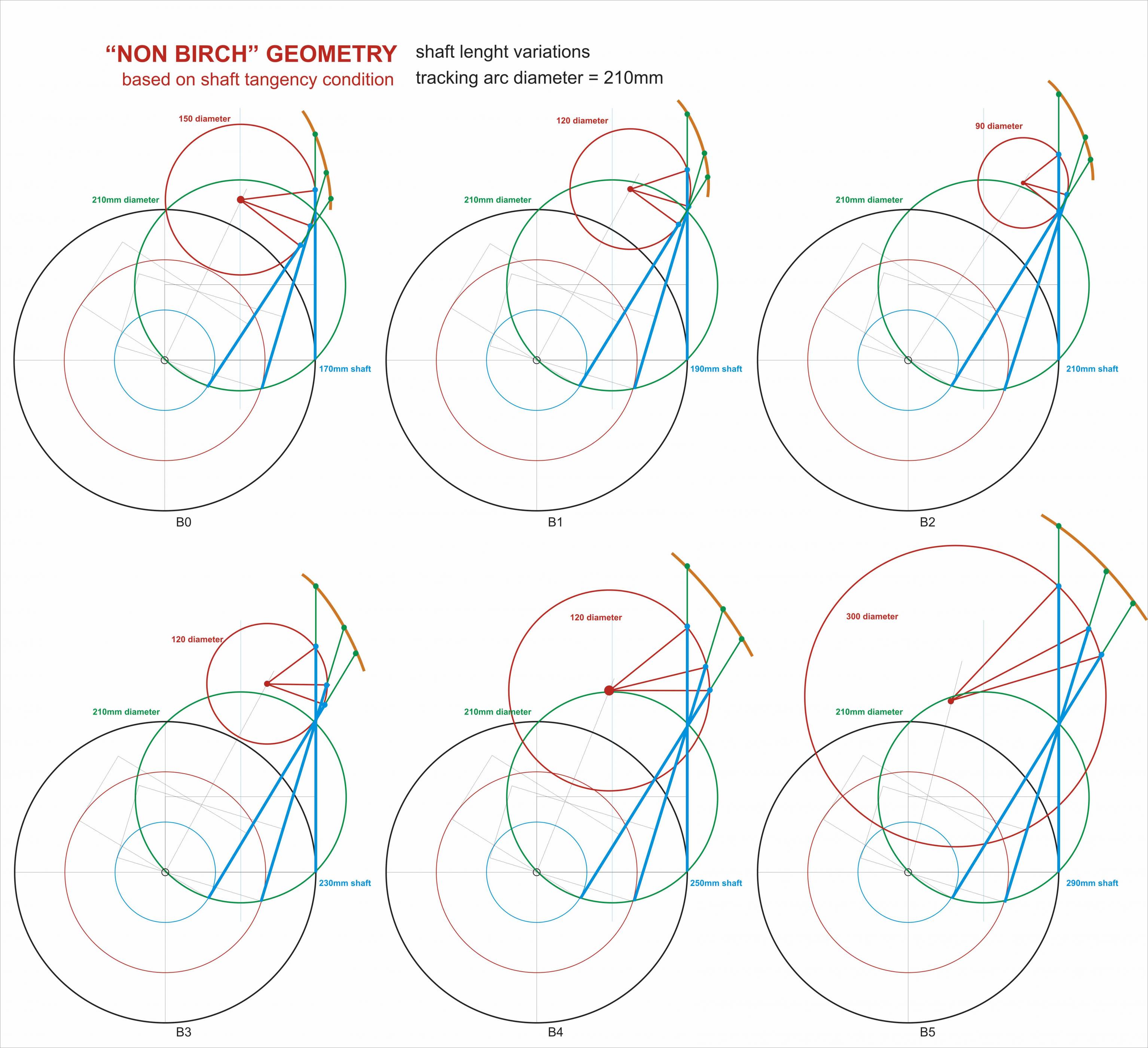

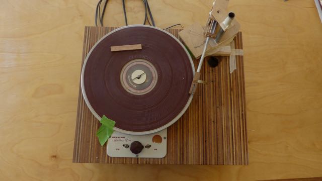

back to mock up

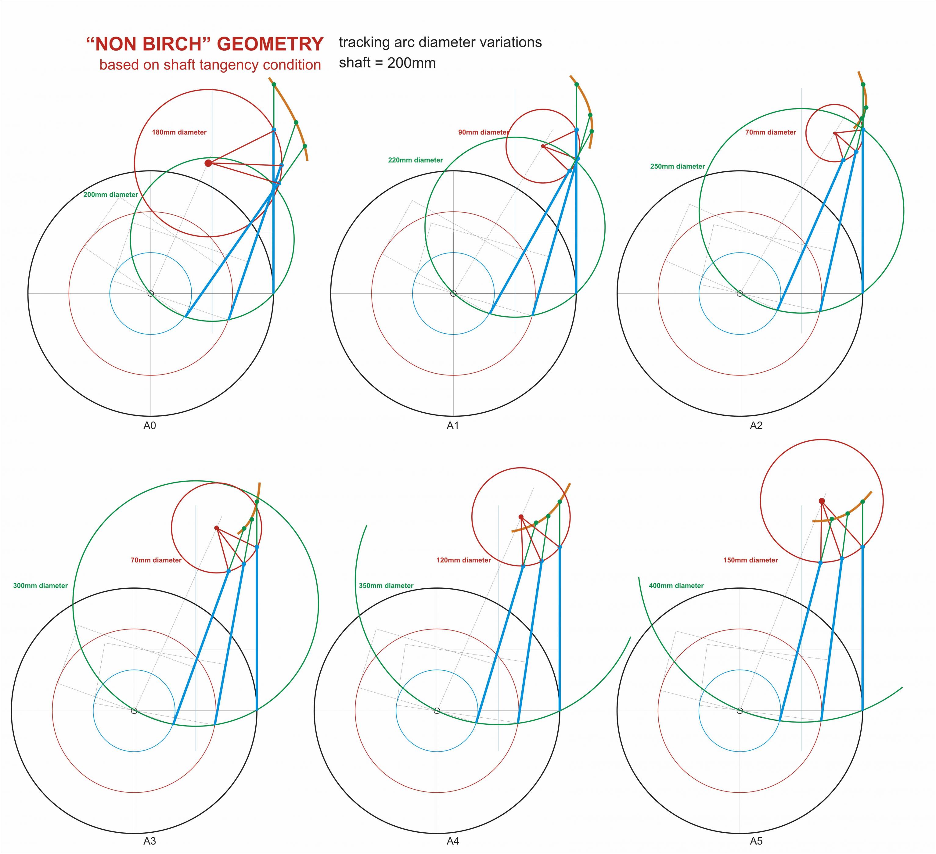

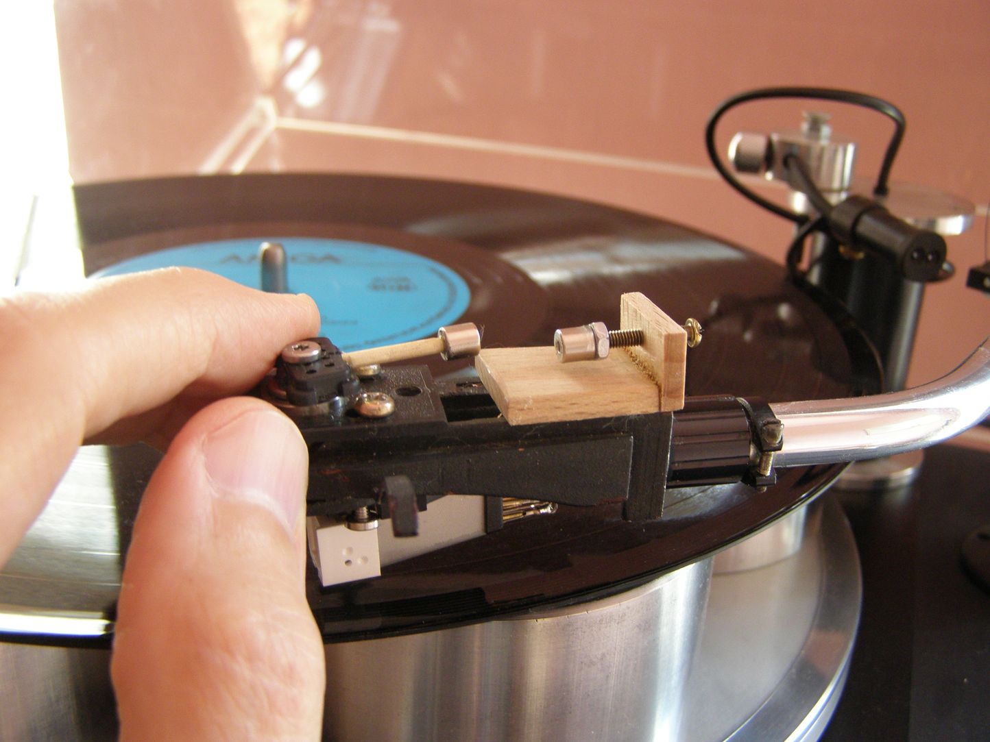

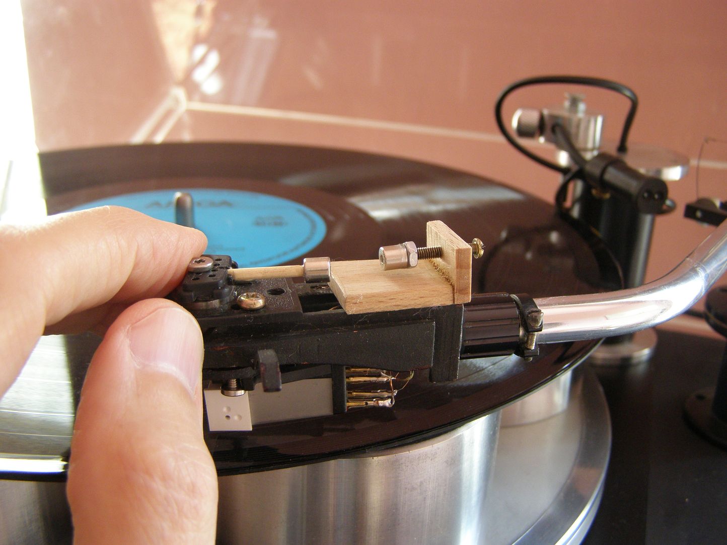

After last summer simulations of several geometries (#1917-18), now i went back to better explore that one based on imposing the shaft tangency to the groove, on a non-Thales arc.
These drawings were made to understand how it behaves, but without a real success: it is extremely sensitive to the diameter of the tracking arc and less to the length of the shaft, but what's the inherent rule? Only those two variants were examined, but there is also the rear shaft length, and maybe others.

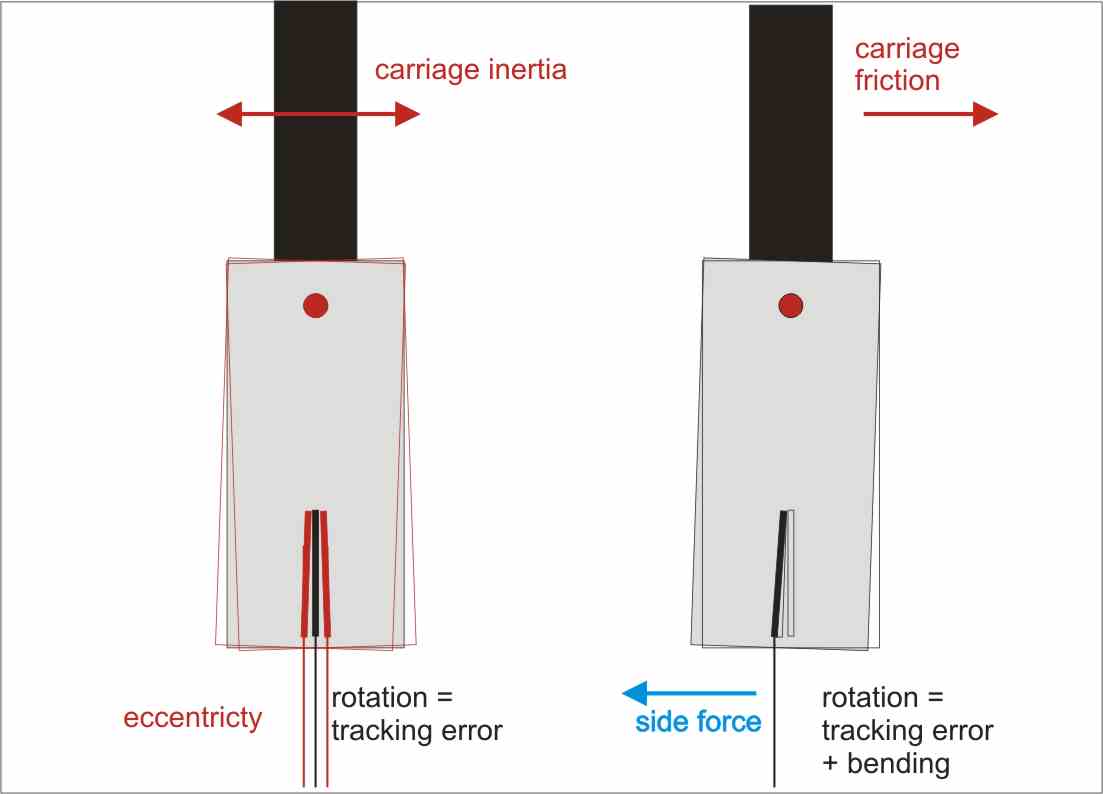

Difficult to discuss this kind of PLT without knowing precise measures, since possible solutions are endless and very different from each other (shape and position of the guide): all geometrically accurate, but presumably with very different behaviors.
I made a couple of mockups with two very different guides for a rough string test*: the rotation is evident and fairly constant - more for A, something less for B.
In short, the offset pivots seem to do their usual damn work, inducing a variable skating as in Birch type.
Now I understand what Doug meant:
The chances of a DIY blue print replication of the Schroeder PLT being built are not very good, but a reasonably close working version based on the same principles? Yeah, that can happen.
carlo
*Ray K go-no-go string test - weight applied = 1gr tension + 10 gr rotation

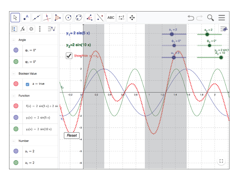

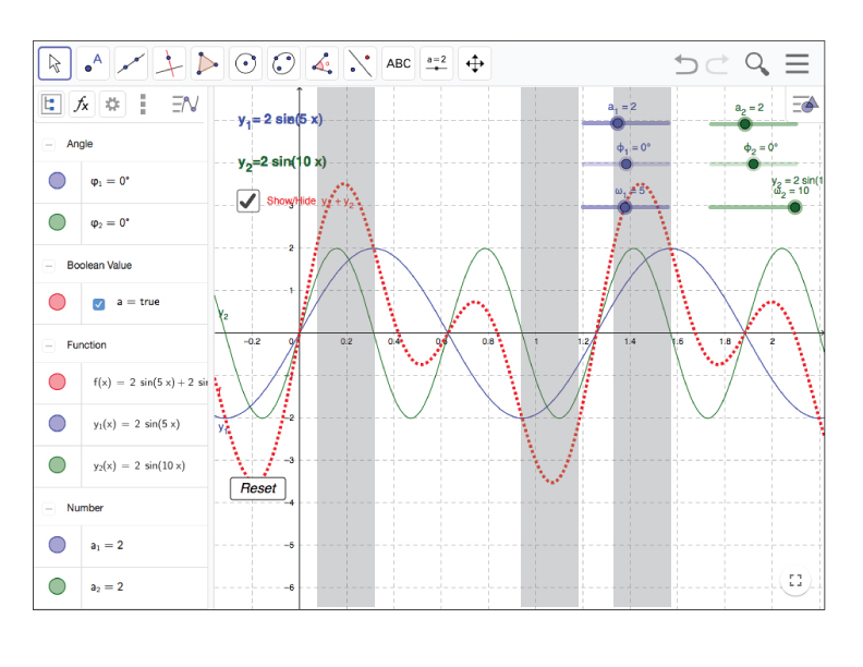

Further thoughts about flexible head shells.
There are two claims about the benefits of a flexible head shells.
1. Reduce resonance frequency.
2. Change resonance frequency.
I am going to examine the first claim.
I assume following.
Y1=5 Hz, cartridge/arm resonance frequency(blue line)
Y2=10 Hz, flexible head shell/arm resonance frequency(green line)
Both levels of Y1 and Y2 are 2's.
So, Y1+Y2=cartridge+flexible head shell/arm resonance frequency(red dot line).
It is very clear that a flexible head shell doesn’t ALWAYS reduce the level of cartridge/arm resonance frequency. In fact, its combination may increase the level of cartridge+flexible head shell/arm resonance frequency. I indicated these increases in shadow areas in the diagram.
If the cartridge/arm frequency, Y1, is equal to the flexible head shell/arm frequency, Y2, and both frequencies are out of phase, Y1+Y2=0. In other words, cartridge+flexible head shell/arm resonance frequency doesn’t exist. Y2 cancels Y1.
In conclusion, a flexible head shell doesn’t ALWAYS reduce the level of resonance frequency. It may increase the level of resonance frequency.

Hi Frank,
Actually, whenever I used the words, resonance frequency, I strictly referred to cartridge/arm resonance frequency.
A cartridge and arm system is a spring system, so cartridge/arm resonance frequency exists. It is Y1 in my previous post. If an arm has cartridge/arm resonance frequency, it means that its head shell is a regular head shell, not flexible head shell.
Now, let’s install a flexible head shell and take the cartridge out of the equation. A flexible head shell and arm is a spring system, too. So, there is a flexible head shell/arm resonance frequency, I.e. Y2 in my previous post. From the video, I think the magnetic flexible head shell is a spring, too.
Finally, if I add a cartridge on a flexible head shell, there are two parts which bring the springiness into the system. The resonance frequency is actually combination of two frequencies. It is cartridge+flexible head shell/arm resonance frequency. That is Y1+Y2.
It is obvious that a flexible head shell may actually increases the level of resonance frequency.

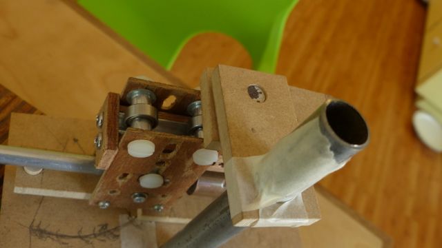

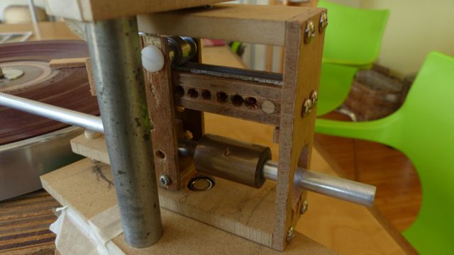

A while back, I got interested in the an idea DD has been advocating - separating the horizontal and vertical functions in a PLT. I thought, at first, that a good looking fairly simple TA might be possible, but difficulties became apparent quickly including keeping the subassemblies away from each other.
The photos show a model I built. You'll all notice my usual fit and finish, I'm sure.
I don't believe stylus drag is sufficient for PLTs so there was supposed to be a rotating arm to move carriage forward and control its position, but because the geometry I chose is wrong it just won't work.
Beyond that, I never satisfactorily solved the fundamental problem of side and axial forces on the linear bearings. The arm will rotate and the carriage will roll, but they don't like to do it at the same time.
I'm sure there are other better approaches to this idea and it is possible that exotic bearings and materials for the linear tracks could make this type of arm feasible, but the deeper I got into the project, the more convinced I became that rotational solutions are the easiest.

Hi Doug, nice to talk about these things again with you: it seems that we have remained among the few "privileged" people (hard work + head banging) to have experienced first hand the problems of these TAs.
From the photos I understand too little, but it seems that this arm suffers from the same problem as the Syrinx
# 1521 I think i've made a big design mistake, not understanding that the same torque that generates the rotation is exactly the same that, acting orthogonally, hinder the linear bearing to slide (like moving a carriage by pushing from side). It's a matter of vectors, point of applications of the forces, not friction
I did not understand how your arm gets the advance, but maybe here too the lever torque blocks the linear bearing by side.
As you rightly notice the stylus drag is not absolutely sufficient for the task: the Syrinx mk2 #1531 had the linear bearing in front to avoid most of the leverage effect, but results were equally discouraging #1544.
Confirmed by measurements with the pendulum, which gave an SD of +- 1/4 of what everyone was talking about (data from calculations, or from the stepping down method) and behaved differently from usual beliefs (e.g. it seems quite independent on peripheral speed) -
...but the deeper I got into the project, the more convinced I became that rotational solutions are the easiest.
Now i'm pretty sure, too, that the extension must be get directly from the torque, without linear bearings, but how? The Syrinx string gadget worked great, if you didn't attach it to the linear bearing. And, if you think about it, that's what our Birch type do, too.
A true, extensible, Thales is the only solution to get a truly centered stylus: someone, someday will find the way. (hard work + head banging)
ciao carlo
