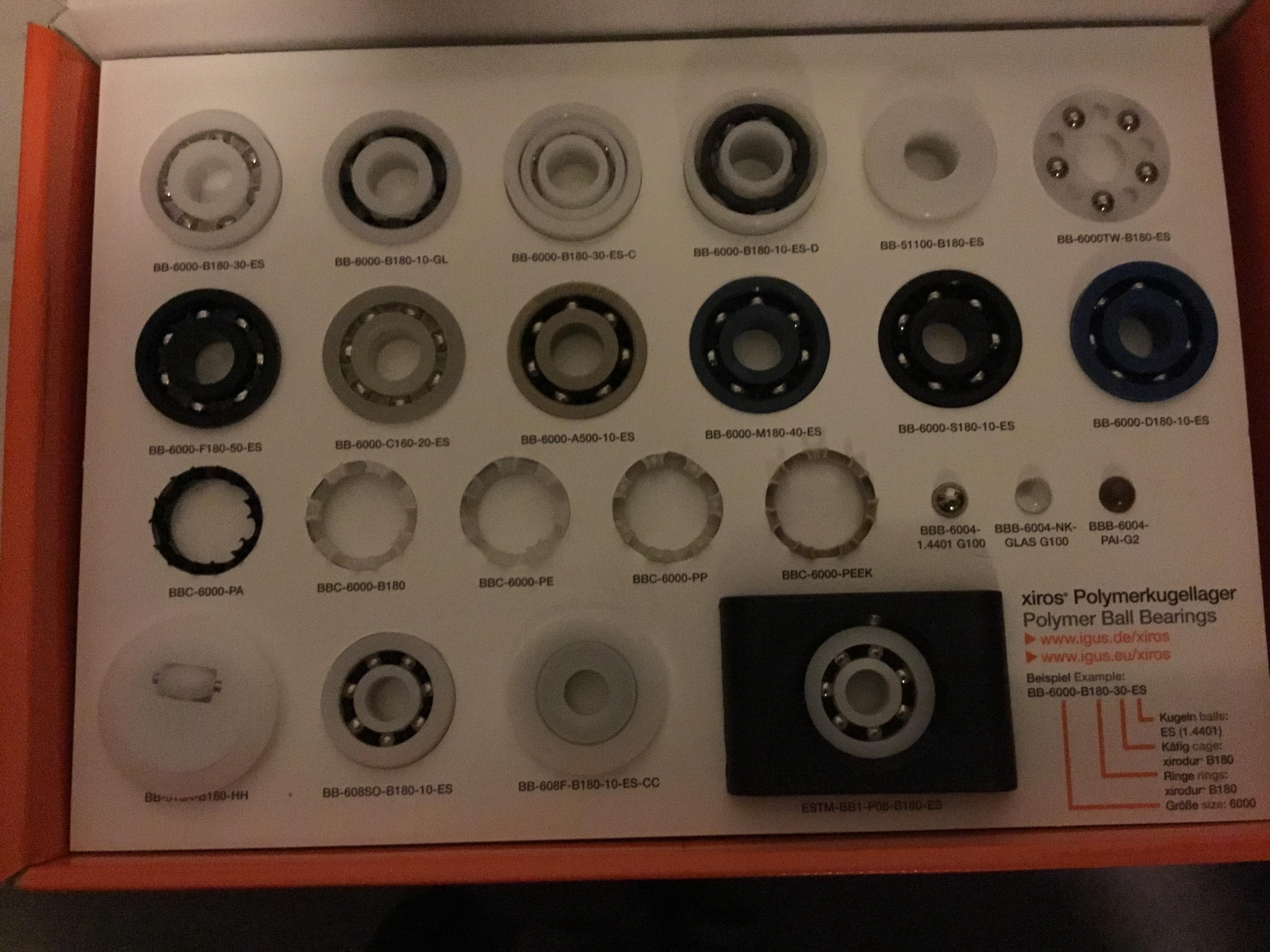

Hi to all. In the pursiut to m yown design of PLT I need to find non-magnetic ball bearings, those not be attracted by magnets. Attraction will influence proper work of magnet guide (my design is very different from that of Frank). As far, as I know, evem ceramic bearings still use steel parts, which will be attracted. At the same time, some sorts of stainless steel are almost non-magnetic. Are such bearings available?

Hi Walter,
The best ball race bearings I have tried are the hybrid-ceramics from boca bearings. These use silicon nitride balls in 440 stainless Steel races. I believe the retainers are also 440 stainless. Unfortunately I think that 440 is slightly magnetic. When I get home from work I'll dig mine out of my parts bin and wave a magnet at them. I did try some full ceramic bearings from China. These did not perform as well as the bocas in my application but as they are zirconium oxide for both the balls and races and have PEEK retainers they will be non magnetic. Boca do do full ceramic bearings with either PEEK or PTFE retainers that will be non magnetic. I think they are quite expensive but will almost certainly be much higher quality than the Chinese ceramics I used.

Hi all,
My favorite supplier:
https://www.igus.nl/product/460
Ball bearings of resin with glass balls, really non magnetic, don’t know about the sizes though- starts with 3mm

Sorry Walter,
The boca hybrid bearings were strongly attracted to the magnet I put near them. Scrub the "a bit magnetic" from my previous post and replace with highly magnetic.
The main advantage of fully ceramic bearings is that they tend to have lower levels of friction than their steel counterparts. Although plastic and glass bearings will be non magnetic they will probably have higher friction than equivalent steel bearings. As it's a tonearm you're building I assume that keeping friction to an absolute minimum is important. You could experiment with making pin bearings from non magnetic materials. These will probably be lower friction and have less play than even the best ball race bearings. And bearing chatter is much less likely to be a problem.

Niffy, Doug, thank you, now I see that stainless steel is not an option.
Carlo, I'll think of shielding, your idea seems to be worth trying. However, completely non-magnetic bearings I would like to try first.
Coolerooney, igus looks really good, I just have no glue about prices. They seem not to provide small scale sales. Closest their retailer to my country is in Poland, that isn't too bad.

Hi Walter,
If you like I can make some enquiries, let me know what you’re looking for
You’re in the Ukraine?
Found these guys
https://www.igus.com/Contact/Sales/UA/iglide
https://www.igus.com/Contact/Sales/UA/igubal
But it can be they don’t carry that product range in your area
Worst case, you buy em through me, at cost, no worries- but no returns -hahaha
Btw, They are quite generous with samples/sample boxes -check it out
https://www.igus.com/info/company-sample-request-com
Have some lying around, but are bigger ones- see pic- you’re welcome to em

Plastic bearings seen by my retailer (no brand - sold for food machinery) run very well, but with evident chatter; Not so small too.
Found this for Igus - seems that here they sell single bearings i.e. 20 eur a 3mm bearing
https://www.igus.it/info/ball-bearings-xiros-a500#section_6
A doubt - with hybrid bearings just the races can be attracted, and the races are round - if they are not going to be magnetized (magnet not always near them) where is the problem?

Coolerooney, thank you, a bit too expensive for experimental prototype arm. I'm not yet sure it will work as expected, so I'll rather try with chiper Chinese from Aliexpress, and if arm is as good, as I hope, I will use IGUS for final version.
Carlo, problem with magnetic bearings is in my design. I need at least two of them to be non-magnetic, because as they pass near magnets, the distance between magnets and bearings change, and in doing so, it will affect tracking ability of the arm.
