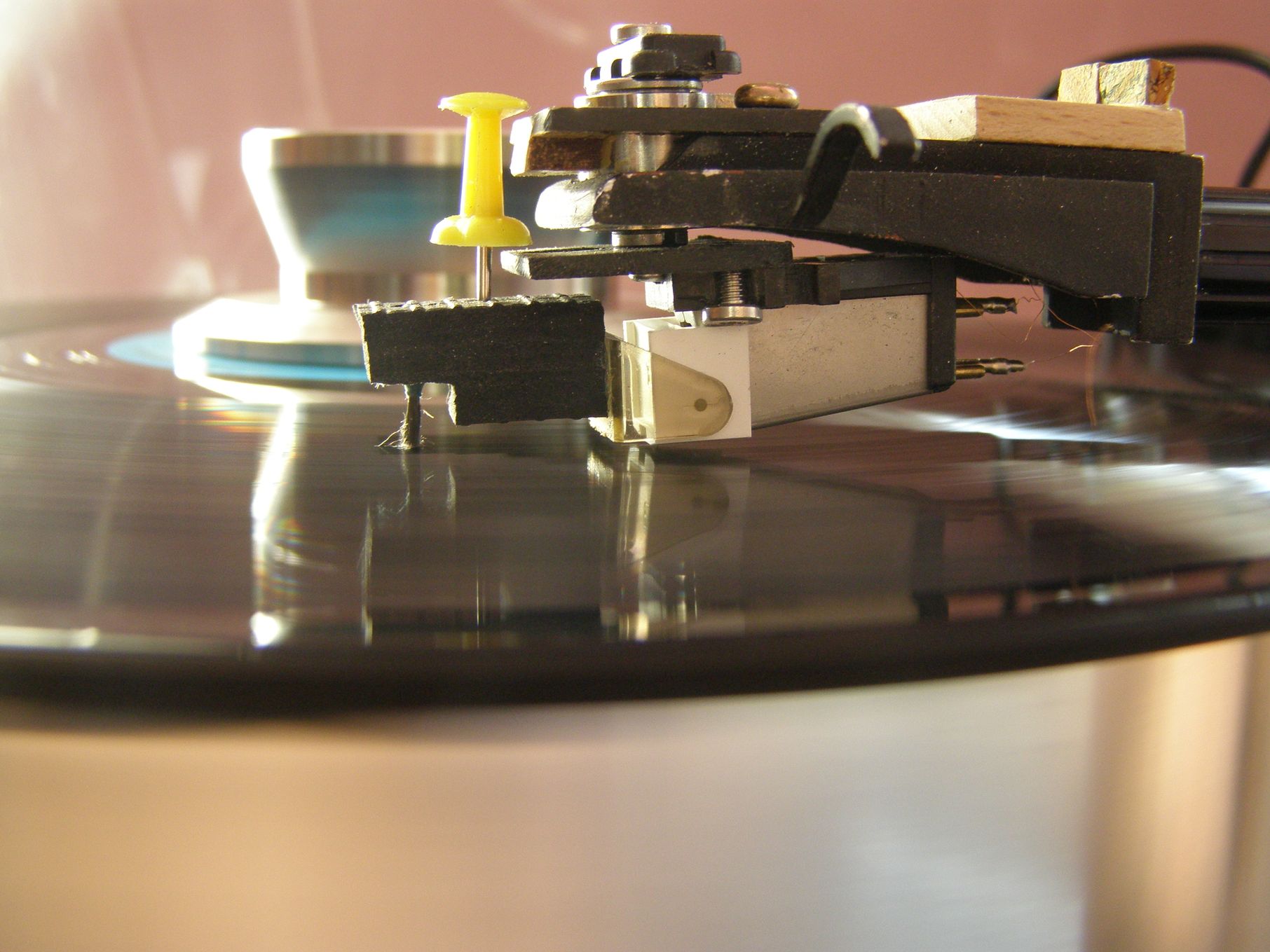

My post(#2130) was referring to rotary shells RS like, (no magnets, bearing above tip) as shown in the attachment. Claimed to rotate, correcting residual tracking errors of pivoted TAs.
The doubt came to me noticing that it was strange to commit to make very sophisticated bearings and then to use common short and rigid cables. A quick test, observed with my usual macroscope, confirmed my doubts: fortunately for customers, rotary shells do not turn at all, and Walter's explanation (#2031), cables or not cables, is decisive -- stylus tip in axis with pivot = 0 momentum,
Now these others (#2134): quote RAY #2035 completely, this case is very different because here the pivot is some centimeters behind the tip, and this is a lever.
However, building some PLTs and Linear ones, and more measuring them, I gained some painful experience of the forces involved (2 - 300mg r sin alpha), so when I see those cute springs and that cotton bud pushing ...
Still a basic doubt: why an oscillating headshell (tunable or not)? I know that many decouple the cartridge and all the rest (wives included), to me (and many others) it seems the best way to enjoy all the possible and imaginable resonances, well secured inside the cartridge.
It's a matter of taste, I know.
carlo

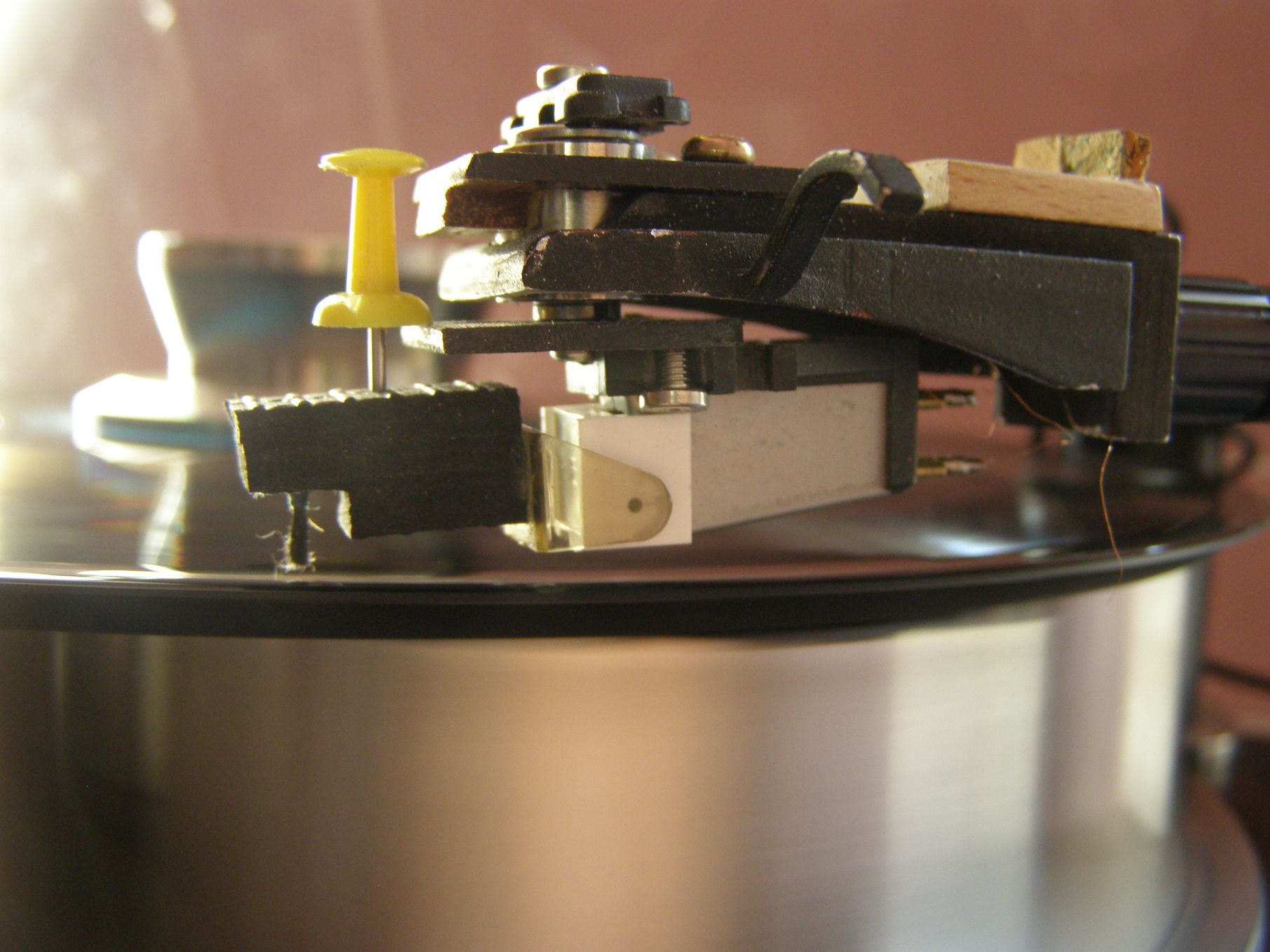

In my rotary shell (#2131) I've used thin laquered wires, taken off ruined MM cartridge coils. As a result, there isn't any resistance from them, and cartridge turns easily. My intention was to listen, if pivoted shell makes difference in sound. Actually, if put pivot point coaxially with stylus, and carbon brush in front of (the way brush is on picture), it will be able to turn cartridge to correct angular mistake, while it travels across the record. This way we may convert regilar pivot arm into something like PLT by just using a modified headshell.
I'm sure it will work that way to almost annihilate angular mistake. However, it seems to bring other problems, I do not like to deal with. I also do not consider small angular mistake a main problem with pivot arm. Anyway, it was fun.
Actually, the idea of Frank to use magnets instead of springs (in my case it was plastic strip on the top) is brilliant.
Walter
Rotary shell

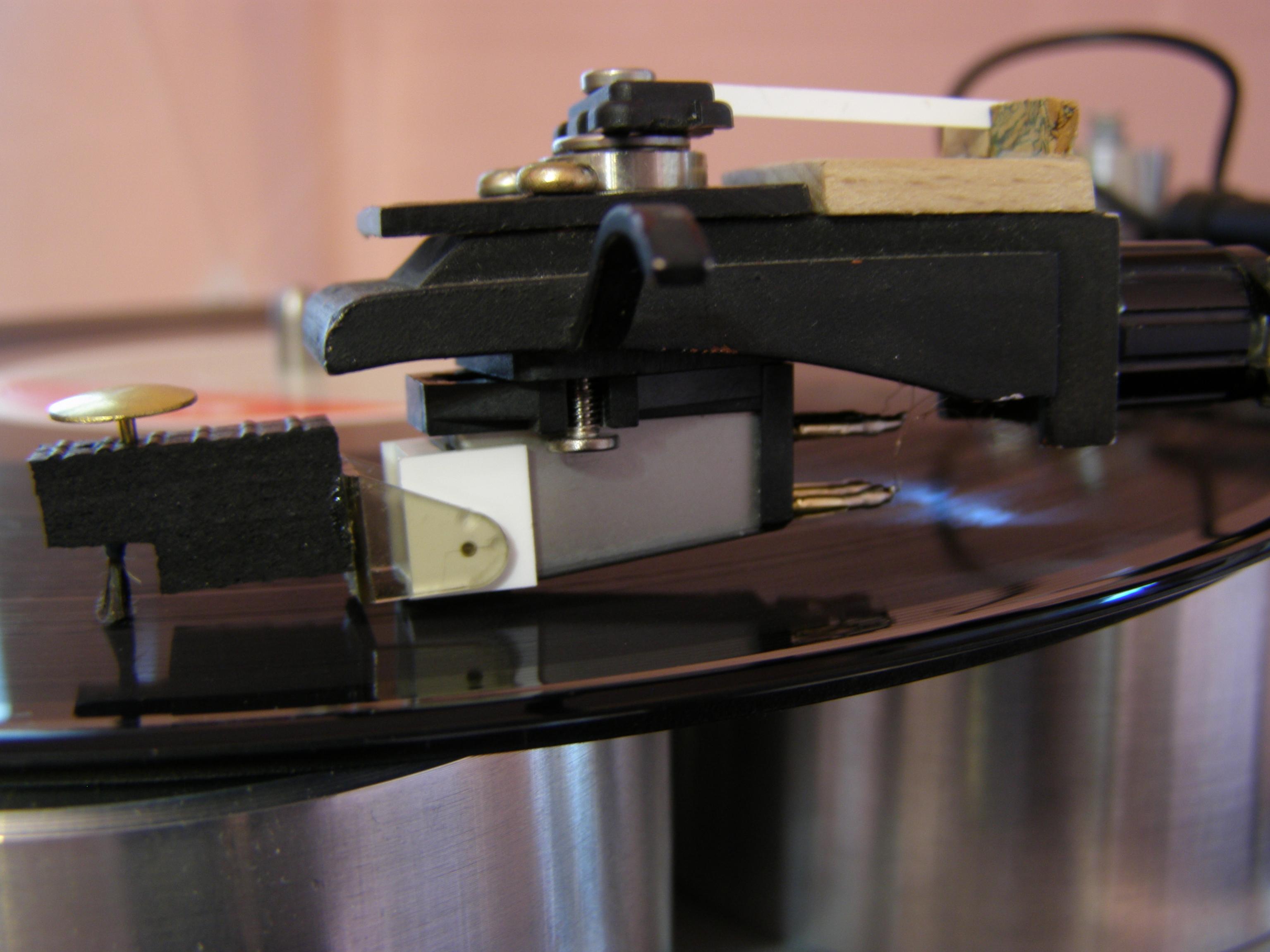

I've reconfigured my shell by positioning bearing coaxially with stylus, and deleted strip spring. It actually works better, than I supposed, turning by the brush. I will put kind of indicator to see what is going on with angular mistake. By the way, I have an idea on how to make the cartridge to return to proper position for the first track of the record under influence of arm lift.
Later I'll try Mr. Schoeder's magnet arrangement, it is easy to apply here.
