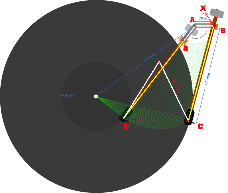

The arm is another variation of the Birch geometry discussed earlier and it uses a servo system to move the arm base, which I think has great potential as opposed to a parallel tracking servo. The similar arm in modern production would have to be the Reed 5T arm.
As I understand, there where some misunderstanding in the forum about this arm. Some looking at a convergence somewhere in the prolongation of the arm.
The convergence point is the Z point on his picture. That could allow to make a full mechanical version of it.
I have edited his image.
To resume, 3 lines articulated (free to rotate on each others), AB, BC, CZ.
The BC always parallel to the arm if we look from the top, attached to it on its vertical axe B IE turning in the same time. The only fixed axe is at A.
I have no idea of the practical forces needed to move this assembly, reason why he had chose to use a motor to move the system with an error detection ?, but, indeed, the cantilever will always stay tangential to the groove and it is a strait arm, that means no lateral forces on the cantilever due to centipede effects of non tangential angle.
It should be easy for a DIY to make a quick prototype in the air to figure out if this mechanical assembly move freely enough at the end of the record or or if it gets stuck.
On the contrary, at he beginning of the record, the friction forces on the diamond tip will push the system towards the inside of the disc, which is equivalent to a classic angled arm on this point. We could imagine a nylon wire with a counter weight attached to the point B axe and which would hang at point X to compensate. With the benefit that it don't act on the arm itself. The motorized version solved this problem, the axis AB being no longer free to turn.
