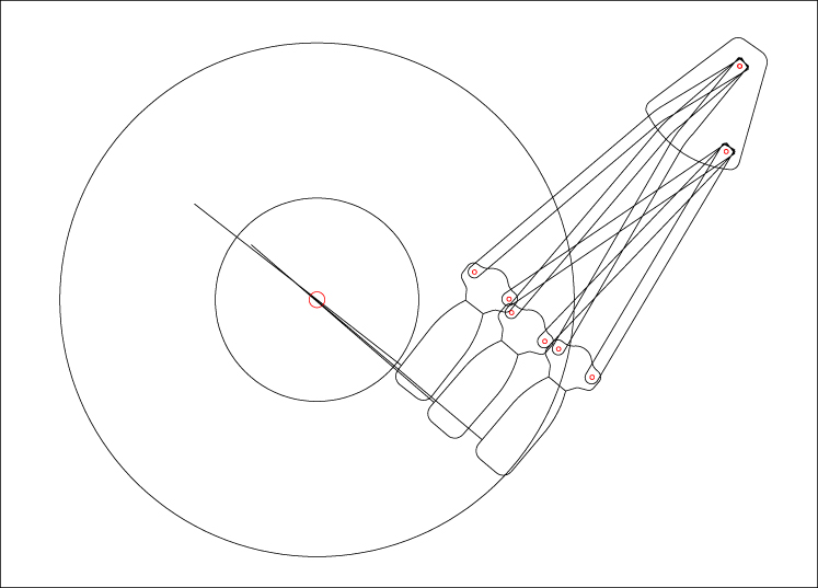

Niffy
The klaudio design probably has the lowest offset of any pivoted arm. Ranging from about -7° via 0° to +7° across the playing area of the record. This will result in an average of only a couple of degrees, much lower than the 20+° of most arms. This will massively reduce skating force and the requirements of a bias mechanism. It could explain why I can't see an anti-skate mechanism on this arm. The resulting skating force is too small to be worried about compared to the complexity of the required bias mechanism.
Niffy
Not sure where you get the +/- 7 degrees from. If you put a ruler on your screen while viewing these video clips, it is hard to see any deviation from zero tracking error.

I see no reason why the mechanism should not be able to achieve true zero tracking error across the record. Offset angle in the context of overhang and [skating] force plays by different rules with a klaudio because the stylus friction force is acting upon multiple moving pivots. Are you are thinking of offset here as in terms of multi-link arms such as Burne-Jones or Van-Epps?
attachment.php
attachment.php
The B-J arm would be expected to [skate] towards a middle, neutral position.
This being so, it is nonetheless puzzling why klaudio offer the arm in 10 inch and 12 inch versions if both achieve the same result. Is the skating devil lurking here? Let's see, where's my string...

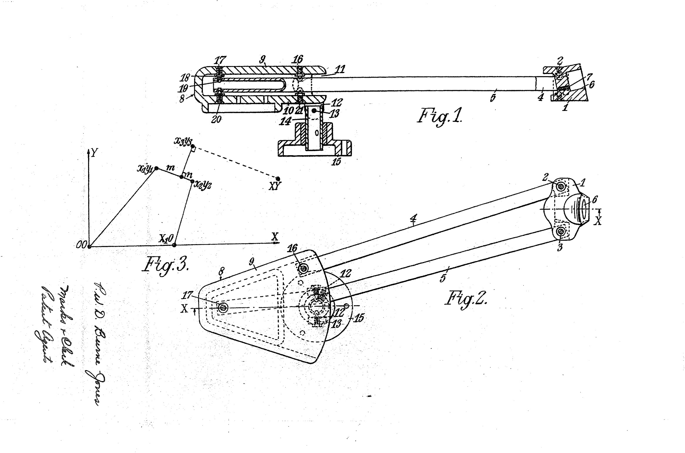

Ray K
Hi Ray,
My calculations were based on memory and I had thought the klaudio was 14" and not 10" or 12". The +/-7° was based on this error. The 7° was the maximum offset angle not the lateral tracking error. Due to the arm being shorter than I thought the maximum offset will be slightly higher. The tracking error is as close to zero with this arm as makes no odds.
The longer version of the arm will have lower average offset and thus lower skating force. The reason for the longer arm might simply be that a lot of people who are after lower tracking errors already have 12" arms so the 12" version will mount on their deck with minimal modification.

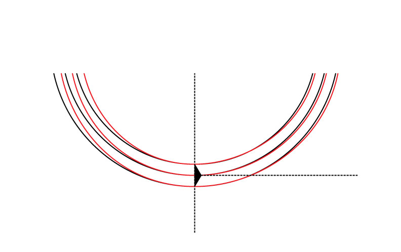

Niffy
Agree. Here is a diagram to illustrate what I was thinking about. Black lines are parts of cycle and red lines are parts of spiral. Black triangle is a cutting head.

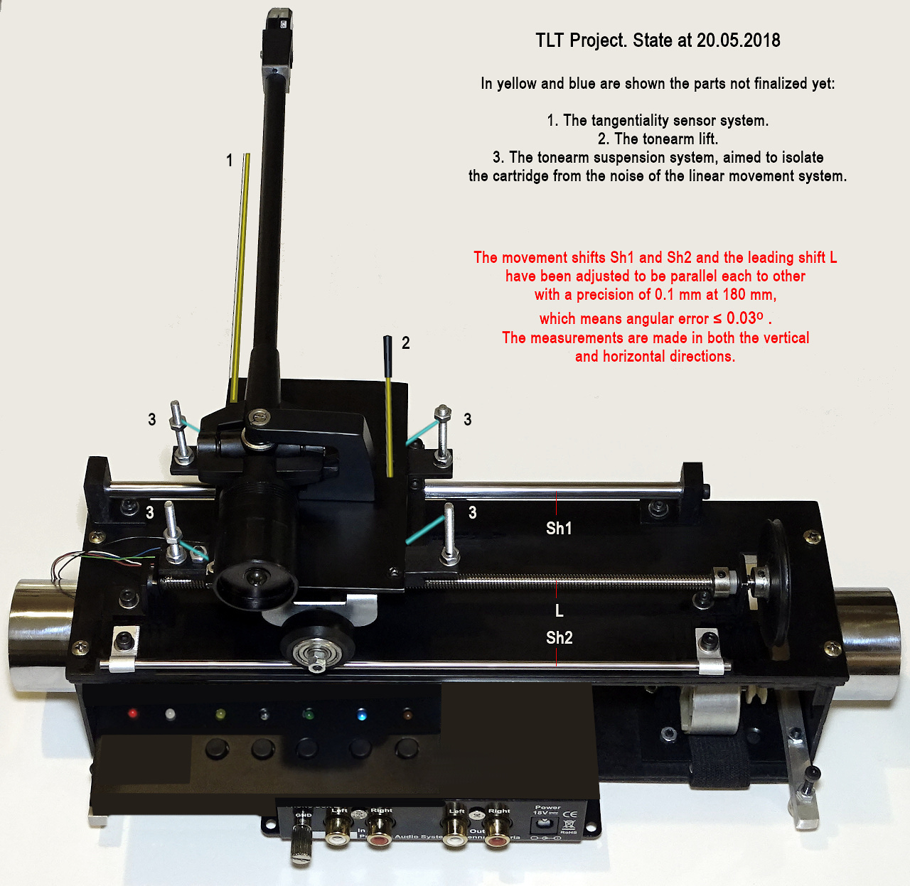

Ray, I am one of these people. I worked on a simple design, using my old Technics tonearm, but I abandoned it to try the Ivanov's floating tonearm idea.

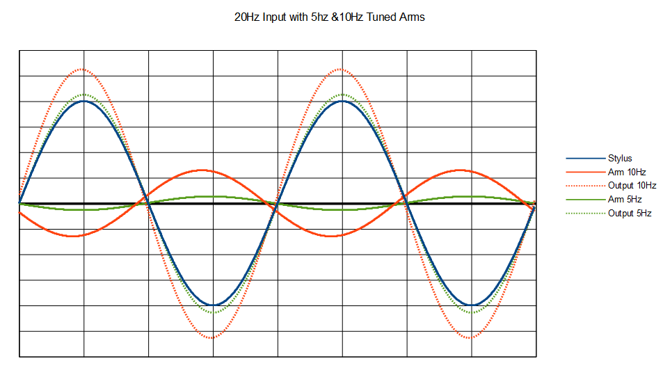

The variation in pitch causing a change in acceleration of the arm? This really is counting angels. A 0.17 dyne force? With an average cartridge this would result in a deflection of a massive 0.0003°. About a thousand times to small to be heard by even the finest pair of ears.
The 6dB is very real for doubling the mass of the arm. An arm tuned to the recommended 10hz will have the cartridge body moving only - 10dB compared to the movement of the stylus at 20hz. That's about 30% in absolute terms. Double the mass will reduce this to around 15%. The relative movement decreases by 12dB per octave so by the time you get to 100hz the 10hz tuned arm is moving at -40dB and the heavier arm at -46dB. So yes by the time you get to high frequency the difference is small but the difference at low frequency is massive and definitely not counting angels. Even if your speakers can't reproduce 20hz the cartridge will still be moving at this frequency if the record is cut at that frequency. When reproducing the midrange would you prefer your cartridge to be moving a little or a lot at low frequency. Reducing low frequency movement of the cartridge has a positive impact across the entire audio range.
Niffy
The things that determines the motion of the cartridge relative to the stylus/groove are the effective mass, compliance and damping. The stylus tip mass plays no part in this. The graph below shows the difference in response between an arm tuned at 10hz and one tuned at 5hz. In this case the 5hz arm would be 4 times heavier and have a relative motion 12dB lower.
And this one shows the actual difference in motion relative to the groove for the same two arms
Niffy

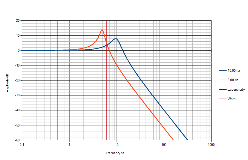

Hi Panayotis,
For some unfathomable reason it has entered into the dogma of tonearm design that lateral and vertical effective masses have to be the same.
In the vertical plane you want to have the effective mass set so that the resonance due to the compliance of the cartridge suspension is around 10hz. This is so that the resonance is above the frequency of warps, which occur up to about 6hz, and below the audio band.
In the lateral plane there are no warps so the only low frequency motion is that due to eccentricity at 0.55hz. Bass frequencies are only cut laterally, there is no stereo information on a record below about 120hz. Increasing lateral mass reduces cartridge movement at low frequencies. I would recommend making lateral mass 4-5 times as great as the vertical, so it is tuned to 4.5-5hz. By the time you get up to the frequency where there is stereo information the vertical and lateral motion of the arm will be virtually the same.
One of the biggest advantages of the linear arm is that it tends to naturally have a higher lateral mass. It is strange that this is the thing most often said to be a negativeof this type of arm.
The only conventional pivoted arm that I know of that purposefully has a high lateral mass is the morch dp-8 which received universal glowing reviews.
