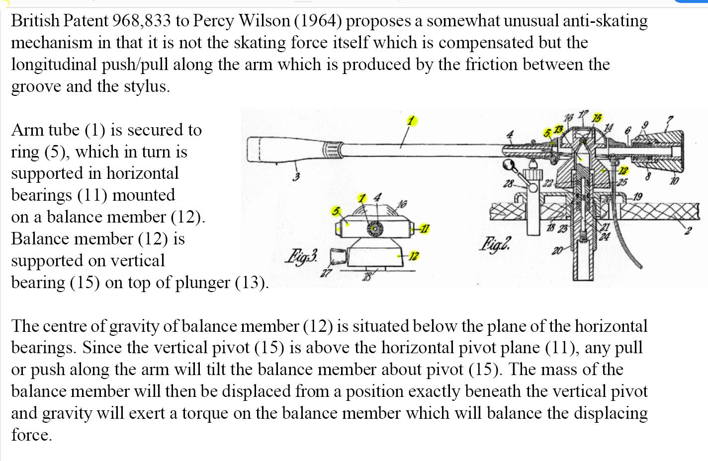

From my previous link - attachment
Someone knows how this strange arm works?
From drawing and description seems that the traction exerted by the stylus drag trough the wand on the ring 5, is compensated by the inclination of the balance member 12 on his pivot 15.
I cannot see any other consequence than a continuous variation of the overhang, which could have only harmful effects. Strange, improbable from a respected designer.
But if there is an anti skating or geometry effect, or a variation of pivot resistance (which is what interests me presently) really I don't understand how it could work. (not so strange)

Thanks a lot Ray, beautiful documents; your TA knowledge seems endless.
Maybe i got it, once read his description. Seems simple and sophisticated, just a matter of planes of tilting of the "balance member": not on the azimuth as i thought, but slanted due the " push pull" (the stylus drag) acting at the offset angle.
Now i'll try to evaluate well the consequences of that design. Even the construction is filled of uncommon ideas (like the pneumatic unipivot etc.).
This arm pose really many challenges, and deserve to be further investigated: that man, more than half a century ago, had really a clear vision of the tracing problems.

The designer Christophe Esperado was a one time member of the forum (now banned) and participant of this thread and introduced this arm in post#225.
The arm is another variation of the Birch geometry discussed earlier and it uses a servo system to move the arm base, which I think has great potential as opposed to a parallel tracking servo. The similar arm in modern production would have to be the Reed 5T arm.

yesterday I did a simplified 3D model of the Percy Wilson TA, which however does not seem to fully confirm the claims of the Wilson patent, but I will not talk about without permission
