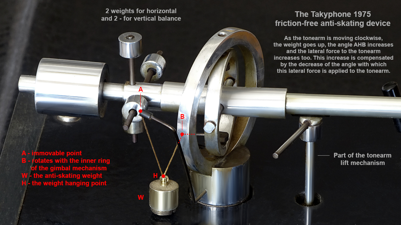

BTW, in my 1975 pivoted DIY turntable I included a friction-free anti-skating device. A weight was hanging between 2 points: one immovable and the other - rotating with the tonearm horizontal rotation cardan component. The rise of the lateral force during the movement of the tonearm towards the disk center was compensated (in high degree) with the change of the angle of the application of the weight force.

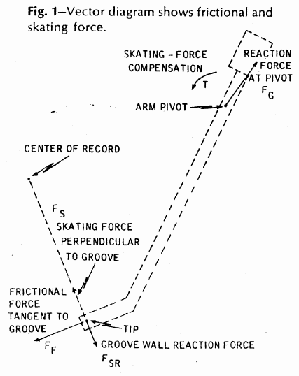

Again .. this is a matter of definitions and namings. In his classic work on the skating issue, James Kogen uses the term "skating force" already in the title. (Att.1). He calls the "mother force" "frictional force" (Att.2) . I agree to use this terminology. You call "skating" the result of uncompensated 'inside force', or the result of uncompensated 'skating force' according to Kogen's terminology.
But, as a physicist I have to go further. The compensation of the skating force does not mean that it dissapears. It is only compensated (in certain degree). So we have the skating force alive, the antiskating force alive and opposite in direction and the result of their co-existence - a significantly lower lateral force.
The stylus holder (cantilever) should never be parallel (or tangential) to what you call the groove direction, instead it should be perpendicular to the radius of the LP. The groove is a spiral and it intersects the radius of the LP at an angle which in turn depends upon the groove pitch.
The two things coincide. You are wrong when you say that the tangent of a spiral in some point is not perpendicular to the spiral radius in that point. The cutting stylus during the master LP creation is moving always in the direction of the current groove radius (talking about the horizontal component of the moves) and tangentially to the direction of the groove's rotational movement.
As your diagram shows correctly, the force perpendicular to the groove is called skating force, contrary to your earlier statement that the frictional force is the skating force.
Joined 2019
Yes, I wrote already that I will conform with the Kogan's terminology. But I wrote also that some misunderstandings are caused by different uses of the terms. E.g. the statement 'There is no such thing as a "skating force" ' of Straight Tracker.

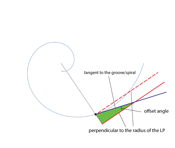

An easy way to visualize what’s parallel, tangent, or perpendicular is to consider motion in the runout groove. The cutterhead stylus holder (cantilever) is/was always perpendicular to the radius of the LP, including through the runout groove. A line drawn tangent to the groove/spiral, and through the point of intersection of the radius of the LP and the playback stylus, will not be perpendicular to the radius of the LP. Even so, if there were audio information recorded in the runout groove/spiral, it would still be played back correctly provided the playback stylus (cantilever) is held perpendicular to the radius of the LP by the tonearm.
To lighten things up a little bit, here's a fun interactive graphic to play with:
Tangent on a Logarithmic Spiral - Wolfram Demonstrations Project
Ray K
Ray K

In my #2004 I wrote about my old (1975) friction-free antiskating mechanism. Here I attach a photo with explanations.
(That time I knew the works of Kogen .. )

Ralf and Ray,
I have still been thinking about your views. On second thought, I think I may be still right about the cantilever tangent to the groove of LP.
I used the model posted by Ray. Please see the diagram.
In the diagram, I added two lines red and blue. Both lines represent two arms.
For the red line(red arm), it is perpendicular to the radius of the LP. It does have tracking error and skating as well unless you add an offset angle. Adding an offset angle can only correct tracking error, but it can't eliminate skating.
For the blue line(blue arm), it is tangent to the groove(spiral). It doesn't have a tracking error and skating either. But it is not perpendicular to the radius of the LP.
The statement I made in my early post.
If an arm doesn't have skating, it must meet two conditions, i.e. the cantilever is tangent to groove and is overlapping the centerline of the arm wand. This is the blue line(blue arm) in the diagram.
It seems that my early statement is still correct.
Jim
I should make a correction to my own post. In fact, saying perpendicular to the radius of the LP is the same as what I said tangent to the groove(spiral).
