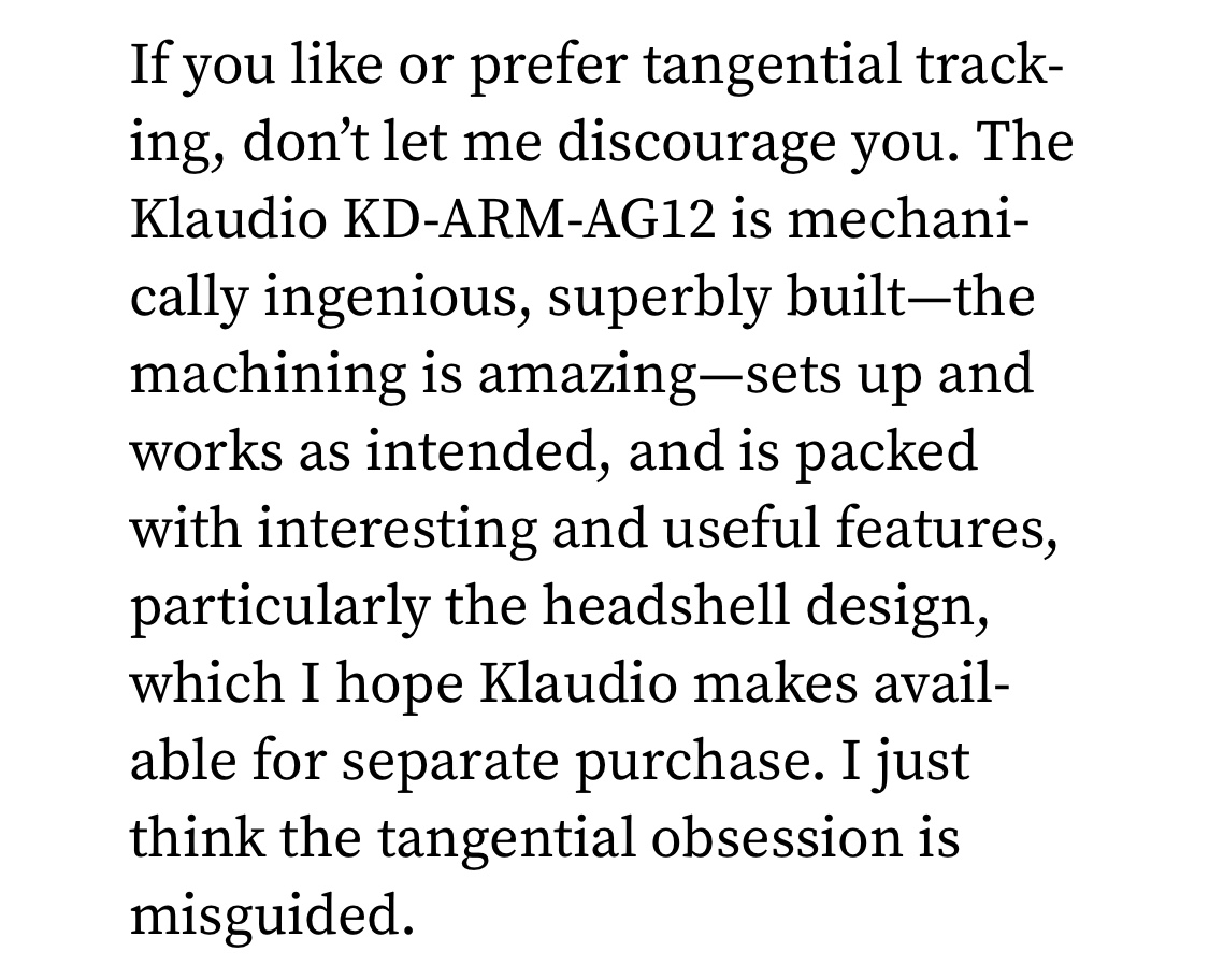

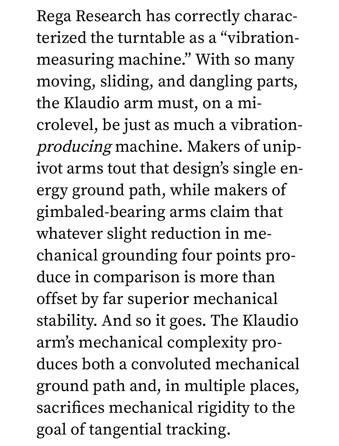

The KLaudio arm is not a pure "pivot" tonearm in the spirit of the OP. Yes, it is pivoted, but it also incorporates a linear ball bearing slide.
In his comments, Mike Fremer considers all of us who value the concept of linear tracking to be "obsessed" and "misguided". Why should we care what he says in his comments on linear arms? Aside from commenting on workmanship, he really said nothing of interest.
Ray K
Ray K
In other words, Mr Fremer said, that it is easier to combine the disadvantages of pivot arm with the disadvantages of the linear one. But who trusts audiopress, anyway? Even if they are right...
I'm still waiting for someone who will combine advantages...😀
I don’t agree with everything Micheal Fremer said especially about linear tracking arms. I am a firm believer of linear tracking arm. However, he does offer some valid points sometimes.
I don’t want to generalize about the view on pivoted tangential tracking arms but want to just refer to Klaudio’s arm. In early part of this thread, I said I don’t like Klaudio's arm because it has too many parts and the construction is too complicated. It seems to me that Micheal Fremer’s listening experience supports my concerns.

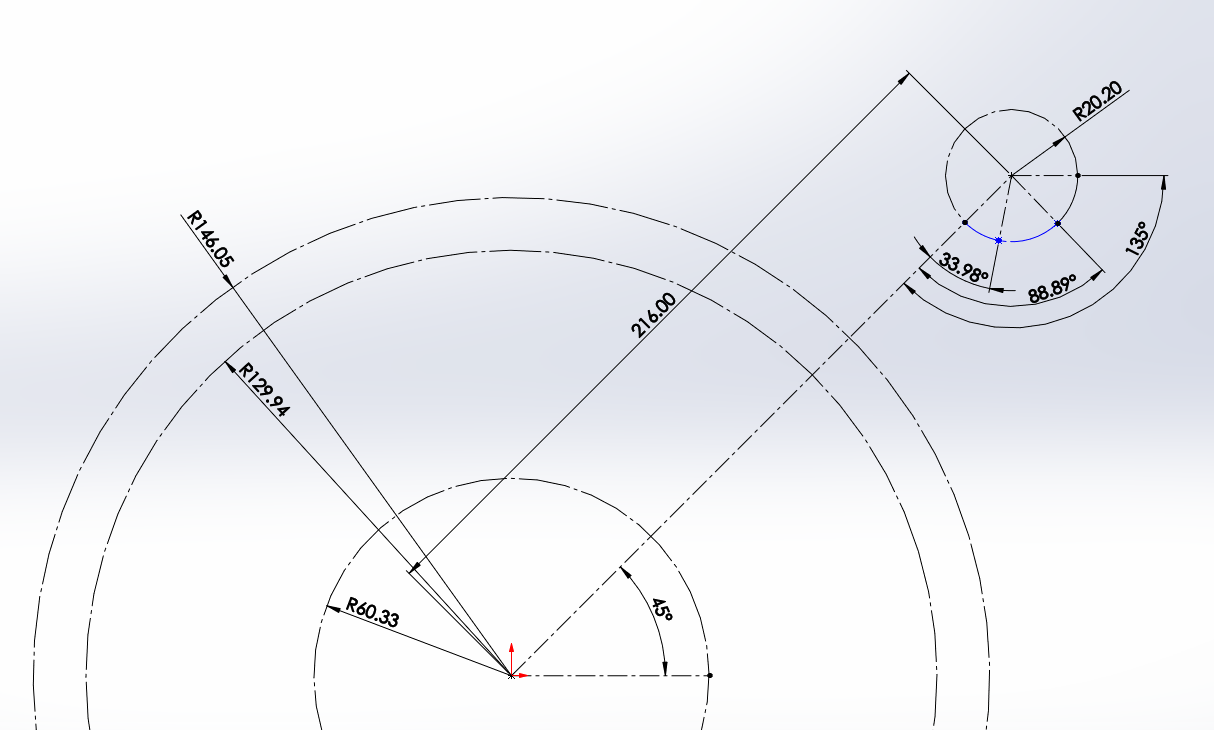

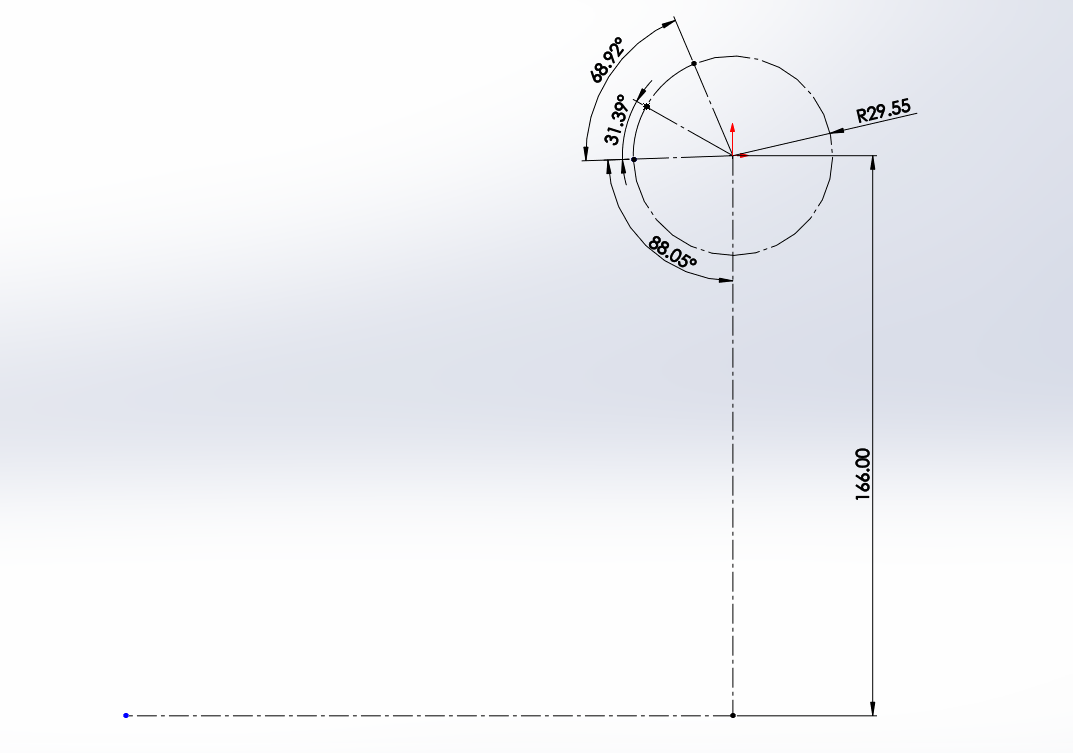

I've refined this geometry a little more.
1st groove @ R=146.05mm
Null groove @ R=129.94mm
Last groove @ R=60.33mm
Tangency error @ 1st groove = +0.15°
Tangency error @ last groove = -0.07°
Most of the play area is spent between NULL and last groove where error goes from 0° to -0.07°, not quite tangent but pretty close.
The ratio of the 2 "gears" or cams is reverse 1:1.4667.
Center to center distance 50mm.

Not new geometry, just an optimization of #1651
The idlers are still there in the model, I've just removed them for simplicity.
If you look closely, the 2 circles in the drawing do not touch. And the sum of their radii doesn't add up to the length of the carrier arm.
I'm using gear relations in the simulation to approximate cams as the cam relations tend to slip.
I've found a new way to optimize the geometry, using a spreadsheet and a solver.
There are 5 major variables + 1 minor, it iterates those variables to approach the target output tangency.
I think I can tweak the algorithm to get it even closer but it might mean losing the nice rounded dimensions it has now.

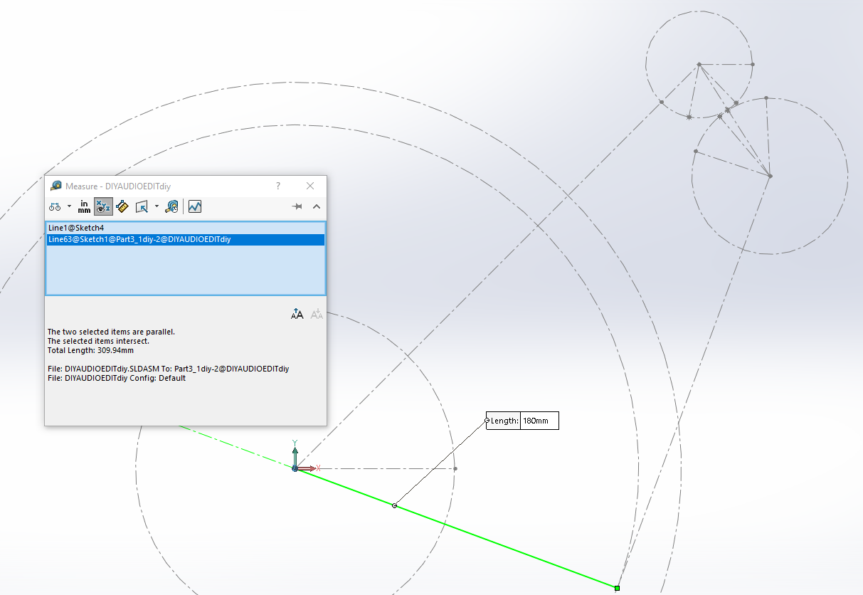

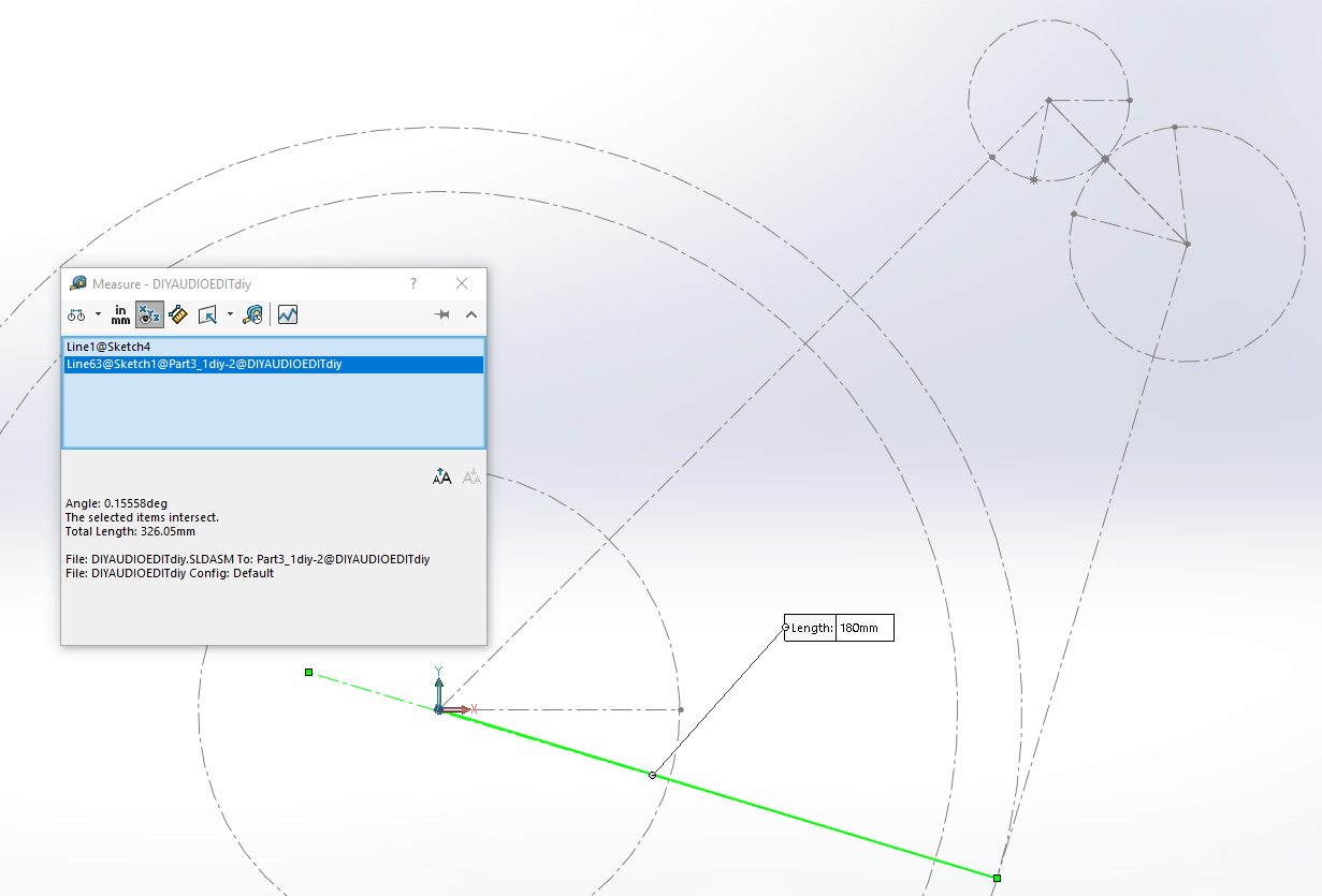

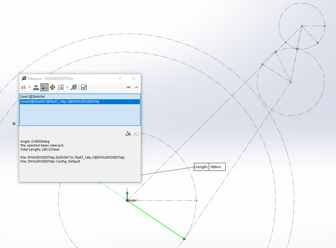

Playing with Linkage simulator i found something a bit better than the original, used for * 3d Rabbit #1950. Same ratio, but the 2 pivots distance increased to 54,5 mm. You may find measures on that attachment.
ciao carlo
*...some day i'll print it. Have you found how to get those cams?
ciao carlo
