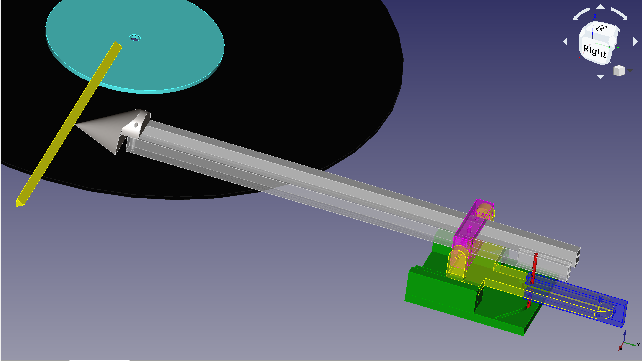

Klaudio tonearm FreeCAD model
For those interested in the Klaudio tonearm, I have created in FreeCAD 0.18 a functional model (attached). In order to see it at work, you must copy/paste the contents of the attached Kla_python.txt in FreeCAD's Python console.
Besides the ruby jewel bearings, the toughest challenge for a normal DIYer is machining the Gaussian bell shaped guide 😉
But where there's a will, there's a way...

Klaudio

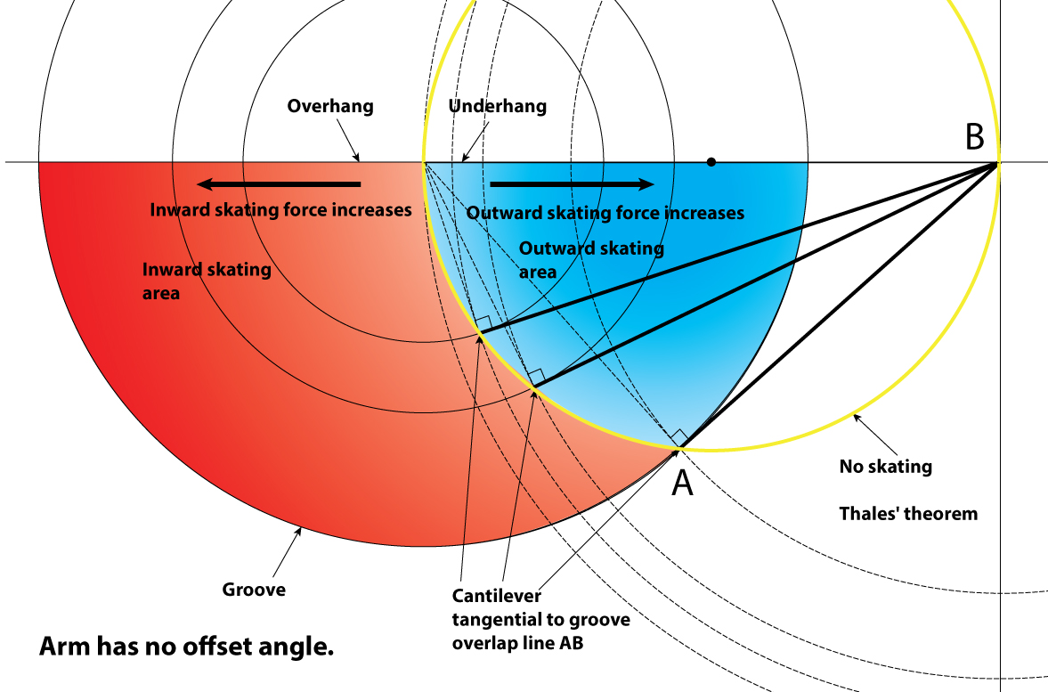

Agree but with some modifications. For a regular pivot arm with an offset angle, skating exists even at null points. In the early part of this thread, I did an analysis of the skating force. Here I repeat it again.
Please see the diagram. In this diagram, the arm has no offset angle. If the arm has an offset angle, skating exists everywhere. When I say an offset angle, I refer to the cantilever is NOT overlapping with the straight line, AB.
So, as long as it meets two conditions, there is no skating. Otherwise, skating always exists. The two conditions are:
The cantilever is tangential to groove and is overlapping the centerline of the arm wand.
Sorry to tell you but ALL pivoted arms regardless of whether they are traditional fixed geometry or tangential will exhibit skating.
The only type of arm that does not exhibit skating is the linear tracker.

Hi. I feel here some misuse of definitions. The skating force is the one directed to the groove movement. It always exists. The lateral component of the skating force is what we try to compensate, as it creates a dis-balance of the stylus pressure on the two sides of the groove and a lower trackability of the channel with decreased pressure.
The "anti-skating mechanism" does not compensate skating!
The principal question in ANY type of pivoted tonearm, regardless of the type of pivoting, is whether it exists a lateral skating force component. The stylus holder may be always parallel to the groove direction and still exhibit a lateral component of skating force. This will occure if the current effective (momentary) axis of tonearm rotation does not coincide with the direction of the skating force.

I understand what you are saying perfectly. If you want to dig deep, you didn’t go far enough. In fact, the groove is not a simple curve, it is a complicated waveform. Therefore, saying the cantilever is perpendicular to the radius of the LP doesn’t mean anything either because skating force still exists caused by the waveforms and the spiral. So is your arm and so are all the linear tracking arms and pivot arms.
If my assumption is not reasonable for analysis of skating, the assumption for the classic calculations of Loefgren and Baerwald is not reasonable either. The two null points are not null points anymore because there are tracking error at these two null points. Since everyone accept Loefgren and Baerwald’s assumption, I don’t see why my assumption is not acceptable.
