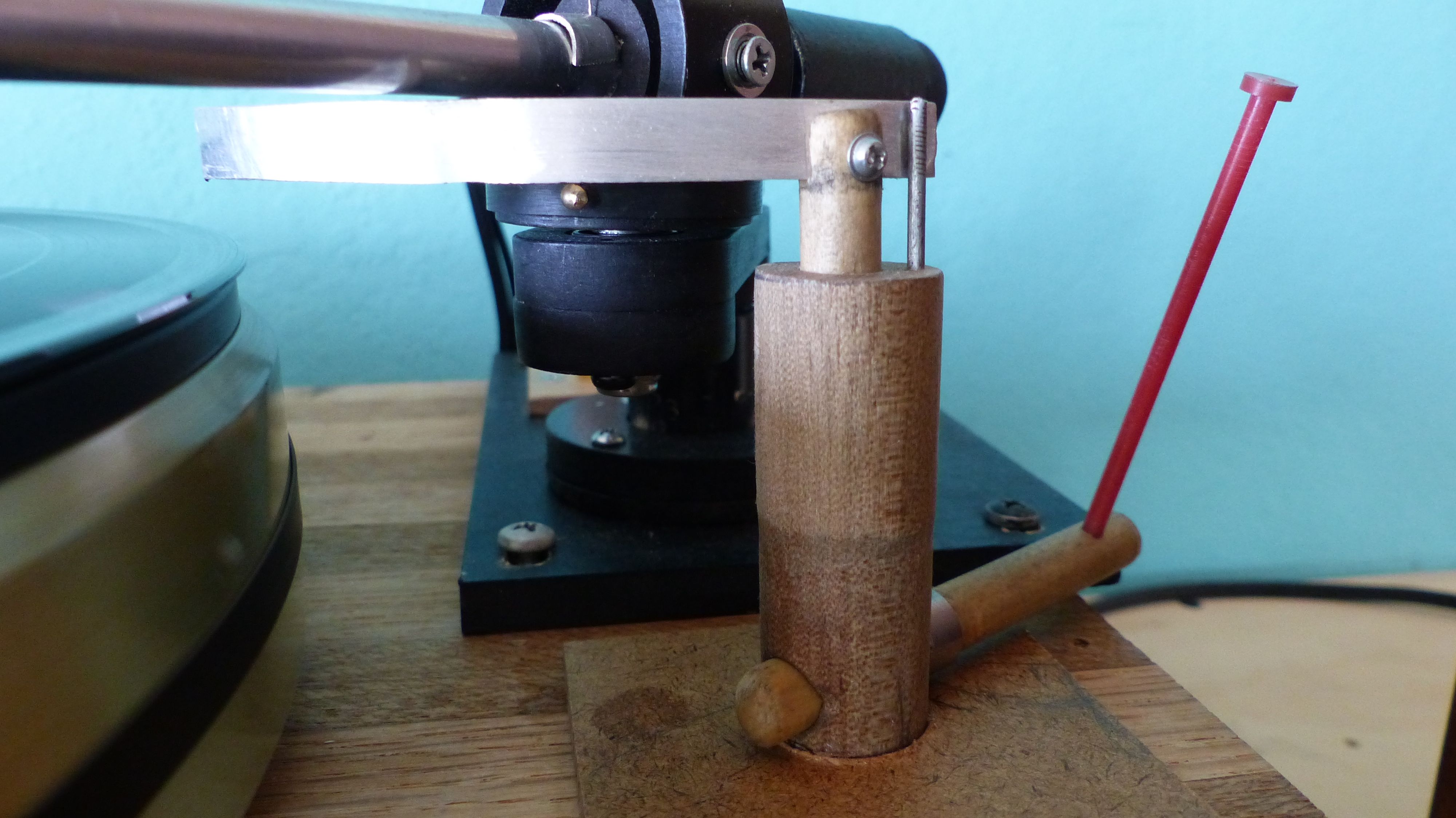

Clever, Doug, as usual. Sometimes my Rabbit too feels a little down mood...

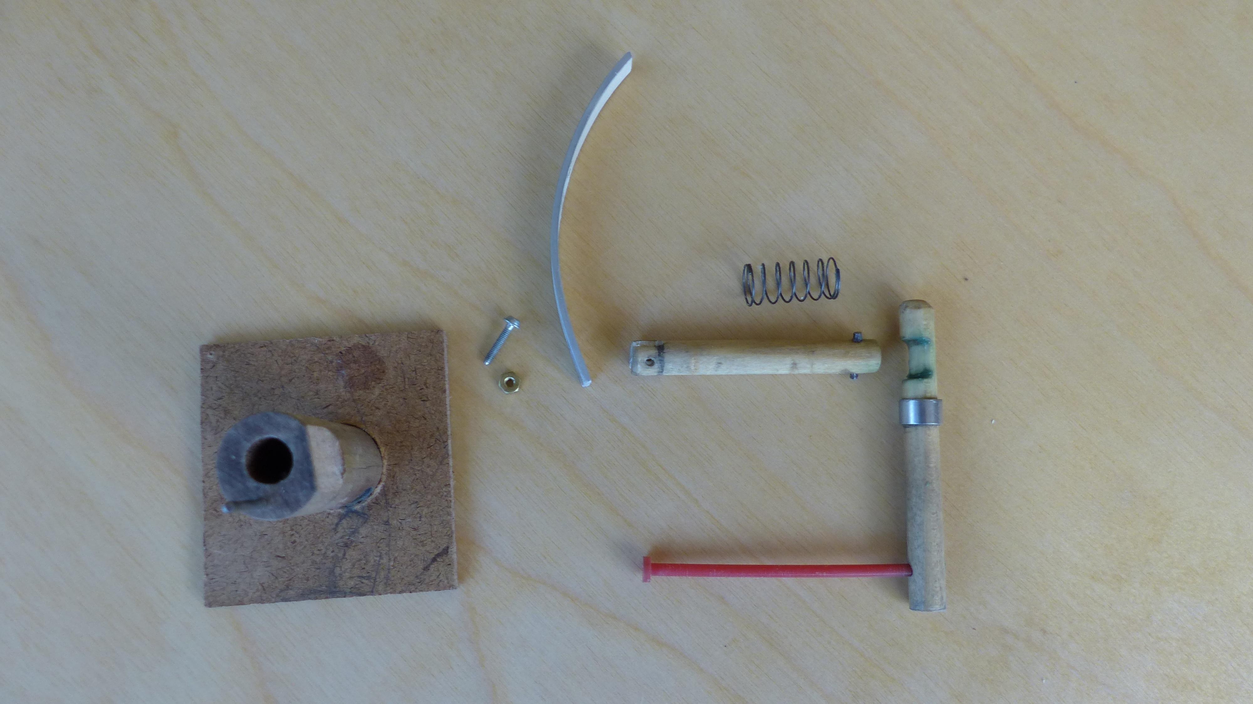

Is it there a spring inside? do not understand the role of the metal side rod
carlo

Carlo,
That could be built on a kitchen table with an Exacto knife and a little care. And bearing chatter certainly can't be a problem.
The lifter does have a spring. If it were built of metal, which wouldn't be hard, and lubricated with heavy silicone, it would probably self-lower slowly.
The metal rod is there to prevent a small amount of twist as the piston raises and lowers. Better construction might eliminate the need.

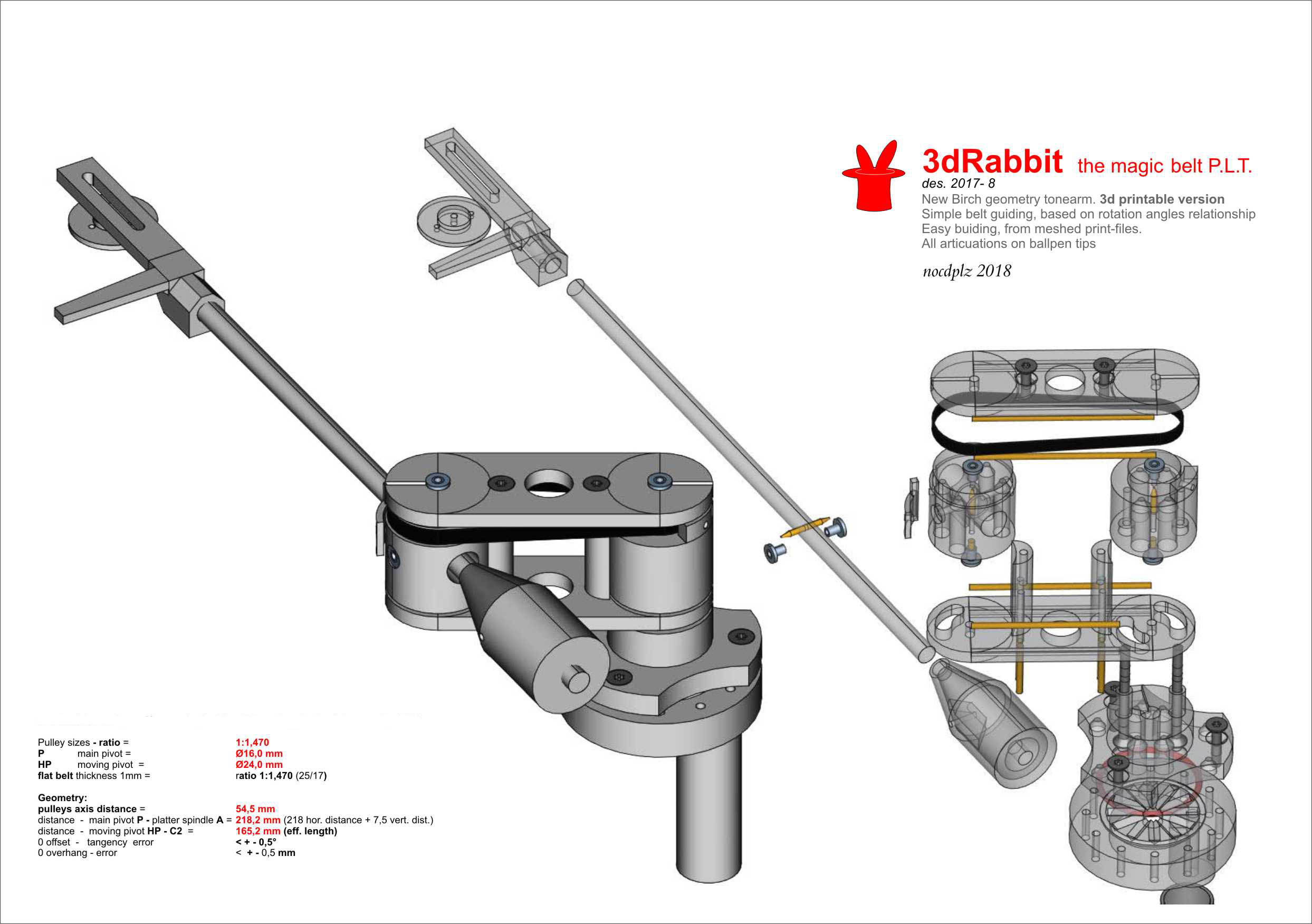

Meanwhile ....
the 3dRabbit's print-files have been -slowly- completed: improved geometry, better than in my metallic version, reinforced structures (in 3D printing hollow shapes may be sturdier than solid ones with infill), easy settable bearings.
But: now I have no will and time to print and test it. So if someone does it, will have the good or bad surprise of knowing directly if it works, or not. In that case don't send me to hell, i did what i could.
Good luck to every brave diyer, since real PLTs are far different from virtual ones
carlo

That arm looks great Carlo. What did you design this to use as the vee part of the bearings where the pen tips sit?
On your 3DToy arm, I believe you designed it for brass set screws that had a vee made by a center drill.
The Bunny looks like it uses something different.
Yes - same pentips bearings as in 3d toy, with just a little mod to avoid the fact that in PLA the threads do not last long: 3mm rivets epoxied to plastic, threaded 2.5mm inside for the v screws
Sorry not to test it. but my old Rabbit works so well...
carlo
ps the Rabbit has just 1 bearing more than a traditional gimballed TA: and -imho- this is crucial to make a working non-servo PLT
carlo
That's very clever. If I can ever finish assembling my copy of your 3DToy, I'll probably give the 3D Rabbit a shot.

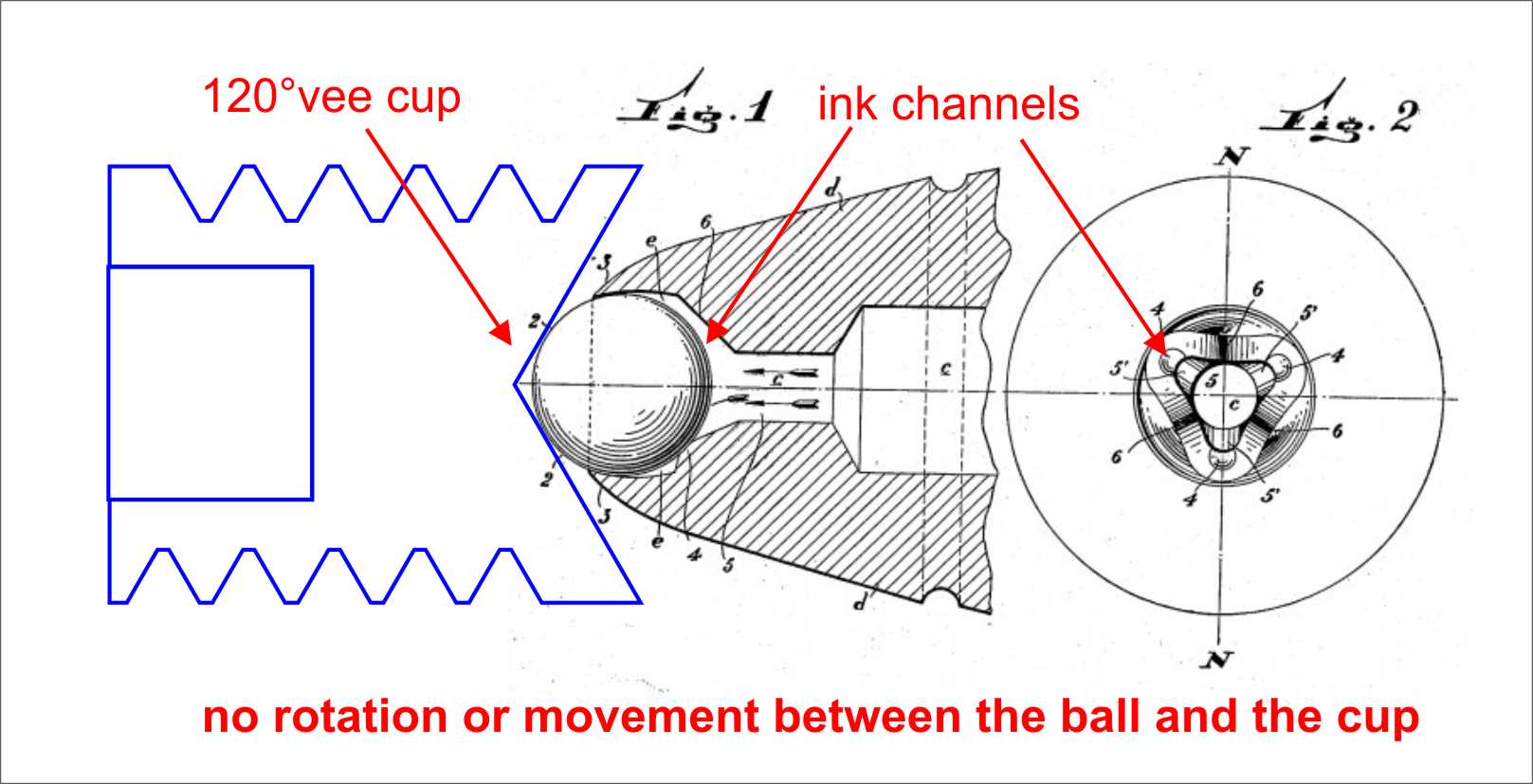

--To make the brass cup grains (the trickiest work of this arm) drill and thread an iron block to guide a center drill and make the conical seat, then polished with a small Dremel tip.
More than enough for a 3dToy, for two reasons
1 - a center drill is not a normal drill bit but a precision tool used on lathes - mills to center holes precisely: it does not make a flat surface, but a starting 118° cone, quite smooth if of decent quality/age. A further polishing with a Dremel may help,
2 - with a ball pen tip there are not two surfaces (steel + steel or steel + brass) crawling against each other, but a sphere that rotates in its seat (the pen tip) The vee cup simply holds the sphere in the right position (related to arm's geometry). At the beginning, following the experts, I emptied all the ink with solvent, then I discovered that ink is a much better lubricant, for viscosity and durabilty, of what I used to put in (silicon grease)
that's all folks - let's not complicate our life where it's not needed

To be clearer.
A ballpen tip is a masterpiece of micromechanics, that no diyer and even a Swiss watchmaker could reproduce (the Chinese themselves who make 95% of the ballpens sold, only in 2017 have managed to make the machines to produce them, instead of buying and assembling them! - Consider that presently they design and build SmartPhones, not bamboo baskets).
In our use (Unipivots & so on) the pen tip must do all the work: the sphere does not rotate on the vee cup. but in its seat, on an ink or grease film). That's why the vee must be 120 degrees or more (not 90!), otherwise is the brass body to rub against the vee cup (and then much better the steel pivot that Niffy talks about)
hope this helps, even if we are off topic

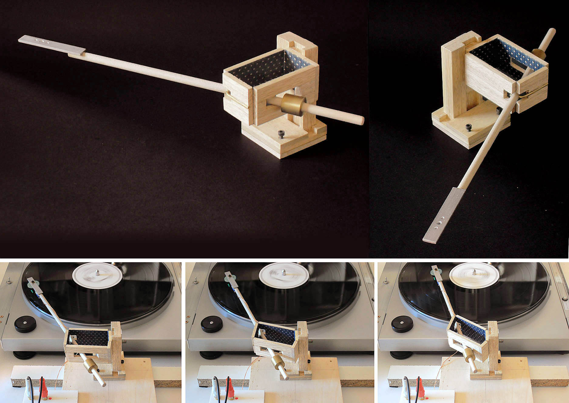

Quote all, Ray, completely: a waving, rolling azimuth is a real nightmare. Adding a second carriage, when just one is more than a problem seems masochistic.
However a cartridge simply sliding on a radial rail represents the perfect geometry: you've only to design a perfect "piston-like" vertical articulation, and to overcome all the issues of the Revox linear tracker. Without a servo, of course.
Nice challenge, nobody till now...
carlo
