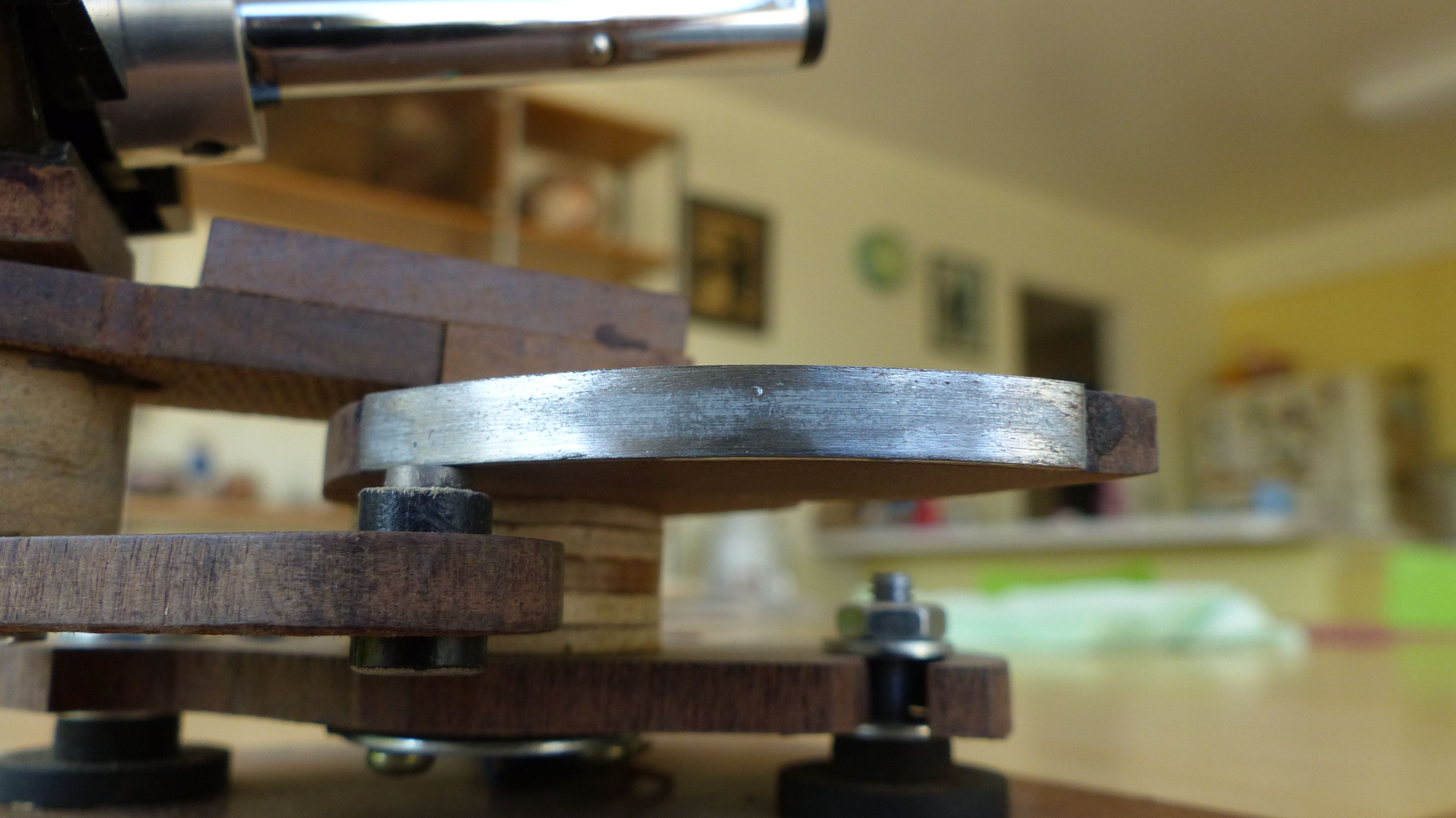

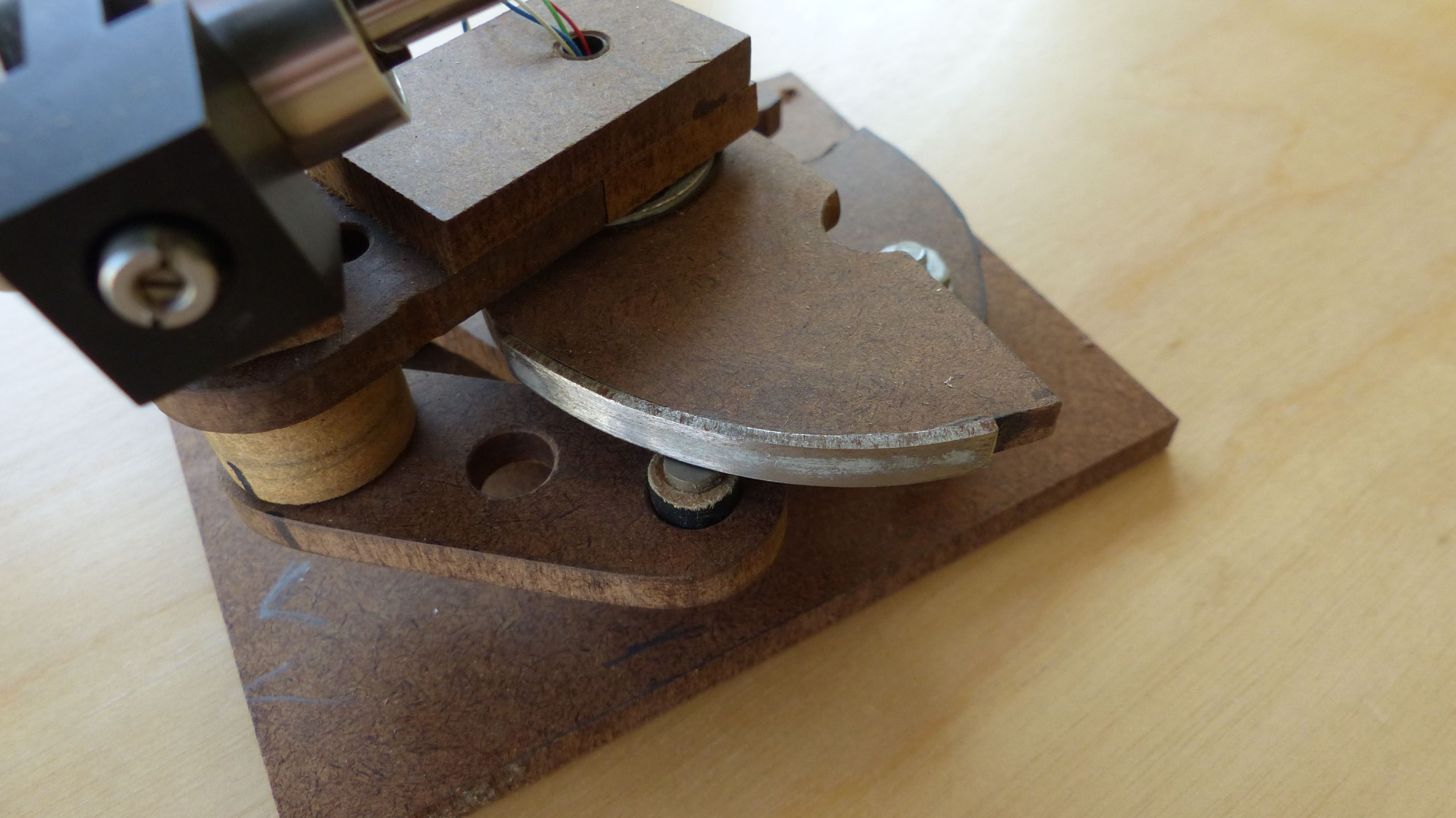

dampdau: I've included a couple of photos of another way to make the guide bar.
Re skating: Both carlo and I have found an adjustable three-point base handles that nicely.
