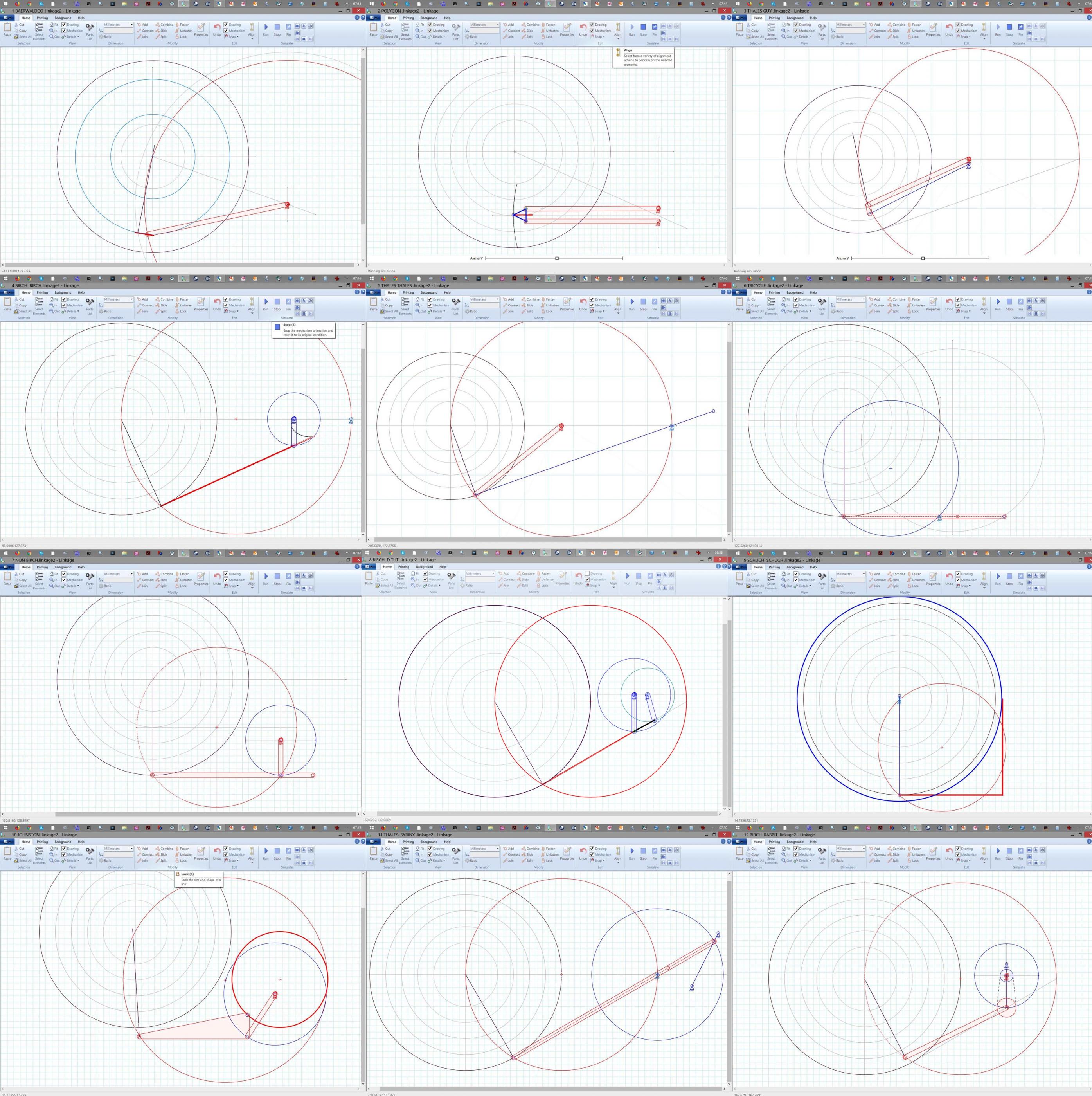

Here some simulations of known geometries, made with Linkage program (thanks to Jcarr that gave us this precious link, and to Dave, the author)
Download Linkage | Dave's Blog
Surely can be further optimized, and many others are around to be investigated; Even better to do them in a program able to do a vectors breakdown too.
Hope this can be useful, or amusing

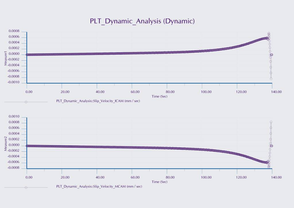

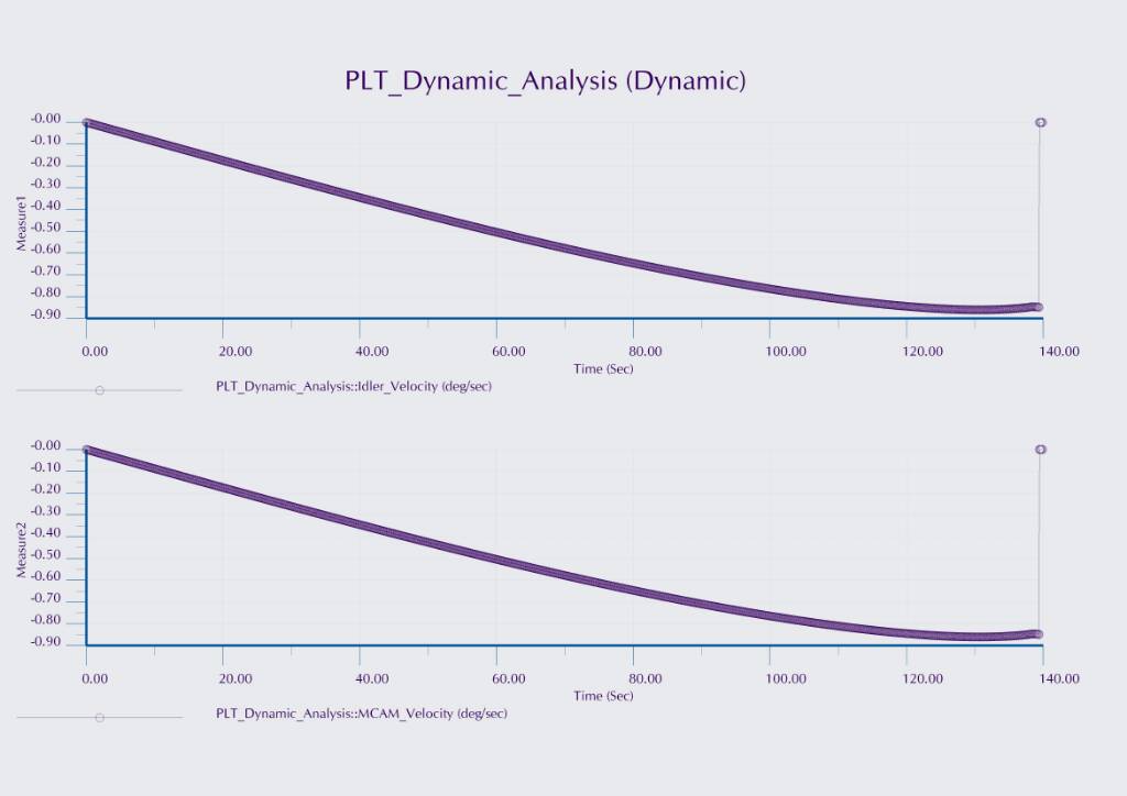

This is what it looks like.
YouTube
The only constraints are main jewel pivot and the cams.
There is no tangency errors anywhere.
Not shown is anti-skate/anti drag force mechanism that is still needed.

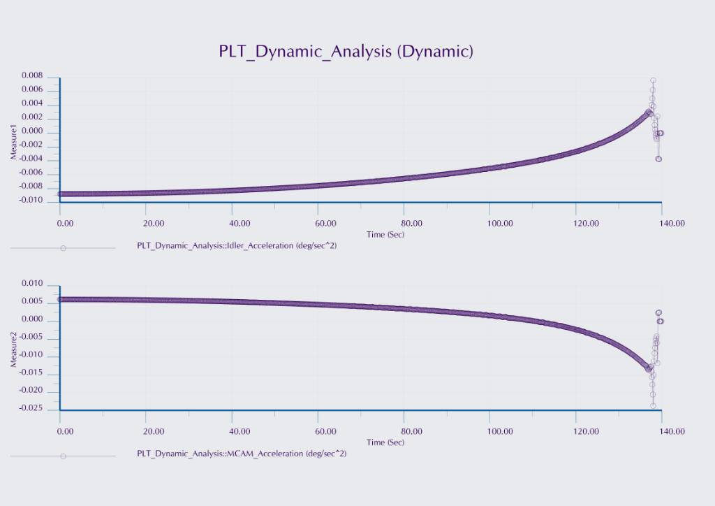

All the frictions are simulated along with gravity and with a 0.0009N force vector along the tonearm tube it rotates the arm across the play area in about 140 seconds.
The 2 counterweights are not modelled.
I was looking for software to design the cams but could not find anything so I had to write the function in excel and use that data to model.
The math works out perfectly to 11 decimal points for both cams but as can be seen in the last pic there is some cam slip, but only 0.5 micron for the last quarter of travel. I suspect this might be an rounding error somewhere.
The noise in the plots are from hitting cam constraints.
To manufacture is turning out pricey because it has to be wireEDM cut from the high tolerances.

Hi Ralf
I cannot find anyone willing to CNC the cams for me with 10 micron precision.
WireEDM can go down to 5 micron.
It needs to be that precise because the cams have a 50 micron gap between them.
There is a rolling surface between the cams that keeps the cams from slipping.
That rolling surface is not modelled as I'm getting IP on that and the drag force counter.
Won't work without those.
That is not a bearing it is another cam.
Cheers
Trenton

Hi 2wice, this belongs more to grinding & lapping than to machining, computerized or not. Sure you need that kind of tolerances in a rolamite like device?
At first sight i'm more worried of cames and their shape, especially in the second half of travel: cames were born to work against levers, or pistons, than against each other. (tags: Camalot - "Friends" - climbing.... that remembers my youth)
carlo
Really a great work, i'll love to see it in action

Hi Carlo
Yes that tolerance is required, they can bind if it's too far out.
I can't find examples of cams used in this way, they work fine in simulation.
Only worry is the increased velocity in the last 3rd of travel, but I'm hoping to counter it by targeting that area with the counter torque mechanism.
Just saying that two counter-rotating cams look like a perfect self-locking mechanism, generating increasing side loads on shafts (climbers entrust their life on it); But the rolamite ribbon can probably change everything, because the loads are no longer radial. no experience about this
Carlo
a mock up before making expensive parts?

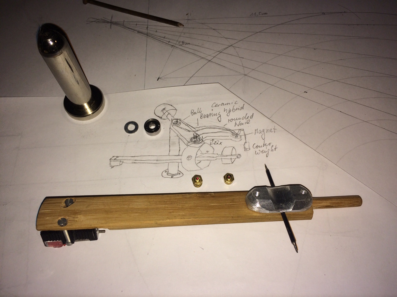

attachment.php
The Construction is very simple, done by a ruler an other piece of paper and a compass.
I added a counter weigth against scating, its force depands on the angle in witch the main pivotarm is moving.
The second pivotarm will be made by a small wire or nail of steel. At the end of the pivot wand is a little neodym magnet fixed, this will damp the arm movings and will lead the wand in a specific curve, the profile can be seen on the drawing as points in the top left edge.
the horizontal armbearing will be made with tiny jewels fixed in a hole at the end of an M-3 brass-Screw.
Uwe

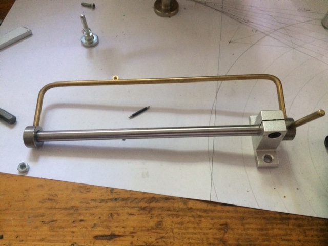

Last Winter I builded a passive tracker by using a linear ball bearing like this.
the remains are the shown bamboo wand and the frame:
attachment.php
But friction in the bearing did concern me and I quitted when it was finished.
Yesterday I went in the building supplies market and got me some aluminium profiles. Then I begun...
This morning the glue is dried, I have to make the iron bow (nail) one again because the fixation was not strong enough. Lazy me, I didn't use oil by cutting the thread.
attachment.php

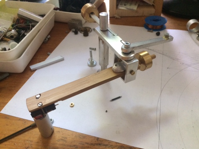

OK, maybe that's it
I had to transcode the video to get a playable format, but foregive me please, now its lying on the side, don't know how to get it upright.
I think by moving by hand its working. Now I have to implement it on my Turntable and check scating. I have already adjusted the needle to 1.5 gramms. forgive me not to use a super duper Needle but I think MCs are little bit over the top, can' t change the tip.
cheers Uwe

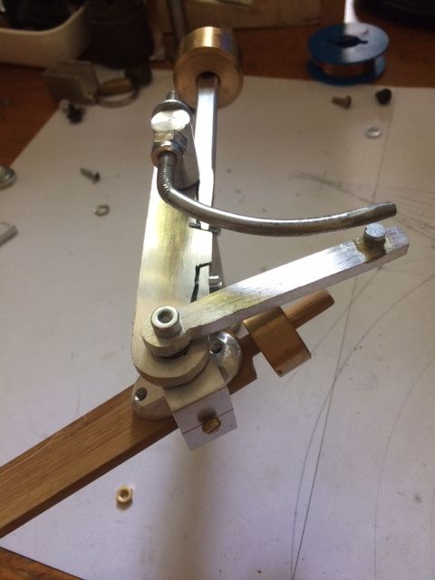

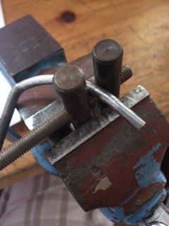

In addition I want to show ohw to bend the bow:
It will last a while until the curve is exactly like on the plan but Its dimensions are not so tiny like on the LT.
attachment.php
In this manner it is more DIY-friendly you don't need High tech equipment. By hand you can get astonishing precise results and you do it only one, so time does not matter really.
I didn't really need my Lathe, but it does help. Manly you need a jigsaw handdrill, some thread cutters a vice and a pair of good files and a good oil.

Uwe, you have hit the nail squarely on the head! However, the on/off action seen with many servo-driven linear trackers is not a problem intrinsic to servo technology. When present, it is due to the design of the servo loop in the particular turntable. I have modified a Rabco SL8E with an opto-electronic servo control circuit that does indeed operate in a continuous, variable speed mode. IME your conclusion is correct - that is the right way to do it. But, this is getting off-topic. I don't want to hijack the thread so, for those interested, here is a link to my work: https://www.lencoheaven.net/forum/index.php?topic=18696.msg279435#msg279435
Your use of the magnetic guide is interesting. In your video the magnetic coupling action seems a bit loose. There is some fore/aft movement along the groove when you swivel the arm back at the "end of the record", likely due to the rubber-band effect of the air gap between the magnet and the guide rod. Changes in stylus drag which come with varying groove modulation levels could pull the arm along the groove and result in audible pitch instability when playing an actual record. Frank Schroeder uses very small air gaps in his arm designs.

Hello diyrak, many thanks for your answer.
Yes you're rigth, there is a swiveling in the magnetic coupling between magnet and the leding bow, but please notice that the system is adjusted to 1.5 grams and just by grinding over the paper the arm holds the coupling and don't leave the track. The idea is to give forces the chance to get in an equilibrium by self justage, this coudn't be
done with strict coupling. I think the LT will behave similar on likely conditions, maybe someone who ones one can proof this.
A smaller air gap would have reqire more precision and I choose to make the arm DIY-friendly, most of us have not access to a water beam cutter.
Thanks for the link, this is exactly what I thougt might have to been done. Unlike in the 80th, in nowerdays you have access to microcontrollers and with an ardurino plus motorshield it is going to be possible to solve the problem.
